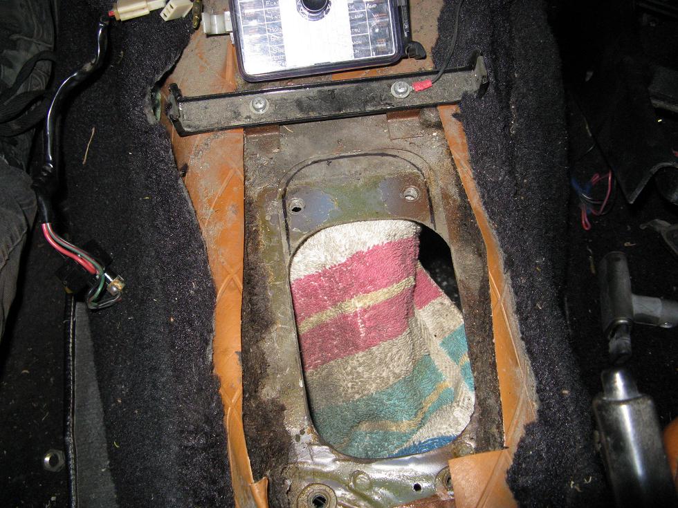

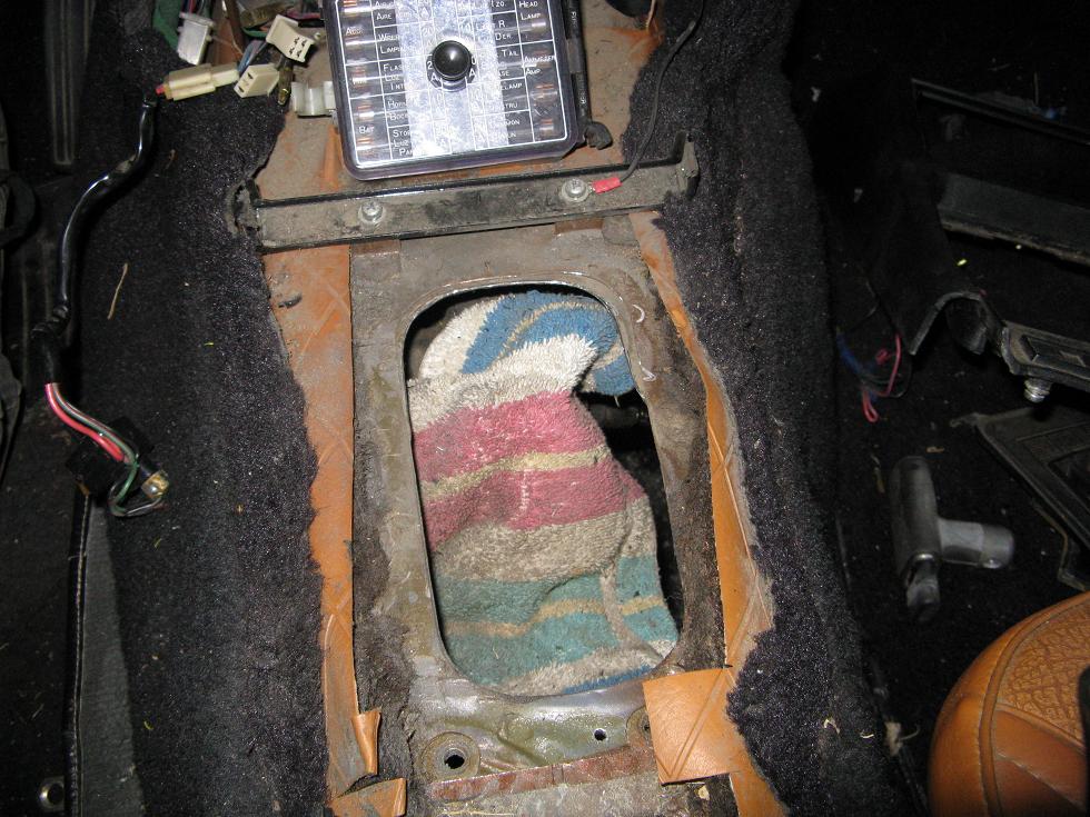

Six_Shooter Posted April 19, 2015 Posted April 19, 2015 I skimmed through the last couple of pages and saw some questions and suggestions for cutting the trans tunnel for the manual shifter. I'll post some pictures of my conversion. There is a picture of the auto shifter hole. Another after I cut out hole, I used the stock manual shifter boot retaining ring to mark this hole. Then a picture after it was all installed. GongZ 1 Quote
