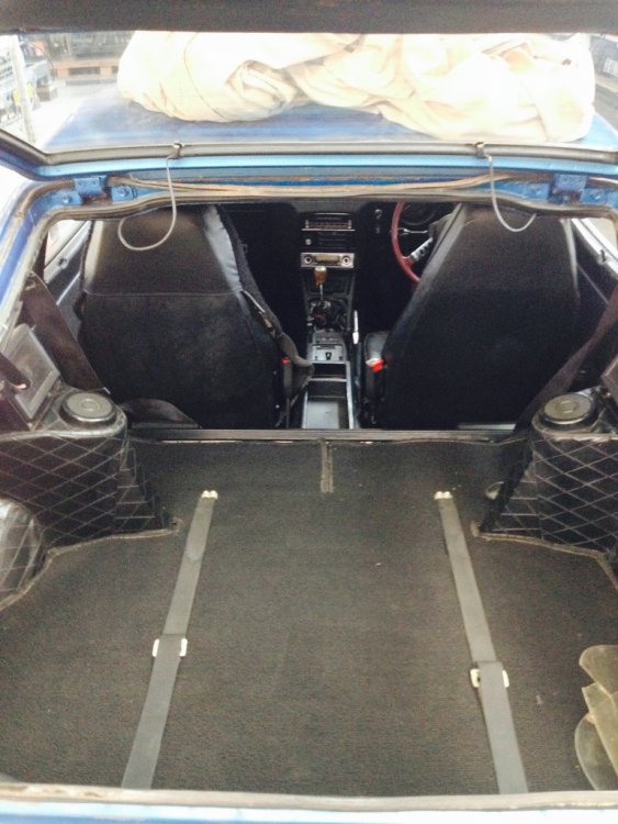

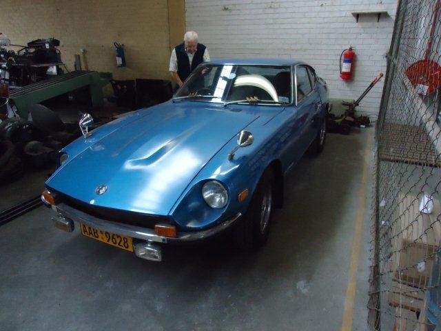

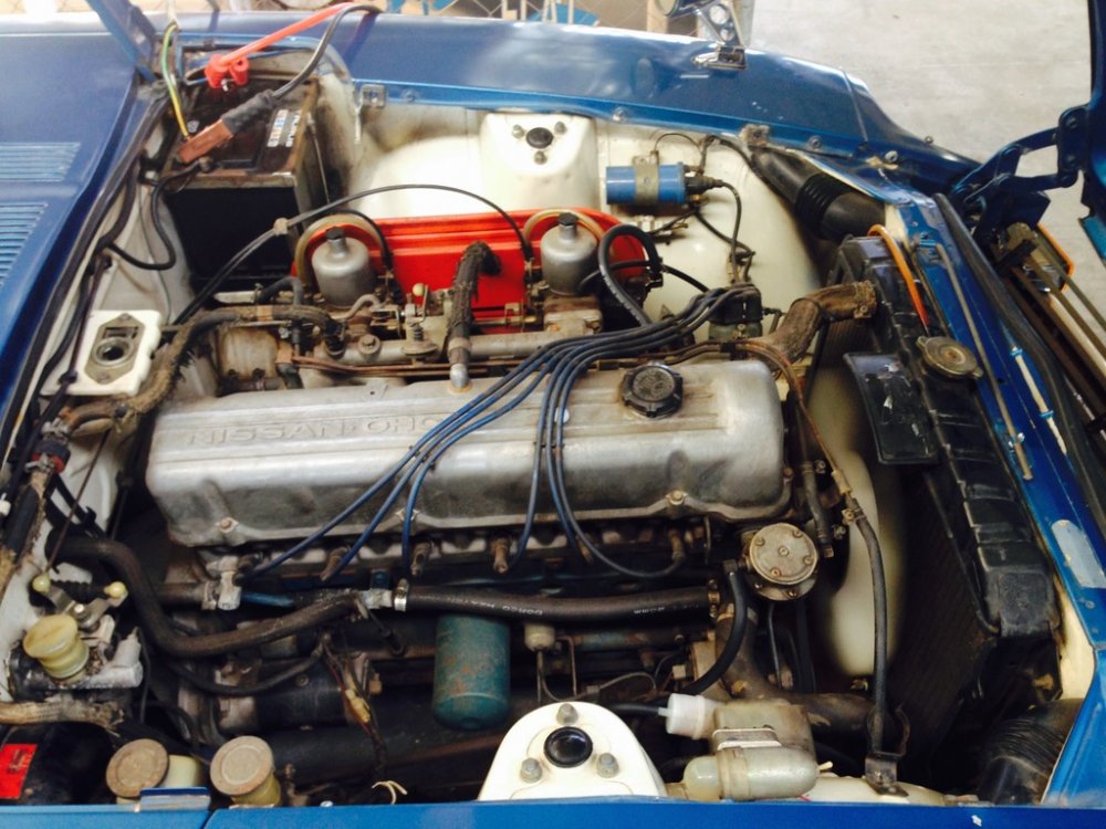

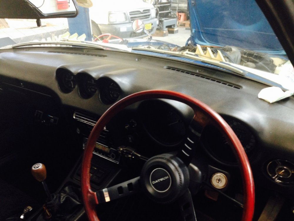

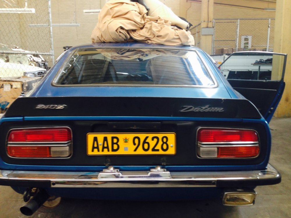

Classicman Posted July 29, 2015 Posted July 29, 2015 I took these photos in May went I went to Zimbabwe to purchase the car. It has been standing in the warehouse for many years, and the elderly gent in the photo is the second owner. The story goes like this. The car was first sold in the UK in 1974 and was white. The new owner obviously didn't like the colour and painted it blue, but left the engine compartment white . After about a year, Andrew bought the car and shipped it to Harare, Zimbabwe. From 1975 till now he has covered a genuine 43,000km in the car. He went so far as to strap foam on the pedals, so the pedal rubbers would't wear out! The car is very original and even the rubbers are still soft. It will obviously need a repaint, and herein lies the dilemma...... Do I repaint in original colour and clean the car up as an original car with patina, or do I do a nut and bolt on the car? Comments? Quote
74zzz Posted July 29, 2015 Posted July 29, 2015 if its lead as charmed life as it sounds.... why do a nut bolt? its very clean as is and if the aesthetics are already brilliant just repaint and keep it well maintained........ do a nut and bolt when the sale prices are somewhat close to recouping a fair chunk of money spent:) with cars im a little like a house, dont over capitalise unless you are gonna live in it forever:) Quote
GongZ Posted July 29, 2015 Posted July 29, 2015 I like the colour of the car as it is now (but that may be because mine is metallic blue too ). Are the rear turn signal lenses red (like a US car) or amber (a trick of the photograph)? Quote
Classicman Posted July 29, 2015 Author Posted July 29, 2015 No, they're amber. I-phone photography :-) Quote

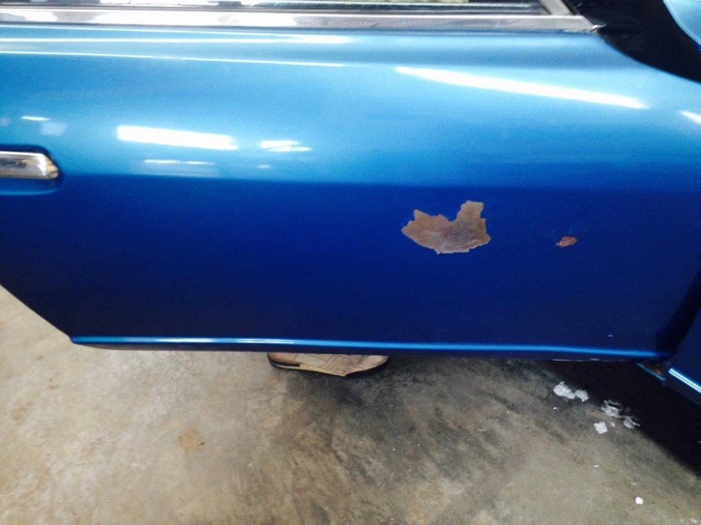

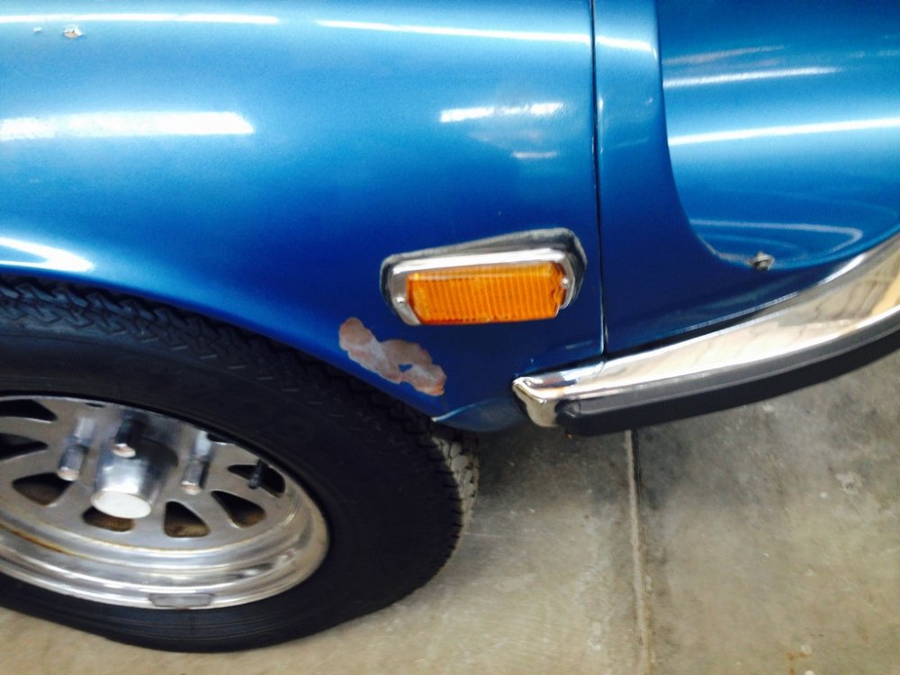

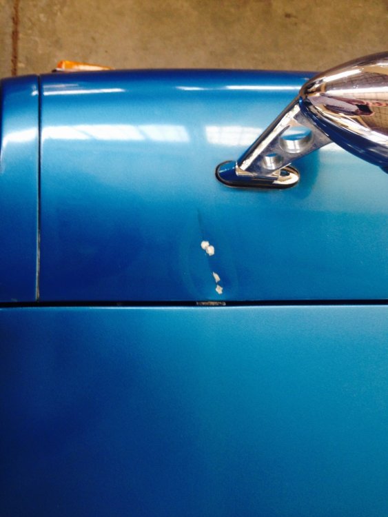

Classicman Posted July 29, 2015 Author Posted July 29, 2015 Gilltech, the problem is that the blue paint job was done in 1974 and although acceptable at the time, hasn't aged well. It is peeling in some places, so will need to be redone anyway. I must admit, I like the blue, and if I am to do a total repaint, would love the Gold, but I'm a purist, and if it came out of the factory white, then will probably err on that side. Having said that, and looking at recent posts of white cars, they don't look half bad :-) I think I will revaluate when the car is at the panel shop. If I can get away with stripping, painting and a good clean and polish of all the original parts, I may go this route. Quote

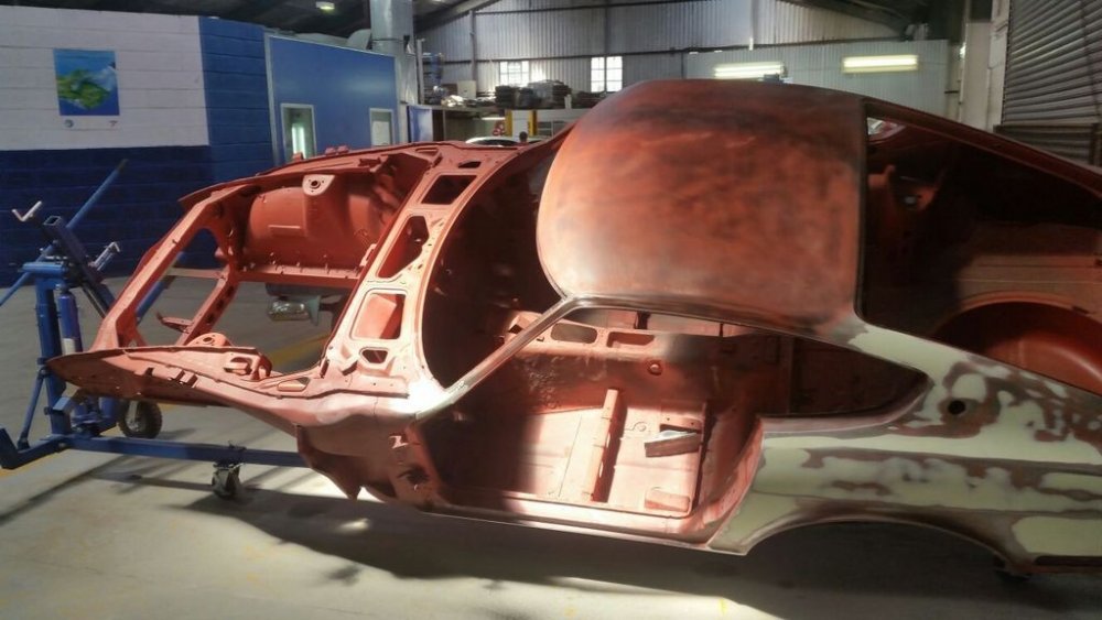

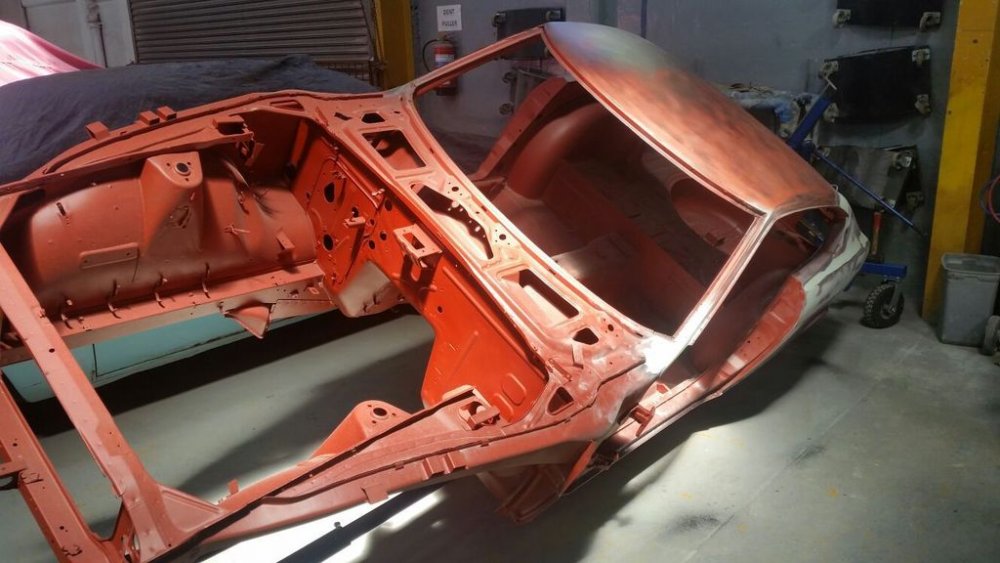

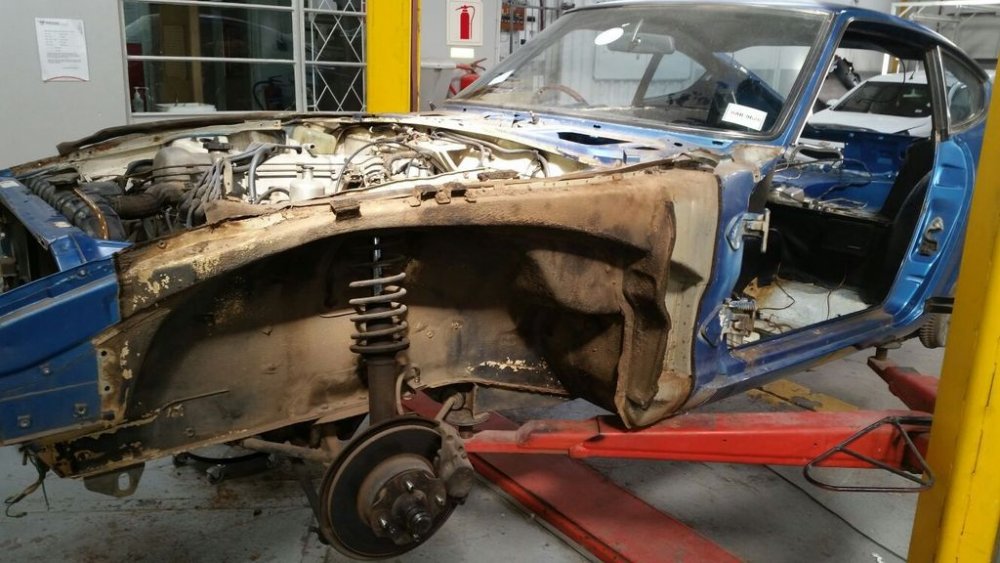

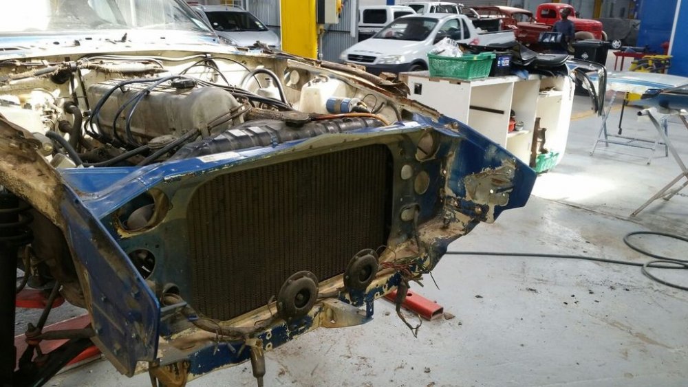

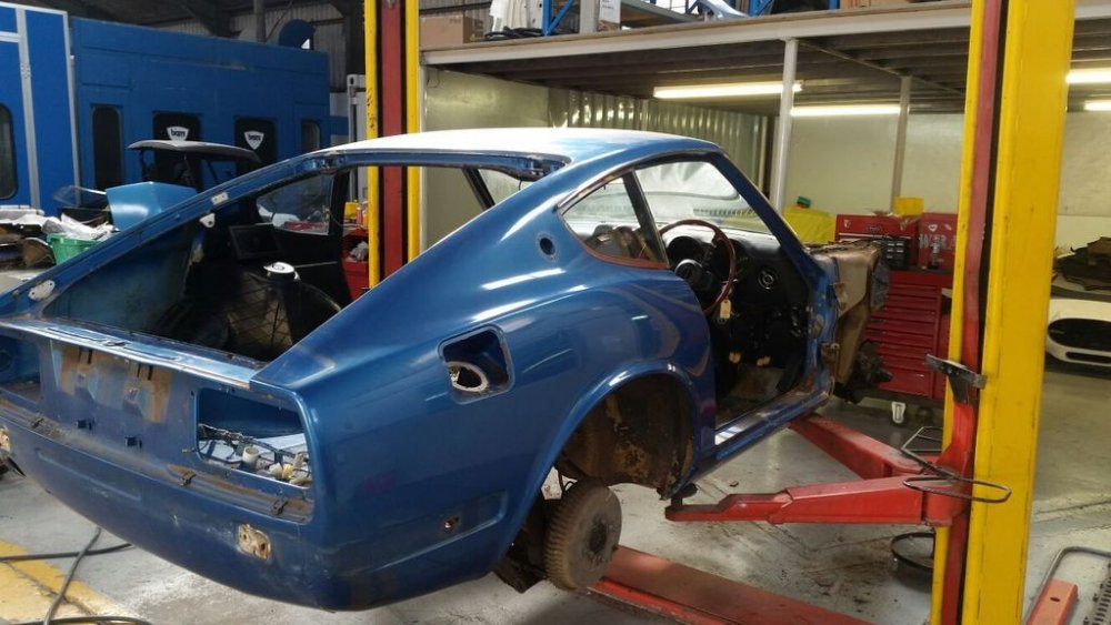

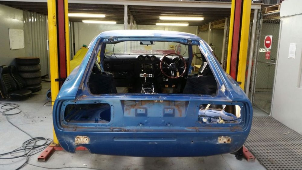

Classicman Posted October 5, 2015 Author Posted October 5, 2015 I thought I'd update everyone on this car and its progress. We have stripped it down completely and the car is very solid with no rust to speak of. During the course of this week, we will chemically strip all of the paint off until we get to bare metal all over. My colour choice has been narrowed down to Safari Gold or Lime, going to have to decide this week. Here are a few photos so far: [/url Quote

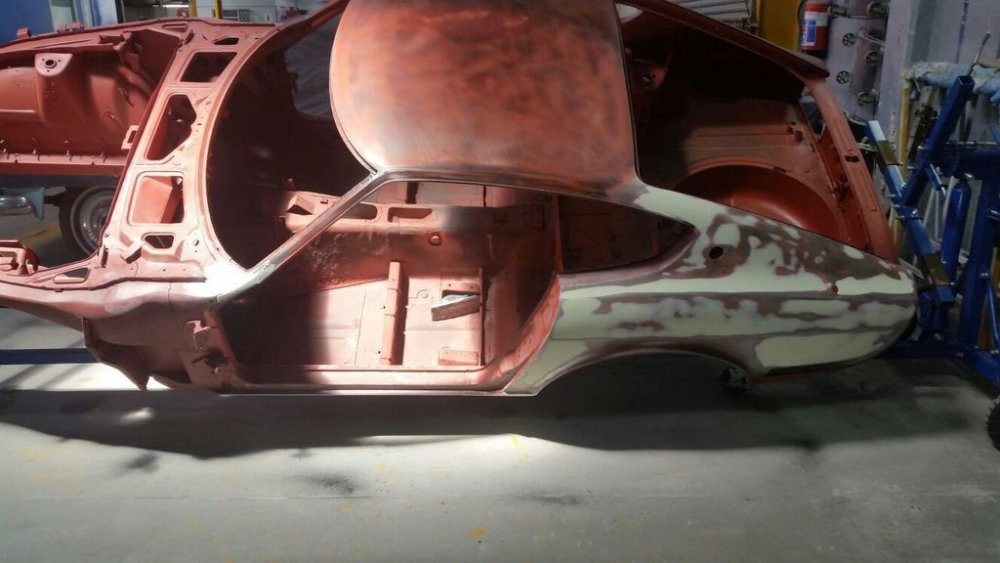

Classicman Posted October 28, 2015 Author Posted October 28, 2015 So, now got all of the paint off and the car is now on rotisserie getting prepped for paint. Dyson 1 Quote
Classicman Posted October 29, 2015 Author Posted October 29, 2015 The bodywork will be finished and primed today and the car fully resprayed by the end of next week. Gav240Z, you'll be pleased to know that I have decided on Safari Gold, so by the end of next week, I should be in a position to post a few photos of the shell in its new livery :-) I just confirmed an order with ZStore for $4,000 worth of parts to do justice to the new paintwork. The car is not going to be concourse, but near as dammit. The plan is to have the car full completed by the second week of December and on a ship to land here by the end of January 2016. I cant wait! gav240z 1 Quote
