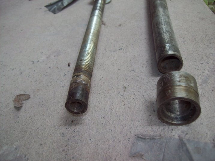

Riceburner Posted April 17, 2015 Posted April 17, 2015 I bought a spindle pin puller tool from Hybridz. I broke off one threaded end on the first pin, the puller has two ends and screws onto the threads, I reversed it and used very carefully. Got both pins out using the tool and a 300mm shifter. I may still have it floating around if anyone wants to try it, or get it copied. Quote
dat2kman Posted April 17, 2015 Posted April 17, 2015 I bought a spindle pin puller tool from Hybridz. I broke off one threaded end on the first pin, the puller has two ends and screws onto the threads, I reversed it and used very carefully. Got both pins out using the tool and a 300mm shifter. I may still have it floating around if anyone wants to try it, or get it copied. Could you put some pics up of it? Ta! I've done a ghetto one using builders threaded "booker" rod, drilled and tapped at one end, and use a bit of 400 mm long larger tube over it, a washer and nut on Booker rod at other end, but, after ripping out the tapped thread, 3 bloody times, i carefully placed it at the far end of the shed, via airmail,,,, It probably would be better with a larger diam length of Booker rod, with the internal tapped end heat treated for a bit more strength?? Quote
Riceburner Posted April 18, 2015 Posted April 18, 2015 i carefully placed it at the far end of the shed, via airmail,,,, LOL! I've used that same shipping method many a time. I'll have a look for it and try to put some pics up. It sound similar to the one you used. Quote
PeterAllen Posted April 18, 2015 Posted April 18, 2015 This was made a long time ago with bits of scrap so I'm not sure if the step inside the small sleeve is necessary. You just need to apply grease on the sliding surfaces. The key to all this is patience - a message I posted before but ignored - soak the spindle in penetrating oil for a week. Half transmission oil and half acetone. Aircobra. I notice you are seeking a lot of advice but you are NOT a donating member!!!!! Quote
