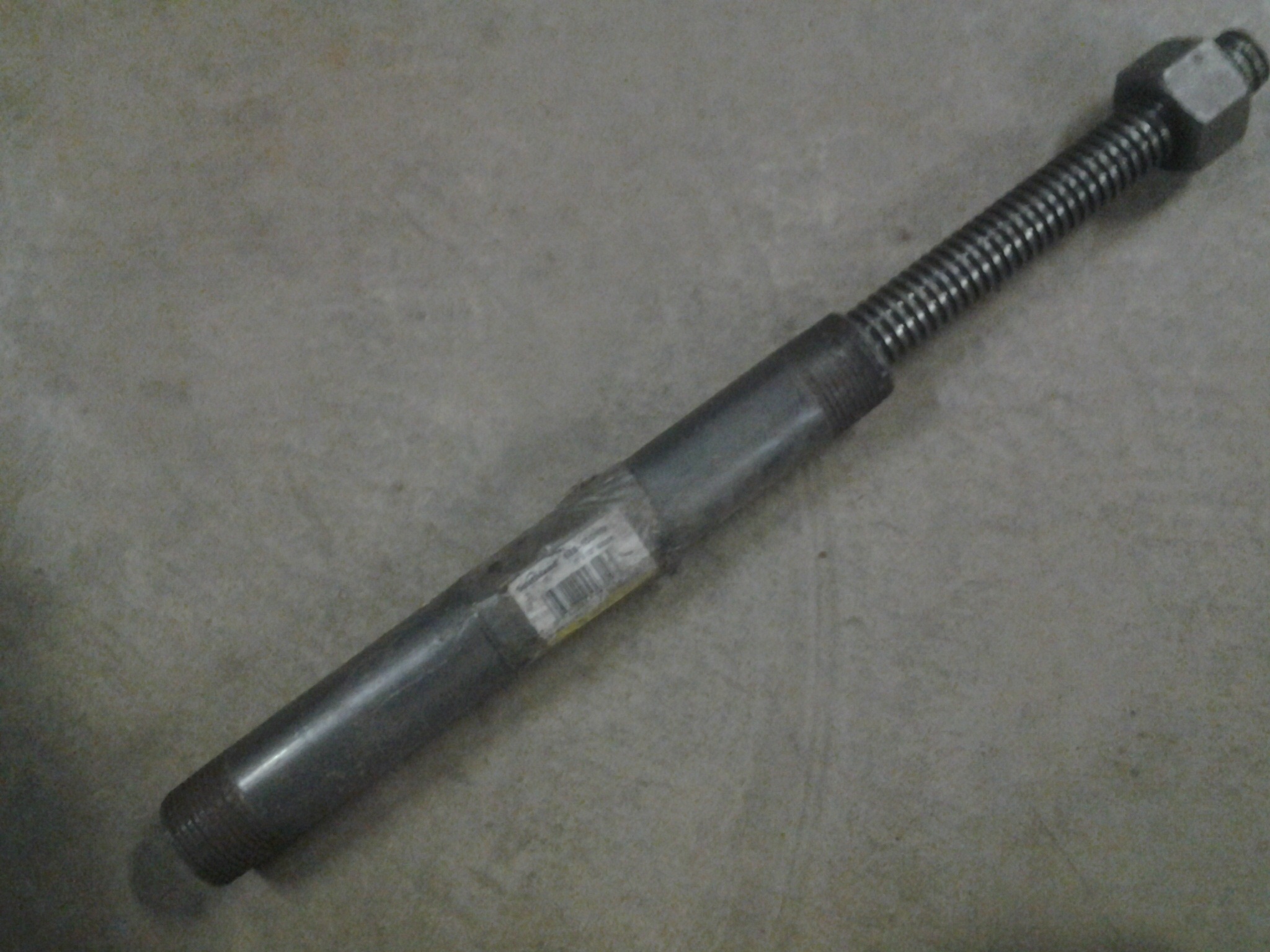

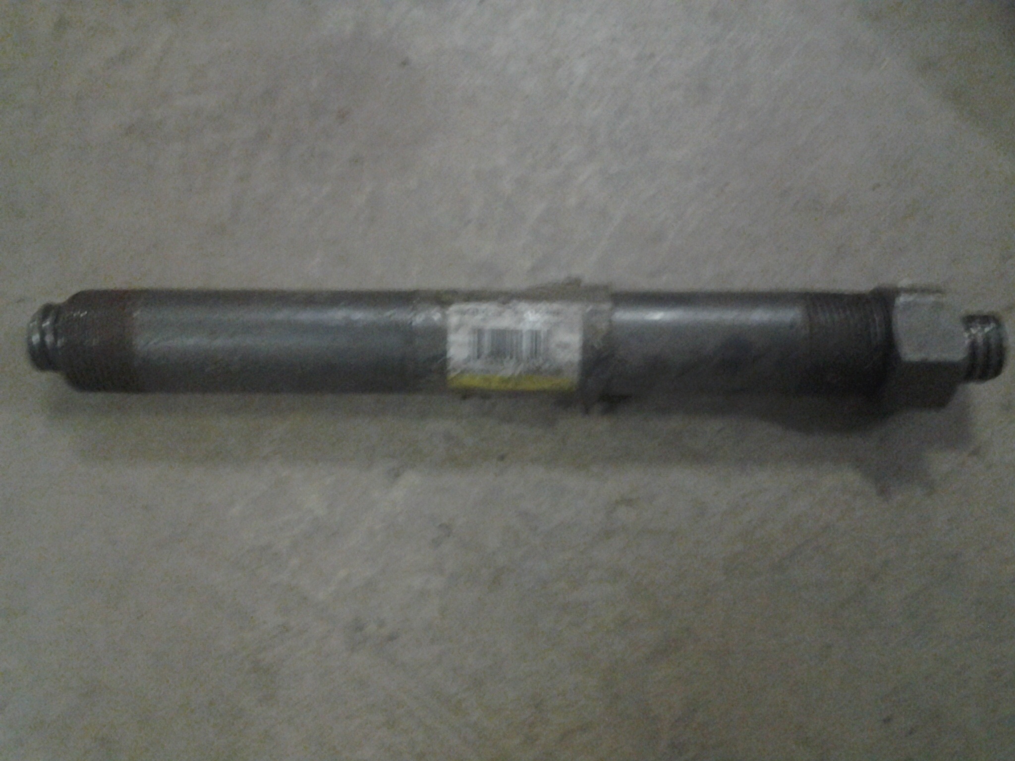

Riceburner Posted April 19, 2015 Posted April 19, 2015 Here's a few pics of the pin puller. The inner rod has threaded holes at each end, they go on to the spindle, the outer tube slides over the top and the nut tightens against it. Quote
