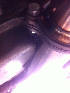

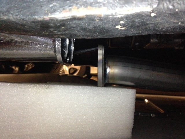

C.A.R. Posted November 14, 2015 Posted November 14, 2015 (edited) resurrecting this topic. every car I've owned has had a shop made exhaust and always without fail I end up with a droney unbearable system and spend time and money changing muffflers adding/changing resonators etc etc. You got to an exhaust shop and they're all experts but really they know crap especially if you have something different. On my Renault Clio Sport I have an English aftermarket sport system with 2.5" pipes. It drones, but not too bad. I wanted to eliminate it totally so I contacted Di Filipo exhaust in Melbourne after seeing a new type of resonator they had. They replied with "Your system is too big" and didn't try to sell me something that probably wouldn't work. So getting to the point. Big single systems will drone. A 2.5" system on a Z will drone. You can play with mufflers and resonators to reduce it, but it will always drone and without fail at 100-120km/h on the freeway. Twin systems such as the Fujitsubo Legalis R is the way to go. Looks good is well made and won't drone. LEGALIS-1.jpgLEGALIS-2.jpg You've obviously never dealt with a professional performance exhaust builder... And you've made some big assumptions in your post, too. I've built many 2.5 & 3 inch free flowing systems for Zeds in at LCR now, mostly made from stainless mandrel bends using quality stainless Mangaflow mufflers. Neither size 'drones' at any given RPM range - most are actually TOO quiet & more induction noise is heard when driving...! I'm more than happy to demonstrate this point by taking people for a ride in a customer's Zed fitted with one of these exhausts, at any time The Fujitsubo system is fine for a stock Zed, but there is no way I'd call it a performance exhaust. There is also fitment issues with it... It's horses for courses, but there are issues to be aware of... Edited November 15, 2015 by Lurch ™ Quote

HS30-H Posted November 16, 2015 Posted November 16, 2015 The Fujitsubo system is fine for a stock Zed, but there is no way I'd call it a performance exhaust. There is also fitment issues with it... It's horses for courses, but there are issues to be aware of... The above post could do with a little bit of context expansion. If all the Fujitsubo 'Legalis' systems fitted as badly as whatever it is that's illustrated in your photos, they - quite simply - would not sell. So what's the story? Quote
C.A.R. Posted November 16, 2015 Posted November 16, 2015 (edited) The above post could do with a little bit of context expansion. If all the Fujitsubo 'Legalis' systems fitted as badly as whatever it is that's illustrated in your photos, they - quite simply - would not sell. So what's the story? The story is Alan, that on this car, it did not fit well. Edited November 16, 2015 by Lurch ™ Quote
HS30-H Posted November 16, 2015 Posted November 16, 2015 The story is Alan, that on this car, it did not fit well. That's a soundbite, not a story. Looks to me like the car didn't fit the system, if the photo of the rear panel is anything to go by... Quote

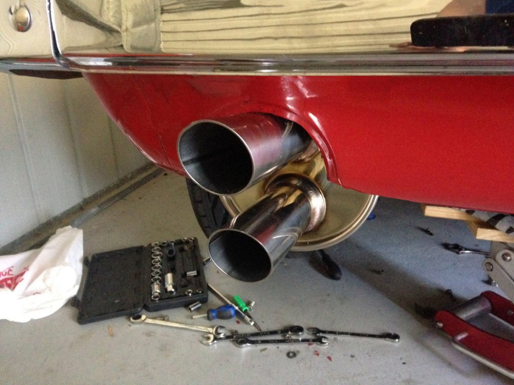

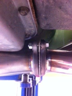

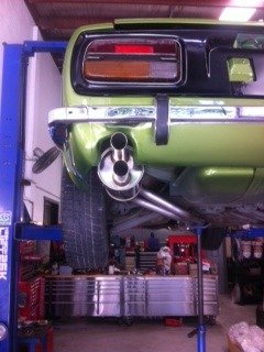

andyk_79 Posted May 4, 2016 Author Posted May 4, 2016 Confirmation that what Lurch said above about the Fujitsubo Legalis system and fitment has rung true for me. After sitting in my garage for about 18 months they were finally getting fitted up this week and have had an email that the intermediate pipes foul on the auto trans and need to be modified. With what I paid plus shipping to Aus and now $300 to $500 to modify (they're being cut and re-bent) - a custom system would have been a cheaper option. Headers and rear section fit well (need to get a new heat shield fabricated but that was kinda expected). Pictures tell the story: Quote
HS30-H Posted May 4, 2016 Posted May 4, 2016 Confirmation that what Lurch said above about the Fujitsubo Legalis system and fitment has rung true for me. After sitting in my garage for about 18 months they were finally getting fitted up this week and have had an email that the intermediate pipes foul on the auto trans and need to be modified. With what I paid plus shipping to Aus and now $300 to $500 to modify (they're being cut and re-bent) - a custom system would have been a cheaper option. Headers and rear section fit well (need to get a new heat shield fabricated but that was kinda expected). Question: Did you purchase the Fujitsubo system in the belief that it would work with the auto trans? Was that a question that was specifically asked? I've got no horse in this race (I don't have a Fujitsubo system) but it seems to me that they have a reputation for being well made and of fitting properly. The occasional anecdotal evidence of bad fit seems to be down to, ahem, other factors... Quote
andyk_79 Posted May 4, 2016 Author Posted May 4, 2016 I take your point, however on a bog standard S30 it is not a question that I thought to ask for a product marketed as a product for all S30 models - No caveats in their product info etc. Quote
HS30-H Posted May 4, 2016 Posted May 4, 2016 I'm pretty sure I remember seeing a caution note in their information for this system, saying that it doesn't fit Auto trans equipped models without modification. Japanese companies are usually quite scrupulous about this kind of warning, as consumer laws are so much in favour of the customer over there. Quote
Cozza Posted May 4, 2016 Posted May 4, 2016 and now $300 to $500 to modify (they're being cut and re-bent) Might not be the right solution for you but I would be spending the $300 - $500 on a manual conversion rather than bending an expensive piece of kit to suit an auto. Just my 2c Mick Quote
