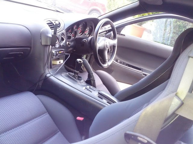

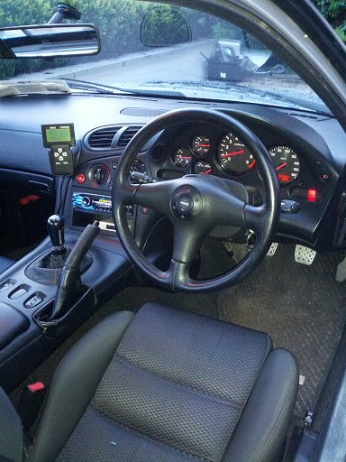

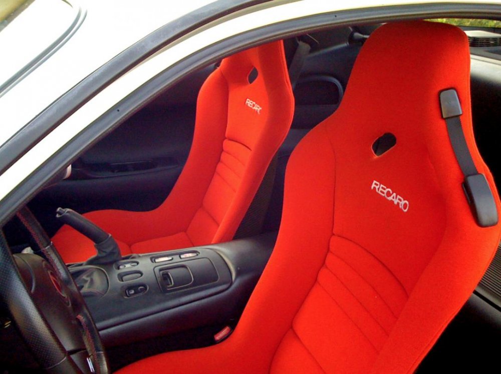

Administrators gav240z Posted May 19, 2014 Administrators Posted May 19, 2014 Hey mate, The standard FD seats are quite good, I like them and I think they would fit well, since both the FD3S and S30 Z are very narrow in terms of seating and so you shouldn't have door card rubbing issues etc..They are a good trade off between bucket seat and every day suitable seat. The only downside is that they are quite heavy and would need a re-trim to suit the S30Z interior look etc... A really great seat and what I have in my FD is the Recaro's RZs with Tilting Rail Function. The benefit of these is you get a fixed bucket seat that can be adjusted titled forward / back and slide forward and back etc.. It is now hard to get into and out of the FD but it is a good compromise and best of both worlds. The only problem is these seats are very expensive - even second hand in shagged condition. They come in black and red. To my knowledge I don't know of any other bucket seat that has a tilting function like this? I've often thought about taking them out of the FD and putting them in the S30Z and putting the normal FD seats back in the RX-7, since they would fit in the tiny S30 cabin. If they were not so damn expensive I'd buy another set. Another great feature is the seat belt strap so you don't have to fish for the belt behind you, although if you go a harness this is a moot point. A guy has replicated them here: http://www.angrypandafactory.com.au/ But he is having issues getting the rails sorted and I've been waiting ages for him to replicate the rails so I can buy 1. A similar seat to the Recaro RZ (Spirit R Type A) seat is the Recaro Pole position seat, (Mossy) - Mark had these in his orange S30Z and they looked good, but he swapped them for some Datsun competition bucket seats. You could re-trim them to have the Datsun style vents in them like this 432 appears to have had done. The Recaro seat shape etc.. would suit the S30Z in my opinion. I've been looking at the Datsun bucket seats since I really like the look of them, but you need the headrest for sure. The only downside is comfort wise they might not be great. A similar seat to those is the 432-R buckets like seen here: Think they are the same as the old Rally cars had. Where would you get them? No idea. I think Alan T (HS30-H) had some copies made a few years ago if I recall what he said correctly? I have a set of reclinable Recaro's in the 72 240z, they are comfortable but they look too big and chunky for the S30z and I want to change them in the future. I like the period look as you can probably tell, even if it means a trade off in comfort to some extent. Quote

Administrators gav240z Posted May 19, 2014 Administrators Posted May 19, 2014 Lotus Elise seats could be another option (although I don't know what they cost). http://clubroadster.net/vb_forum/89-roadster-projects/18571-sharka-build-2.html#post352791 It is difficult to find seats that are narrow enough for the S30Z. The standard FD seats are good, I drove all over Ireland in them and never really felt tired or sore once it was properly adjusted. I sometimes consider putting the stock seats back in since they can be reclined. But I have to say the RZ Recaro's I've got are a really good compromise between a serious track seat and daily driver seat. Only downside is price, but most aftermarket seats are expensive. You may find the stock seats quite good if re-trimmed and the foam support restored. Quote

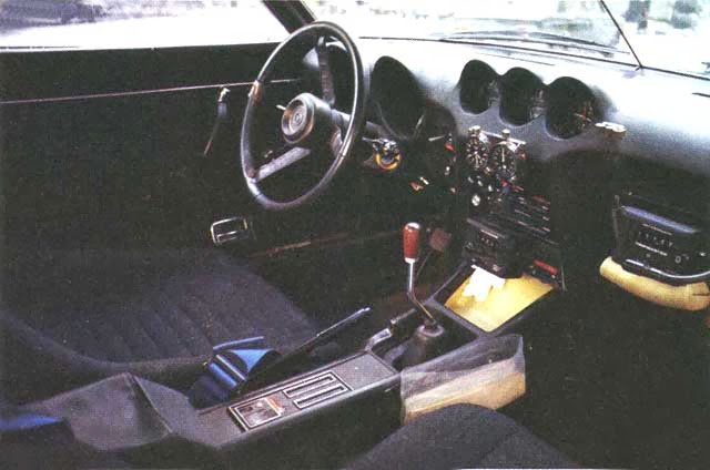

DreamZproject Posted May 19, 2014 Author Posted May 19, 2014 Yeah, still interested in adjustable seats, but those elise seats are amazingly thin hey! I actually have just completely restored and refoamed my 240z seats and they look shmick, I just think that they would still be a little too squidgy for my liking. Yeah I'm certainly over 5'6" and over 60kgs Luckily (i guess) my rails are gone, so i have the luxury of being able to fit things that are a tad taller than most. Has anyone tried the S2000 seats I'm fairly keen on them so far. Also any thoguhts on any of the cheap end sports seats; Autotecnica fake recaro's etc.? Quote

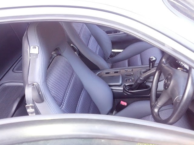

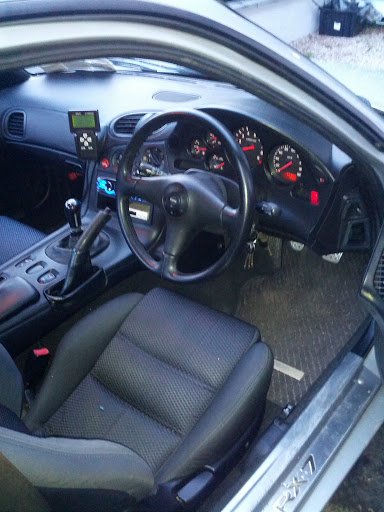

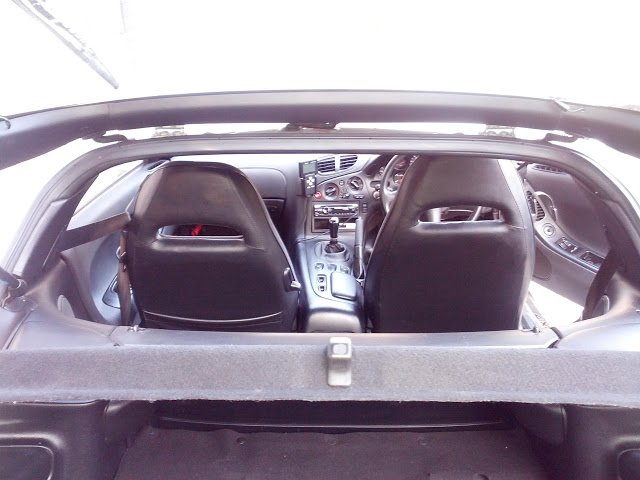

Administrators gav240z Posted May 19, 2014 Administrators Posted May 19, 2014 I'd almost swap you those 240z seats (sure they're not 260z ones?) for my FD RX-7 ones but I have the early 240z style seats and I'm not sure they would be what I need? This is what my FD seats look like, they are the carbon style (pattern) ones. Quote

cracker Posted May 20, 2014 Posted May 20, 2014 I've just bought FD seats to go into my 240z (in almost perfect condition too ) and though I've only done a very quick trial fit, they look like they will fit quite well and at 6ft tall and quite slim I find them very comfortable. I can't vouch for them fitted, though from the reading I've done they are excellent, but for sitting a touch high (though if you are fabricating custom mounts you will be able to account for this easily). Gav mentioned they are quite heavy but I've weighed them and they come in at EXACTLY the same weight as my stock 240z seats. If memory serves correctly, zedevan (I think?) has installed them and is very happy. There are photos somewhere. James Quote
Administrators gav240z Posted May 20, 2014 Administrators Posted May 20, 2014 Gav mentioned they are quite heavy but I've weighed them and they come in at EXACTLY the same weight as my stock 240z seats. Compared to the Recaro bucket seats that came in limited edition FDs they are heavy. It's all relative to your expectations LOL...but I suspect not much heavier than stock 240z seats like you say. Quote
