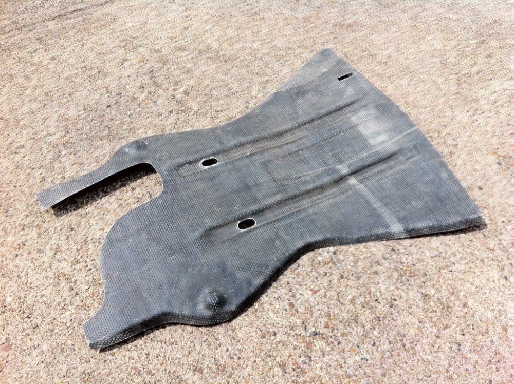

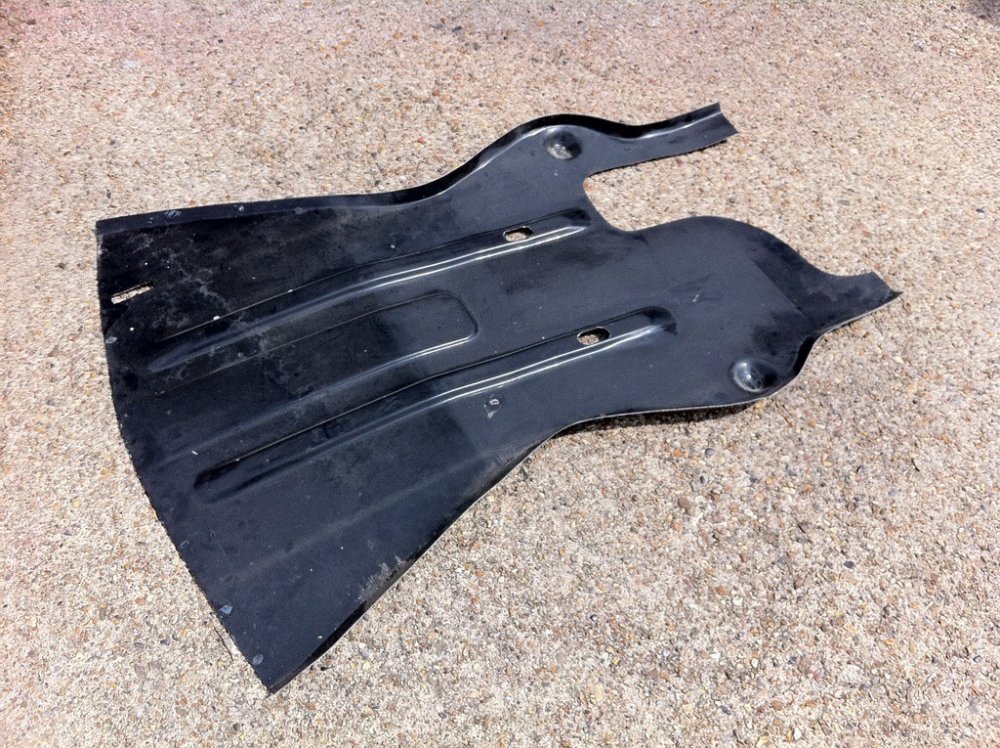

HS30-H Posted July 25, 2014 Author Posted July 25, 2014 However, a couple of parts did arrive from Japan last week. Although I was glad to finally receive them, the shipping bill (they were sent freight collect) made me blow a fuse or two. One of the items was packed standing upright on a wooden pallet when it could have been laid flat or just sent as-packed. To add insult to injury the consignment was sent by Express air freight.... Just a quickie: Here's the aforementioned item. You'd think it would be common sense to pack it nicely and send it flat, wouldn't you? Instead it was packed and strapped to a wooden pallet standing up.... WTF? Quote
Administrators gav240z Posted July 26, 2014 Administrators Posted July 26, 2014 I still can't work out what it is. It looks like a floor pan but I'm guessing it is some kind of undertray? Quote
Moderators PB260Z Posted July 26, 2014 Moderators Posted July 26, 2014 Hmmm, never ceases to amaze me how some people pack stuff. Once had a turret arrive at work in the bottom of the pallet of parts Quote
Riceburner Posted July 26, 2014 Posted July 26, 2014 It's the extended under tray or belly pan that's unique to this model. I take it these are VERY expensive? Quote
HS30-H Posted July 26, 2014 Author Posted July 26, 2014 It's the extended under tray or belly pan that's unique to this model. Yes, it's the 98200-E7200 'COVER-under' for the 432-R. Black side faces down, with the woven roving side facing up into the engine bay. I take it these are VERY expensive? Yes, and quite hard to get. But not as expensive as the bloody shipping was..... I should have taken a photo of it on the pallet. Defied belief. gav240z 1 Quote
