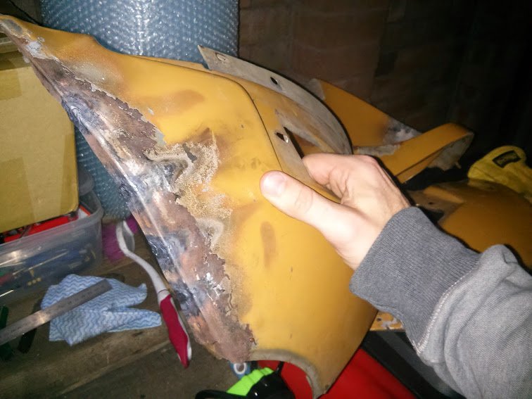

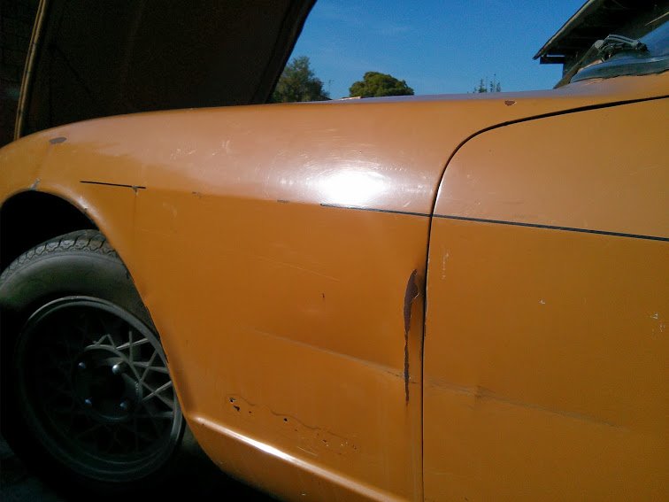

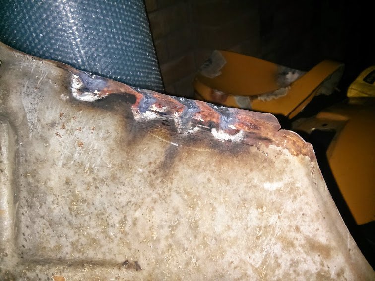

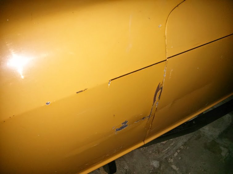

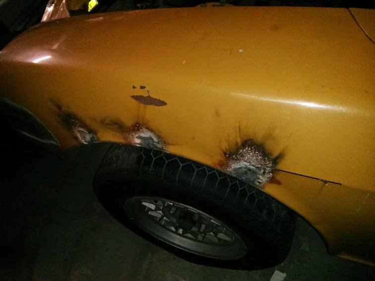

The passenger fender had cracks along the lip from rust. So welding this up was a pain, I managed to get some of the way there with it, but the metal around the area was really thin due to the rust and so it kept blowing holes. So a bit of help from 1 of the gentlemen at the tafe course and all good now...
There is also a dent as you can see here:
It's been mostly straightened out, but it will require heat shrinking as the metal has stretched and is a bit floppy now. I haven't used a heat shrinker yet so I'll be sure to describe how it works when I do. Should make it nice and toight like a toiger.
The edge of the panel also got pushed in because the door would open and catch on the leading edge. Here is a before photo to show you the difference.
It still needs further 'dressing up' as they say...

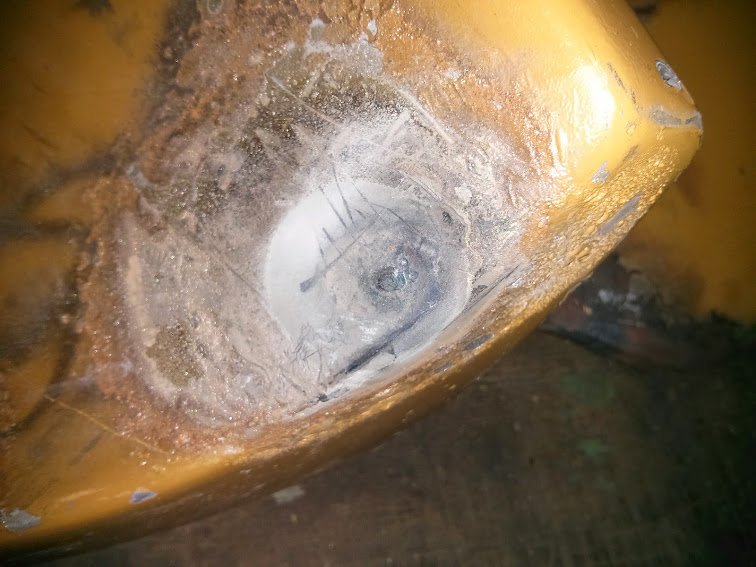

Looking at that sugar scoop on the car you'd have never known it was hiding all that bog.

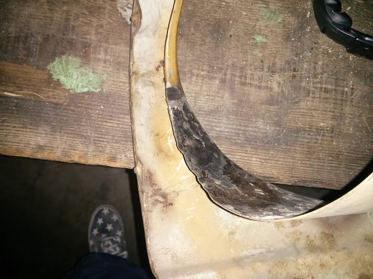

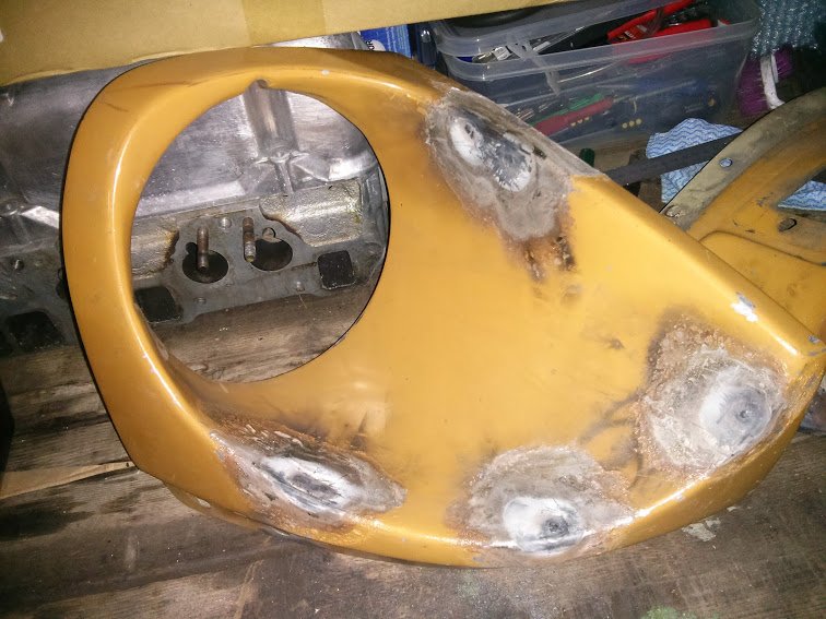

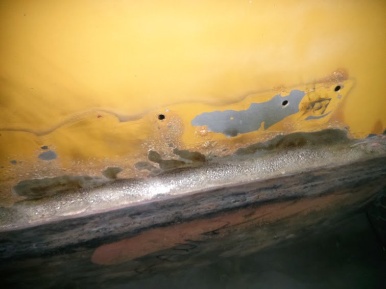

But once removed and I looked on the underside I could see something wasn't quite right, so I expected when I stripped the paint back to find something like the above. What is weird is the area the damage is, I still can't quite figure out how that happened? I think it was a really bad rust repair attempt? Anyway I should have another good condition scoop on the way soon to replace it, I'll use this for future practice or if anyone wants it let me know?
Here is another bit of dressing up, the lower valance panels are actually quite good. But again the edges had stress cracks from rust. Since these panels are quite expensive to source in good condition they are worth fixing.
The lip on this corner is actually folded flat, but I had to unfold it to patch it up and I'll clean up the area and rust proof it then fold it back down again.
The other side is in better shape and only has minor surface rust.

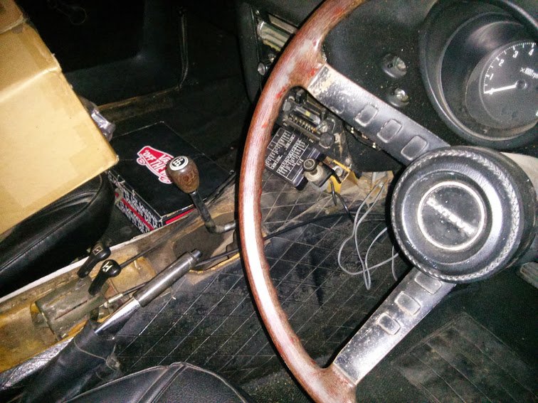

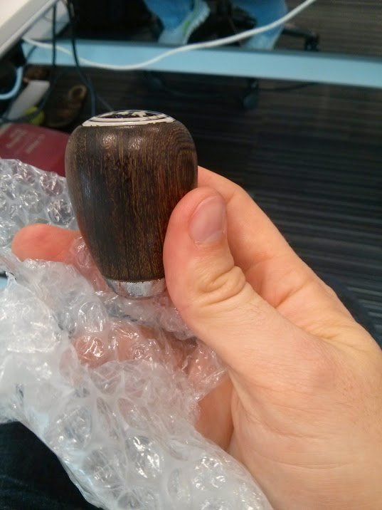

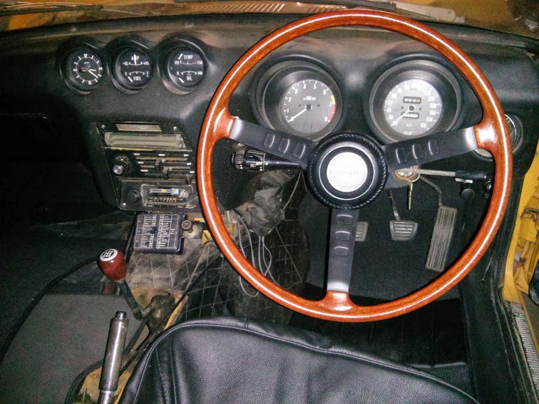

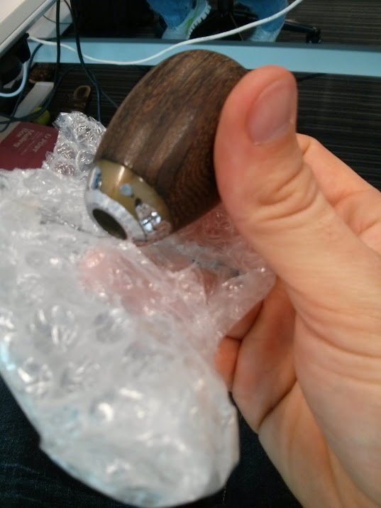

A photo of the 4 speed knob :) - which will get the 5 speed button shortly.
You can see the gear lever is bent backward to accommodate the earlier cars transmission tunnel (71A gearbox) hole being further back than later cars where it moved forward.

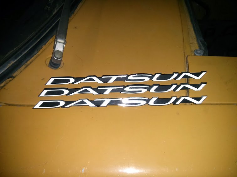

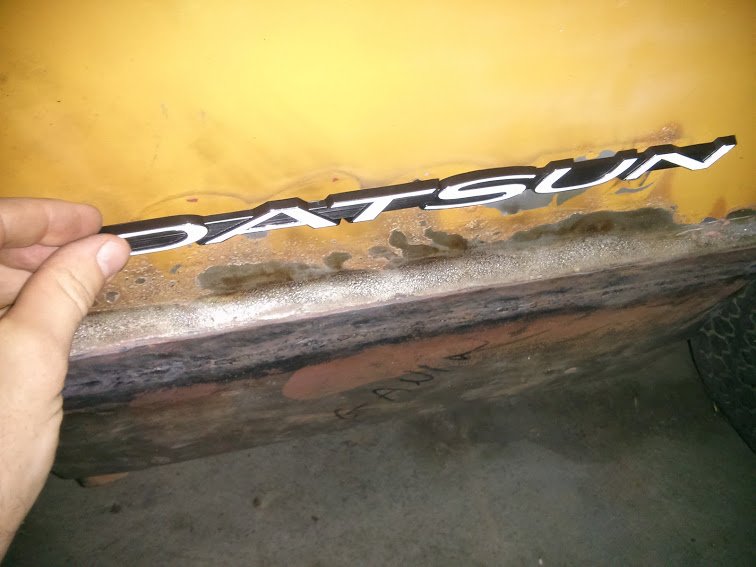

I found 3 DATSUN badges on Yahoo! Auctions at a good price.
I can confirm that the badge holes line up between 260z / 240z guards.
Although I seem to have 1 additional hole that will need to be plugged.

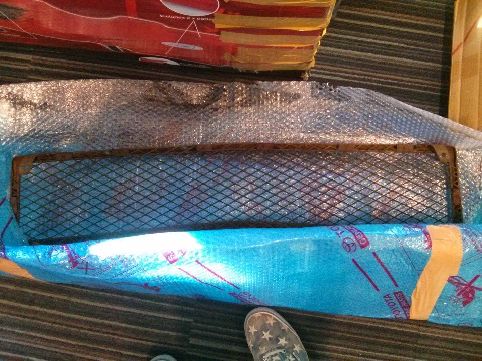

Fairlady Z Grille.
Although she's a little fragile and has some rust etc.., so not sure how I'll approach the repair yet, going to have to be very careful. These seem to be quite rare to find these days also.

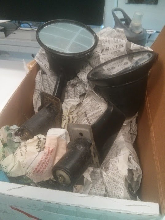

Speaking of Fender Mirrors I found some Fairlady Z ones (long stalks) and just waiting on them to show up now. As you can probably tell I splurged a little this month on some new items. I really should get onto my motor next though and I need to buy a drivers side door skin.

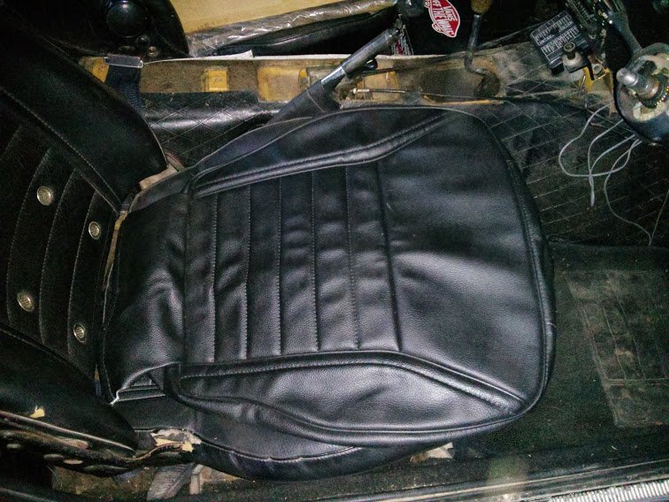

So photos of the new stuff I mentioned the other day.

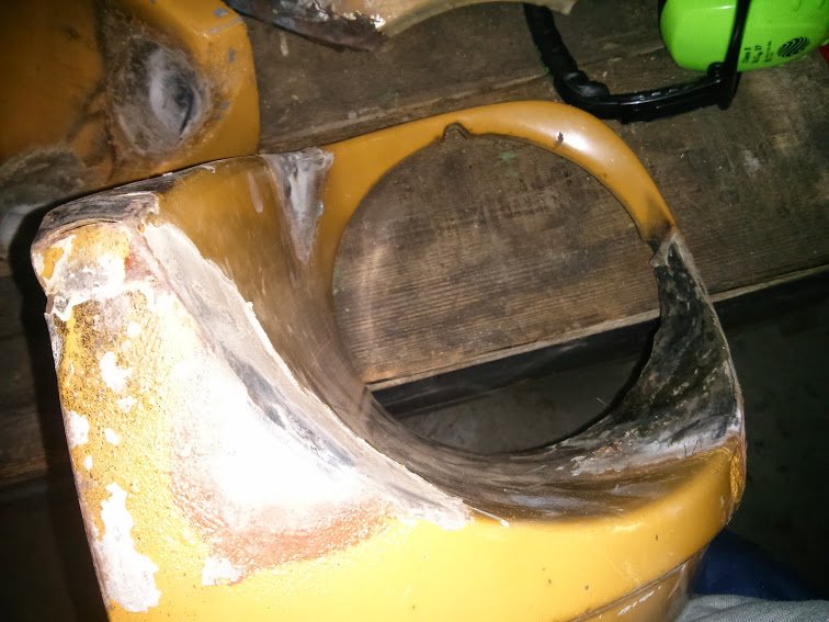

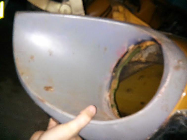

New headlight bucket for the passenger side, this time no bog.
As mentioned I got 2 of everything, when it came to trim (since I'll be doing the 70 and 72 240z's)

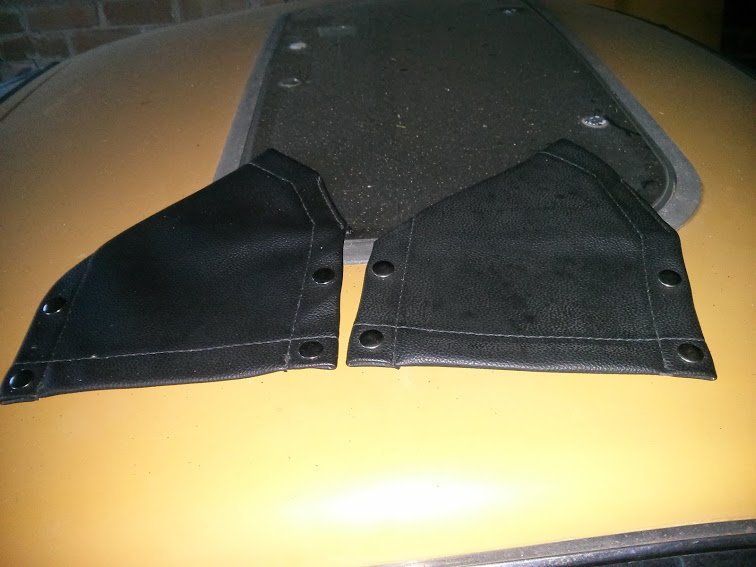

Handbrake boots.

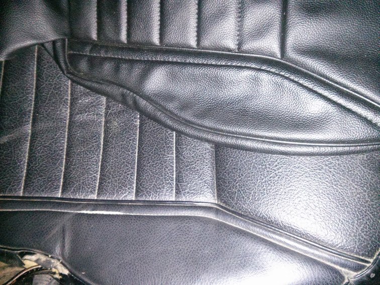

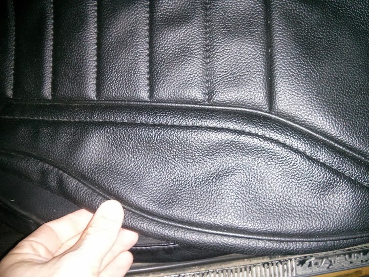

Seat bottom trim
Close up of texture

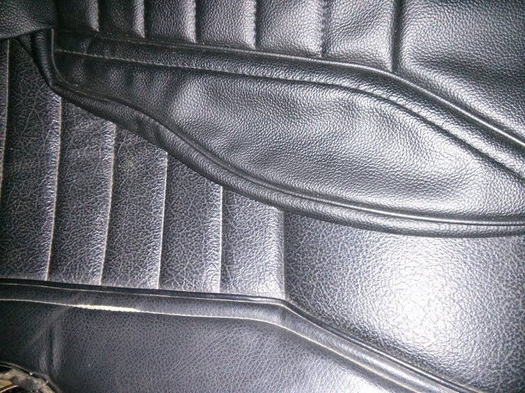

Original vs new comparison

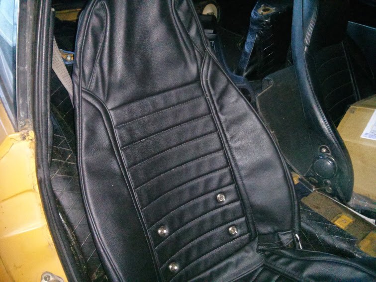

Seat back trim

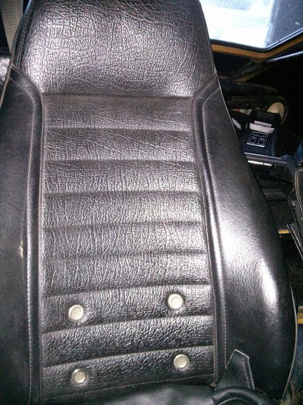

Original
The buttons in the seat backing are slightly different, but you would only be able to tell if you put them side by side. Likewise the grain in the trim is different but I don't think many would notice. Of course I'd probably loose points if competing for concourse, but that's no the point of my restoration at this point in time. Otherwise my console and steering wheel etc.. would also need to be perfectly original and I think I'd rather have the car on the road and enjoy it than have every part OEM and original.
These things can always be changed in future, should I want to go down that path.
The original trims by the way have a few splits - as they be expected and could potentially be patched up and fixed, so I'll keep them for future reference.

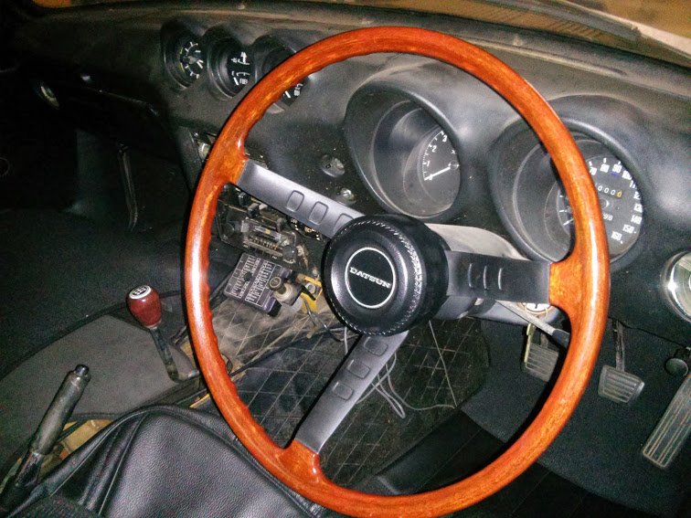

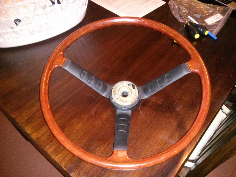

So finished the steering wheel off this evening.
Now to put it on eBay with the title "series 1 240z steering wheel, *uber rare*" and a price tag of umpteen million dollars.
I would like a "Datsun Compe" wheel but I also like the "Bus" wheel as a friend once described it.

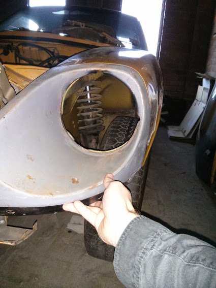

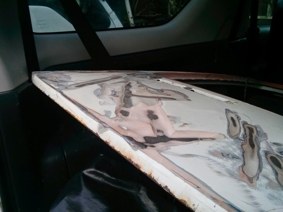

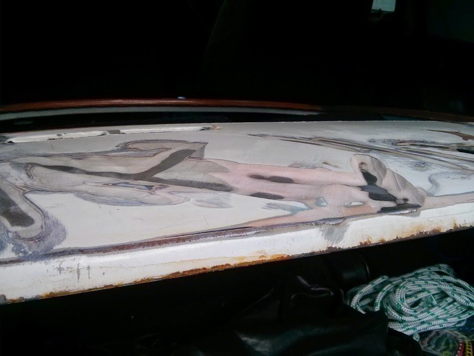

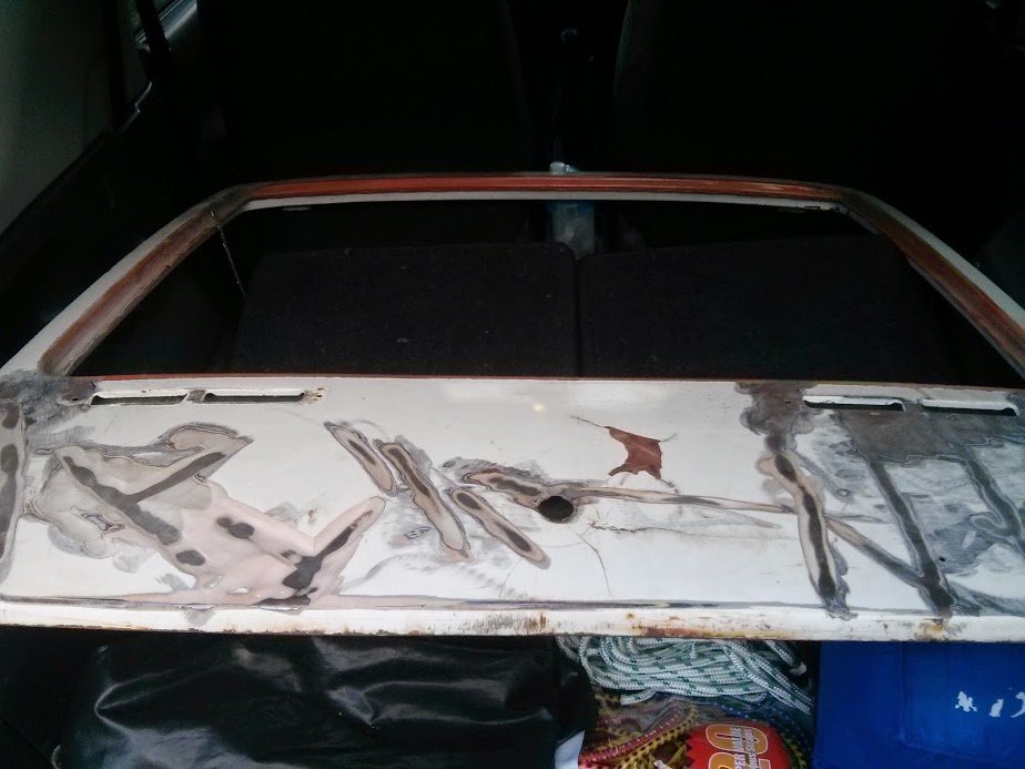

Since my rear hatch has been damaged and bogged up, I thought I'd look at sourcing another. I got this 1 from Mark (Mossy) the other day..
But as you can see someone has spent some time on it already.
And I seem to be thinking this a lot when I see previous repair work.

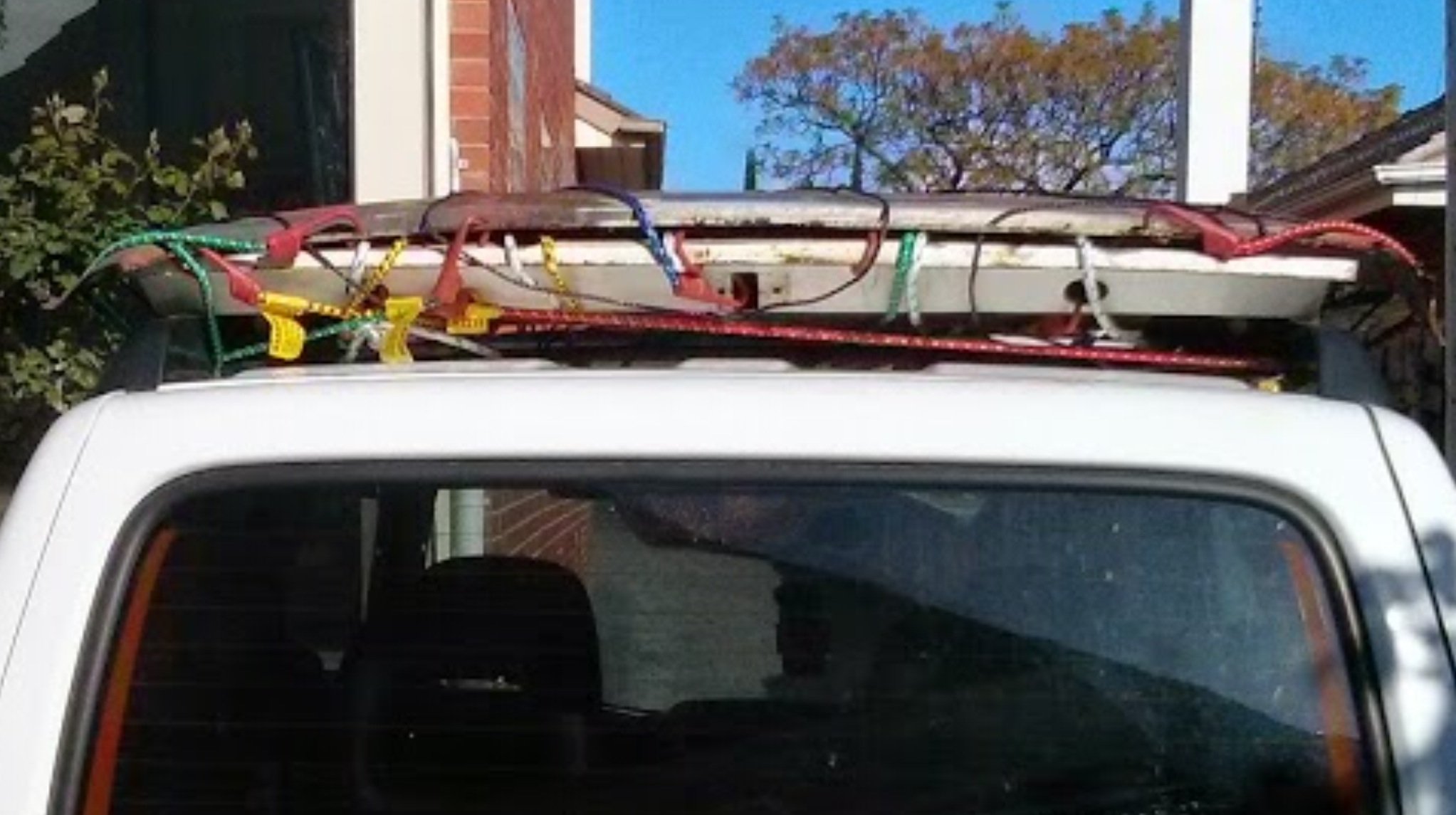

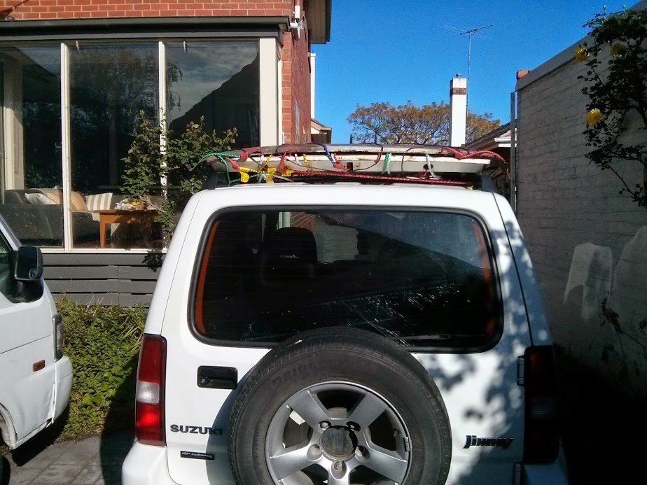

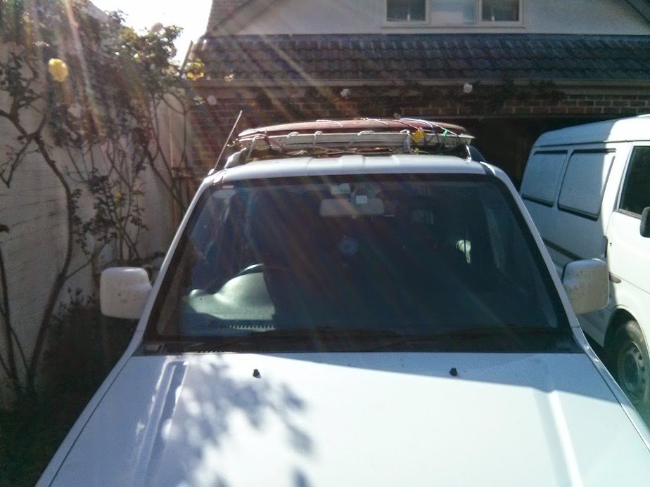

Since I was in Melbourne I picked up some Z-parts I had at my parents place. I got a pair of good condition door cards (Thanks Gareth), a pair of replacement rare spares floors + rails (Thanks Tai) and a roof skin patch panel (Thanks Tai again).
The challenge was packing it all, but onto the roof rack the hatch, roof turret went and floors went into the boot along with the door trims. It was a little nerve racking driving 9.5 hours to Sydney with it all up on there at 110 km/h + high winds but got in last night without issue and nothing moved about. So thankfully I didn't end up on PB260z's thread.
http://www.viczcar.com/forum/index.php/topic,14919.0.html
This is why I got a Suzuki Jimny as a practical car.

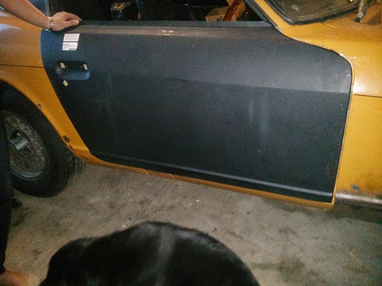

1. If you've been watching the door skin tutorial thread.
http://www.viczcar.com/forum/index.php/topic,4189.30.html
You'll know I've now got the door skin onto the door frame and am in the process of fiddling with the alignment. Sadly someone changed the OEM door fastener bolts for some odd ones and I have a mismatched set on the drivers door. I'll post a wanted ad in a minute as threading them in was encountering some resistance and I don't want to strip the door nut threads.

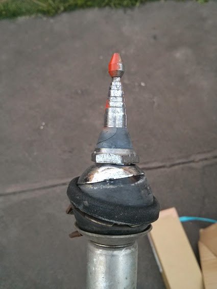

2. In other news I found an 'arrow head' antenna.
See (HS30 00084 - Just love the originality of this car!) http://www.classiczcars.com/forums/check-out-my-ride/46713-my-1970-240z-hs30-00084-a.html
So at some point I'll dissemble the antenna polish it up and re-assemble. As a related note my father had a bunch of books on automotive how-to's that I saved from the bin years ago when his old garage was cleared out. In there is a how-to on rebuilding an electrical antenna. That's what I love about these old cars you can rebuild almost every component, not throw it out.
