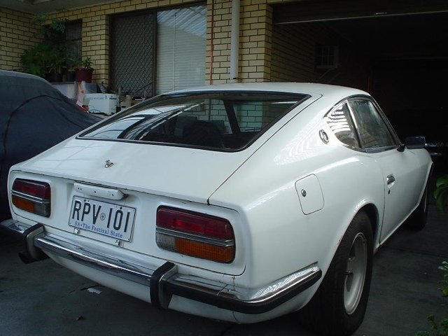

Ever since I got my 2+2 back in 03 and found this forum I learned the differences between 2+2 and 2 seaters, like with most of us love at first sight. I just had to have one.
Eventually I found one about a year latter while still working on the 2+2. It was local with blown headgasket, few layers of paint and quite a few kg of body filler an interesting collection of S1 parts bolted on it.

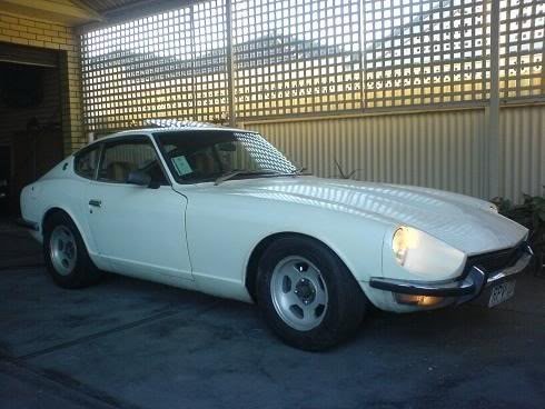

I remember the day when Missus and I ,hooked up a trailer after work to my trusty R31 and went for a 50min trip one way to the hills to pick it up.
When the car was of the trailer under my carport fairly late at nite I couldn't stop looking at it, walking around it, like a kid with his brand new long lusted toy he got for Christmas.

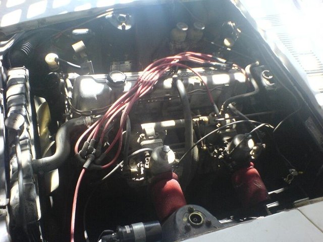

After first failed attempt to get it to run, i didn't notice the rear carby had excess fuel pouring out. She back fired through the carby and the uni filters caught on fire. Flame over 1m high and rising. I jumped out of the car threw an old blanket over it , (lucky only minutes earlier used it as a floor mat to check under the car) ran like hell to get the water hose to put the fire out.
Damage was my heart pounding and melted two uni filter socks. Tip they are dangerous things. keep a fire extinguisher near buy if using them.

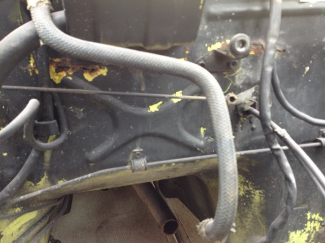

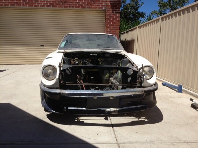

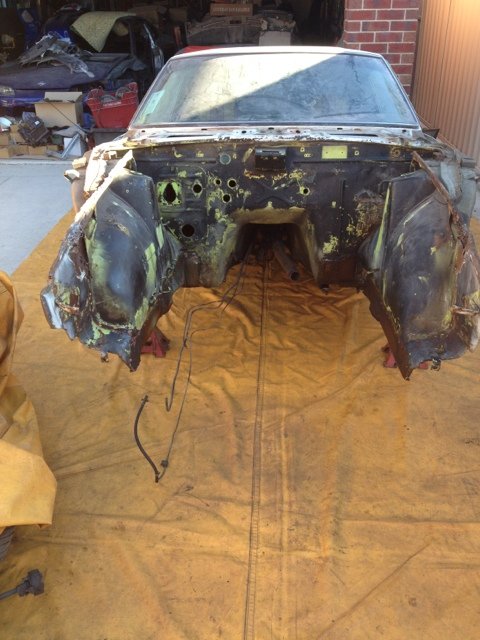

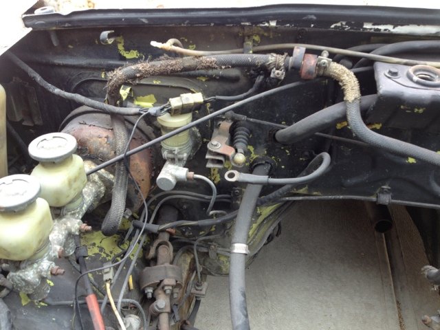

engine bay stripped
Guards removed

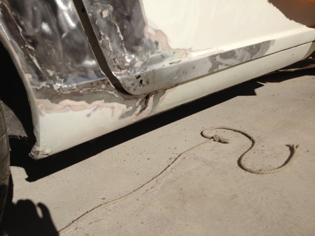

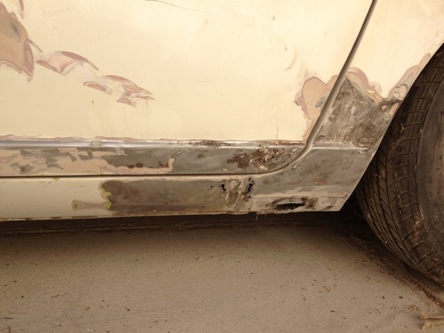

Striped few unknown panels from 10-20mm thick body filler.
This one is going to be at least 20mm overall narrower car than it actually was. and probably at least 50kg lighter. not exaggerating.
the previous dimwits didn't know how to align the doors or repair dents. they just plastered on top of the paint few buckets of body filler and one huge plank to align it all up... Bit of pimp my ride style.
Luckily due to 6 layers of paint and 20mm of body filler seems to have preserved the panels well. besides dents the doors have minimal rust.
Seals are lot better than expected. only outer skin near dog leg needs replacing. dog legs and inner panels are clean no surface rust. Still original primer. (pics to follow)

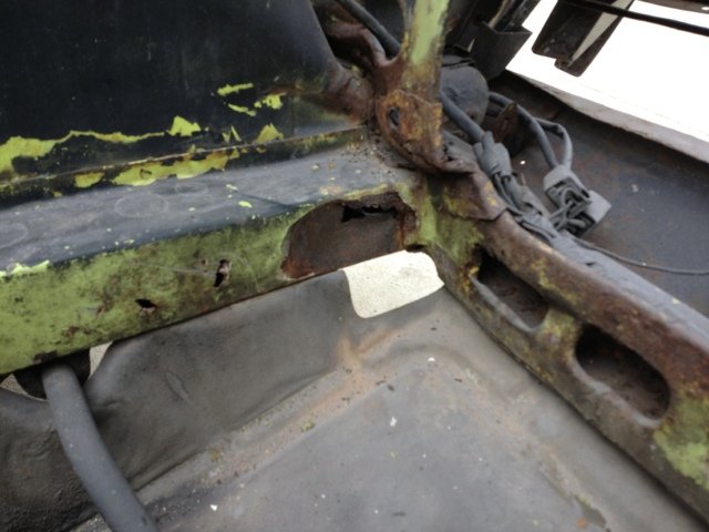

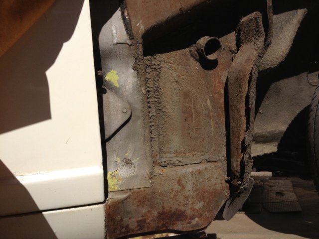

bit of a nasty rust on left rail. But ordered a set from my mate Nato so both rails will be replaced. She needs to be able to take the power of the turbo L series or Sr20det.

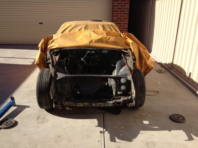

last few days busy buying and picking up parts and eqiupment for the build. not too much progress.

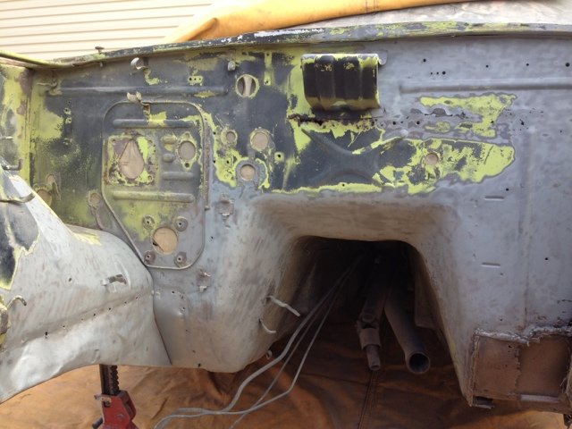

Its pretty much ready for sandblasting and chassis rails replacement.

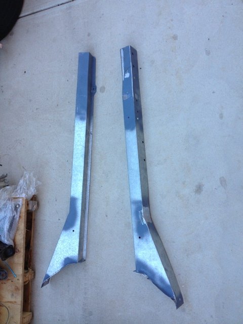

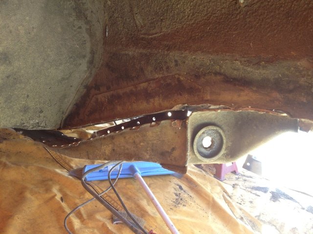

new rails

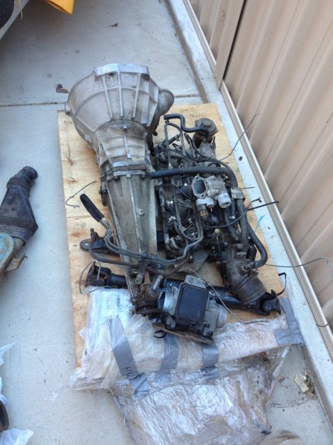

and EFI system from L28. The gearbox is for the early girl.

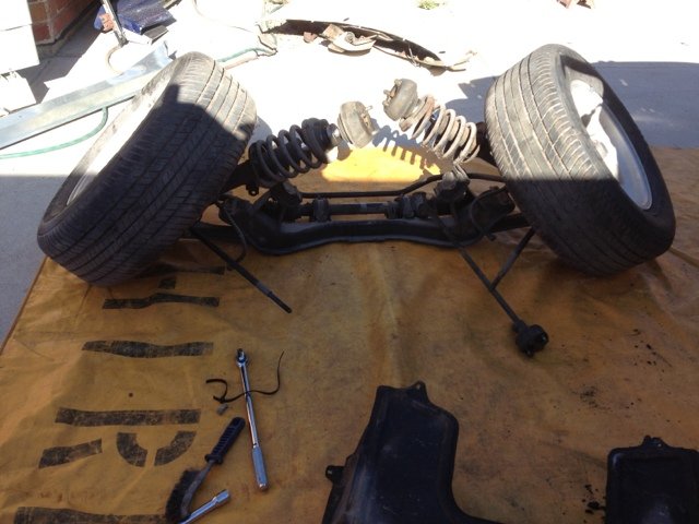

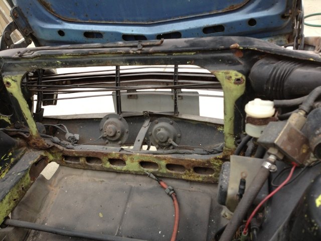

More of deconstruction today than construction.
Guess it has to get worse before gets better.
Some pics.

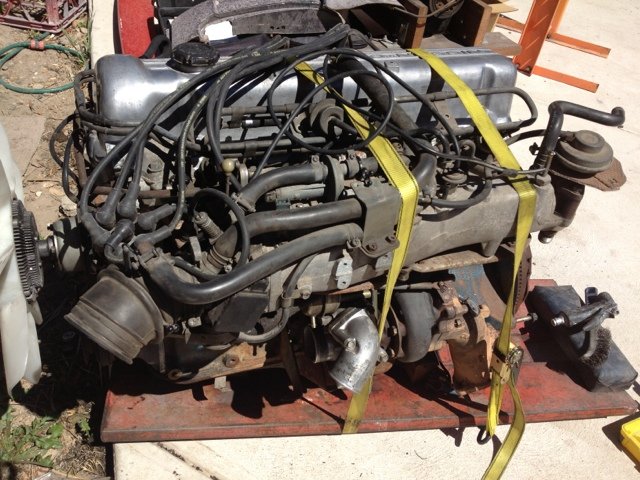

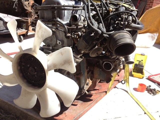

Engine mock up with l26 with efi and turbo straped to it.
Drifters learn this is neg camber hahaha

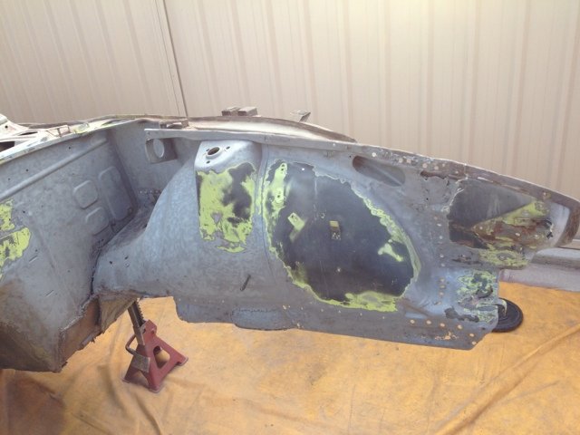

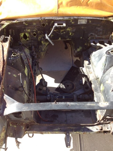

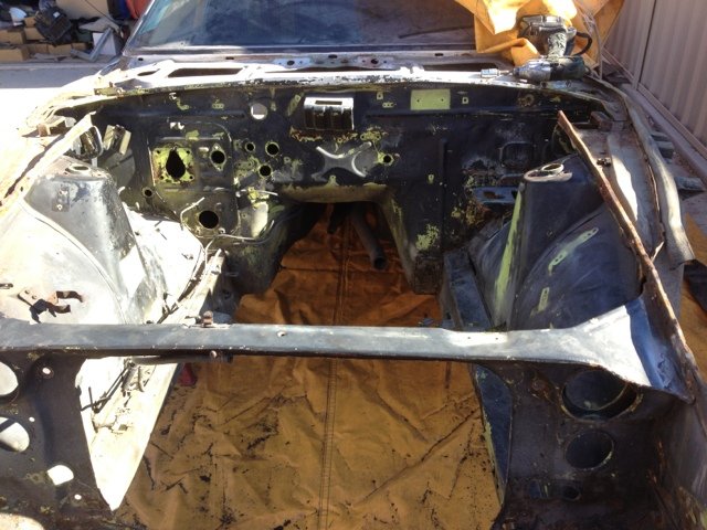

Engine bay stripped
Rail almost off
Both rails and rad support are removed
Tommorow quiet removal of interior before i can make noise. After that blaster gets turned on and attacking the front of the car.
Than hopefully some rust repairs and getting the new rails fitted.

Gareth yeah they Nato's rails. Fit very well. They are lot stronger than flimsy factory stuff. This baby wont have any issues with bigger engines. No messing with this one full steam ahead. Need it on the road by end of March or im screwed.

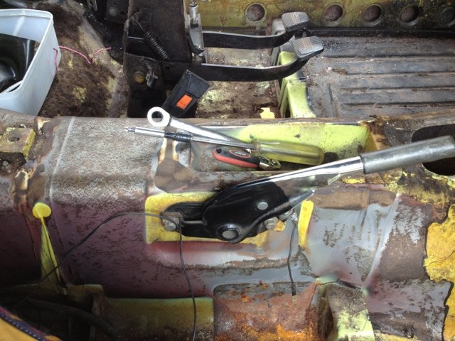

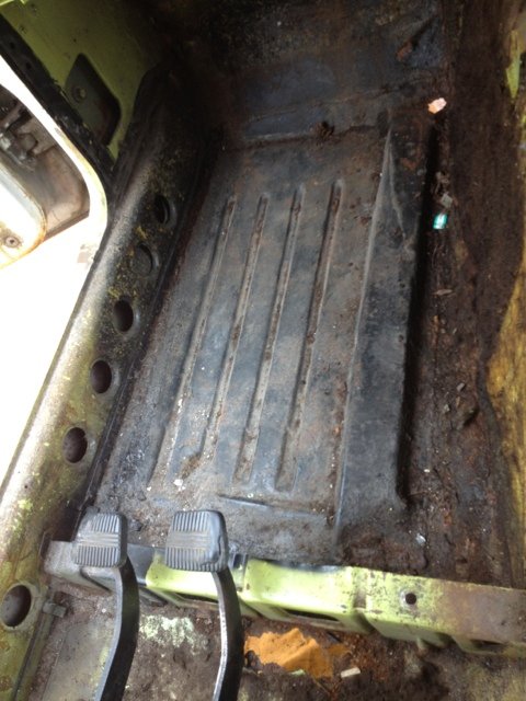

Did manage to remove the seats and dash and some soundeadner. Seem to peel very easy so kept doing it till
it got hard. More than half the tunnel done.
And the ugly previous repaired passenger side. This will be removed.

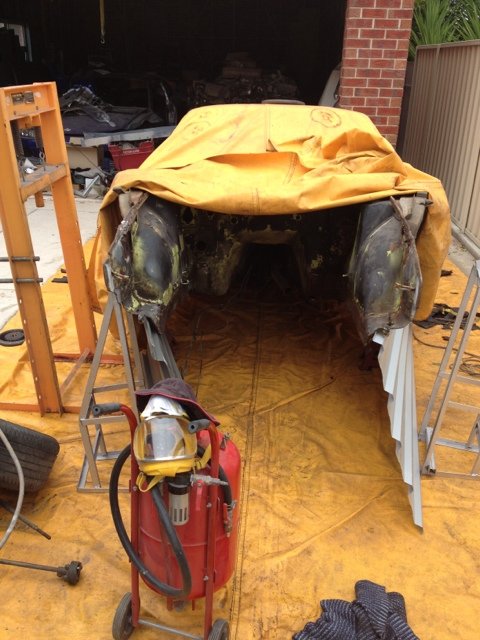

While i started well this morning and was on schedule as soon as 10:30 arrived was going to start the blaster.
But nooooo  >:(  mother nature decided to piss me off and started bucketing. Was soo cheesed off about rain.
2hrs later i went to dry the tarp from water. Put few fence sheets to stop the limited supply of blasting media flying everywhere.
All setup just to put safety gear and hit it.

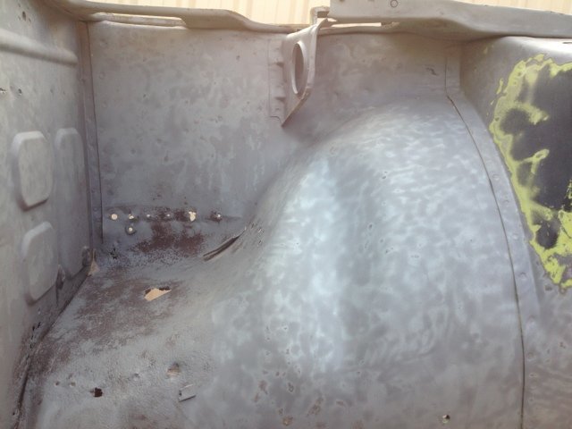

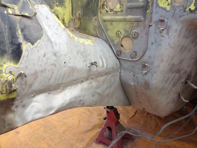

With coarse media was going very well. Bad thing only had small amount of it so run out quick but did sizable area.
Than shifted using fine. Results were good but very very slow.
B5BC10D8-4406-4602-A041-67A0738204BA-181-0000000C78FB6499_zps293e3004.jpg.
Considering late start did ok. If wasn't for rain I probably would have finished 80% of the engine bay.
Oh well tommorow continuation of blasting for few hrs after work.
Though feel like I was all day at the beach with strong winds blowing sand everywhere.

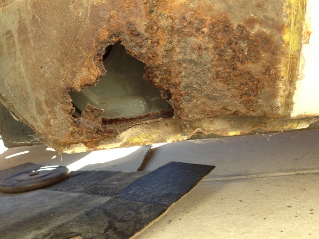

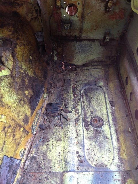

Battery area doesn't see that bad..
After all this effort, I'm sure you're keeping this zed..
Yeah not too bad, does have a hole but easy fixed. More issues below it.

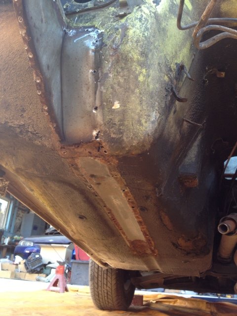

I dont get some people. If doing rust repairs GET RID of the rust than weld a plate over the clean metal if u too slack to flush weld it. Bashing rust in and welding on top just make it worse and problem re appears couple years later.
Anyway due to some retard need to rebuild lower part of the skirt and floor area on passenger side.
Shouldnt be too hard simple shapes.
Still lot more blasting before cutting and welding can start.
