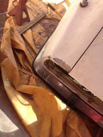

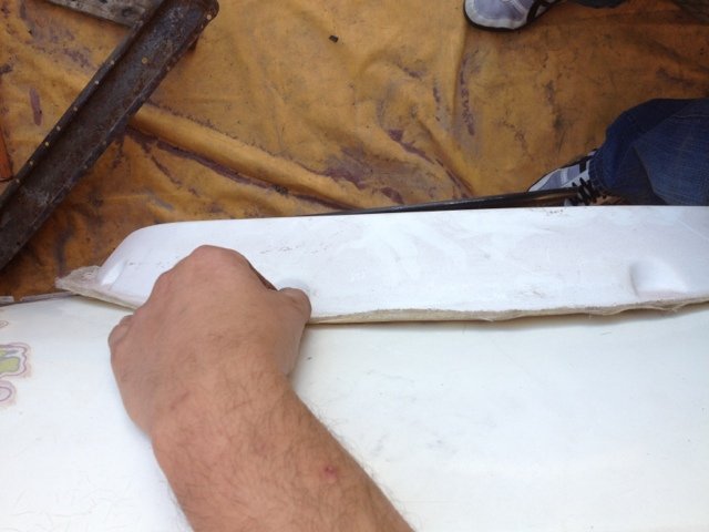

I got my Gnose from them and the type A spoiler as well, quality and fitment is really good, but you will have to drill mounting holes and fit the fixings you require.
I have a few pics from test fitting straight after it arrived. Will post up later.

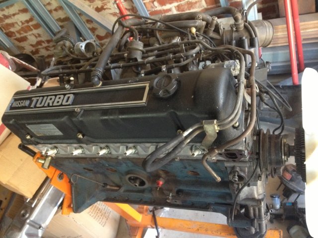

Got the l28 turbo valve cover ex USA not bad on my l28 turbo mock up.

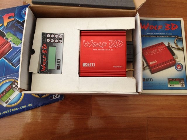

To run the show got v4 wolf rd ecu.

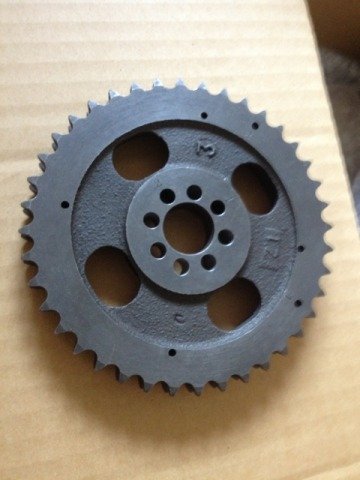

Todays santa delivered me this ex japan l series adjustable cam sprocket. Not sure if needed but sounds cool  ::)

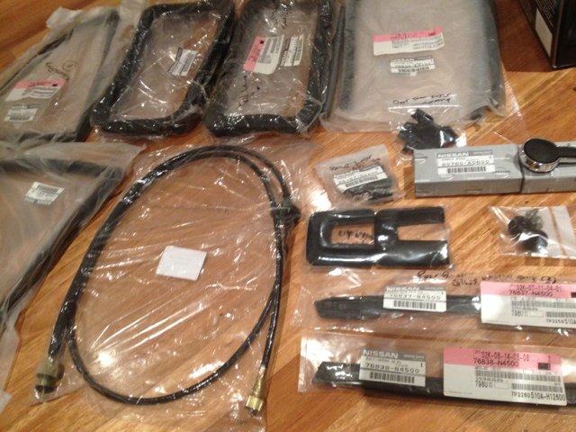

Also in the same package got few other goodies.

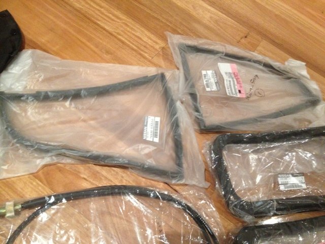

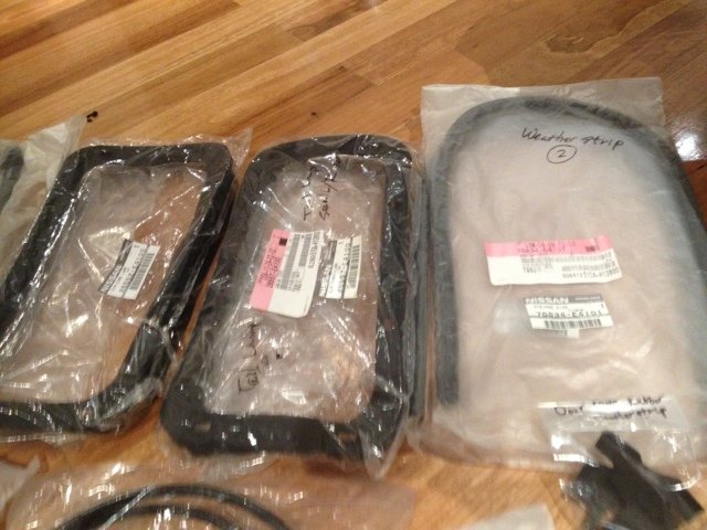

Some genuine weather strip kits
Some second hand gear
Now you prob ask why did i buy that from japan besides the antenna the rest was $30 without postage.

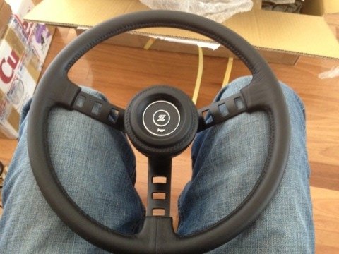

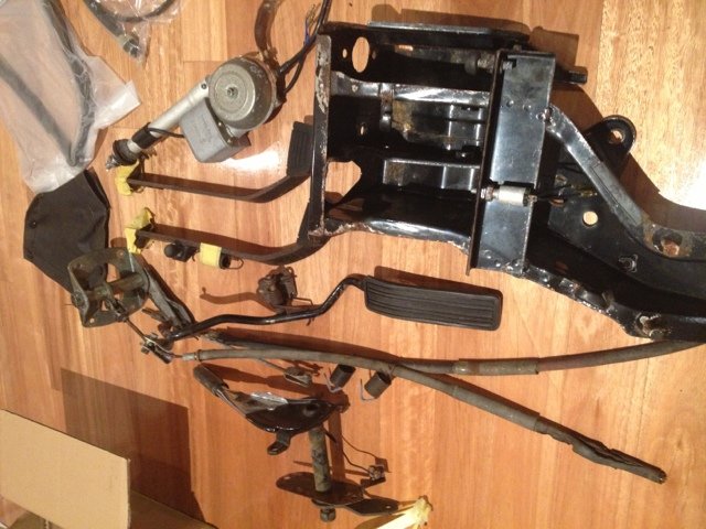

Not bad $12 for manual pedal box lol.
Best for last

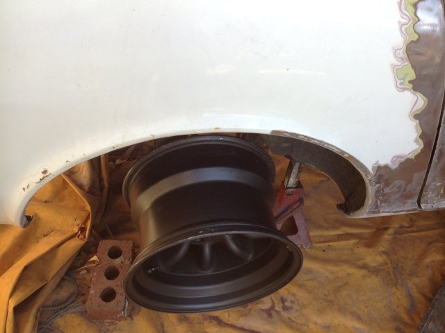

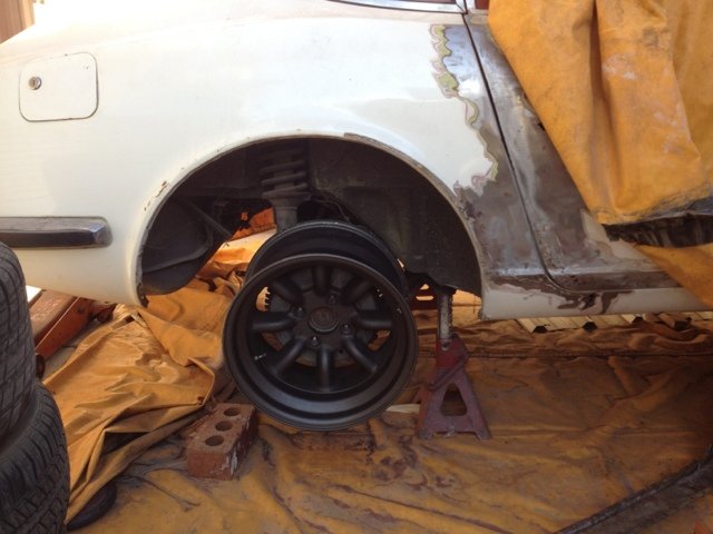

Watanabe have arrived the original classic one from the 70s

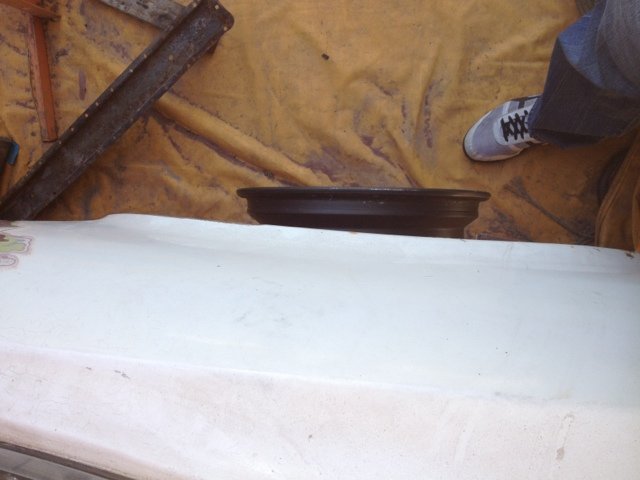

Stick out a fair bit
Add some flares and perfect. Was worried that need wider flares for the wheels.

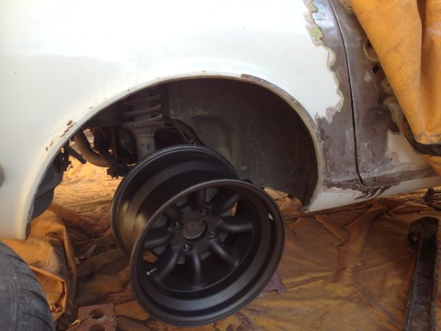

Wheels are front 15x8.5 and 15x9.5 not 10 as i thought. Luckily
They did come of a 240zg so perfect fitment.

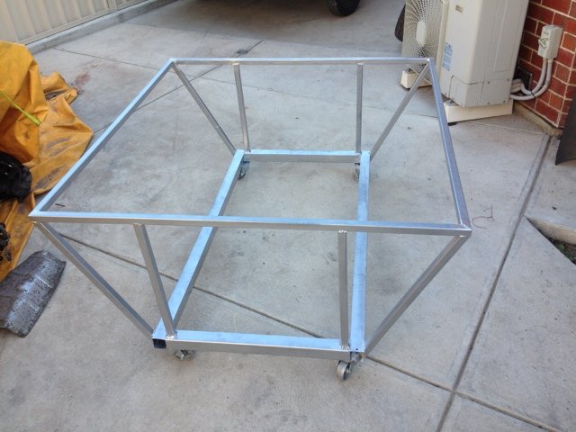

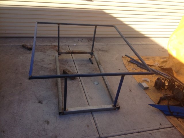

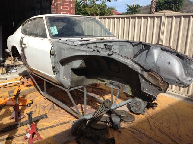

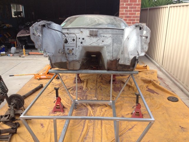

Besides shopping for things still i did manage to sqeeze in. Few hours making the 240z body trolley so it can be mounted on it without any suspension and still be movable.
Stoll to attach the castor wheels and mounting brackets and paint.
Just made it out of scrap i had lying around which wasnt much.
Hopefully tonight finish that. Than sand blast the rest of the var on weekend.

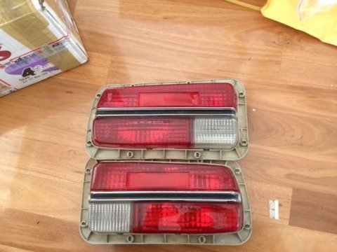

I was about to say US tail lights were an odd choice for a Z-G replica. Where did you get those flares from?
Yep so as l28et, disk brakes, intercooler,power steer, etc...... Still want it to be my car. So few personal touches will be on it.
Yeah like the US ones makes the rear little but cleaner with one less color.
Did you buy those Watanabes new? If so, did you have a 4 month wait for them and then the wait for shipping?
I was in the process of ordering a set and yeah, there's a 4 month wait plus 6-12 weeks via sea.
Where those US tail lights cheaper than the EU/Japanese lights? Just curious as I'm looking for a right hand one to repair my Aus light.
Dont' say that too loud, all the North American blokes will be banging down our door to get AUDM tail lights.

4. Dimitri rear lights in good condition are $300+ if patient. Seen the as high as 1k for new ones. Japan for US crapy ones 250-700 for better ones.
They popular in japan so hard to get them through there cheaper from US where I got these from.
I may have bits to fix ur right one if u after orange indicator. Sms me picture of your light and ill see if mine can be used to fix it. Not sure if right or left that i have an odd number off.
But do have 2 spare set of lights bit rough but can be prettied up.
Just sms me and i help out.

Trolley is finished tomorrow restarting the blasting. Than mounting the car on it for rail replacement.

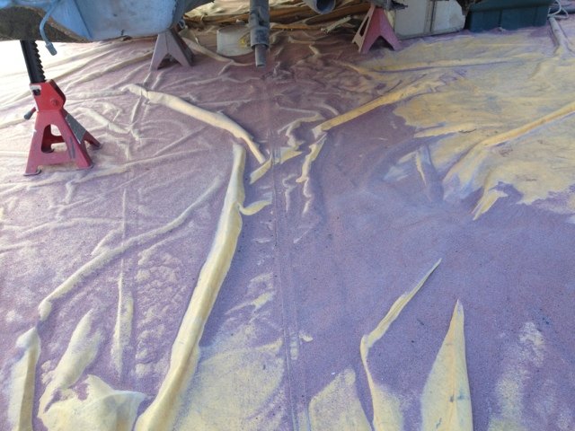

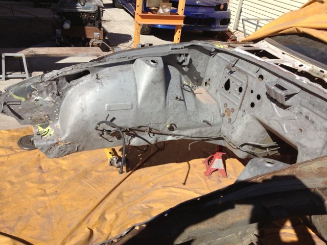

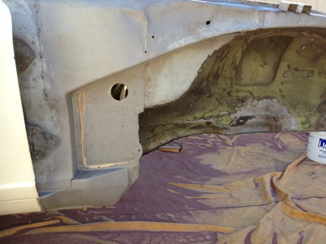

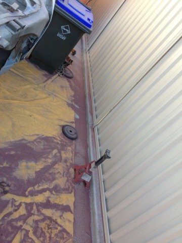

Ok over 8hrs of blasting in 2 days and garnet everywhere.
Lot slower than expected. Multiple layers of paint body filler and tar based stone chip made it an absolute nitemare.
And the garnet just everywhere.

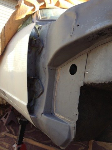

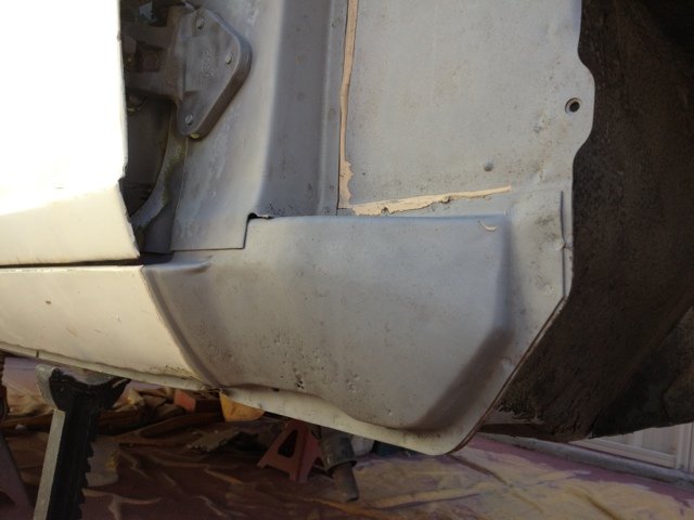

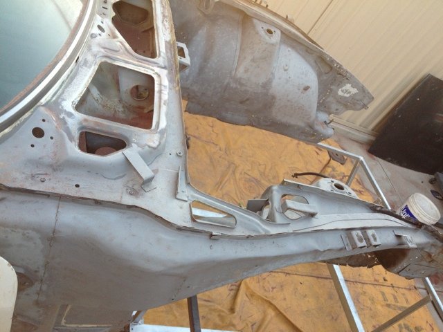

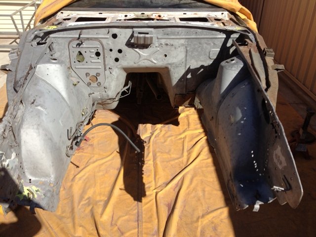

Finaly engine bay finished. Didnt totaly do the front end as it was full of body filler and was taking ages. Im cutting those off so no point wasting time.
C3D0B6D9-9A83-4455-A8E2-6FC3E34A1A39-4418-000004A351E0700F_zps77f41512.jpgE0096092-D4D3-4479-BA1F-B1ACFEBD88B1-4418-000004A349B6AC84_zpse4528738.jpg
Underneath i only blasted where the trolley is going to be. Once on the trolley the rest of blasting may be bit easier. If too hard ill just blast it when it ends up on the rottiserrie.
Oh did i mention the F#%^ng garnet everywhere  ;D

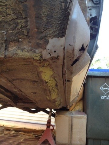

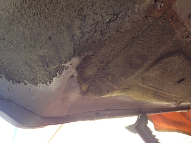

As it was coated several times with tar stone chip, still soft, garnet just bounces off with minimal removal. Plan B has to be developed to remove the tar. Thinners seem ok bit slow and very messy. Anyone one suggest anything else???
The stock dry stuff seems to flake off easy.
Hopefully tomorrow give it a scrub with renex to get any traces of corrosion out than clean it and spray some weld through primer on it.
I knew it had a frontal at some stage and will be removing few panels off to get it 100%. Extra work i didnt expect.oh well that old z for ya.

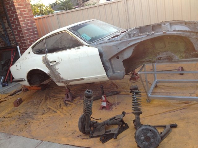

Removed rear suspension and diff so greasy and full of redbacks. Anyone after r180 and driveshafts let me know.

I used a heat gun and a small cooking blow torch burnt the tar and scraped or chiseled it off. Comes off like cold fat on a roasting tray.
Then with left over residue i brushed a layer of paint stripper and pressure washed it off and all thats left is metal. Or it could be blasted off if majority of tar is scraped off.
Yeah ill try heatgun and scraper and bit of mineral turbs to scrape the tar.

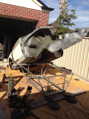

Well yesterday my 240 tried killing me twice.
Hence I added Christine in the title.
Can a single person mount a zed on a 750mm high trolley without any cranes.
Simple answer yes but unless you want to be squashed like a pancake think about it twice.
One z shell and one trolley how hard can it be?
Started well till almost on it i just needed another set of hands for front end to be tilted on top of the trolley.
As i started tipping it it decided to roll backwards on top of me.
Well i bolted and lucky the garage is brick and stop the z instantly
Though extra work that i didnt need
Another attempt at it with similar results but no damage to the car or myself (bolted very fast lol) till i figured my problem was with my aid, the roller pipe. Once sorted.
Launching to the skies just to tilt it over.
Wooolaaa
Z on a trolley
So can a single person do it on its own? Yep
But quicker and lot safer way just get a carton of beer and 3 mates and get the job done in 20min than enjoy the beers for rest of the day.

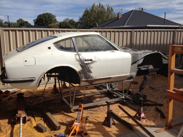

Made the rear mounting brackets to suit 240z and almost finished the front mount. Trolley will be re-used for my other projects so the mounting brackets are bolted not welded.
Its high enough that i can even fit complete rails. Its at good working height for the body. Roof well need a ladder but that will be tackled on the rotisserie once the rails and rad support are welded back.
