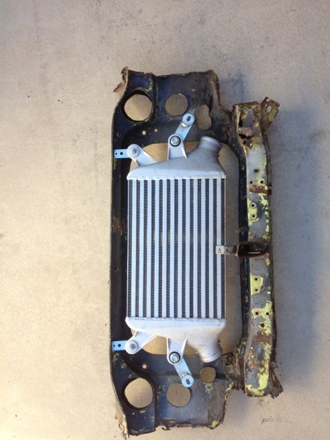

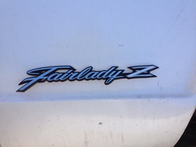

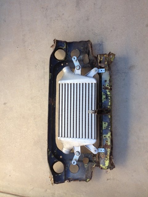

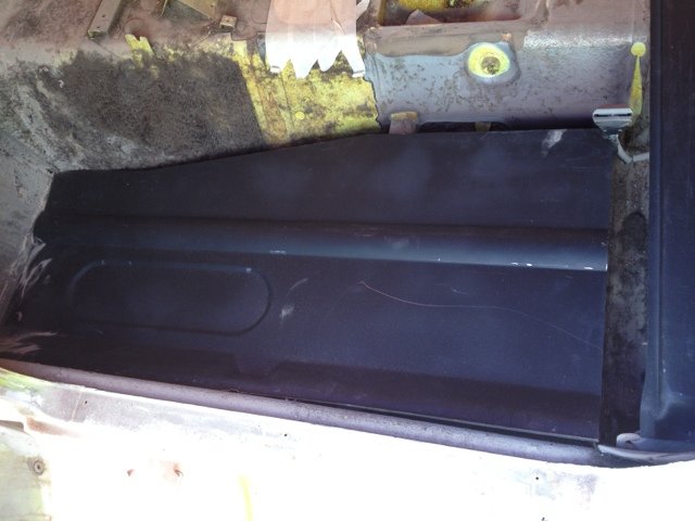

Fairlady Z Posted February 5, 2013 Author Posted February 5, 2013 On fire today. Presents keep arriving. The FG falcon intercooler looks like a reasonable fit just to decide the orientation that works out best for L and RB later. Looks like a good cooler rated to 350kw bout what i need. Also looks stock which me like. Also one of the fairladyz badges arrived. Nothing better than a feel of a new part. Im gona cry when i cut the z part off. :'( Oh well must be done to replicate the "fairlady 240z" on ZG More goodies please. Oh I forgot picked up the replacemnt floor on weekend from rare spares. Looks like a good fit. So at the moment got all the bits to do on the engine bay. Building a storage/garden shed behind workshop so i can clean up my backyard so dont look like a wreck yard. Also clean up the workshop. Once that is done finish blasting the front end. Weld te rails and rad support back on mount the car on rotisserie and blast the rest of it. Than enter the workshop for rust repairs and body work. Quote

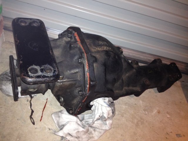

Fairlady Z Posted February 15, 2013 Author Posted February 15, 2013 Scored these yesterday. zg hinges at a reasonable price. And scored an r200 lsd 4.3 at a realy good price. Though need 4 bolt driveshafts. So if someone has any floating around please let me know. Also are 260z driveshafts same as 240. Besides fliping the moustache bar is there any other changes between r180 and r200 upgrade? Or best to get the 260 rear parts. Got a feeling 260 m bar is bit beefier. After this weekend should be all back 100% working on the z. Nato is working hard on the rails so should be finished soon so i better get the rest of the car ready for it. Quote

Moderators Zedman240® Posted February 15, 2013 Moderators Posted February 15, 2013 You're in luck with the 4 bolt shafts; I have a spare pair. You may have to change the rear part that sits behind the diff where the rear arms pivot bolt to. From memory the R180 is straight, and the R200 has a curve in it. Quote

Retro Z Posted February 16, 2013 Posted February 16, 2013 You will need to use 260z mustache bar as the diff bolts wont fit a 240z mustache bar unless you slot the holes out. And yes 260's is beefier. Also you will need to use 260z half shafts. As diff is slightly offset to one side. 240z ones will fit but will eventually bind up. Some people will say 240z and 260z shafts are the same but I've done the measurements when i went from r180 to r200. One shaft is slightly longer than the other. Only by a few mm though. Quote
