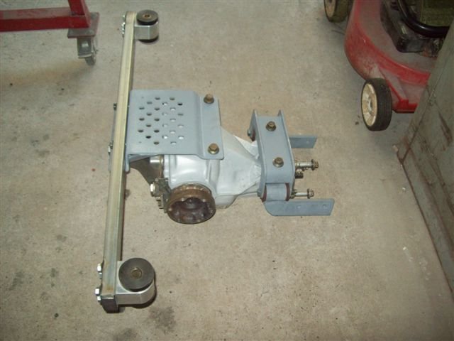

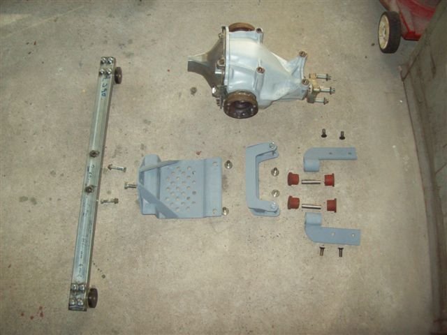

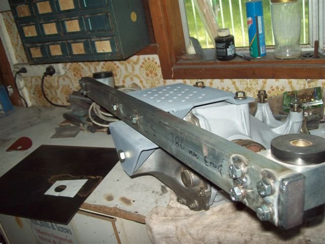

In attaching to the two rear moustache bar mounts I was fortunate to buy just the bushing housings from the mob which make the moustache bars for Arizona Z but they’ve stopped selling now. Don’t ask Dave for them as he will only sell the complete bar set-up. I suspect you could also cut these off an existing bar and weld or bolts them to your own moustache bar. Remember that Datsun moustache bars are made from spring steel so bolting would be preferable to welding.
For the moustache bar I used 50mm x 25mm steel tube and I welded in sleeves, to prevent crushing, for the four bolts holding the mount housings on each end and for the two bolts attaching the main rear diff mount plate.

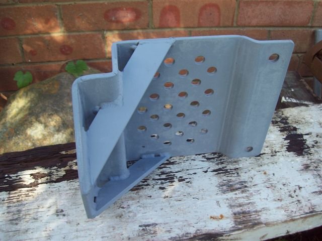

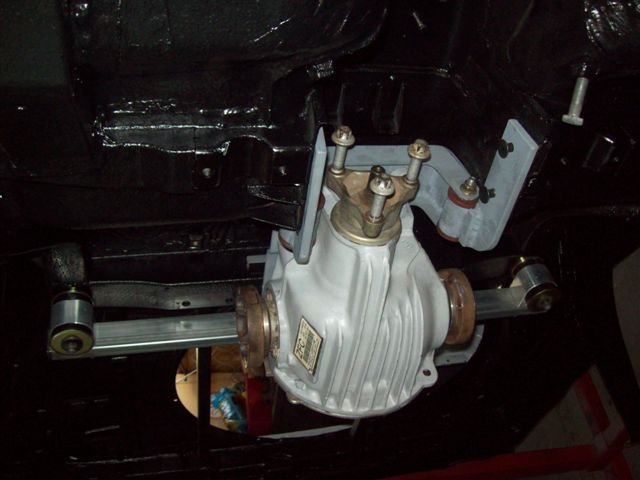

The picture of the rear diff mount plate probably explains it more than any words I can string together. It is triangulated by being secured with three large bolts which came with its original install into a Holden.

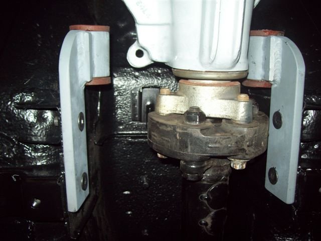

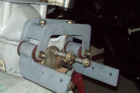

I probably went through a dozen designs and prototypes for the front mount before settling on what I have. The problem was to use the existing mounting points (for the Datsun diff tie-down strap) which were well forward of the front mounting points on the Holden diff. We turned up our own red polyurethane bushes (a bottle of Jack Daniels) which was a PITA so I would see if a suitable sized commercially available bushing was available in future. Again a picture is worth a thousand words.

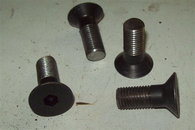

One difficulty with the front mount is the Holden rubber tailshaft coupling I’m using in lieu of a standard universal joint rotates close to the new mount and countersunk bolts are required. Unfortunately nobody manufactures these 10mm (or is 12mm?) with a fine thread. I bought longer bolts with some plain shank and cut a fine thread on the lathe and then cut the bolt to length, i.e. another bottle Jack Daniels!

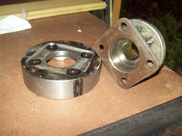

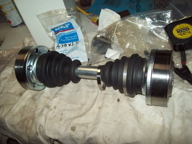

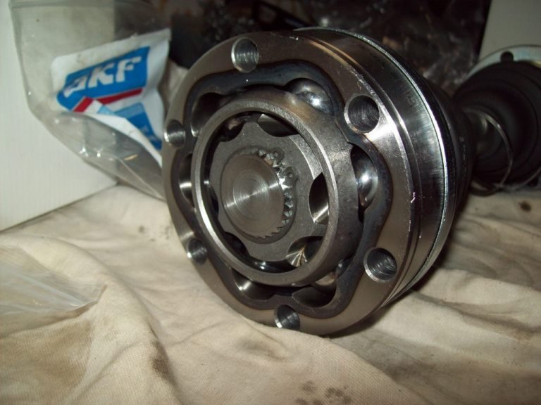

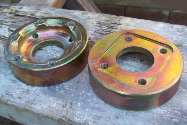

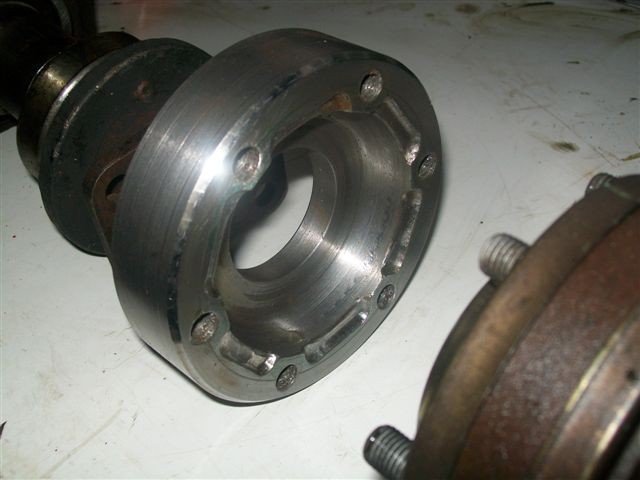

To use the Holden CVs a coupling was machined to mate to the Datsun stub axle coupling. Yet another bottle of Jack! Again pictures explain it all.

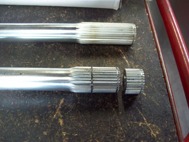

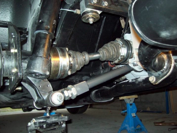

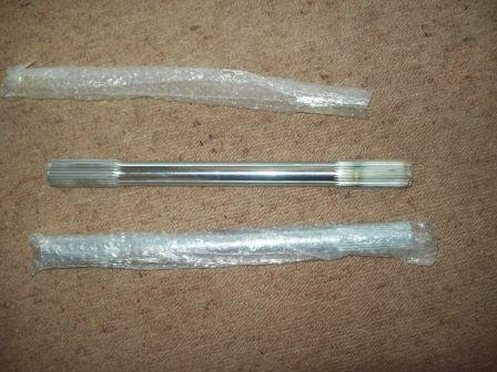

The Holden CV is a universal type best known as a Porsche 930 CV. They are used extensively in off road buggies and this has the added advantage of there being drive shafts (USA =axles) available cheaply. Holdens are usually fitted with different CV, inners and outers. One is a fixed type (27 splines) and one is a 'plunge' type (28 splines). Use only the plunge type CVs so make sure you get shafts/axles with 28 splined ends, not the 33. Unfortunately none are the exact length – 350mm – so you need to buy a pair of 15 5/8” shafts and cut them down to length. You then need to machine two circlip grooves into each splined sections to secure the CVs. i.e. yet another bottle of Jack!
The overall set-up.

I'm in the process of a CV conversion (in addition to adding an S15 Helical to my R200) which will use a commodore outer CV joint - could I trouble you for a 3D CAD file (if you have one) of the adapter you machined up to go between the CV's and the 4-bolt 240z companion flange??
http://www.viczcar.com/forum/index.php/topic,5033.30.html
There seems to be a few porsche 930<-->S30 companion flange adapters on the market, but they all appear very thick and I'll need a very thin one (whilst still allowing for joint cage protrusion, etc) so I was hoping to modify an existing design to be thinner and have it machined up :)

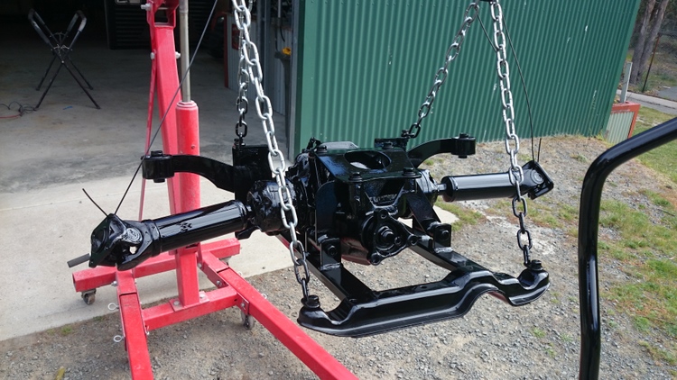

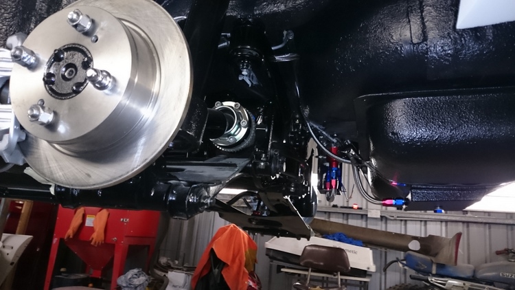

This I My Diff Set up.
Same as above but all mounted on to the zed frame work and bolts onto the original mount points using original mustash bar.
cost me $2500 in fabrication alone.
Ah very true otherwise you would need adapters similar to the ones I have with the wolfcreek axles I have and just more to go wrong I think.
That setup you have is very neat.
