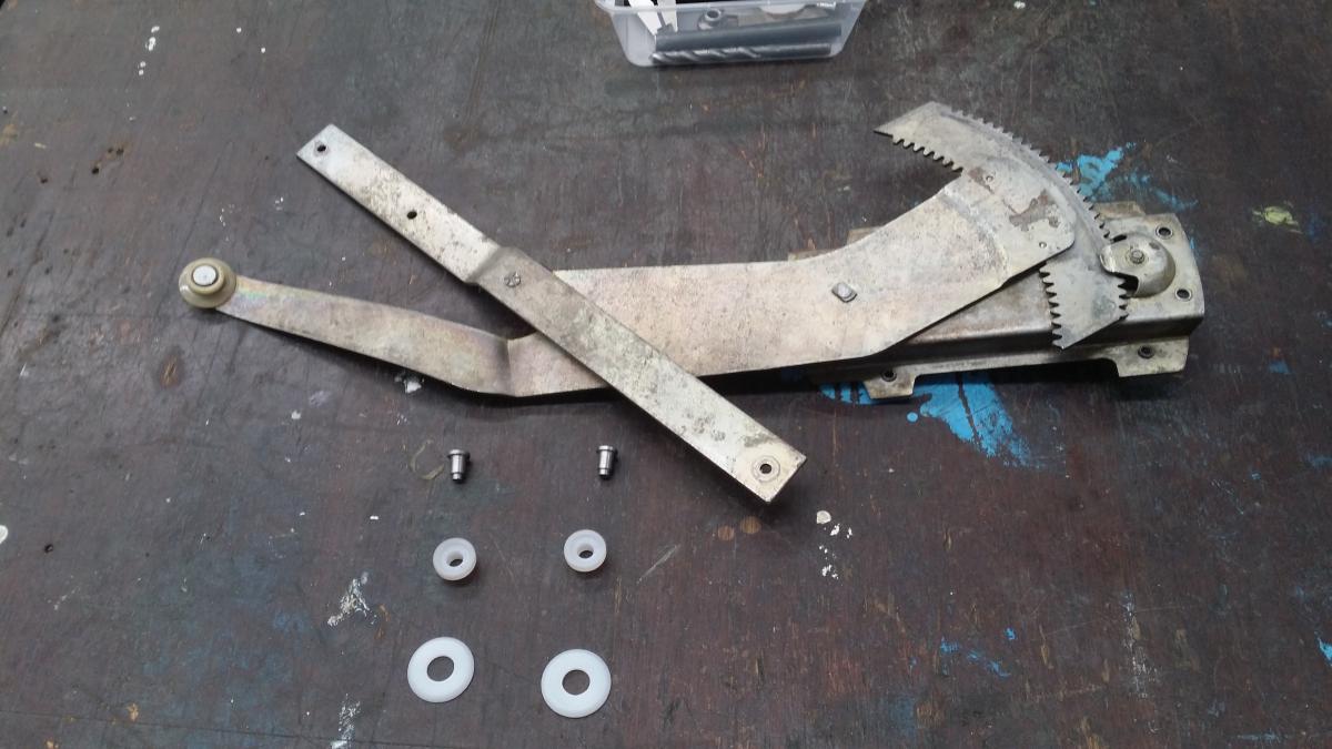

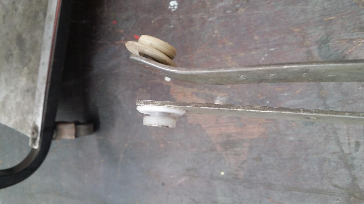

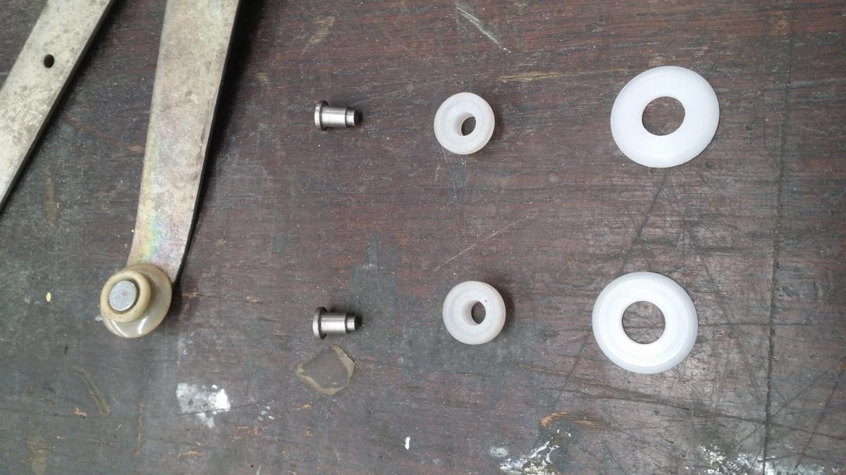

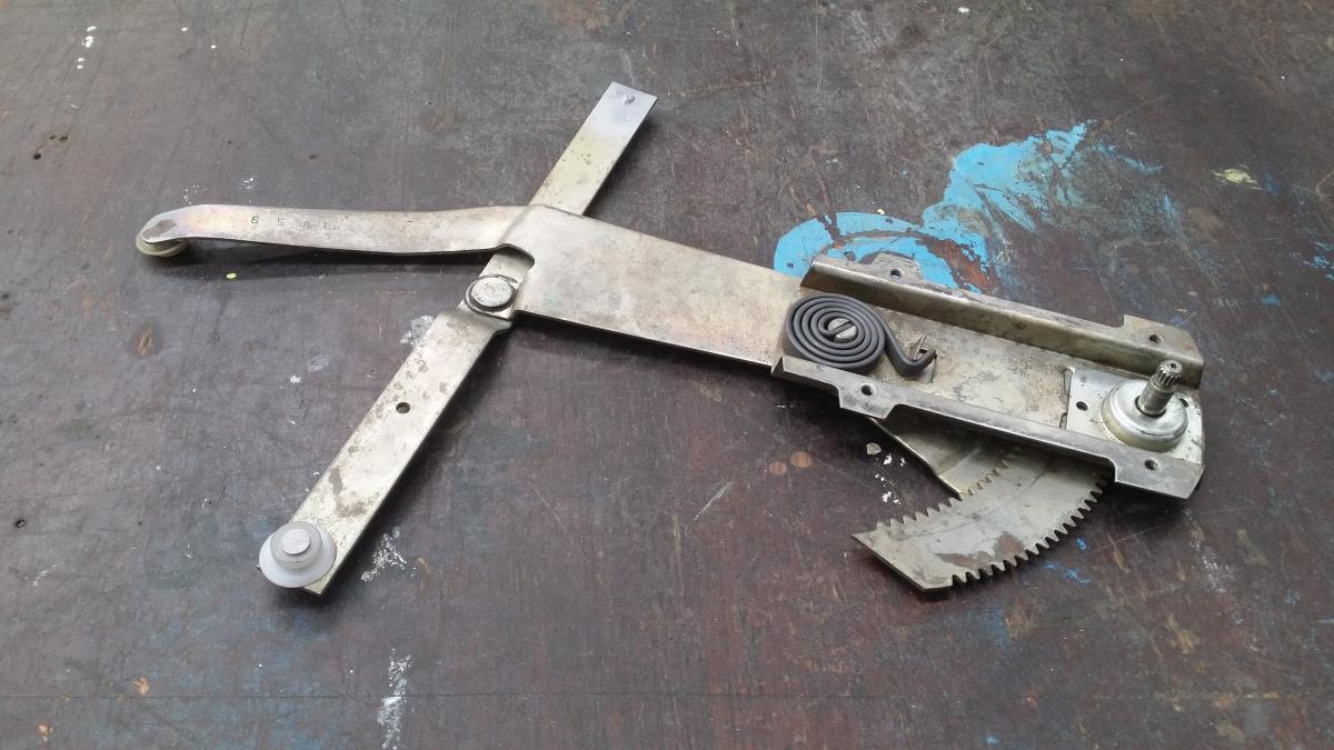

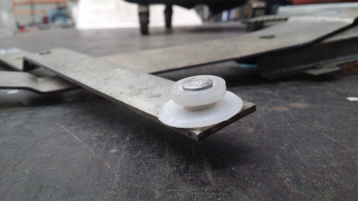

  20. Hi, Thanks for your interest! Are your 3 rollers and larger plastic collars still intact and appear undamaged? and yes there are 3 per mechanism and would need to be welded in if replaced. If yours all appear to be fine i am not sure that replacing with new would be necessary. if your window was a bit stiff it may be because of other issues. - window felts worn out creating slop/play int the window allowing it to kick over slightly and wind up unevenly. - there is also another guide roller in the top of the door which you can buy new from the US. - the mechanism may also need general cleaning and greasing. - inside door window guides out of position... what does your mechanism look like currently? here is a post from NZ it has the another roller in one of the pics https://zclub.nz/viewtopic.php?p=20818&sid=5d62fecbc695791fdf2d1796f2e5ee19 Cheers, Craig
  21. Hi all, Just thought i would post up some pictures of a winder mechanism that received 2 new rollers, 2 new bushes and 2 new pins welded in. If any one needs one repaired just let me know , some rough pricing in previous post and extra pins or large plastic washers add $10 each to roller pricing. Thanks
