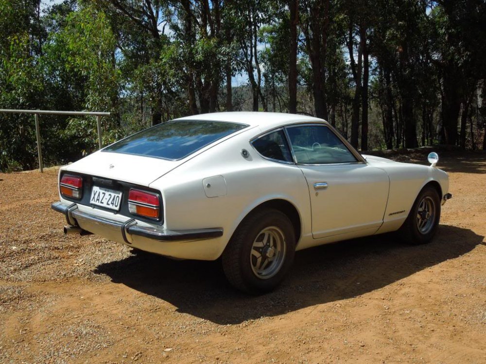

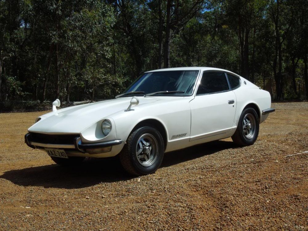

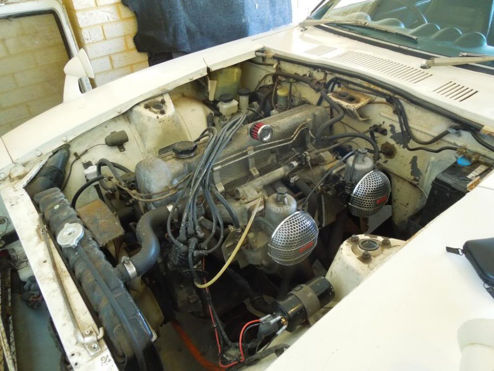

i'm Jamie and new to this forum. Thought i might share with you my now project 240z i purchased a couple of months ago down south from perth. I got this car and it barely ran, looked rough but the interior was still really nice and the car still has matching numbers and is build number 803. I gave it a buff and a big tune up, fitted electronic dizzy and had the front brakes rebuilt. I recently took it to a work track day and evidently did some damage (suspected run cam bearing by the sounds of it) so now i'm taking this opportunity to do some resto on it. I'm going to do it in stages so it doesn't hit me all at once in the pocket and so i can still drive it in between etc. I'm going to keep it as original as i can but modify it to how i want it. all mods will it basically bolt on so if the need ever arose to make it how it was , it can be. I really want to put flares on it but can't bring myself to cut into such an original car, so insted of going 17x9.5 i'll go 17x8.5 that sort of thing.
Here are a couple of pics to show you what i have to work with
as i go along i'll explain my steps on it and if you guys have opinions please let me know.

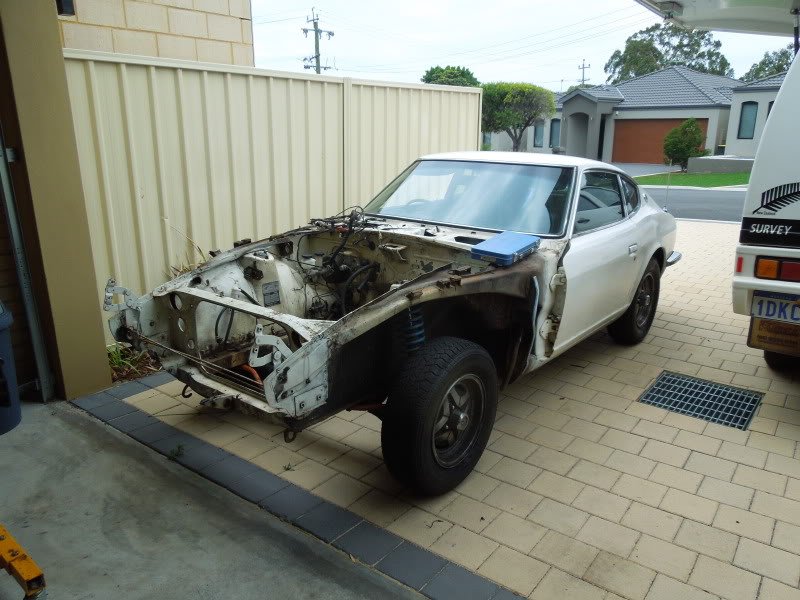

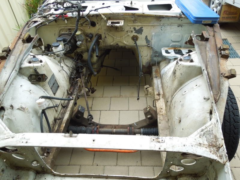

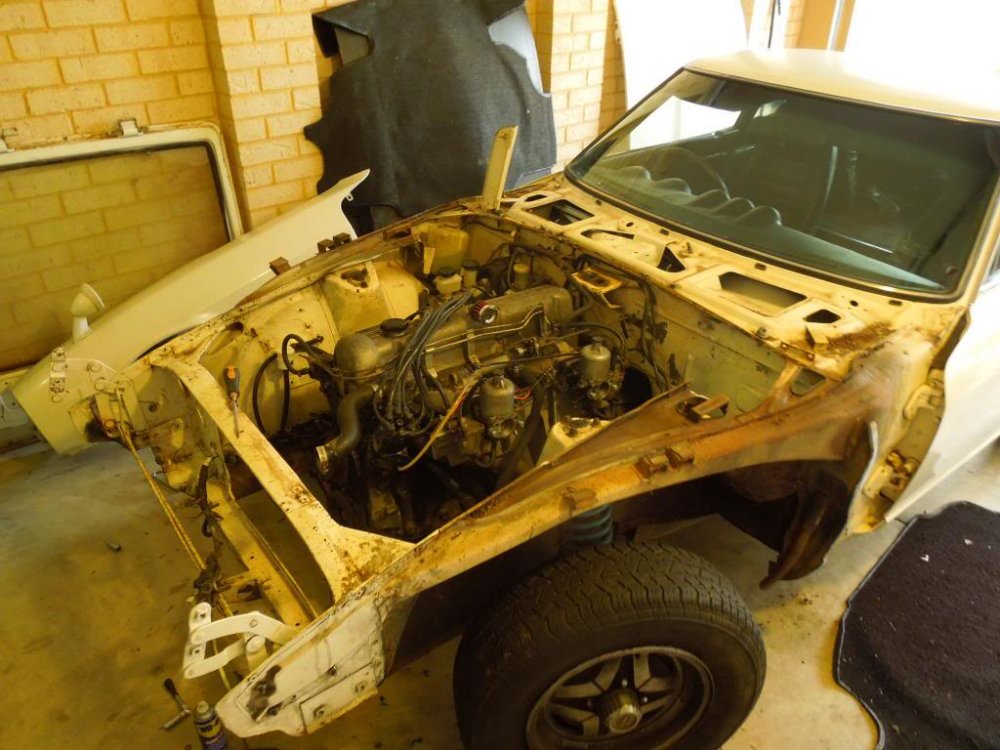

Step 1: Remove engine, gearbox and basically take the whole front of the car off. Remove everything from the engine bay and from the window forward have it sand blasted and repainted white.
Had a couple of spare hours today so got stuck into it, as you can see the engine bay isn't the nicest looking so going to get this redone and then get the exterior painted at a later date.

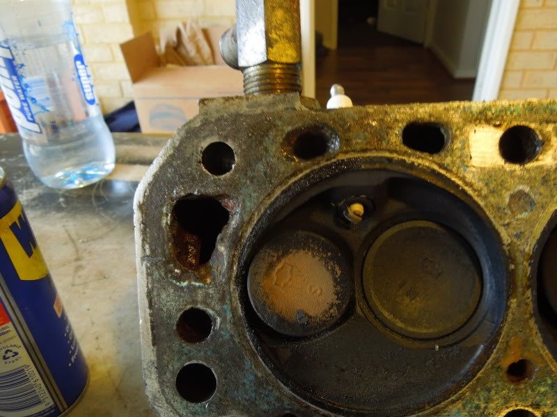

Since i was on a roll I started taking the engine apart and removed the head. Finding out why it started making bad rattling and metal on metal noises from the top end. I found that one of the oil squirter bolts was either missing or has fallen out causing starvation on the cam. Once i had the head off it looks like i made have blown a head gasket but looking at the corrosion in the water gallery it was very close to breaching the bore anyway.

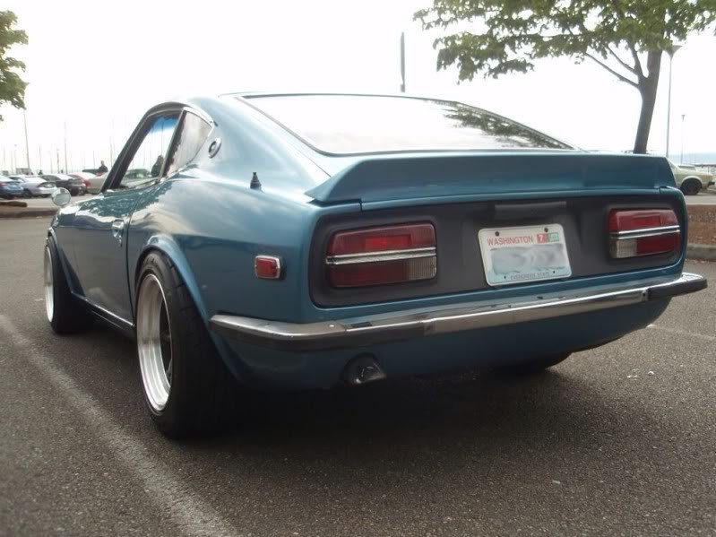

The more I go into this build the more I want to get silly with it and fit 17x9.5's and flares. What are your opinions on this? Bite the bullet and do it or keep the car looking more original by not cutting the guards and fit 17x8.5's....
I really do want to model my build on something like this as it just looks look staunch.

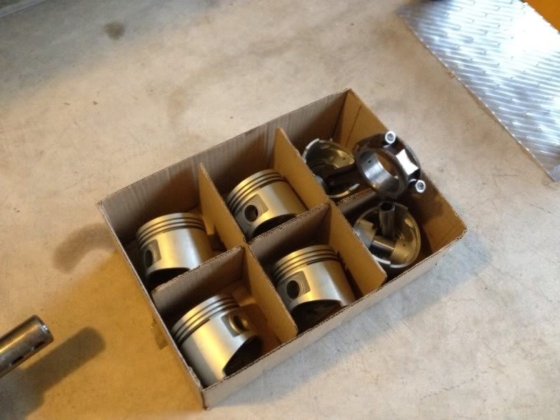

Purchased an engine stand last night so now the next thing is get the block out and start getting some quotes on getting a short block rebuilt. Any body have any suggestions ? I want to try raise the compression so i'm thinking flat top pistons and shave the head. I want to get a mild cam and run triples too.

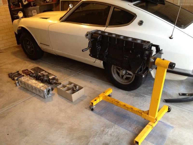

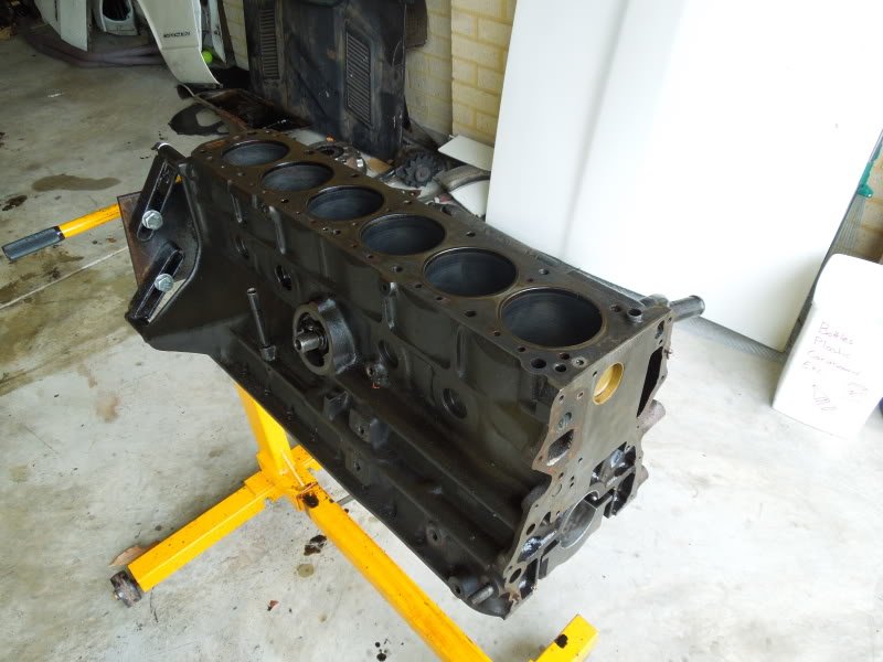

Thought i'd give you guys a bit of an update as I found some motivation and an engine crane today. I've finally got the engine block out and on a stand now.

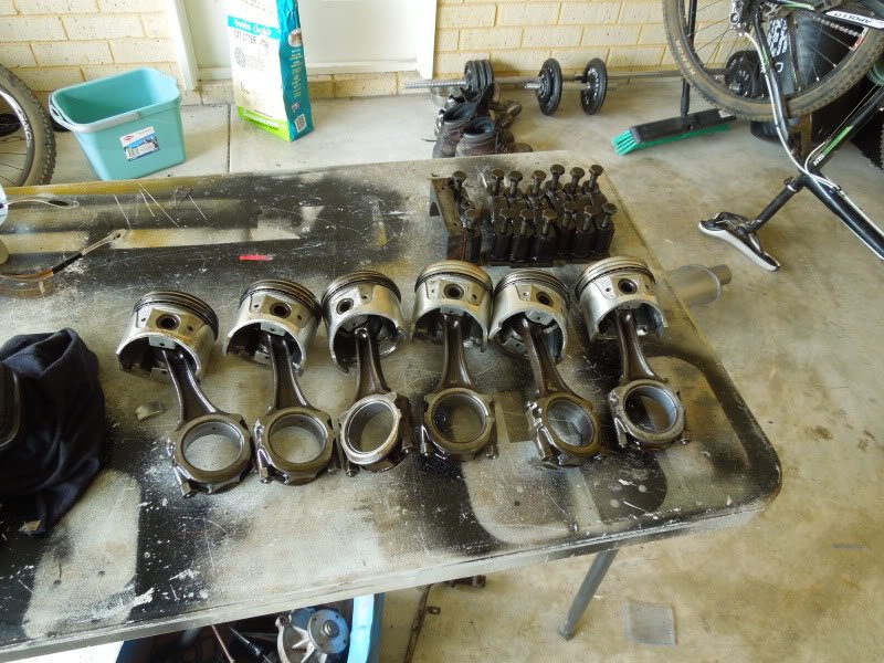

Once i got the engine pulled apart i found a piston skirt in the sump and the no.6 piston was the culprit. I also found a hairline crack around the pin area so i'm quite glad i made the decision to pull the engine down as a major failure was going to happen
the engine still looks in pretty good condition, i think its had a cheap rebuild in the past and it looks like it has oversized bearings fitted and the crank looks perfect. Bores still show hone marks but i intend on going oversize on the pistons anyway. Still researching a couple of piston options but i'll be putting in flat top/high comp ones regardless for a little more power

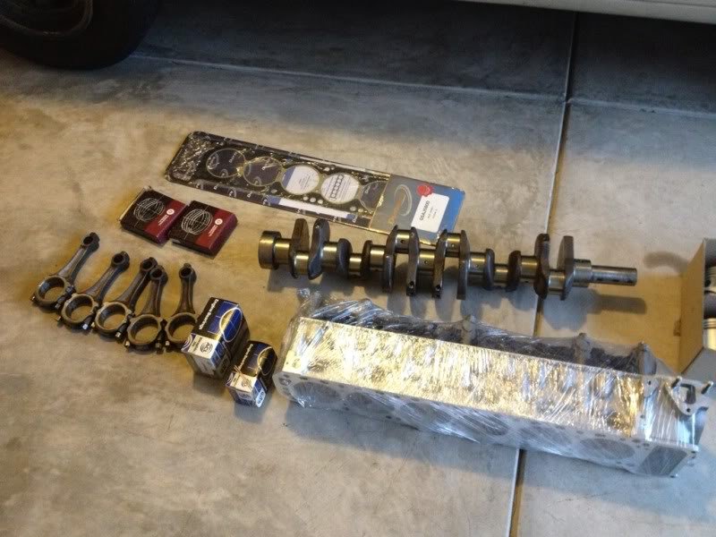

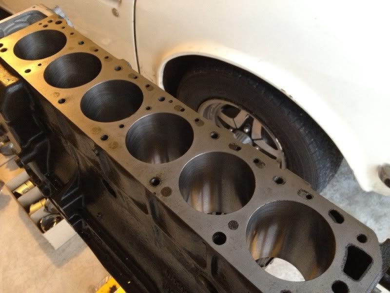

Finally got my engine back from the reconditioners today. I have to dummy assemble it to check valve to piston clearances. The block has been bored to 60thou and decked to raise compression.
The "reconditioned" head I got off eBay ended up being a lemon, they just skimmed the head but valve guides were shot, seats fell out and it was bent across the top. So after much machining, l28 intake valves were fitted with new guides, has had some mild porting done, heavy valve springs fitted with its performance camshaft
This should give me some motivation I've been lacking pretty badly, so very excited to get this engine together.

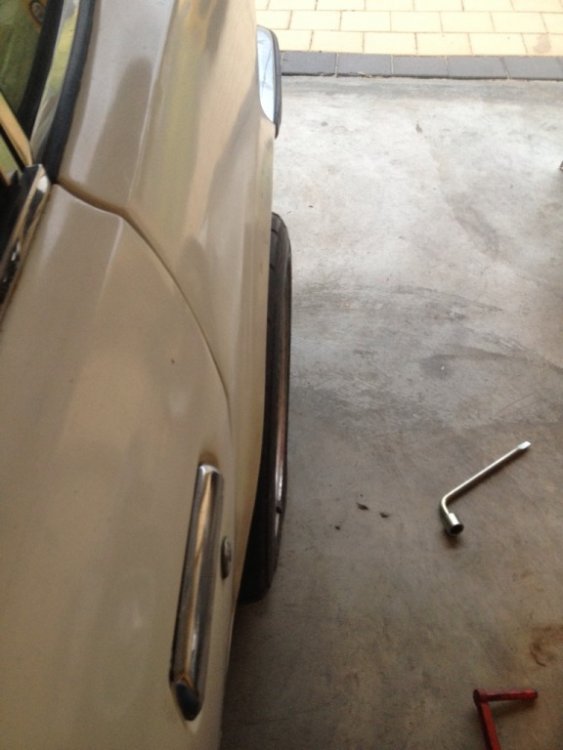

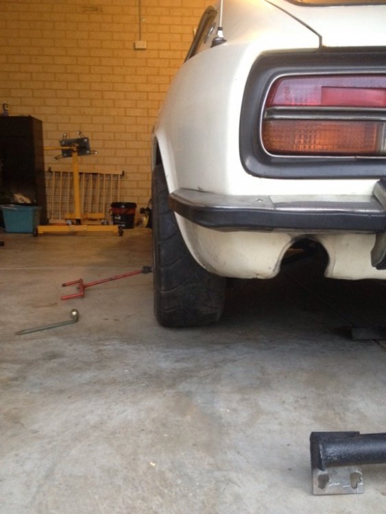

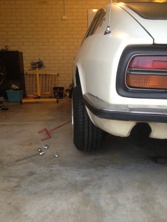

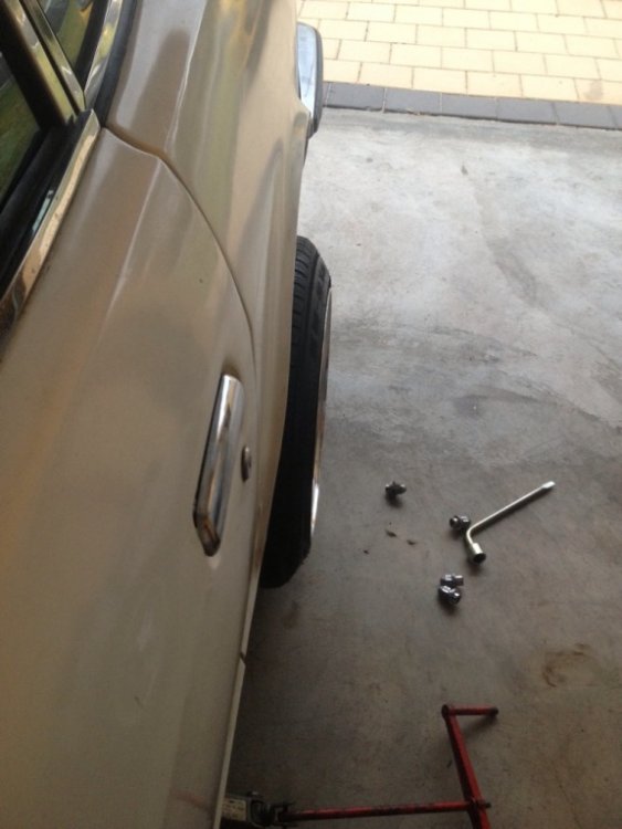

15x8.5 will poke a little but it's what I want. I dummy fitted some wheels I borrowed from friends with the results below.....
15x8 -4
15x9 -10 which obviously poke to much but wanted to see

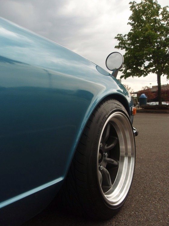

And this is the look I'm going for and from what I can tell these are 16x8.5 -6 and maybe ill go 16s, just depends on my mood when it comes down to clicking the button.....
16x8+0 with 225/50/16 semi slicks will fit with rear gaurd lips rolled, most road tyres have a rounder shoulder so may also fit in that size.
Blue car looks good standing still, but I'd be interested to see how much rear travel it has IF any.
I see your point, that's why I'm thinking 15s with a slightly thicker sidewall to fill the guard but allow movement. I guess it's the kiwi in me, buy the wheels and make them fit  ;D
