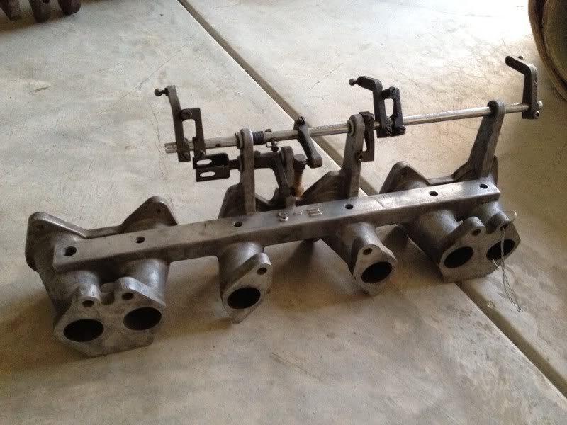

JDM_240z Posted April 21, 2013 Author Posted April 21, 2013 Did some more shopping in the weekend, picked up this manifold Quote
d3c0y Posted April 21, 2013 Posted April 21, 2013 Yeah sorry, not trying to be a wet blanket, but people always come on here saying they are going to fit massive wheels without flares and "reinvent the wheel" so to speak lol. There is a build thread on hybridz.org for the blue car if you want to check out more on it. What carbs are you going to put on that manifold? Quote
JDM_240z Posted April 22, 2013 Author Posted April 22, 2013 My bosses have some dellorto 40's lying around which he is going to give me, so i'll re kit those and see how they are. I'd love to do the OER injection but due to $$$ that will have to wait. Yeah sorry, not trying to be a wet blanket, but people always come on here saying they are going to fit massive wheels without flares and "reinvent the wheel" so to speak lol Its fine, thats very useful information and appreciate it. I wasn't trying to fit ridiculously large wheels but trying to get that nice stance look. I've had to go away and rethink the whole wheel side and think i may have to pursue going down the path of ZG flares to get the look I want with 16x9 -13 and 16x8.5 -6 maybe. Quote

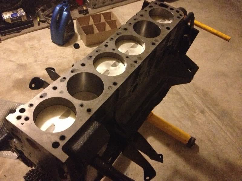

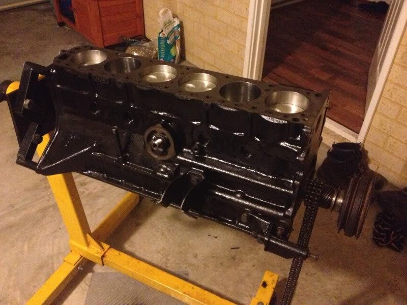

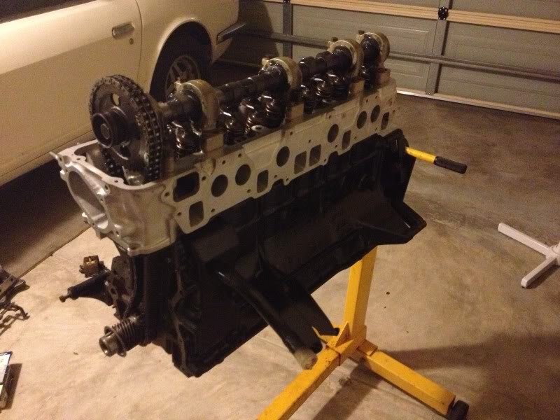

JDM_240z Posted April 28, 2013 Author Posted April 28, 2013 I won't be running any larger brakes than factory so I can't see any clearance issues. I did some wok over the weekend, fitted the crank, one rod and piston and put the head on to check valve to piston clearances. Plenty of room by the looks of it which I good, get the new pistons pressed onto the Rods now and put the short block together. I still need to do some head setup such as shim the cam towers and get some thicker lash pads then that is ready to be bolted on. Just need to buy more bits like new timing gear, oil pump and gasket set.... At least the ball is rolling now Quote

JDM_240z Posted May 9, 2013 Author Posted May 9, 2013 Cheers for that guys, might have to roll with 16's then as that car looks so dam tough! Got more work done last night, assembled the short block and tonight the head goes on. Quote

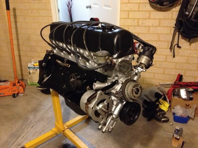

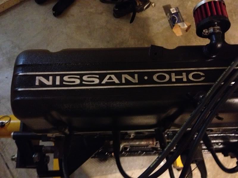

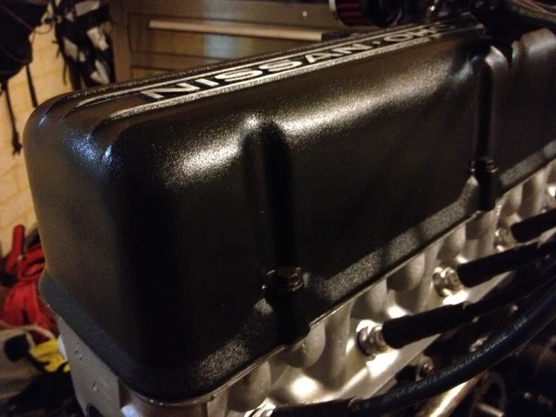

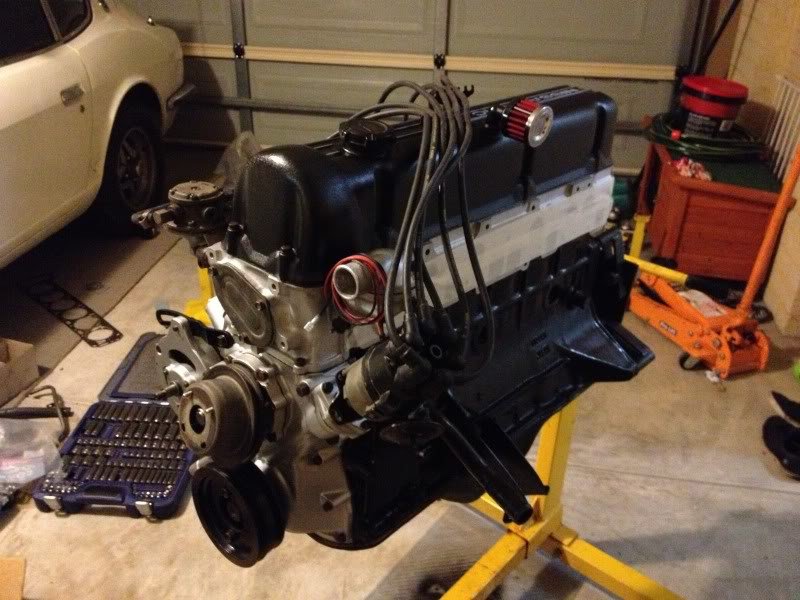

JDM_240z Posted May 23, 2013 Author Posted May 23, 2013 Been doing a bit of work over the last couple of weeks cleaning and painting components. Painted the rocker cover and sump in wrinkle paint. Brought a new oil pump due to some scoring in the old one. Quote

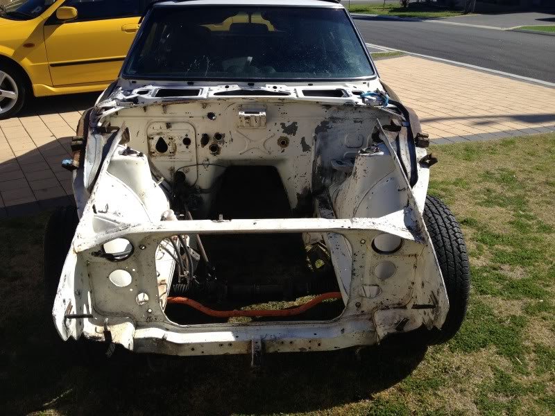

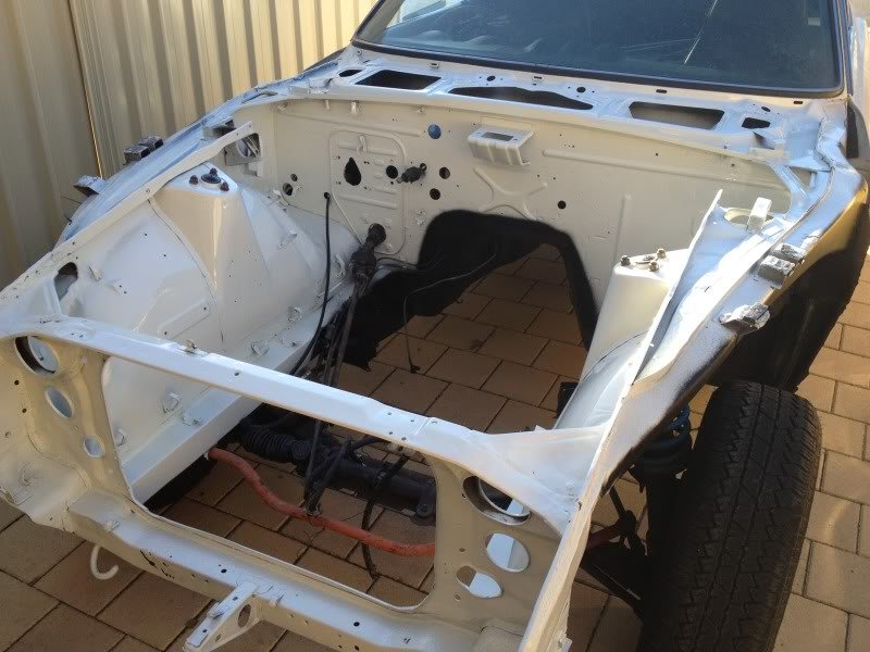

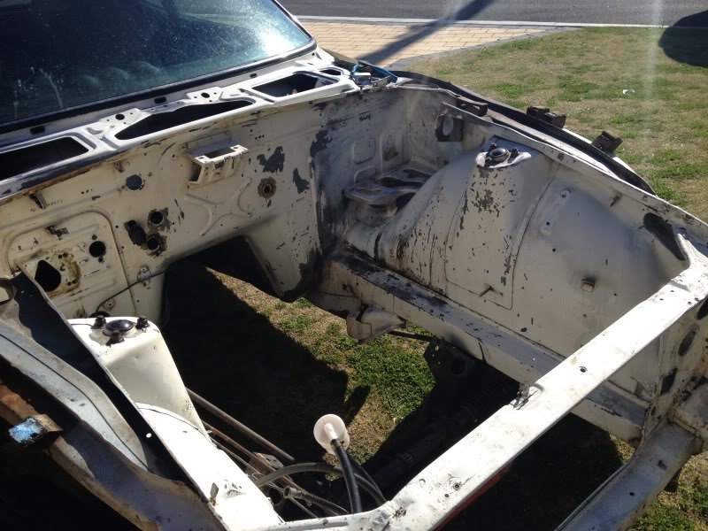

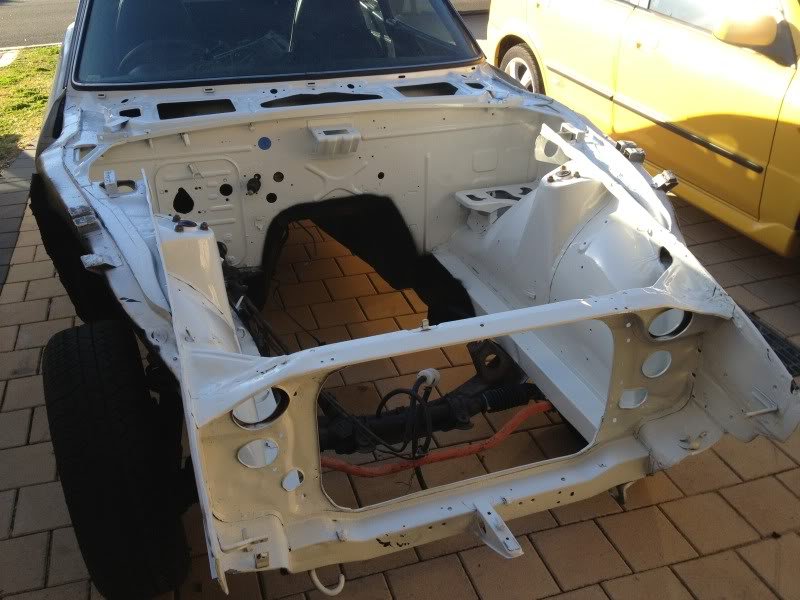

JDM_240z Posted August 4, 2013 Author Posted August 4, 2013 Hey guys, been a while since I've posted on here but in between putting a rock on my fiancé's finger and treating myself to a new mountain bike the black hole in my wallet is slowly starting to close. Originally I was going to just paint the engine bay while the motor is out but as us token kiwis say... Nek minit I've gone for a full body respray. I've got my chassis back and the panels are being prepped . Here are some before and after pics: After Quote

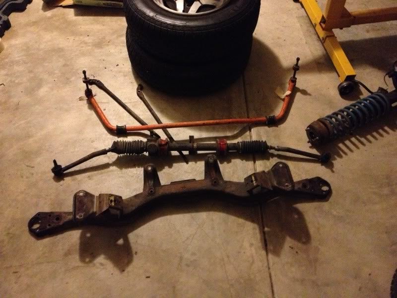

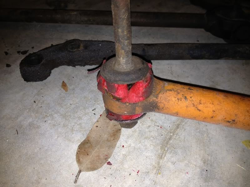

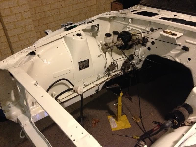

JDM_240z Posted August 10, 2013 Author Posted August 10, 2013 Got a bit more work done over the last few days. Managed to get the the brake booster and lines in, as much as I would like to put in all new master cylinder and lines but I need to draw the line somewhere otherwise it'll never be finished. Besides it retains the original character I've also pulled the subframe out for re bushing and coating. I'm going to sand blast the major components and paint them with POR 15. I'm waiting for my suspension bush set to turn up from the USA , as you can see the bushes in it are TOASt! Quote
Scoota G Posted August 10, 2013 Posted August 10, 2013 Don't stop the music. It's great to see such pace in a build. I have a full bush kit from the states so if it's going to be weeks before it arrives yell out and i'll post out what you need. You can always send me the replacements back later. Quote
JDM_240z Posted August 10, 2013 Author Posted August 10, 2013 Cheers for the offer, hopefully they'll arrive late next week or the following. It gives me time to get the subframe etc done. I really want to get the drive train in the before I pull the rest of the car apart for paint, I have no garage floor left as it is. Then I can do the same with the rear subframe. I'm still deciding how I'm going to lower the car, I really want to buy the parts but I'm not sure how far to lower it yet so catch 22 really. Quote

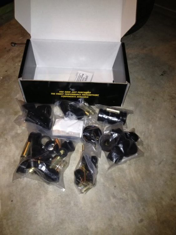

JDM_240z Posted August 15, 2013 Author Posted August 15, 2013 Had some more goodies turn up today from the states Full suspension bush kit and my chassis paint turned up also. Big Saturday coming up, need to strip the doors ready for paint. Hopefully drop my subframe and suspension off for sand blasting tomorrow as well. Quote
KatoKid Posted August 15, 2013 Posted August 15, 2013 Whos' bush kit??? I like the all black. Will be interested to hear how they fit. Keep us posted. Quote
77260Z Posted August 16, 2013 Posted August 16, 2013 Making fast progress mate, well done. Let us know how you go installing the bush kit. I've got one from the US as well but haven't started installing it yet, I'll be interested to see how much of a pain they are to swap over. Quote
