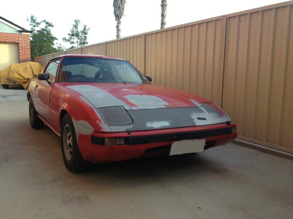

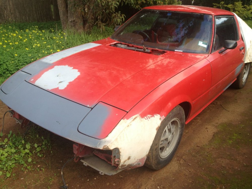

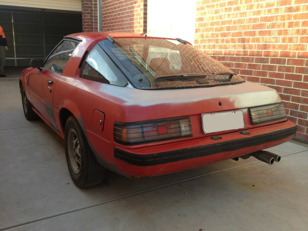

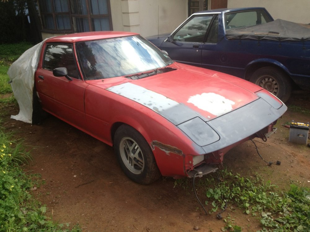

It is a S2 Rx7 besides needing TLC as you can see there are no mods what so ever on this car.  Everything is stock. One of the reasons I ended up buying it.

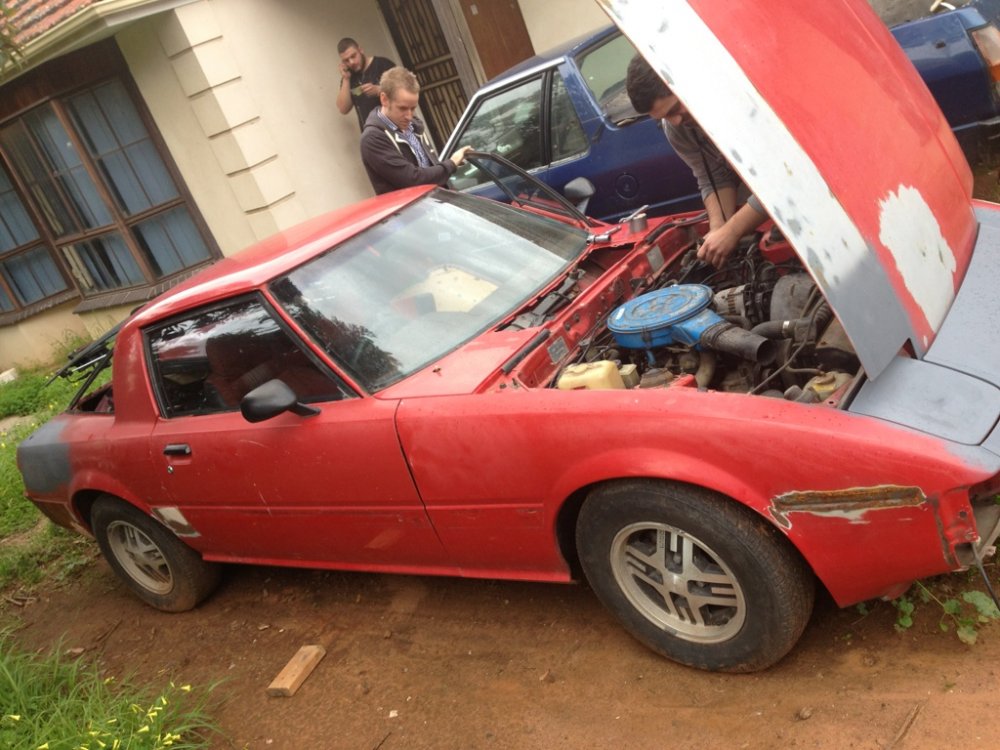

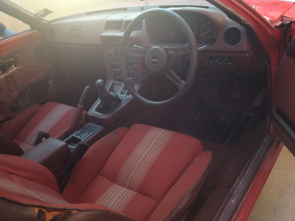

Pics of the car when I went to check it out.

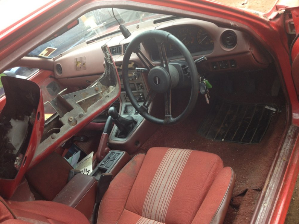

Delivered to my place. After a quick clean up of the junk inside and quick assembly to see what parts I'm missing.
it was running but never driven it as brakes and clutch were not operational.
After quick clutch flush and bleed and top up of brake fluid test drive was in order in my backyard  ;D
yep she boogies  :P

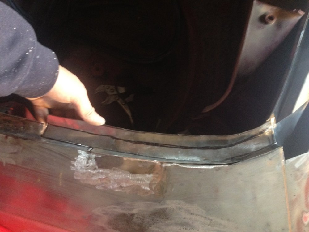

But as we all know plans change. And I couldn't accept myself doing crap job. So after bit of snooping and digging there was more rust to be found.
what I saw
what i didn't
what I thought "she be ok"  :o

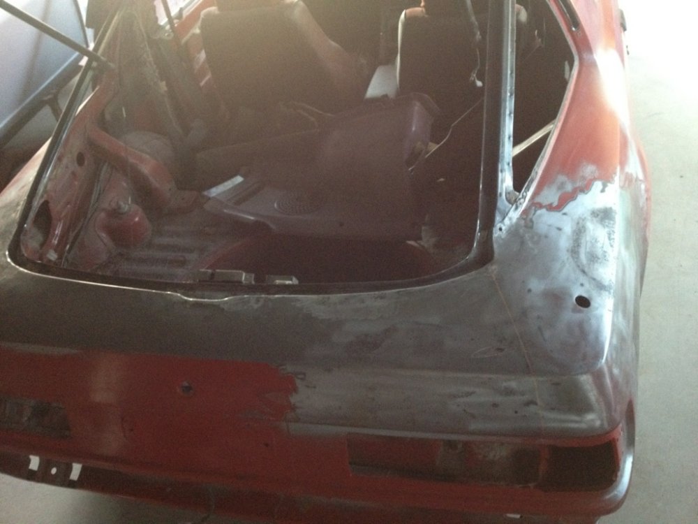

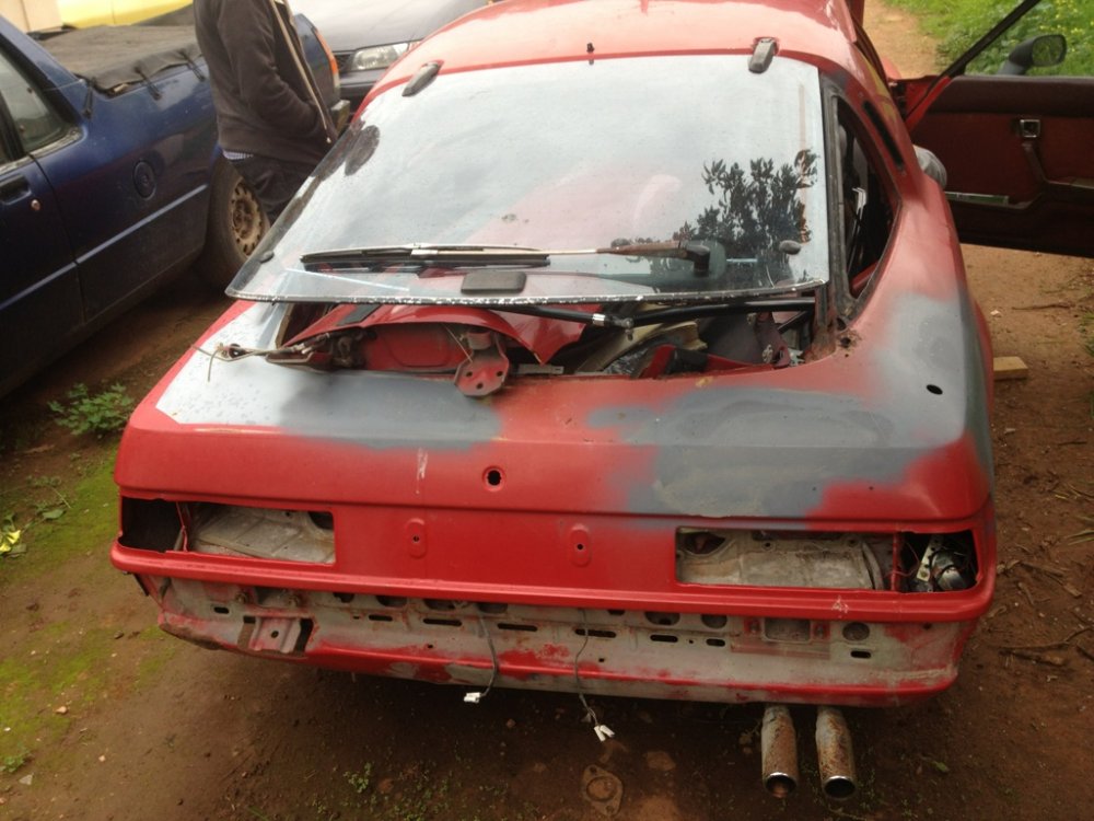

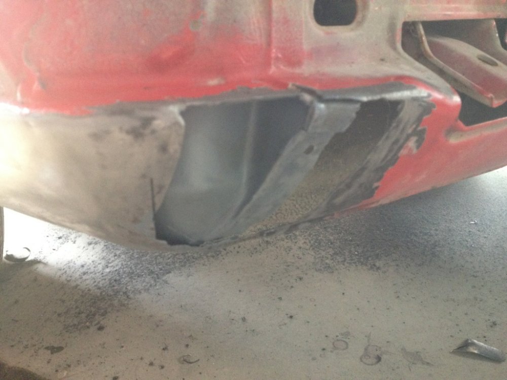

and what I ended up doing is striping it to metal to see whats lurking under there from previous owners repair attempts.
Lucky I went with my gut feel and investigated it further. it was a time bomb.  The car was mostly in such a good unmolested condition that deserved to be saved properly. so my "quick fix" ended up "lets fix it properly".

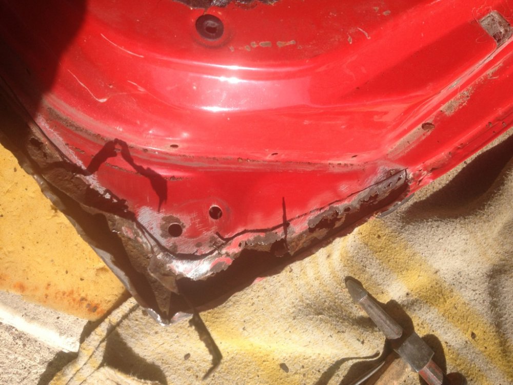

Mick yeah the repairs hmmmm there are too many wanna be car repairers out there. As far as I know could of been done by "professional" as seen some pros do worse job than this.

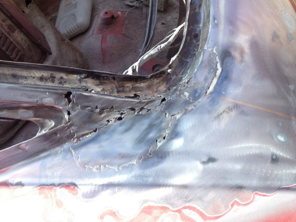

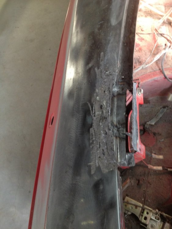

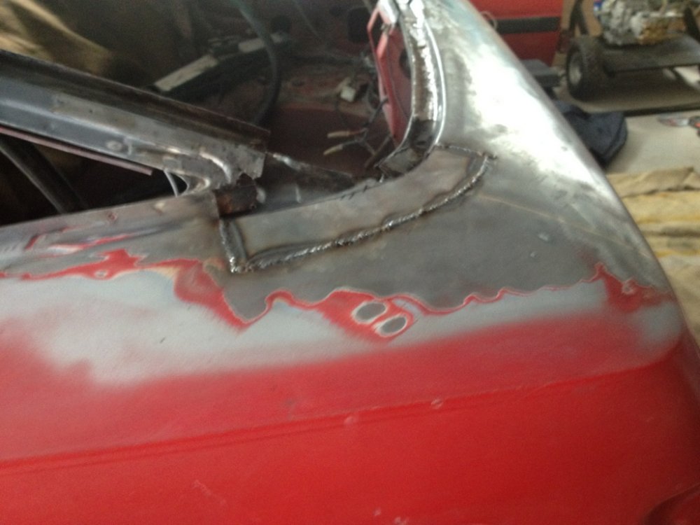

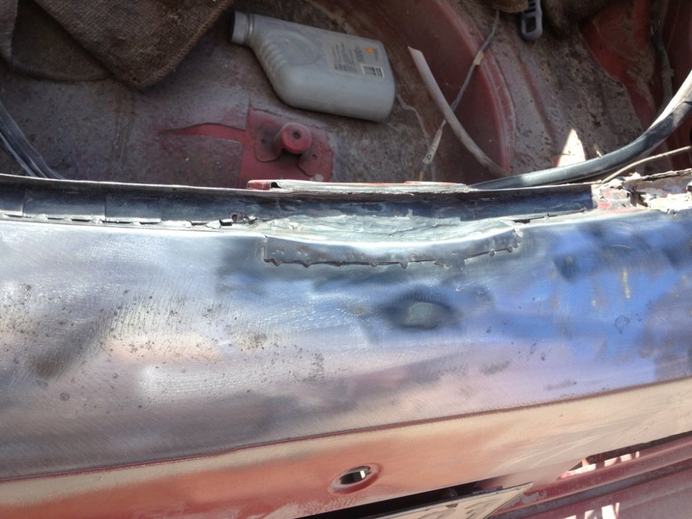

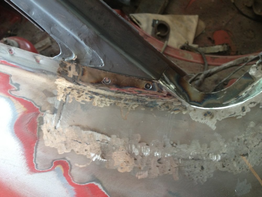

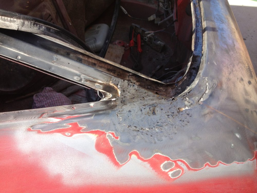

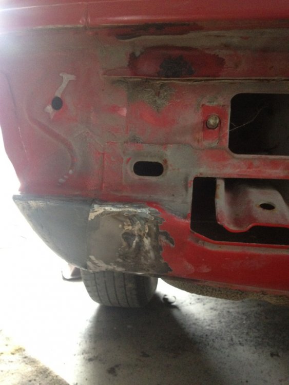

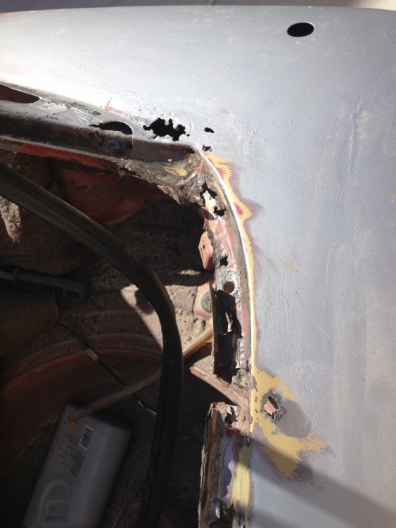

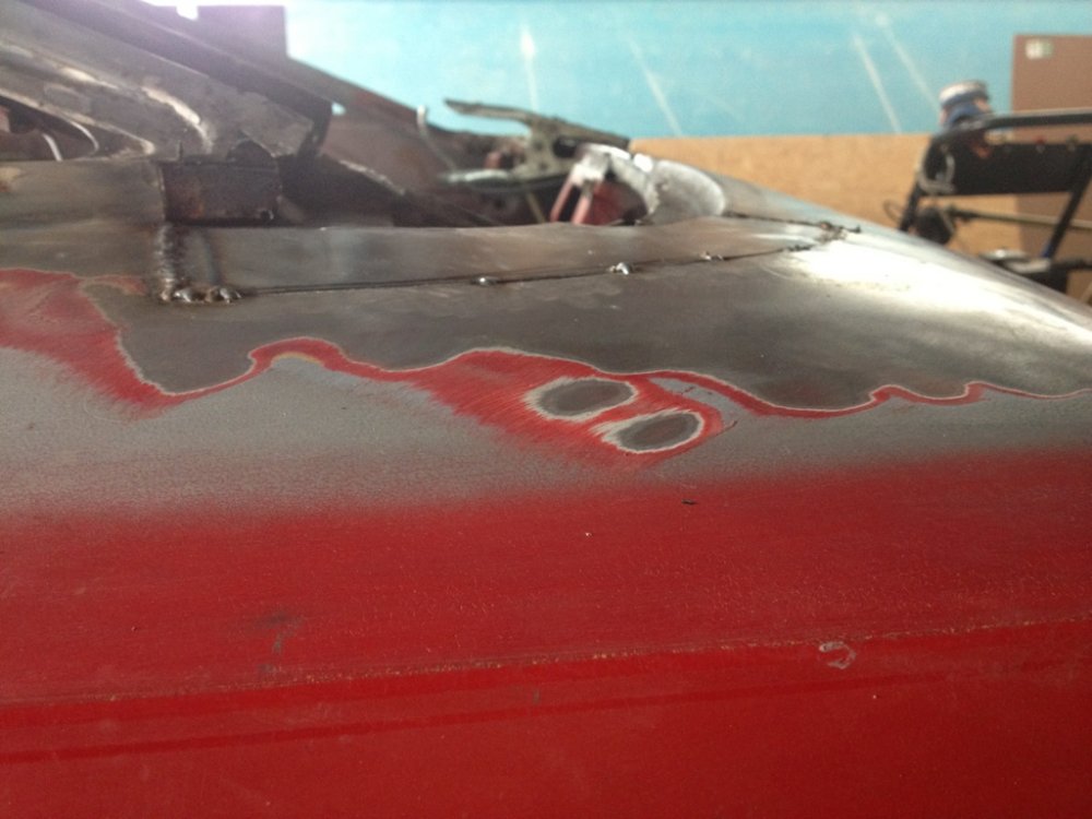

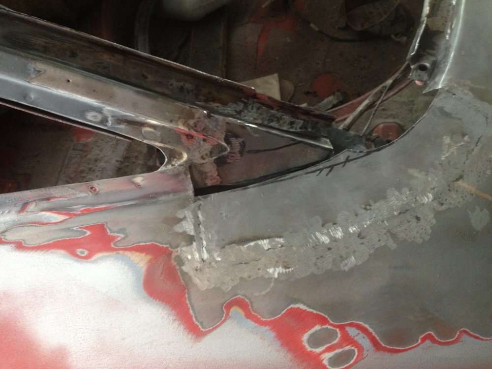

I tried turning a blind eye to the dodgy repair to the left side hatch area so welded all the holes. (it was meant to be a "quick fix" and back on the road)
Tried burning the rust out and spot welding the holes.
Yeah lot better but wasn't too happy. It will pass now. So I continued fabricating the rest of the gutter.

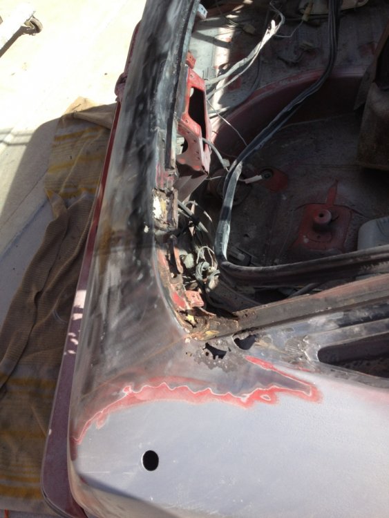

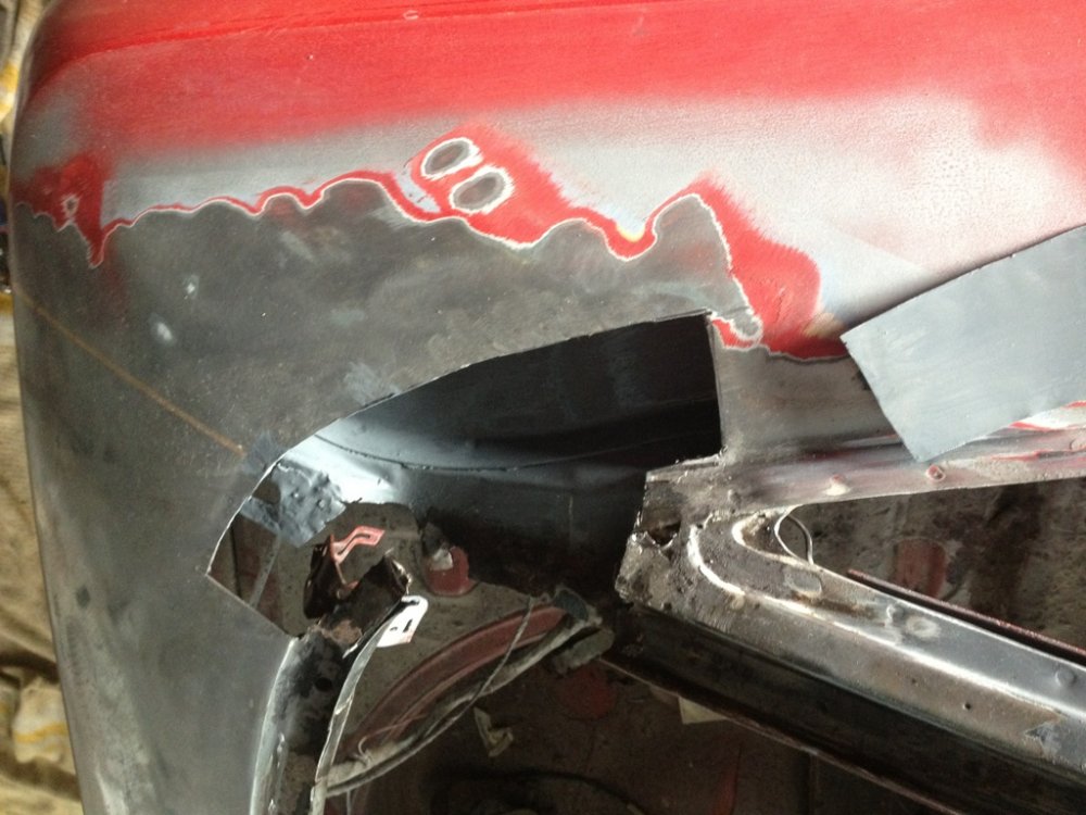

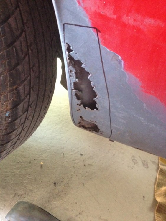

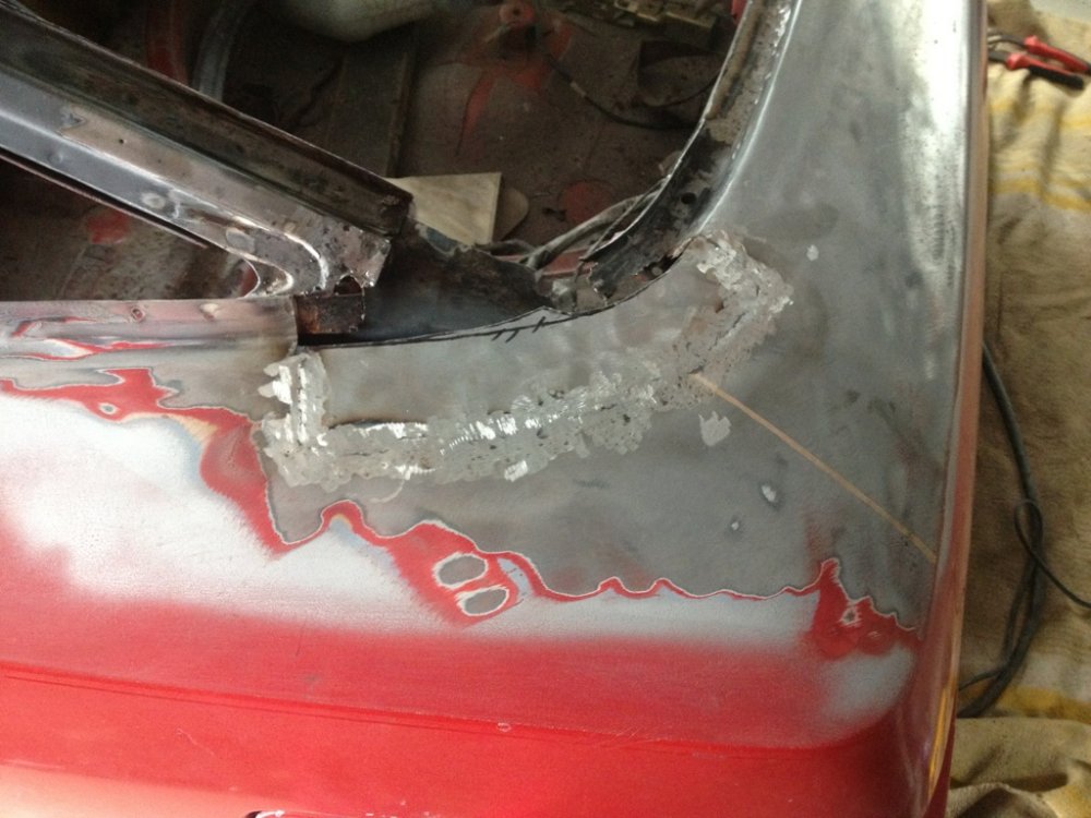

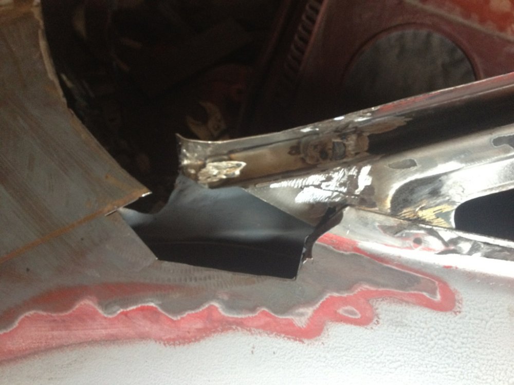

This turned out so well. I couldn't stop thinking about that left corner and what did I actually seal underneath all that crappy previous welded plating.

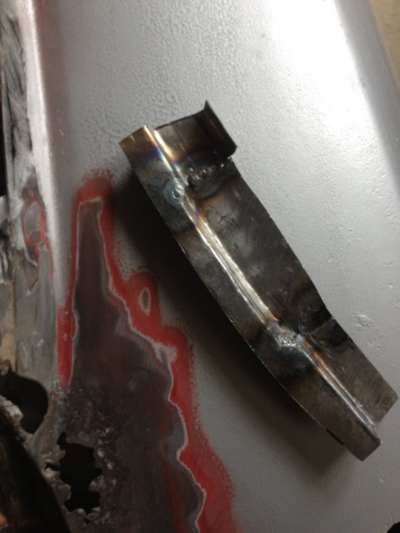

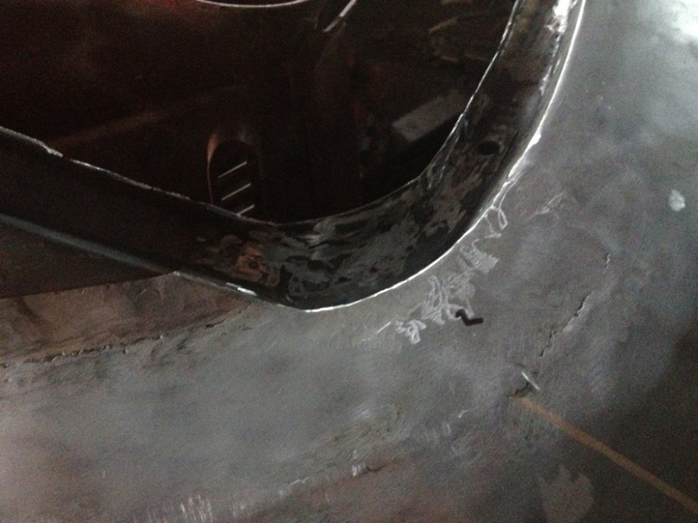

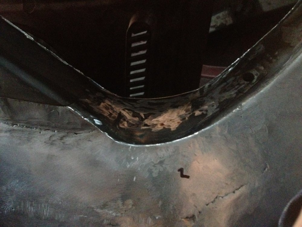

Couldn't hack it so got trusty grinder out to find out.

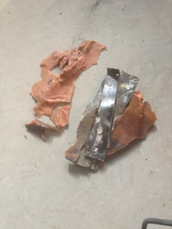

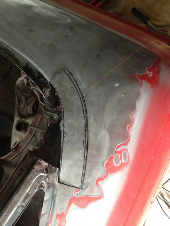

The corner is out. Lucky I did as there was more dodgy work underneath it.  The so called previous repairer just hammer the rust in and welded a galvanised fence sheet on top of it.  >:( it was rusting to buggery.

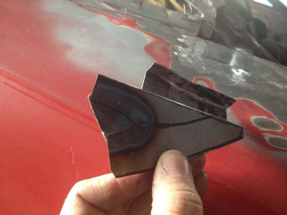

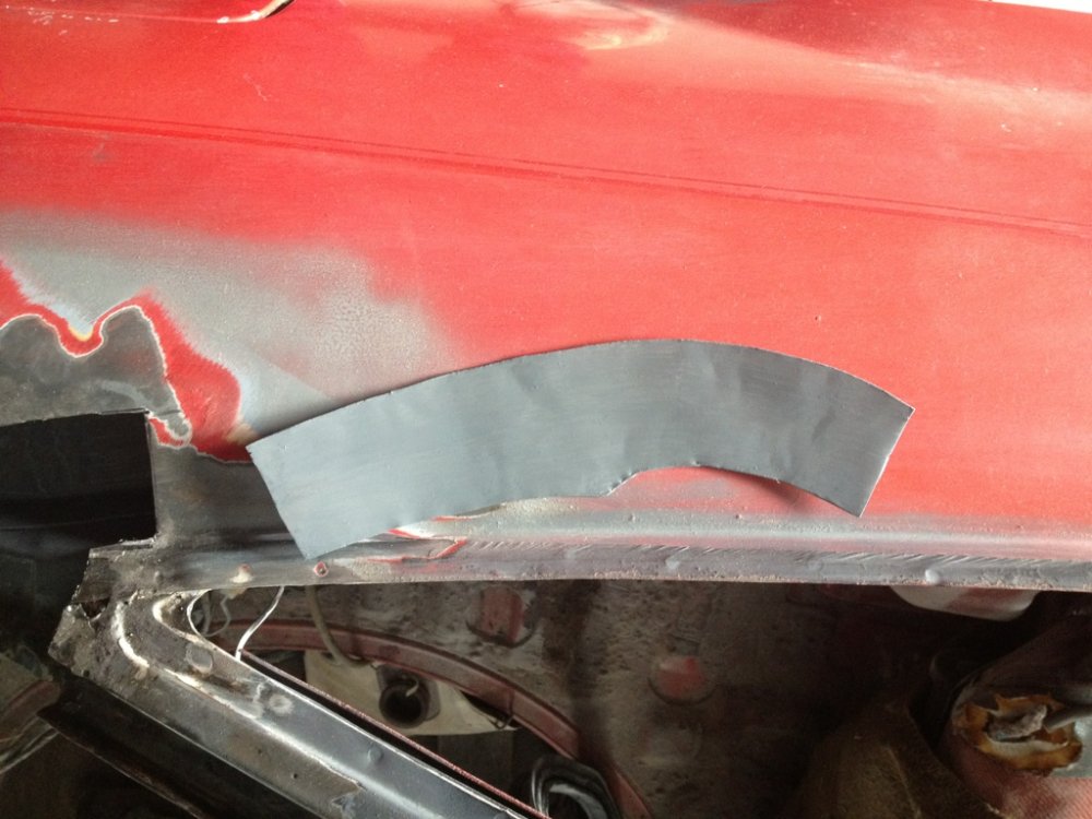

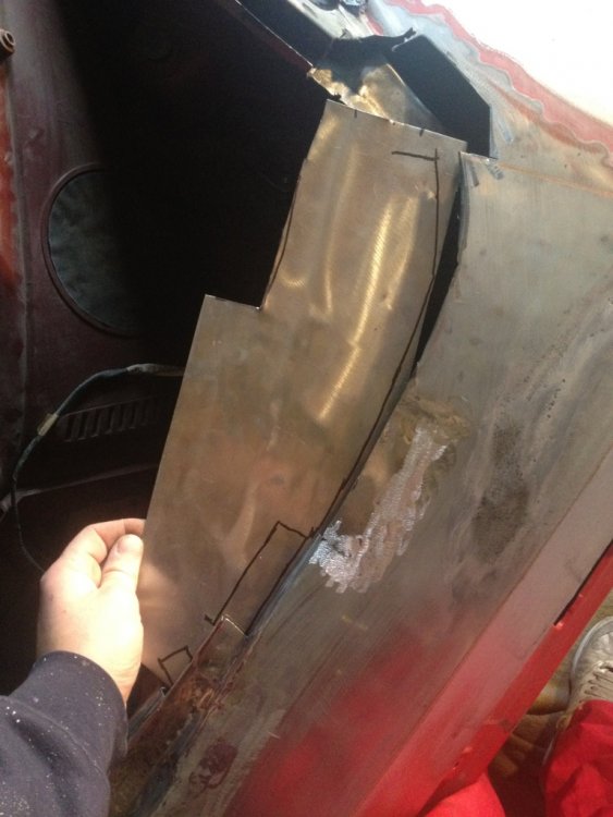

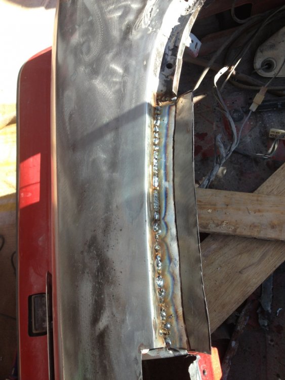

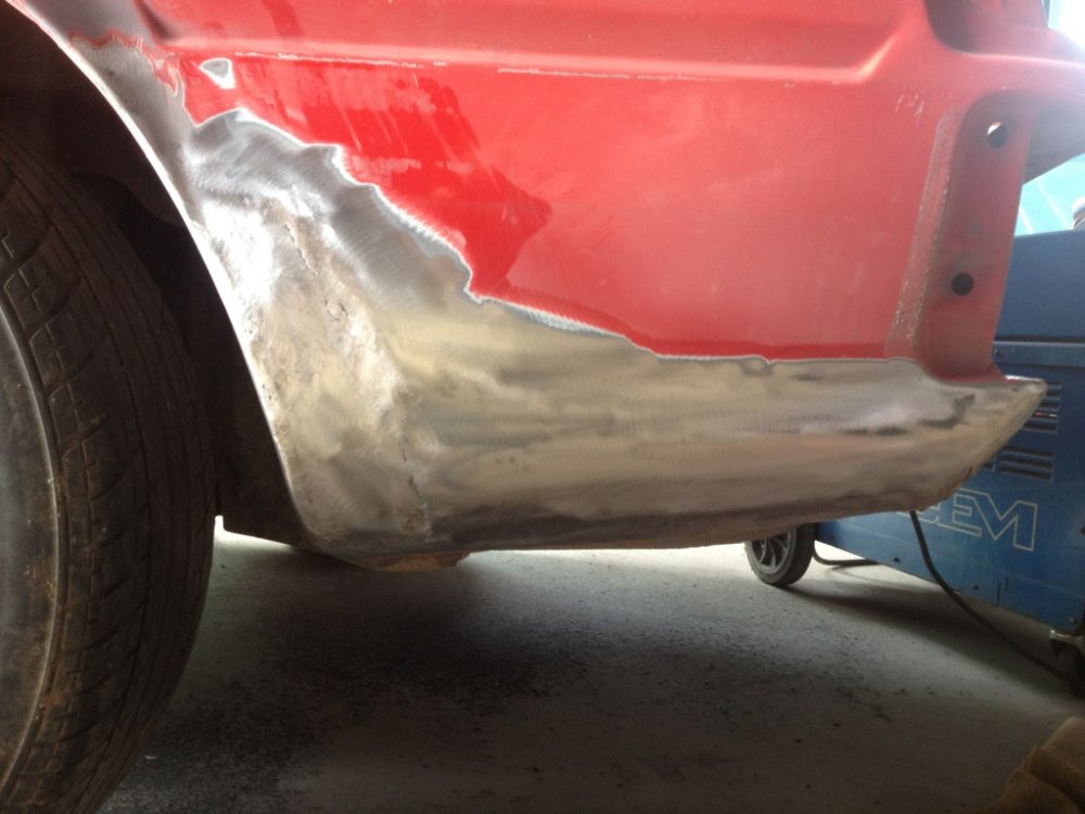

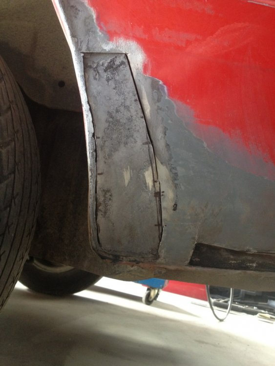

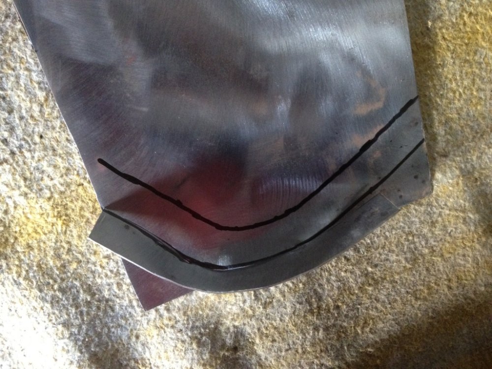

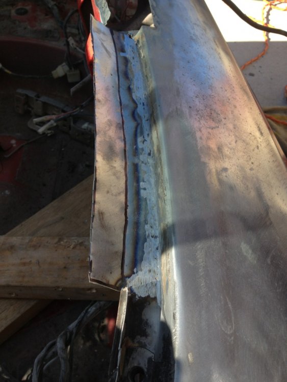

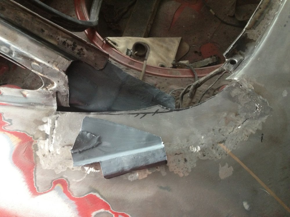

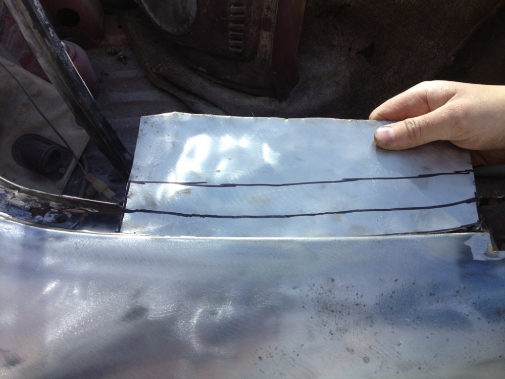

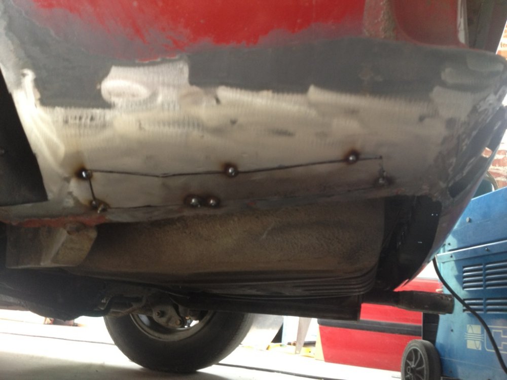

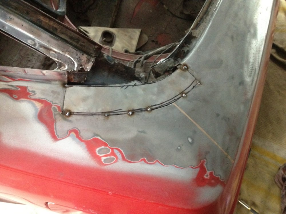

Next step was to fabricate the corner I just cut out. Thanks to the 240z rusty leftover panels that I cut out a clean peace to fabricate the corner
Ranex rust eater/converter was used to remove any surface rust in surrounding areas and than coated with Wattyl Super Etch primer before welding in.
Few tack welds to keep it in shape and correct position
checking the profile

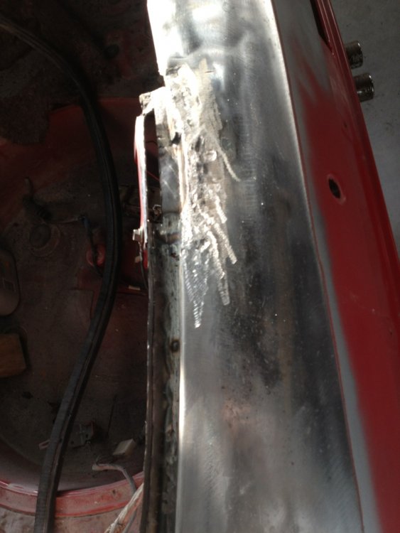

all welded
little bit of grinder time to annoy my neighbours  ::) also to make it look pretty and feel smooth
That's it for today. Next fabricating the inner corner and the hatch gutter.

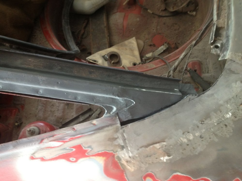

so bit more on the Rx7.

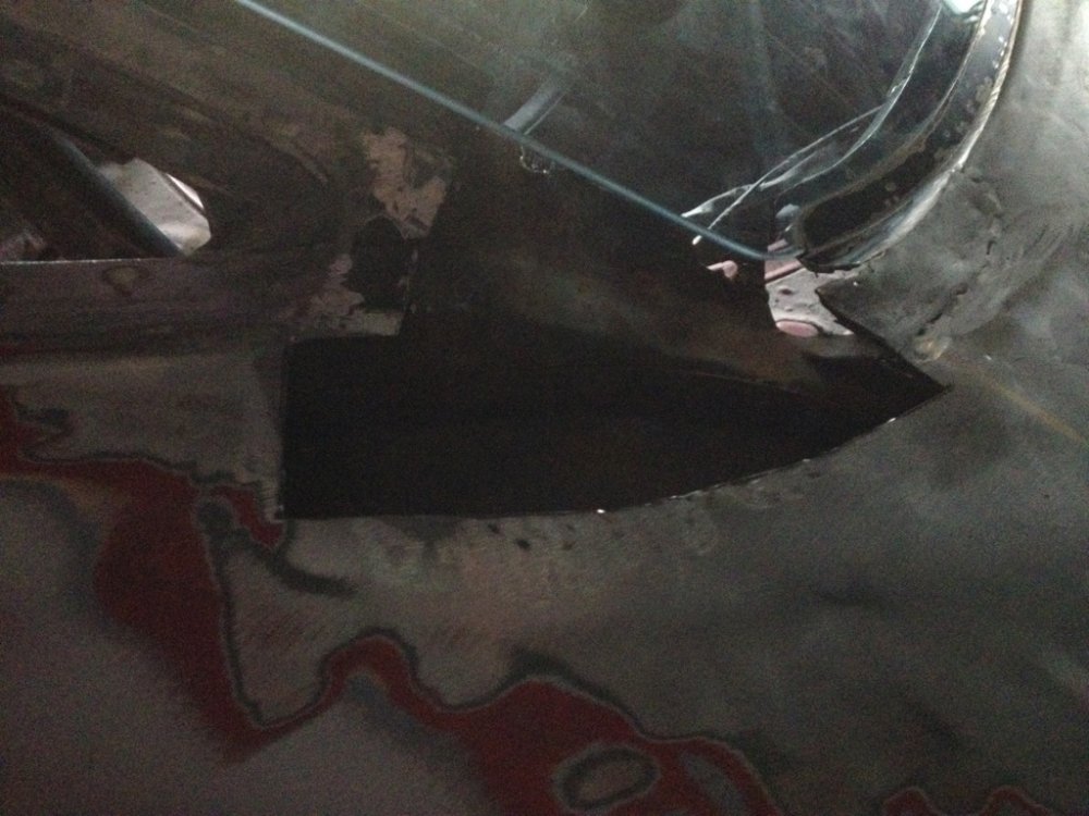

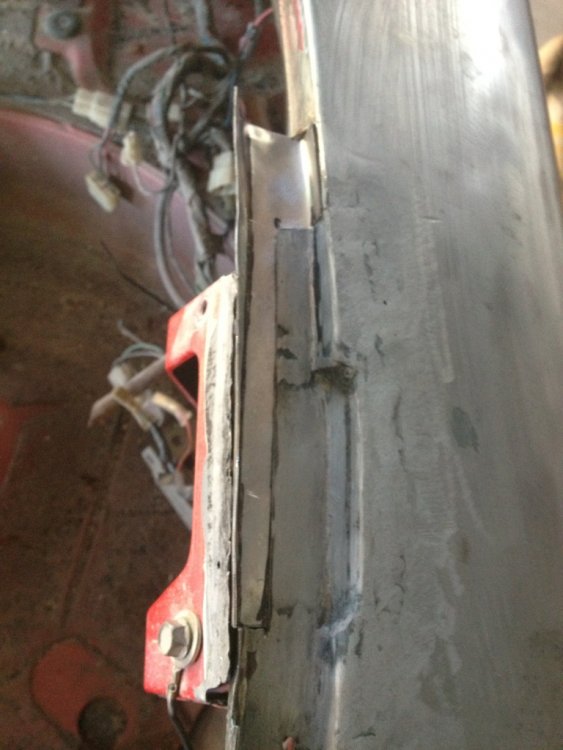

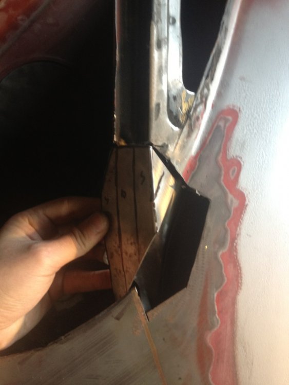

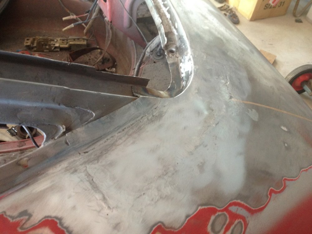

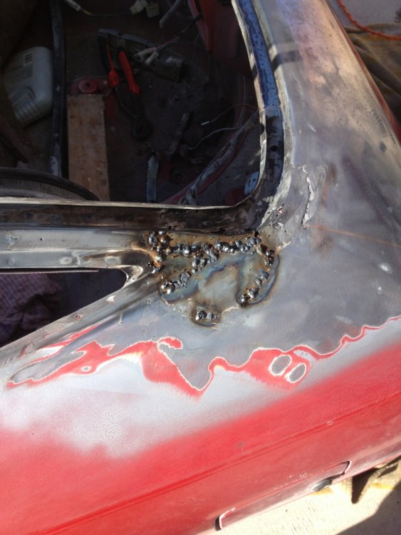

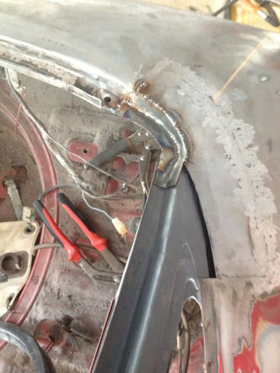

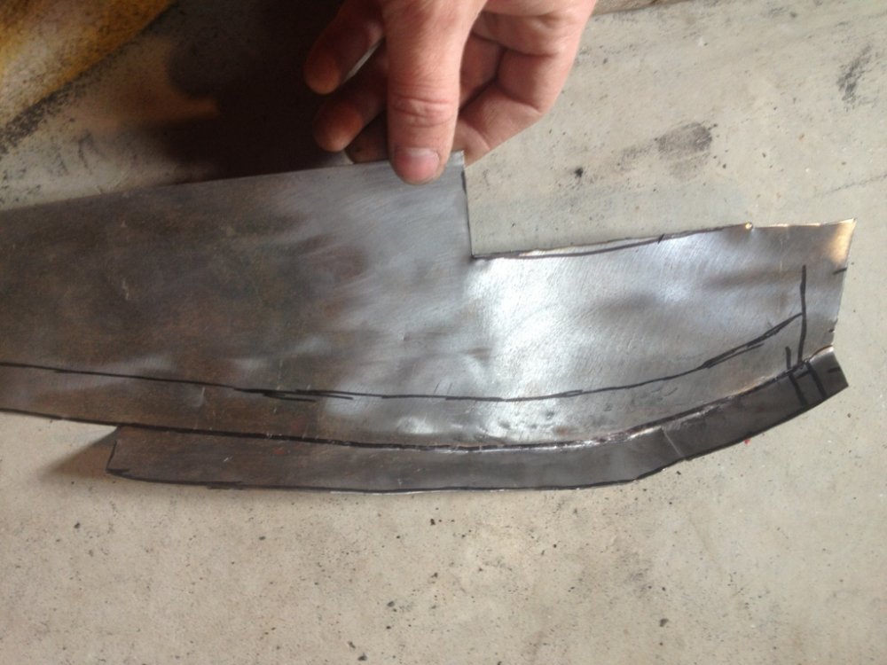

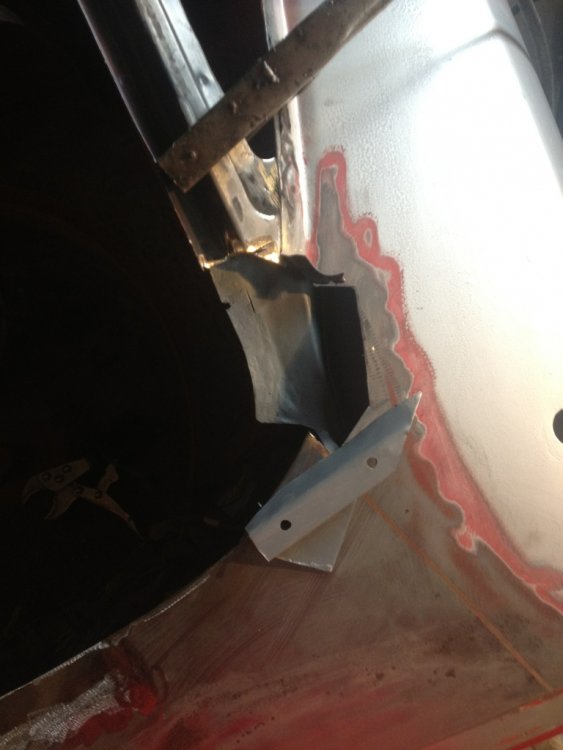

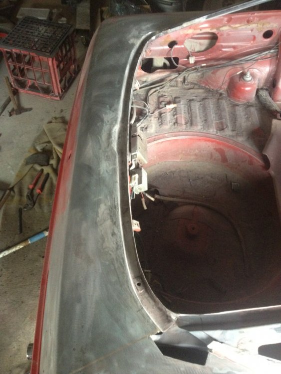

The left inner section replacement

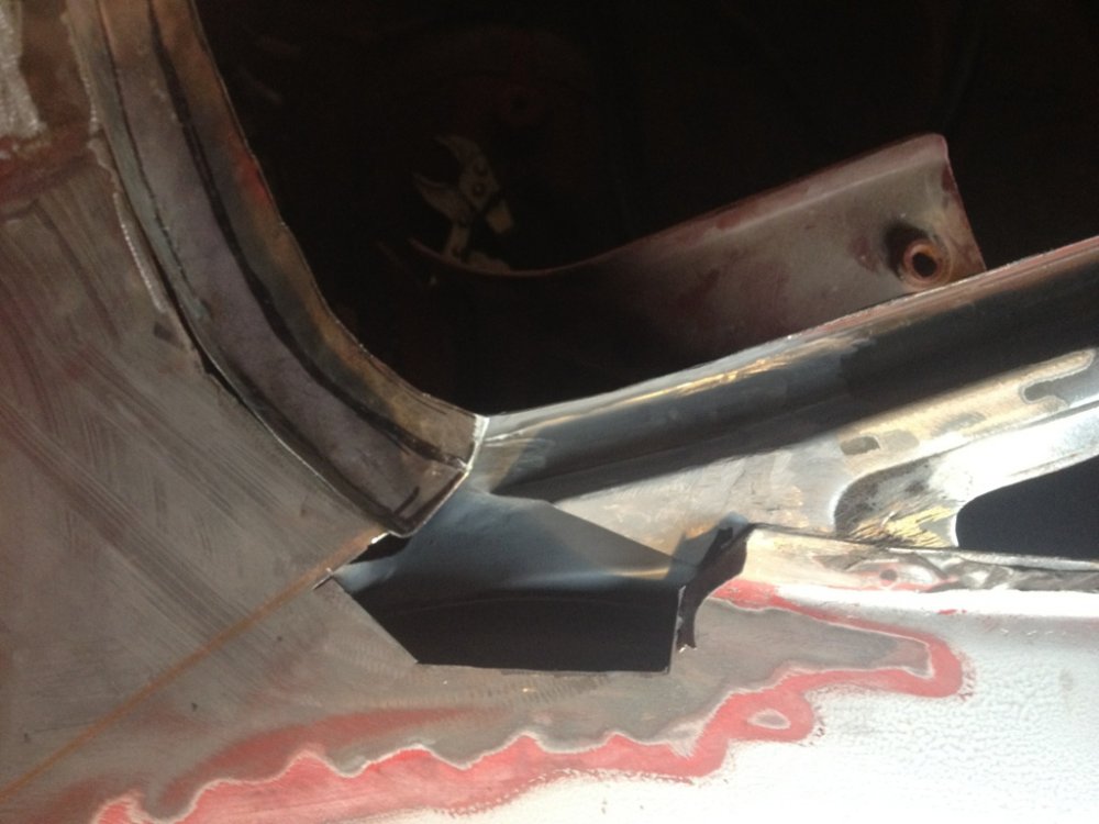

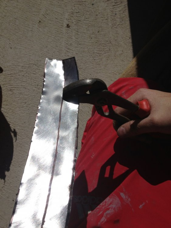

the inner gutter corner section (was a pain definitely need to invest into shrink/ English wheel tool)

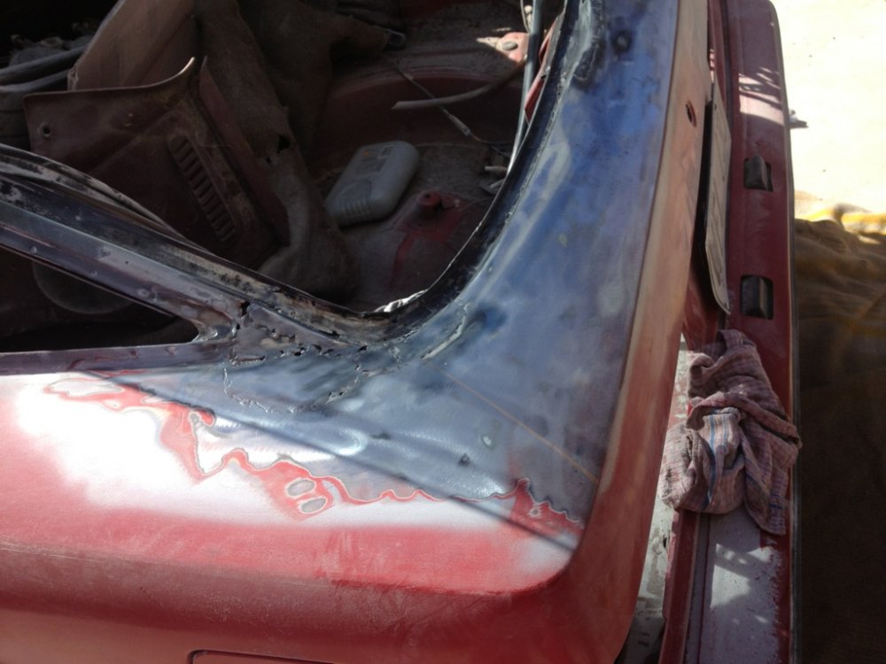

Finalising the top section of the 1/4 panel and gutter channel

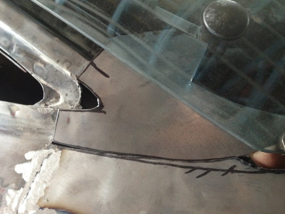

Now the bit I somehow missed to see.
that finalises the Left side of the rear 1/4 panel now to the right side and that tailgate gutter.
now before welding in the above i thought better finish of the inner panel on the left side

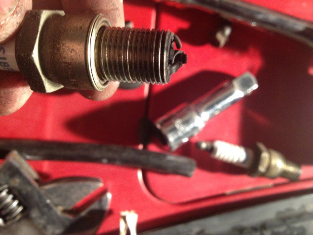

Decided to take the plugs out de-flood it so I can hear it run again. This seemed to have worked with previous owner.
took the first plug out and was soaked with fuel.
once cleaned i noticed this
This can not help in starting it first go. Took the other ones out and out of 4, 3 had damaged spark plugs.  I remembered when I got the car that were 4 boxes of NGK plug hidden under the seat. Once opened the box they were brand new ones. once I cranked the engine without spark plugs and got most of the fuel out of it replaced it with new plugs.
Hit the Start key and she purred (buzzed) to life burning off lot of excess fuel. Once the fumes and smoked cleared and engine warmed and choke disengaged noticed the revs were a bit too low since all my vacuum repairs. decided i leave the tuning and to later date and probably hand it over to the experts.

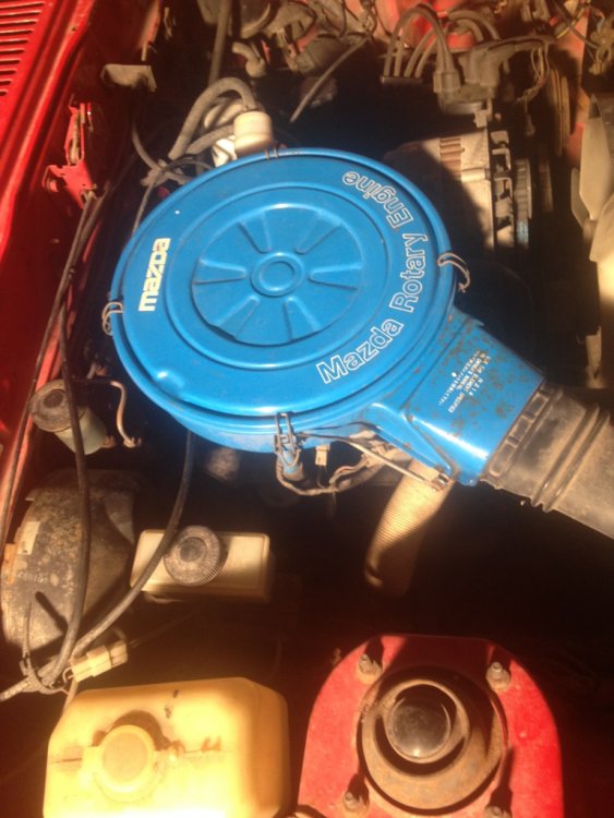

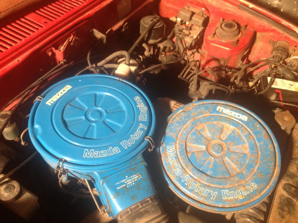

bought few bits for engine bay to "bling" it up a bit.
New filter cover vs old

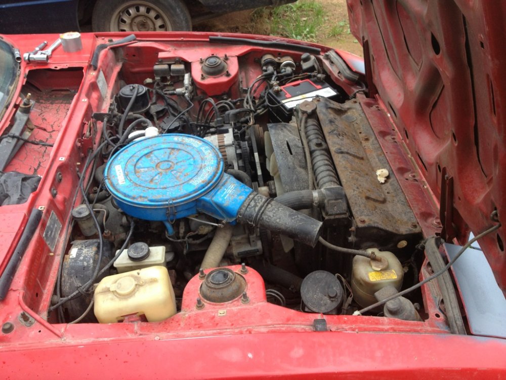

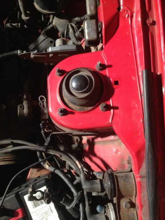

As from earlier pics engine bay is in need of TLC. Sprayed bit of Septone Ripper on few sections to see how bad it is under all that muck. to my suprise check the results.
Not sure how many of you guys used Septone Ripper before. Its awesome product.
with above I sprayed it, left it for 2min and wiped it with cotton rag. no water.
from de-greasing engines and engine bays, to cleaning upholstery (any cloth) and vinyl from oil and other nasty stains you may have in your car.
It works wonders almost as good as wd40 for 100001 uses for cleaning around cars or homes. Stained your shirt with oil or blood. Spray some Ripper and see it disappear.

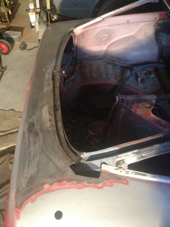

Ok where was I.

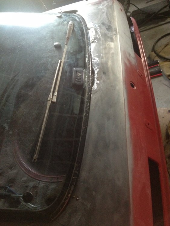

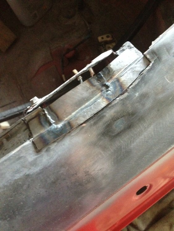

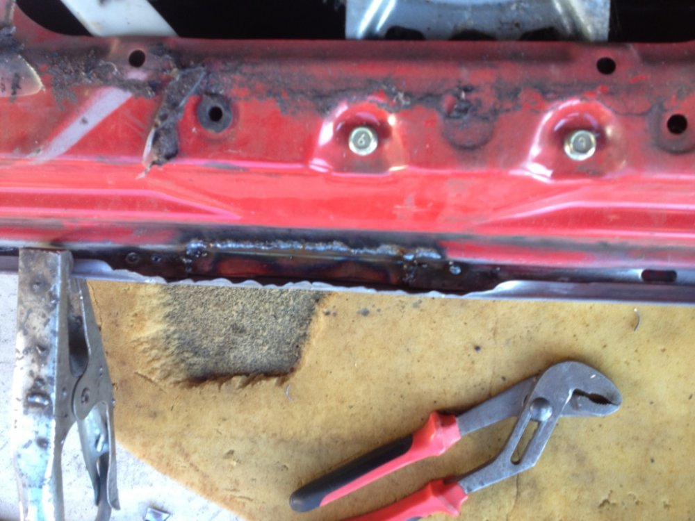

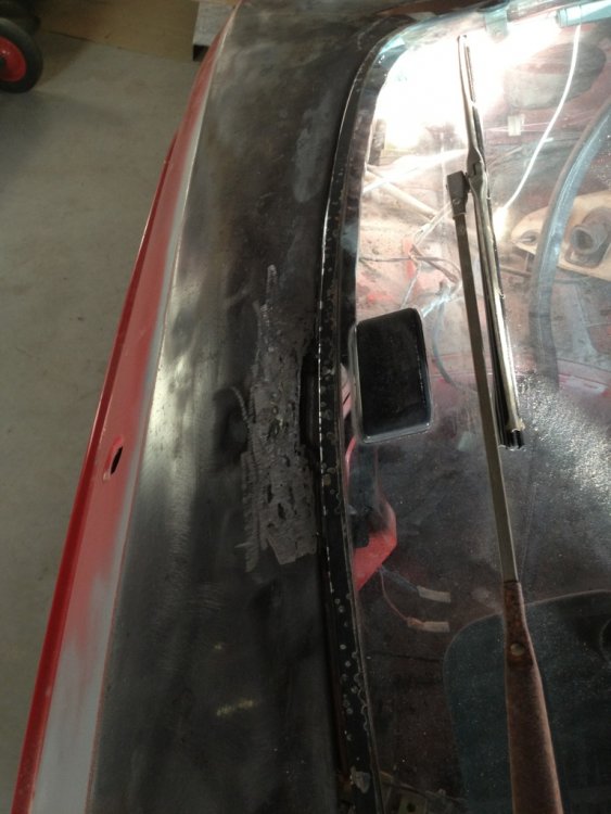

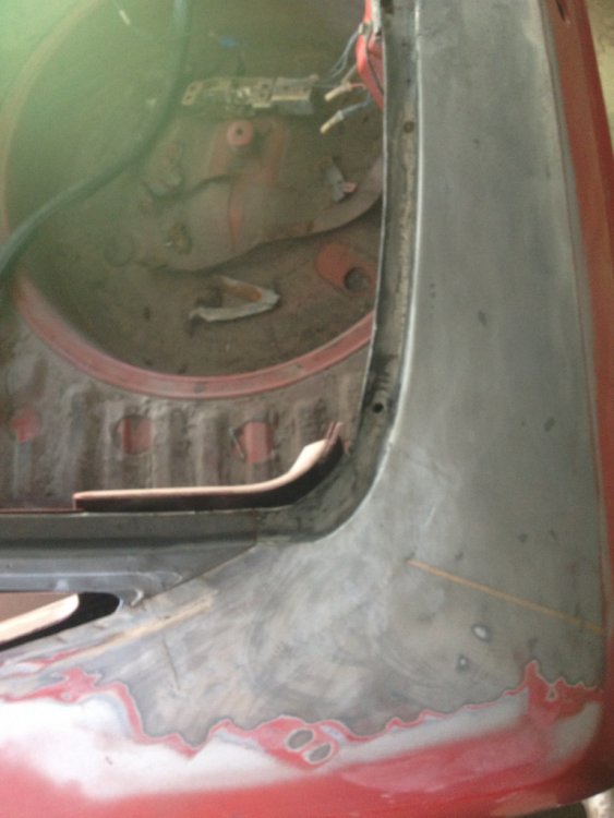

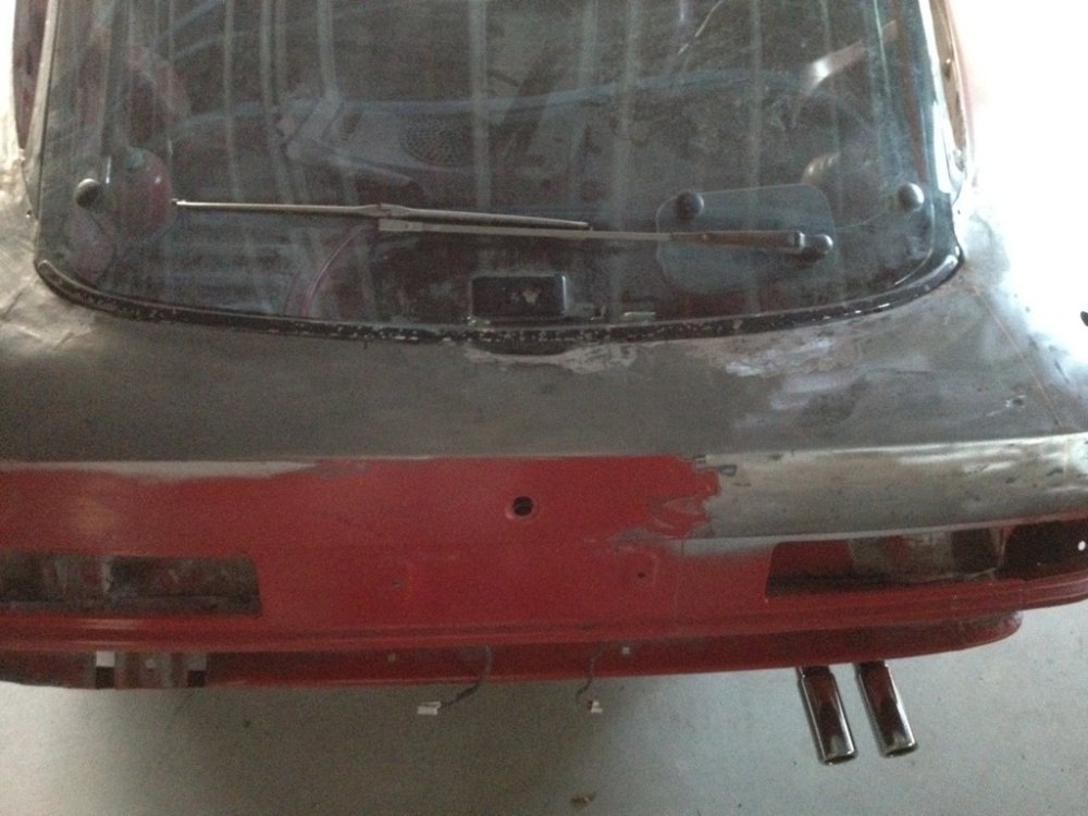

oh the tailgate channel thingy.

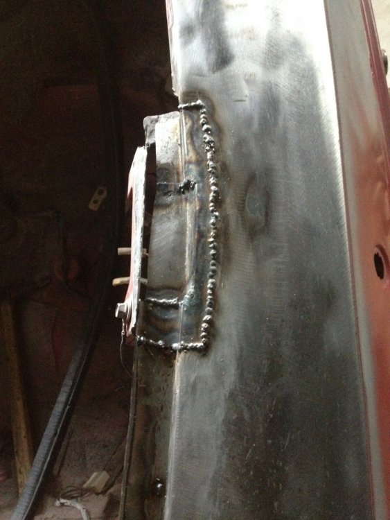

Drain and Interior brackets welded in.
the hatch area completed

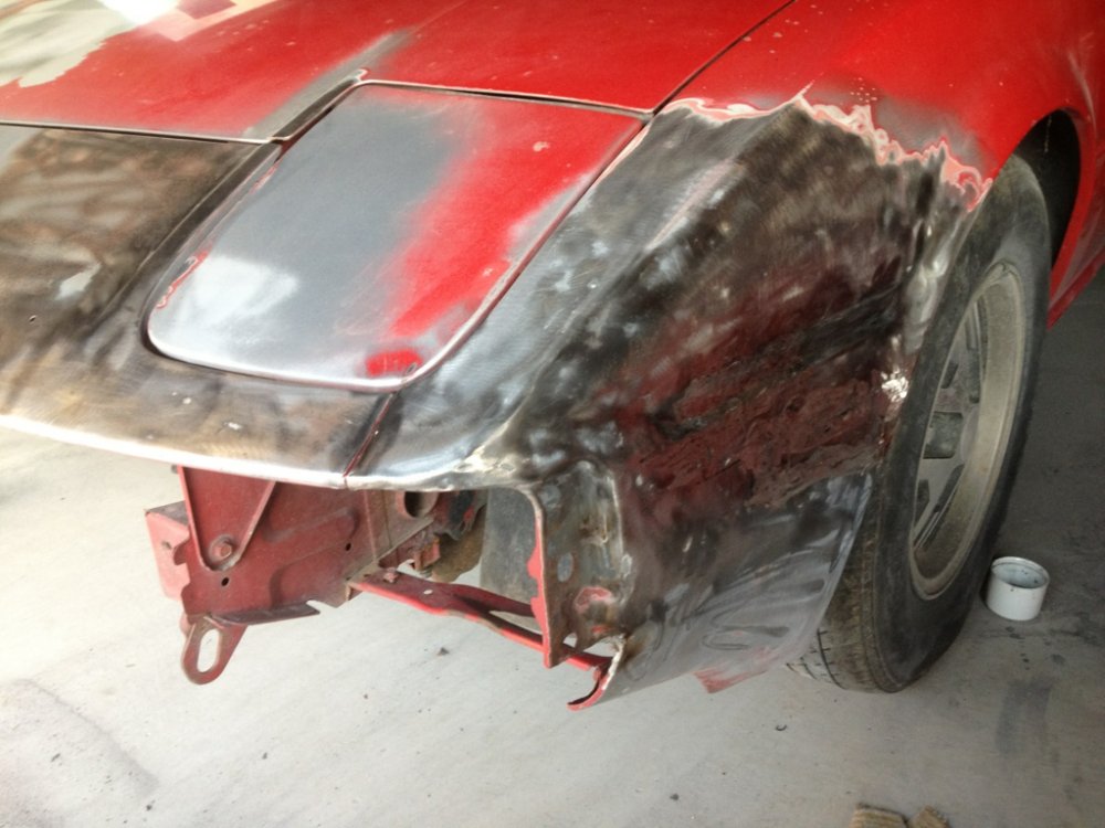

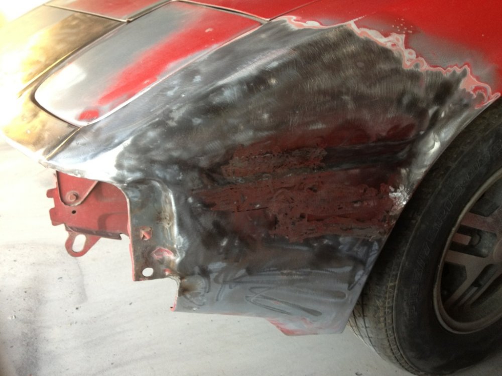

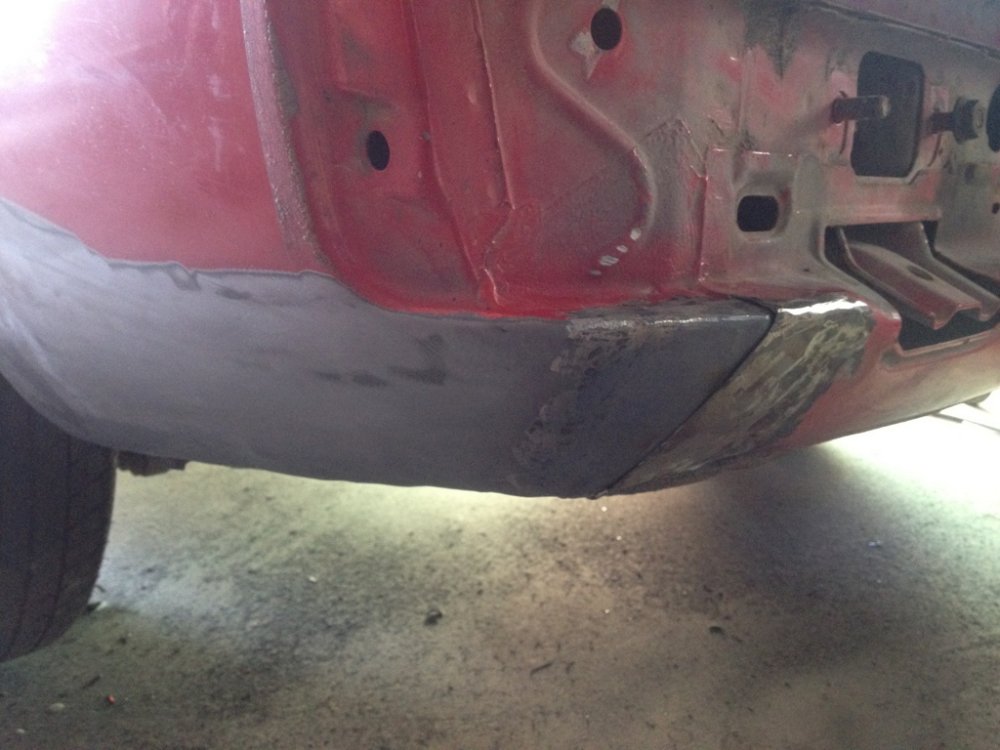

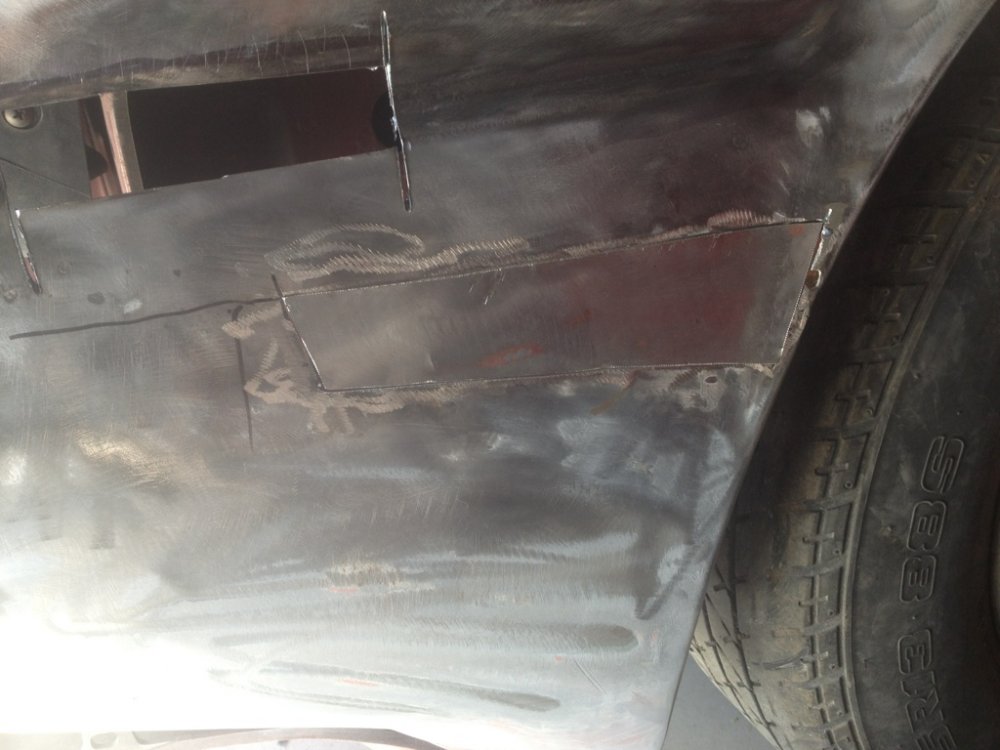

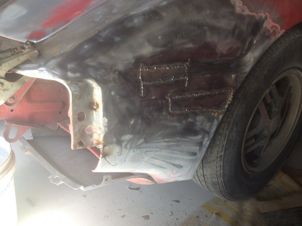

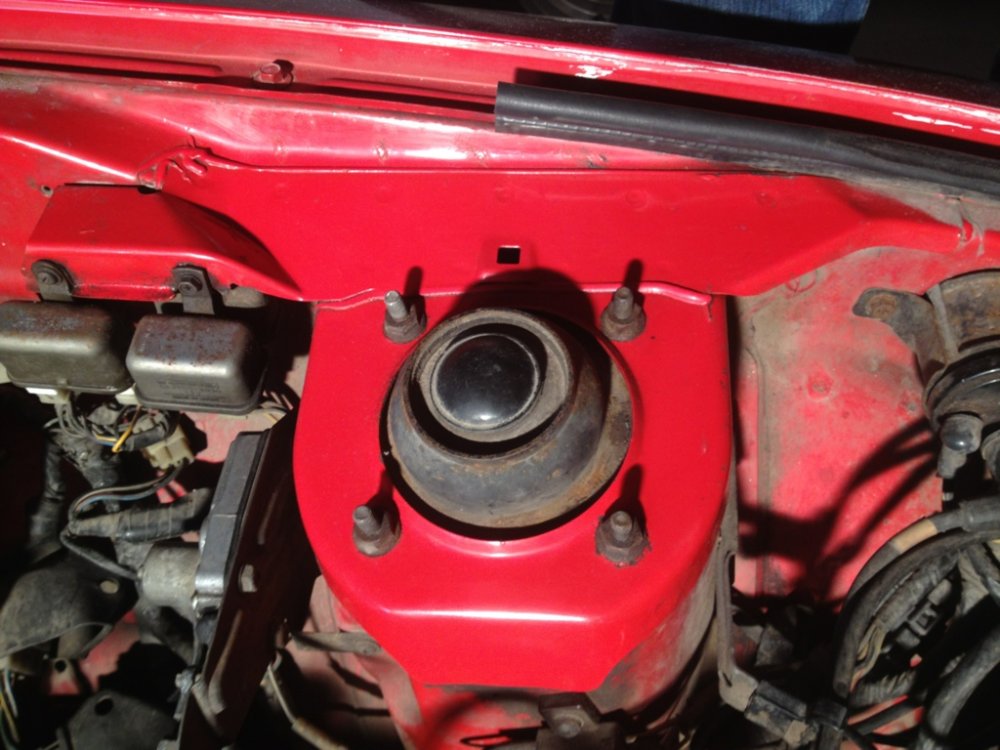

and the stuff that was behind the front guard previous repairs done by some "professional"
my repairs

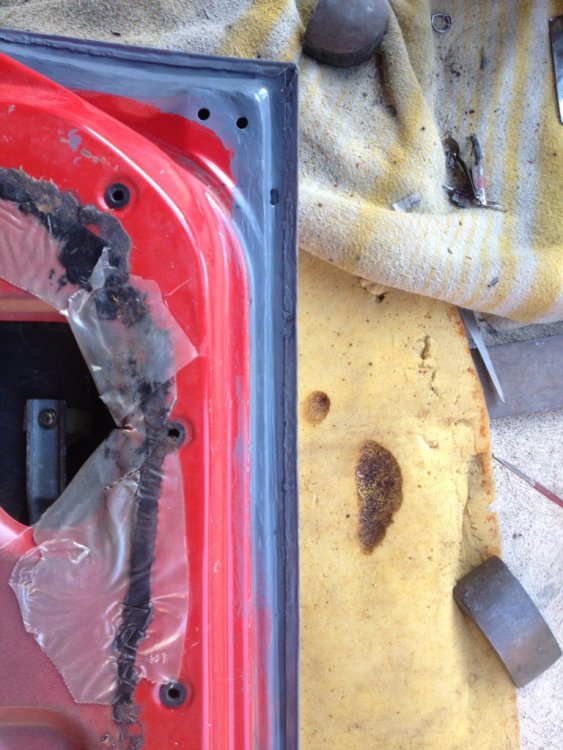

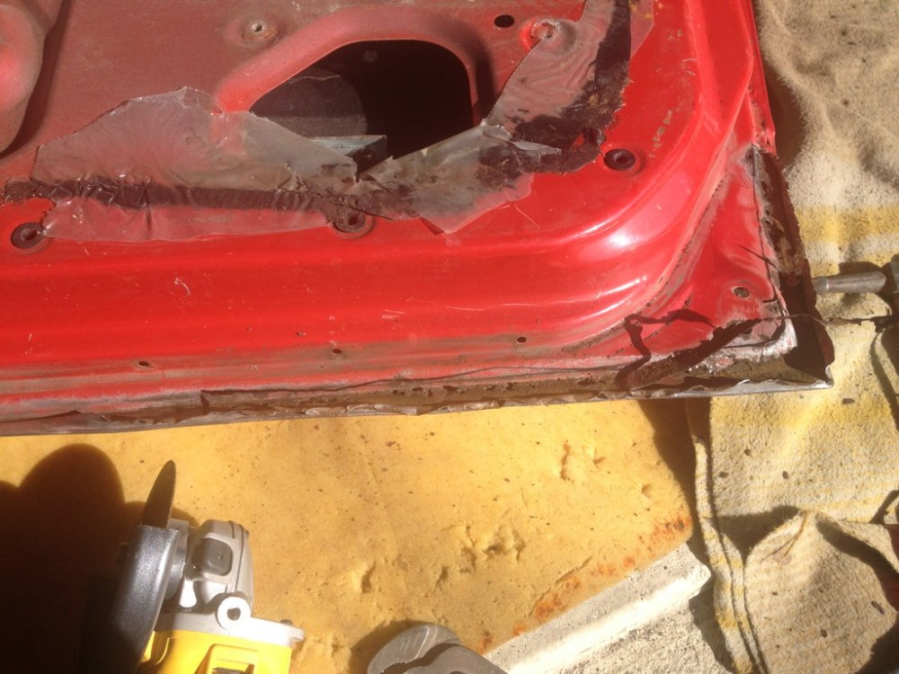

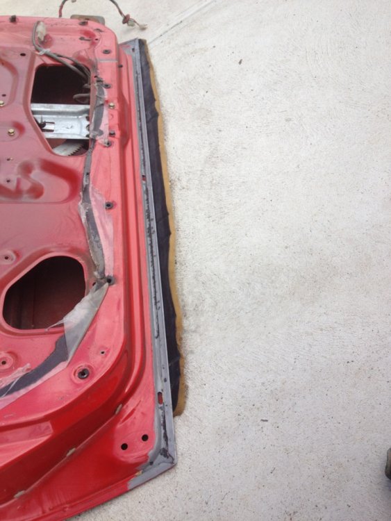

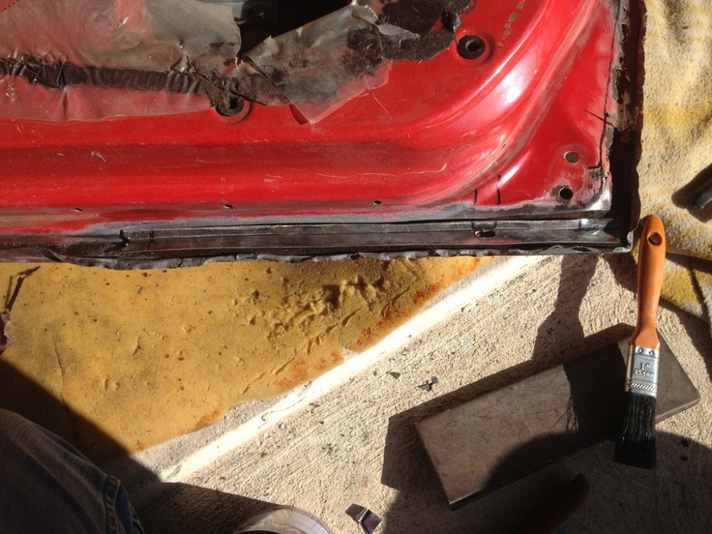

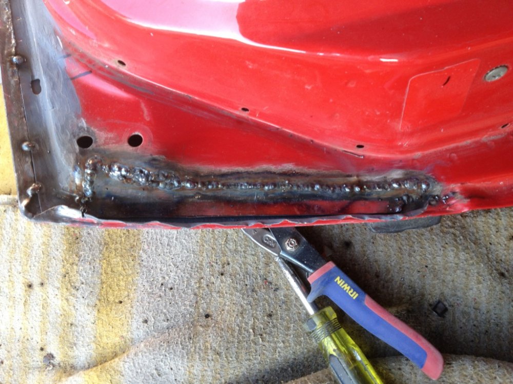

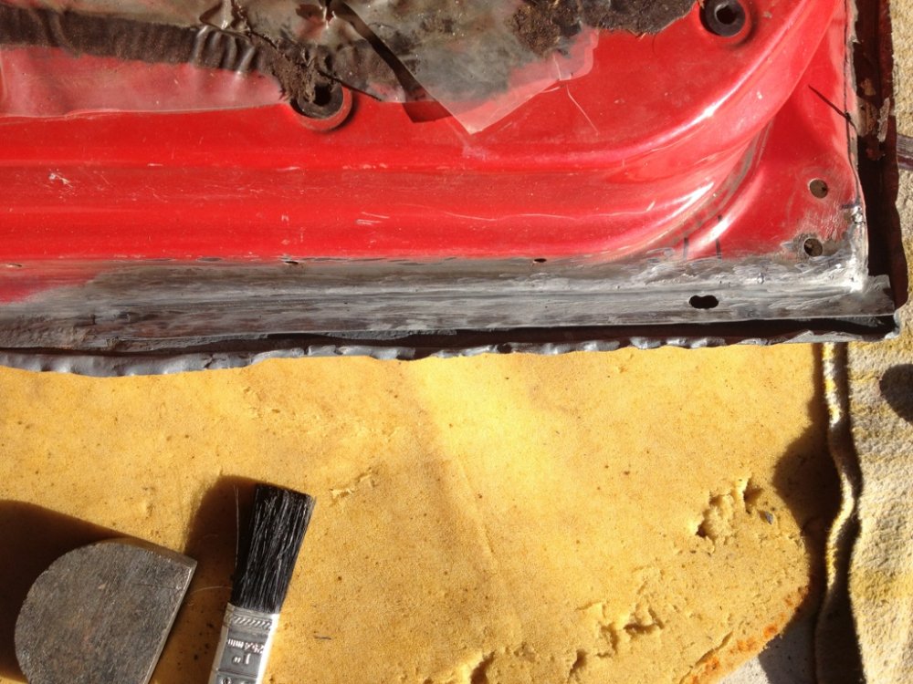

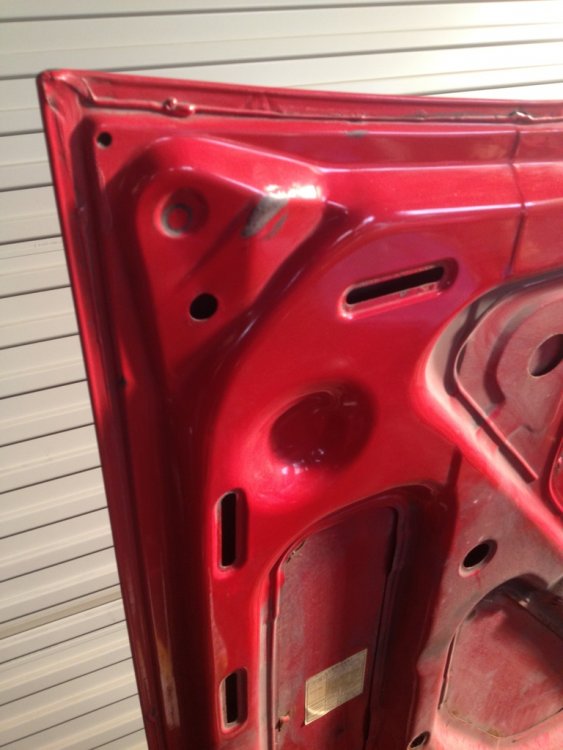

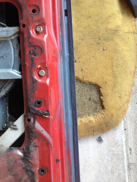

Now the original doors on surface looked good. but the inner panel was very rusty. can be fixed but as it came with two spare doors wasn't going to worry about it.
the passenger door was good with slight surface rust. that i cleaned up quickly
the driver door was not as good. but better than the originals.
now the repairs
that finalises the rust repairs.

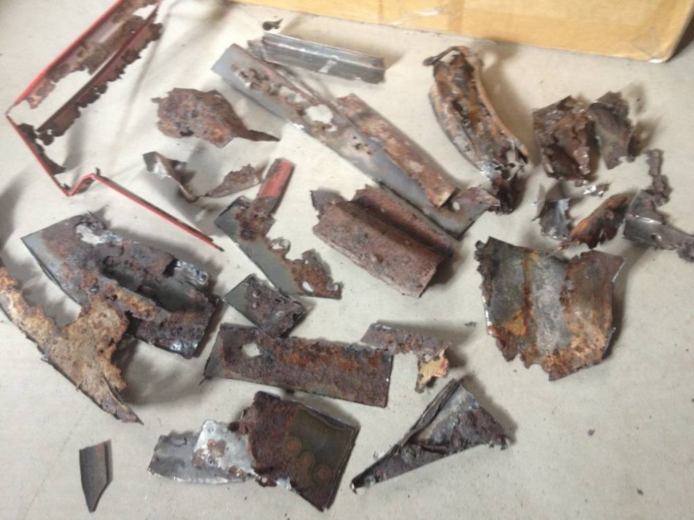

these are some of the bits I cut out there was more but I chucked it before the pic moment

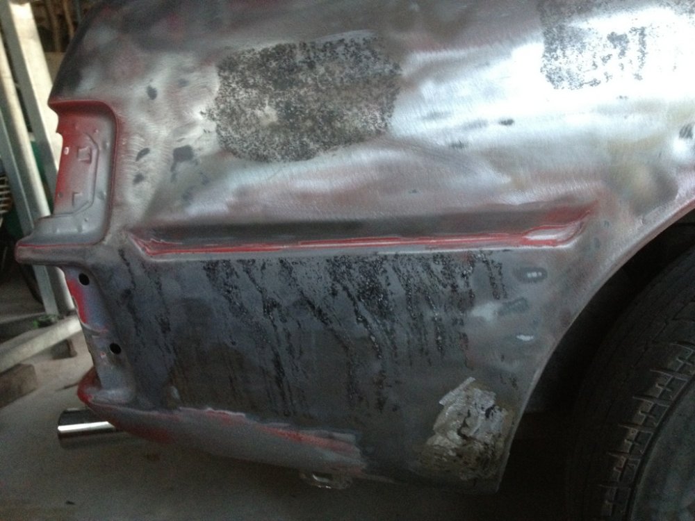

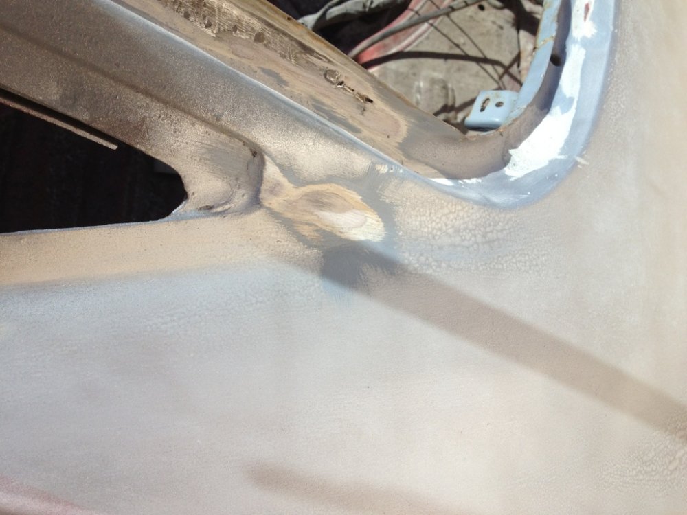

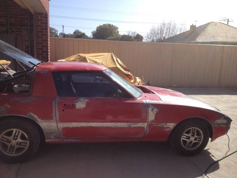

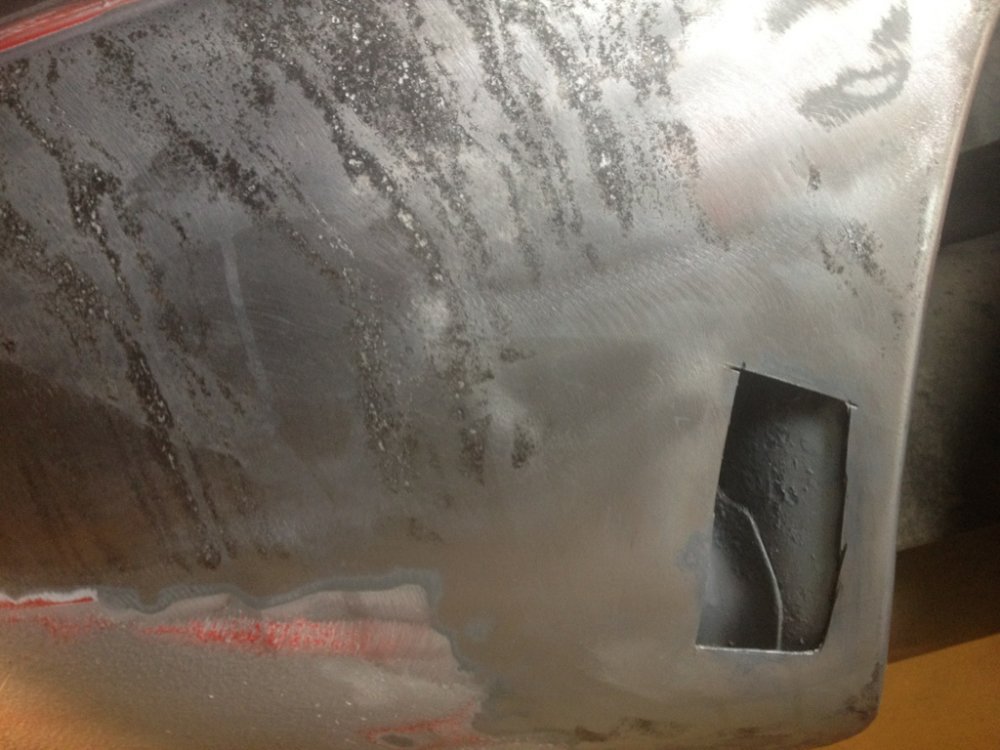

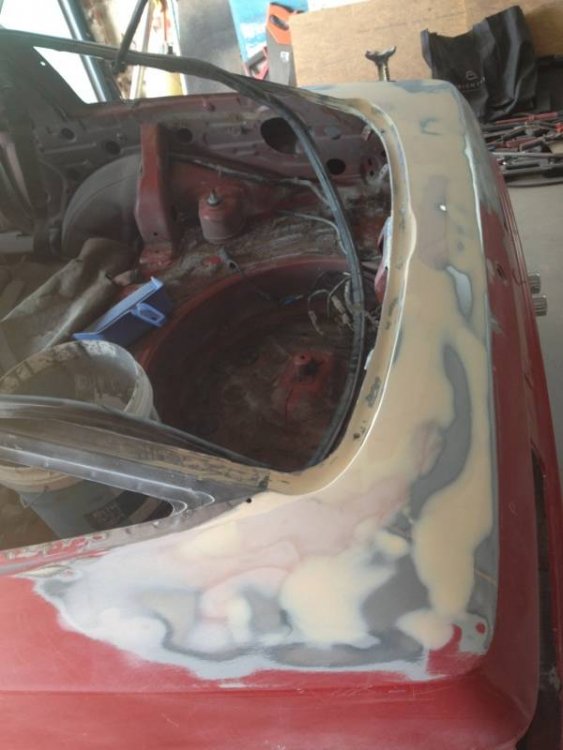

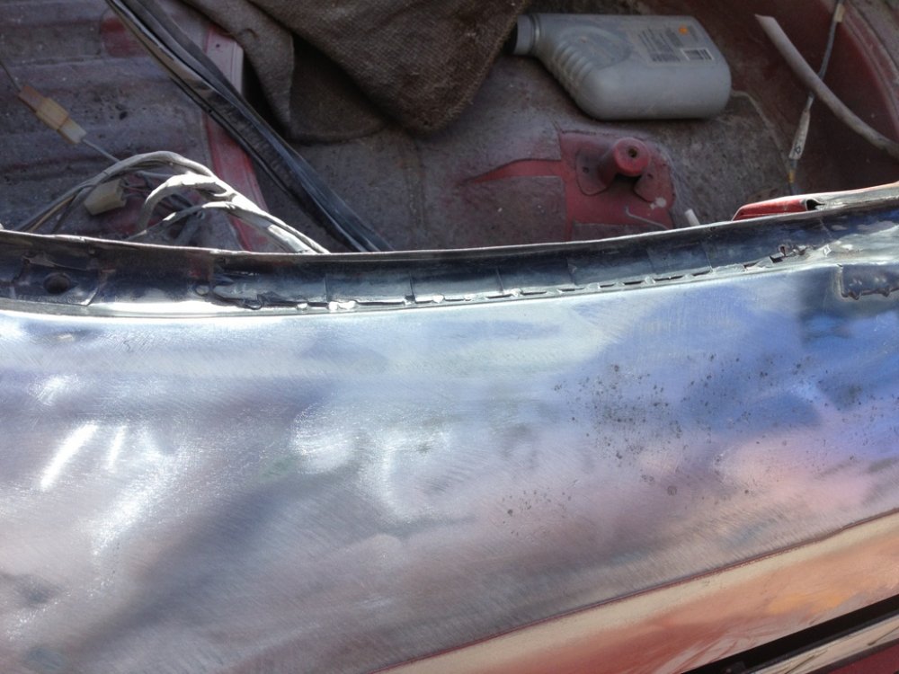

now the boring and annoying body filling and prep work for paint.

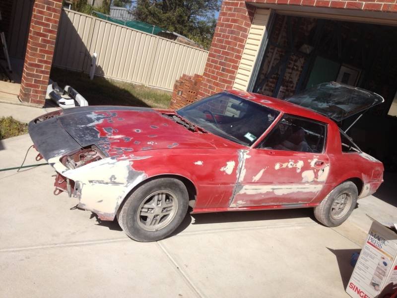

Bit of an update. Yes have been working on it over the weekend and still no primer on it.  >:(
as this stage is least of my favourite parts in car rebuilding its taking bit longer for few reasons:
1. I hate it
2. I really hate it.
3. To anal about getting it right so some sections are redone several times.
4. Physically demanding. using power tools may be quicker but lot easier to get the shape wrong too. So I prefer good old hand sanding. My health not the greatest so its not helping at all.
maybe 3-4 hrs still to do final touches and she be ready for primer in a day or two. Next Saturday hail, snow, pigs flying etc.... shes getting colour no matter what.
ill post one or two pics that i took just to show work is being done.

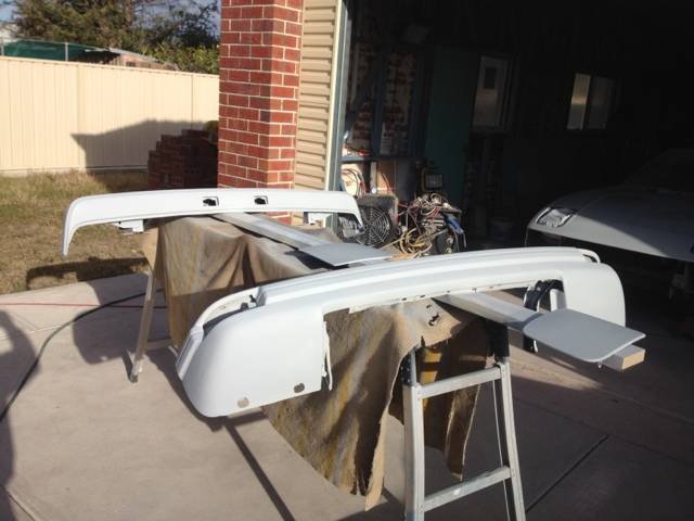

and some parts arrived for my 240z projects. thanks to ebay.
ZG rear spoiler. love the rear sticker that is on it, so true.  ;D if previous owner of the spoiler is on here , cheers for good packaging.

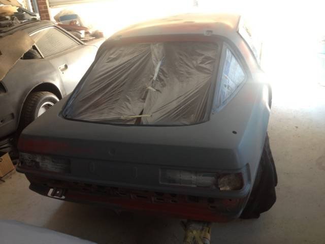

that enough for now. hopefully next set of pics the car would be gray.
  • 2 weeks later...

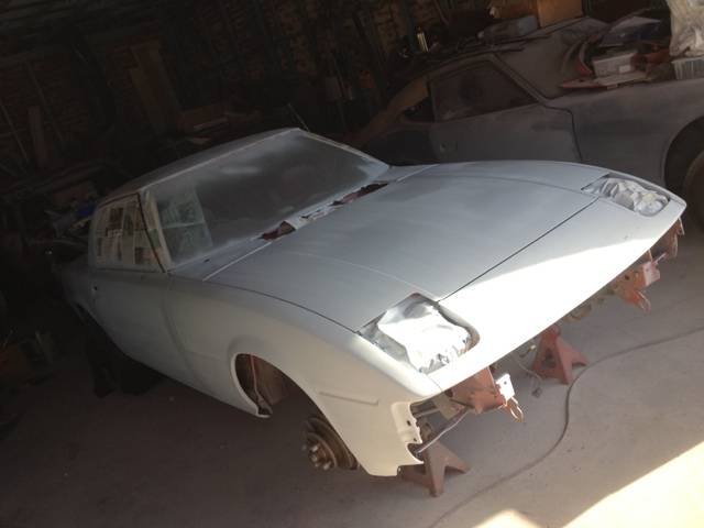

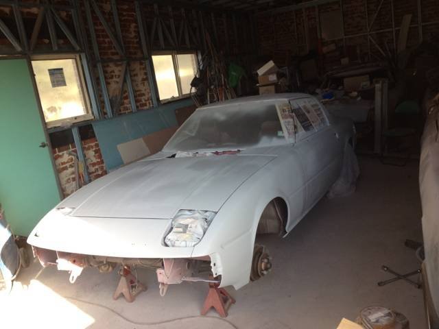

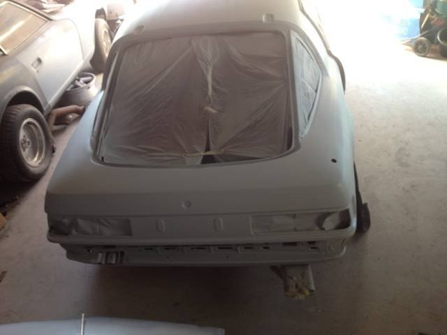

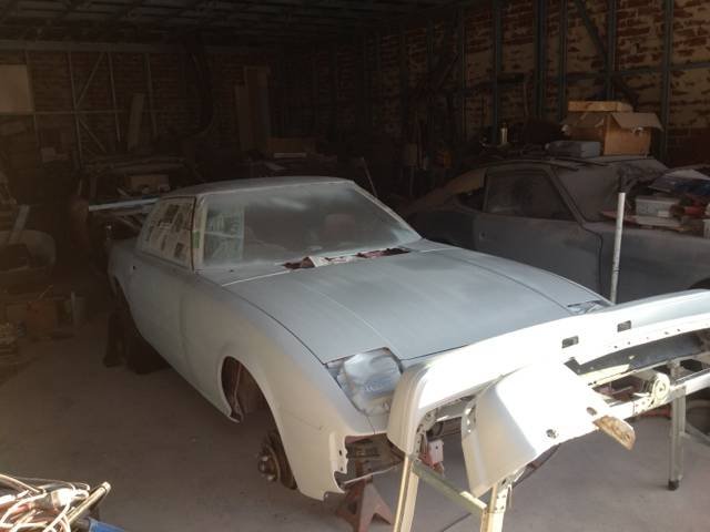

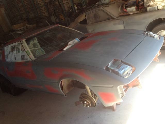

Last weekend was hectic but managed to get it done.
We have primer now.
First bit off etch primer to cover the bare metal
Than 2pk high fill primer over the whole car and bumpers.
Next bit of sanding after work.hopefully all turns out well than on weekend colour goes on. Finaly I can see little glimpse of bright light at the end of the tunnel.
