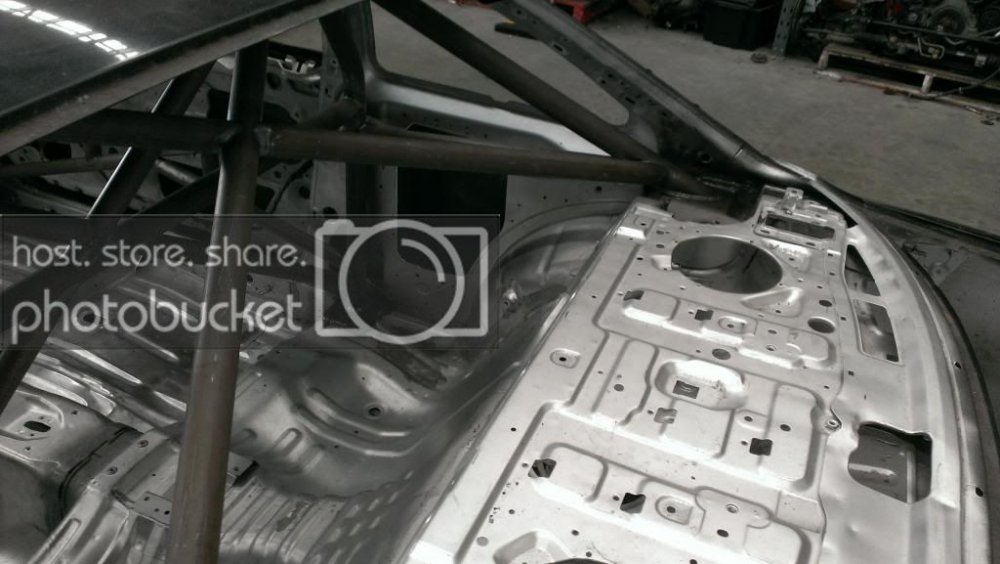

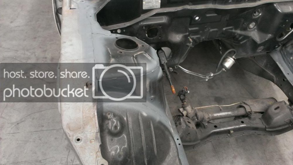

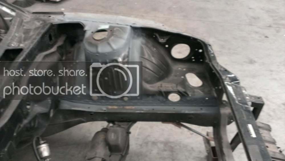

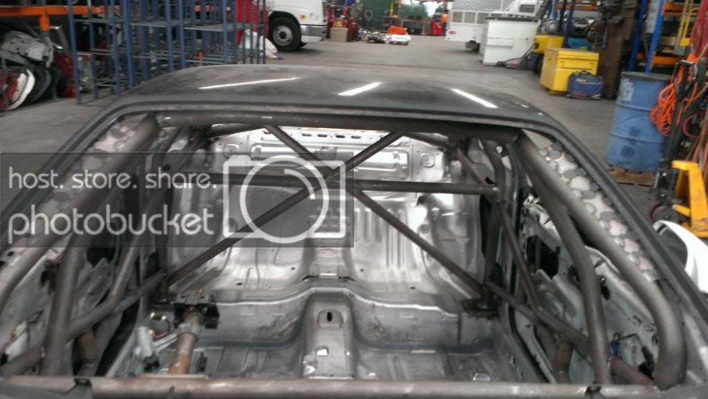

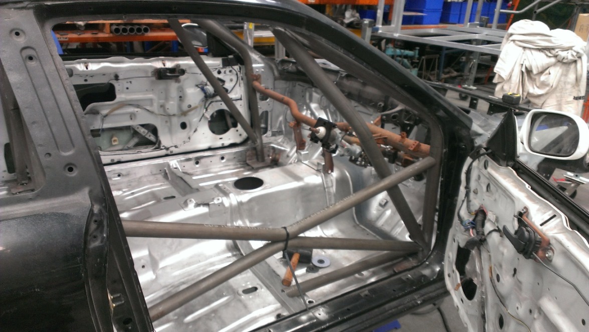

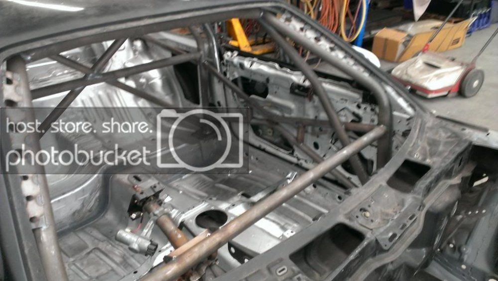

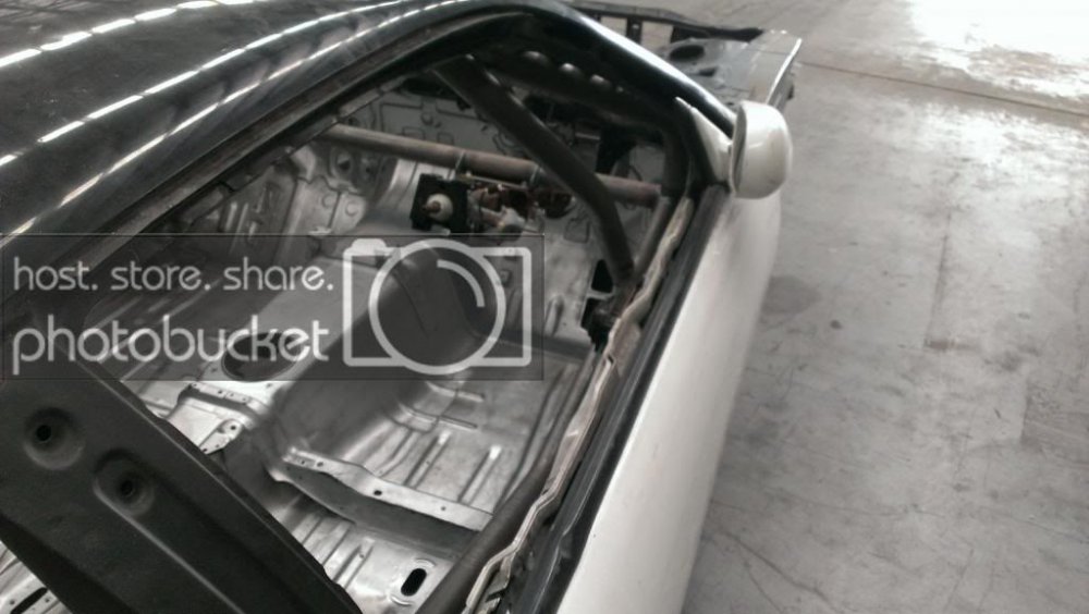

PZG302 Posted December 20, 2013 Author Posted December 20, 2013 Some progress on the S14. The photos below show the cage in progress, bloody high priority big dollar jobs getting in the way Any way the cage will be finished in the Christmas break and I will have the car back home hopefully before I start work again in the new year. The cage will be fairly comprehensive and stiffen the shell nicely as well as give me lots of protection if the worse happens. The shell was also seam welded in the engine bay around the strut towers and the two floor seams in the passenger area. As the rear suspension is mounted in the cradle and the cage ties in the front cradle location and the top strut mounts in the parcel shelf I don't need to worry about doing anything in the boot. I have also teed up all the suspension except for the coilovers, which will be ordered when I know the exact set up for wheels and tyres I will be running. The new Achilles slicks look to be interesting at a very good price, or I can continue with using the Porsche Cup tyres I previously did. Any way all new rose jointed suspension arms for the front and rear will be arriving hopefully mid January. I will also be installing alloy R32 uprights for the rear and getting the rear cradle reinforced and solid mount bushes installed at the same time. It will cost me a bit more, but it will be done quicker than I can and the welding done right. Basically I drop my cradle off and then pick up the rear cradle all set up and ready to bolt into the shell. I also had a good chat with the engine builder and some budgets for various build types will be worked out in the next few weeks. The rules are quite free in some areas, but very restrictive with having to use the standard turbo and manifolds, so the engine is compromised in what can be done and compromises need to be made to come up with a good package that provides a bit of power, but more importantly, a nice drive-able torquey motor. I am now on the hunt for a couple of cheap SR20's complete and suitable for rebuild, my brain will hurt trawling some of the sites to find cheap motors. If work keeps going as it is I will have the dollars to keep the build going and hopefully be looking at shakedown testing around the end of September 2014. Quote
PZG302 Posted January 2, 2014 Author Posted January 2, 2014 The shell is home this morning, the towie just dropped it off. The cage is complete and turned out great, now for me to get the car on a rotisserie and finish the stripping of underneath and the inner guards before painting all but the outside and hanging panels in KBR/POR15 in white. And the price was a nice surprise to, I suppose cash helps I also found a S13 blacktop motor at a good price a couple of hours drive away, so gives me something to do tomorrow. It's a standard motor in allegedly good condition, so a great base for the new race motor. A build and budget is being worked out at the moment and hopefully won't be too far from starting off. I also have a T28 on the way to swap out the T25 that the S13 comes with. Another reason for getting this motor is no VVT, so a bit simpler as I will be using bigger cams anyway, plus the head is slightly better than the VVT version for what is looking at being done for it. Excuse the poor phone photos, but here are some of the cage and seam welding.... Seam welding in the front. And the other side Cage from the front Steering mount to "knee breaker" Back of cage. The strut mount in the parcel shell is plated and attached to the mount point of the rear bars on both sides. Blurry shot showing intrusion bar and another view of the steering column mount and tag between pillar and tube, which is also done for the main hoop and B pillar. The cage is a great design and will make the chassis nice and stiff as well as keep me safe, hopefully I won't have to test that part out. I am also getting a new seat in the next week or so, depending on availability will be local supplier or from UK, to better make use of the HANS device. I will be getting an OMP HTE XL. A very comfortable seat that fits a fat bastard like me in the hips and also the shoulders. I will also be getting a great window net kit that is used on the Porsche cup cars, It will work out about $150 dearer than other kits, but the way it is made is much better, doesn't require any welding to mount it and is a much better solution for when the net is not in use. So if anyone wants a brand new Sparco PRO200, see this thread....http://www.viczcar.com/forum/index.php/topic,13649.0.html All in all some big progress has been made and further progress will be made in the next couple of months. Quote
dat2kman Posted January 2, 2014 Posted January 2, 2014 A1 Will shop again, Excellent fast transaction! Looking good, Yes it looks well triangulated on both sides, and tagged nicely. Sainz bar on roof? Quote
PZG302 Posted January 2, 2014 Author Posted January 2, 2014 Full "X" bracing for the roof, so very comprehensive cage with everything triangulated nicely, including the intrusion bar to knee breaker. Quote
Mike260LW Posted January 3, 2014 Posted January 3, 2014 Matt, the cage looks really good. Should add plenty of structural stiffness and, as you said, a safety cell around you. Who did the fabrication work for you? Mike Quote
PZG302 Posted January 3, 2014 Author Posted January 3, 2014 Mike, a guy by the name of Dave Avenell. He has his own fabrication business and sub-contracts to Australian Diversified Engineering at Aspley. As well as cages he has built quite a few off road baggy and truck chassis, so knows his stuff. If anyone in Brisbane is looking to get a welded cage done I would highly recommend Dave to do the work. He charges a fair price for the quality and time taken, and is very easy to deal with. Quote

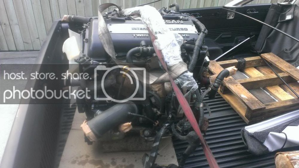

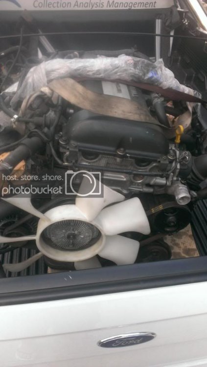

PZG302 Posted January 3, 2014 Author Posted January 3, 2014 Well as said in the post from the other day, things are moving quickly. A JDM BB T28 turbo turned up in the post this morning and i had a nice drive from Brisbane to Kyogle to pick up a standard black top SR20 from an S13. Motor was standard and came complete with all ancillaries and loom, didn't bother with the computer as I will be using a Motech. I also got an engine crane this morning and put it together tonight to get the motor out of the ute and under cover. So this will be off to the engine builder as soon as he is ready for it so some magic can be worked, including swapping the T25 for the T28, if this hasn't already happened. Next on the list is a rotisserie to prep the underside of the car, this should be sourced in the next week or so to get a quick start on the prep and then paint the underside and interior so I can get the ute back in the garage. Things are looking good for a September shakedown at this stage as long as the fun tickets keep stacking up nicely. Quote
