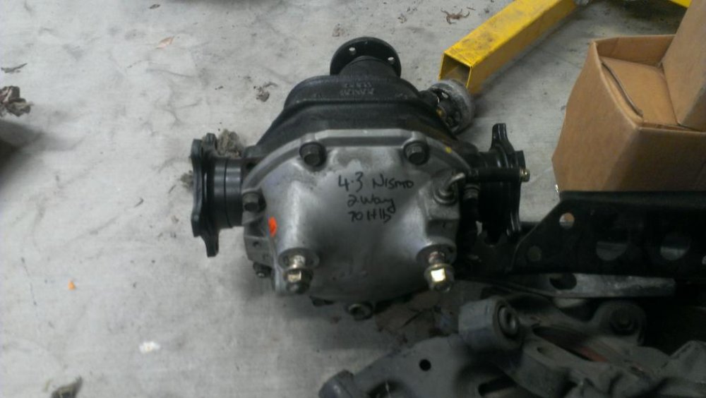

PZG302 Posted July 26, 2014 Author Posted July 26, 2014 Yep, Paul knows about these. Still waiting on a diff from Paul as well. I have to drop in on Monday to pick up some rear rotors so a bit more of the rear cradle can be put together. Will be pulling the hubs back off during the week to paint to make them as pretty as the rest of the cradle. Quote

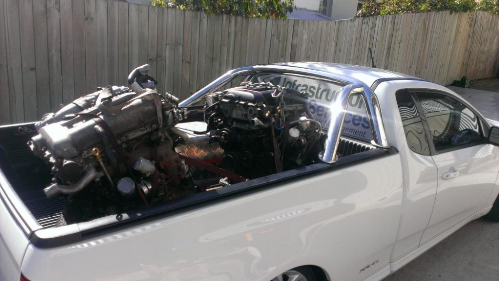

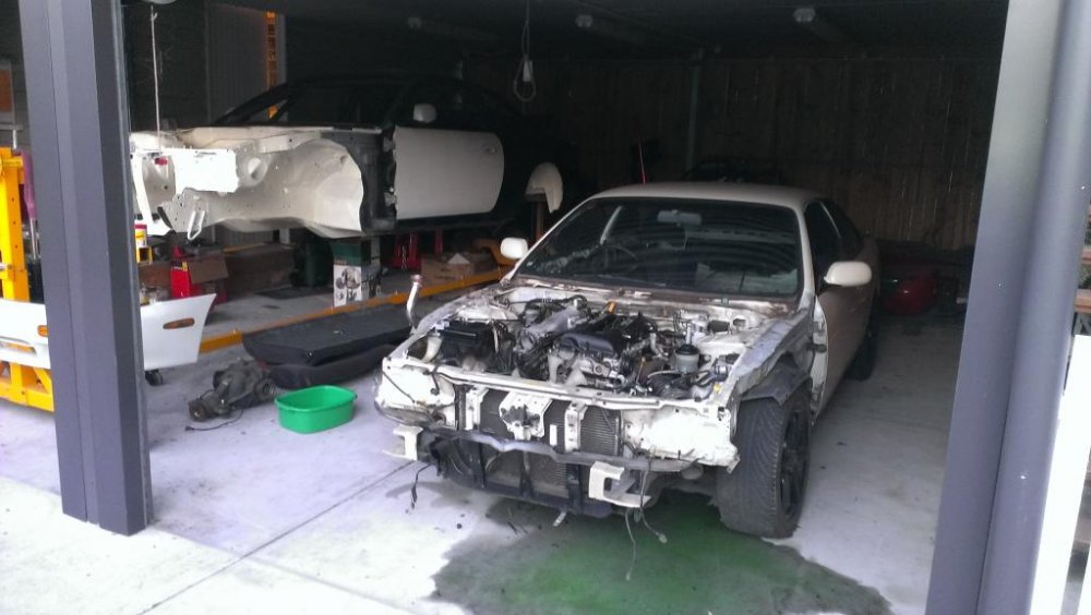

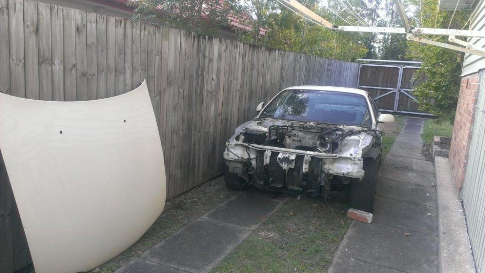

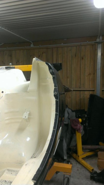

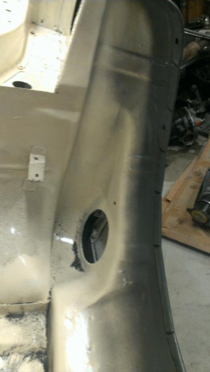

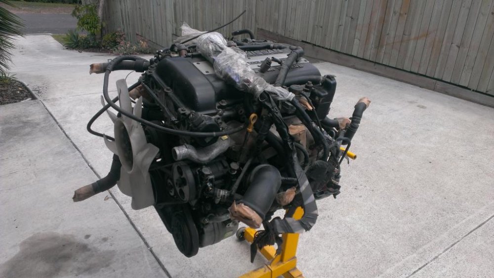

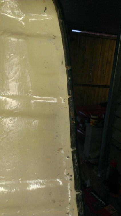

PZG302 Posted November 19, 2014 Author Posted November 19, 2014 So it's been a while since the last update and not much has happened, but there has been some progress. The spare car has been stripped of the bits I need and is awaiting to be sold as a rolling shell. It provided the motor, a spare box, tailshaft, pedals some trim for the windows so they will sit properly and not flex, expected when they are 3mm acrylic. Leaking green blood as it is being prepared to have its heart ripped out..... And now where it sits forlornly waiting to be rescued.... Also sold one SR20 I had, a blacktop out of a S13, so no VCT, only a T25 and different inlet manifold to the S14, so couldn't use it in Prod Sports. The bloke that bought it got a bargain, and I got a diff..... So this was sold..... To buy this...... The other two SR20's, one from a S14 and on from a S15 are now at the engine builders to have a look see where we can make some gains within the restrictions of the rules. Looks like the motor will be a low boost, around 12lbs, running on 98 that will hopefully be nice and torquey using Motec's latest M1 series ECU and either a C125 or C127 data logging display to future proof the management side and provide me with more data than I will ever know what to do with...... The ute was full..... And today I finally got around to starting some work on the car. Before starting on bolting the brake and fuel hardlines back onto the shell, and refitting the fuel tank so I can reinstall the assembled rear cradle and then front suspension, so the shell can come off the rotisserie and I can get the ute back in the garage, I got out the angle grinder and FBH to "roll" the rear guards, well just knock the lip up so the tyres will fit with an extra couple of mm clearence and not be cut by the edge. Half way through side one.... Hammer was used..... Hammered flat and hit with some etch primer..... Before fitting the rear cradle I will be painting the inner guards with another coast of KBS to provide some extra protection. Hopefully this will be rolling and ready for paint in the next few weeks. I now have all the suspension arms ready to go and a new 4.3:1 diff with 2 way mechanical LSD and matching drive shafts ready to bolt in. Quote

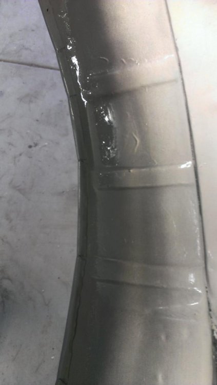

260DET Posted November 19, 2014 Posted November 19, 2014 Hope that those cut quarters were welded up again before painting, got to keep my eye on you blokes it seems. Quote
dat2kman Posted November 19, 2014 Posted November 19, 2014 Why? Perfectly OK. Makes it easy to pry back off and repair/replace outer skins, and tub the upper inners, f need be. Quote
PZG302 Posted November 19, 2014 Author Posted November 19, 2014 Just etch primed at this stage, still have to do a little finishing yet, but the other race cars I never bothered and never had dramas with cut tyres or rust from just folding the lips over. Just need to take a couple of rough edges off and then repaint in KBR and all done. Quote
