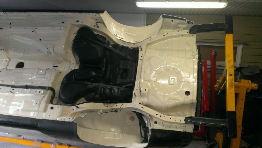

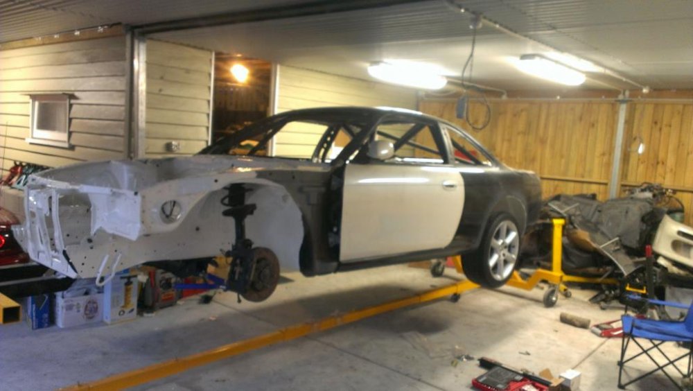

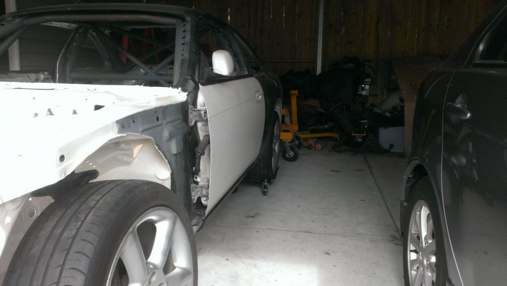

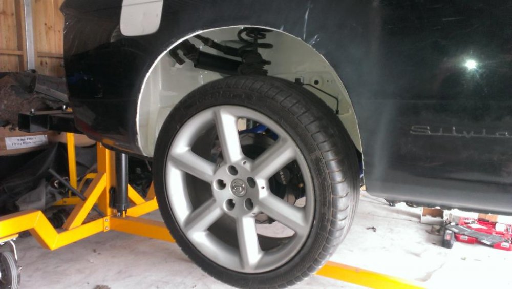

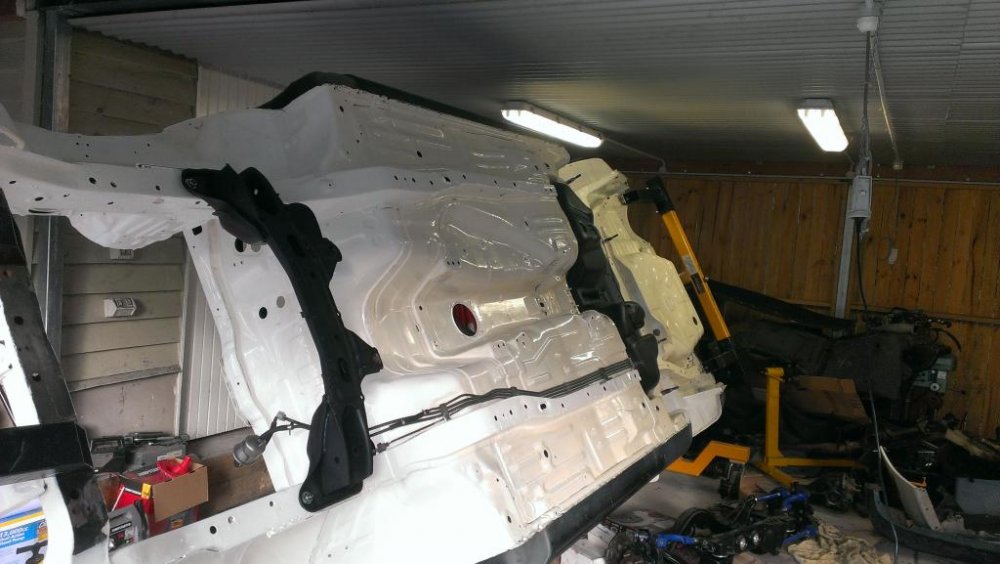

PZG302 Posted December 5, 2014 Author Posted December 5, 2014 Some more bits done to the car. Hopefully it will be off the rotisserie in the next few days and I can get a garage space back for the ute..... So from last time, I repainted the wheel wells and engine bay with the left over KBR to make it a bit neater with a more consistent colour over these areas, and also to cover the etch primer in the wheel wells where I flattened the guard lips so no more rubbing now I have worked out tyre sizes, will be using a 240/640/18 or 270/650/18 slick that will work nicely with the 4.3:1 diff and standard box with the motor planned. Wheels, at this stage planning to use Koya semi forged wheels, nice and light and able to get a custom offset as needed when I measure everything up... First step in getting the suspension back in was to fit the hardlines for brakes and fuel and get the fuel tank back in where it lives. I also bolted up the front cross member, because it was easy and it got me more room in the garage.... Next was making sure the rear cradle was right to go, including installing the diff and driveshafts. I can't believe I stuck with an old Zed for so long, how much easier is it to put a diff in and bolt up the drive shafts!!!!! I wish I knew about this much earlier...... Not the best photo, was beer o'clock and I had had enough for the day. Was an exercise to get the complete cradle onto the shell by myself, though an engine crane, ratchet strap and some imaginative thinking got it all fitted up in the end. Paul at Option 1 has lent me some shocks so the car can get off the rotisserie, which was much appreciated as was being able to raid the bolt bins for the LCA bolts and also for the use of the rattle gun to pull apart my front suspension I had so I could clean up and paint the upright and fit to the aftermarket LCA. And also not forgetting a big thankyou to Paul for fitting some 18" rubber for the right price on some 350Z rims I bought from Matt, Deus Ex, not long ago. So here is the rear end all bolted up and the brakes thrown on to see how the look. Being a Datsun, evrything just bolts up, as long as you know which bits you have and need..... And now with wheels..... Today was time to get the front suspension sorted out and fitted up. All pretty easy, just a pain in the arse to pull stuff apart to be cleaned and painted and then fitted up. Easy bit was the aftermarket arms to the cross member, the castor rods will have to wait until it is on the ground as the brackets for the castor arms bolt to where the rotisserie is bolted to the shell. I had some old front hubs I had bought off Ebay, and they were ABS hubs so I have the special hub ring that I should be able to use with the Motec for wheel speed in conjunction with GPS speed. I also took the opportunity to fit up the Z32 brakes I scored off Ebay for very cheap with new rotors, and again being Datsun it all bolted up not a drama. Getting stuff unbolted did prove frustrating at times. Again blurry photo because beer o'clock.... And a couple of pics for how the car is sitting at the moment. Once it is on the ground, then I can look at fitting the dash in around the cage and to start planning the wiring for the lights and accessories. Until I get some work I can't spend money on the car, which is frustrating, as it only needs the hydraulics, electrics, suspension, motor, ECU, wheels and tyres, a lick of paint and it is ready to hit the track..... Quote

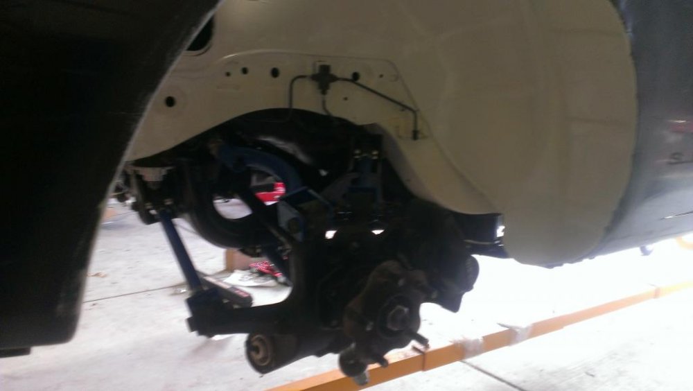

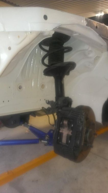

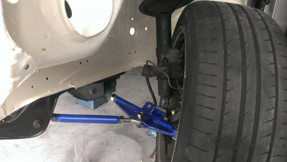

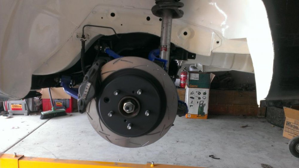

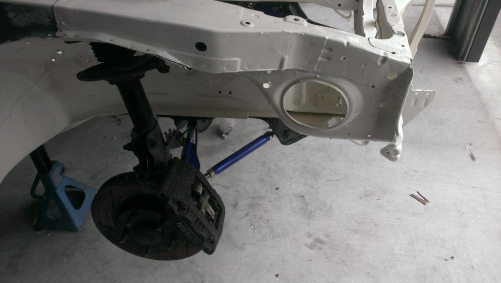

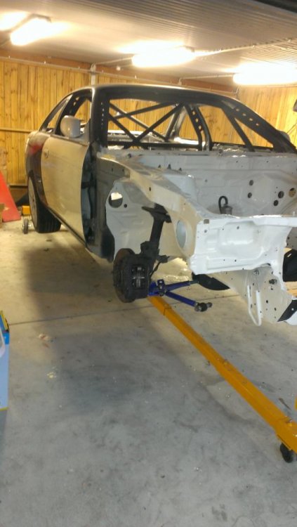

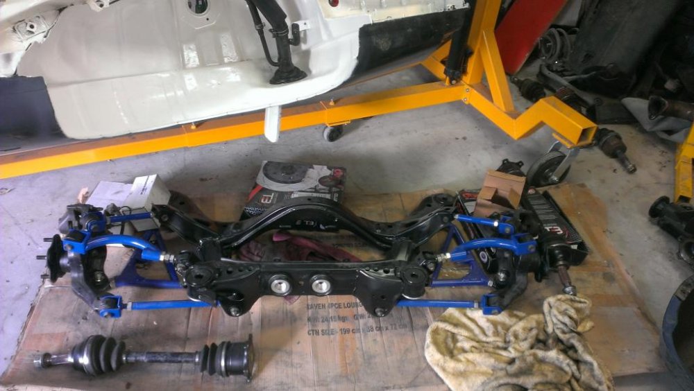

PZG302 Posted December 12, 2014 Author Posted December 12, 2014 Another step forward for the build. The suspension is in and once I have the fun tickets will be getting some very nice coilovers custom built to suit and the final set up of the suspension. The car is now on the ground and for the first time with wheels on it. Next week I plan to get the garage re-organised so I can get a spot back for the ute. So here is how the car is sitting at the moment...... And a view of the front suspension with the castor rods attached.... Plenty of room for the brakes using the 350Z wheels so the race wheels I am planning to buy should be a no brainer...... Next is to start on fitting the dash up and also some work on the doors, which will include removing the intrusion bar and cutting away as much of the inner skin as possible, but still be able to fit up the electric window motors and mechanisms. Quote

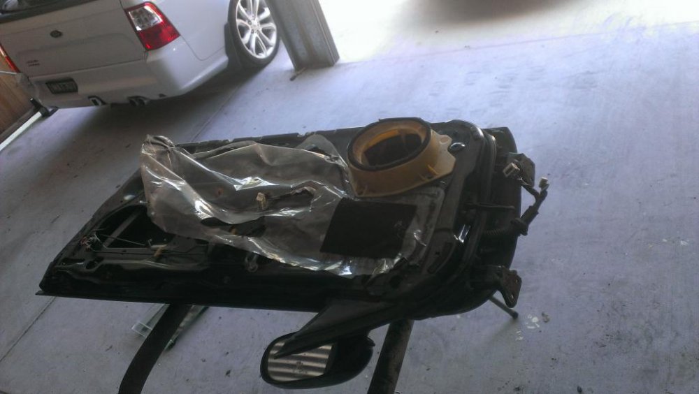

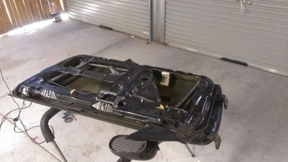

PZG302 Posted February 1, 2015 Author Posted February 1, 2015 Not much happening with the car at the moment as I am working again, and as with those things, when I have time - no money, and when I have money - no time. At this stage the suspension will be done in April/May between trips to Indonesia and then some more stuff for the brake lines and other little bits that are cheap and easy to do. I did have a play today with an old door i picked up for $50, so it was time to see how much lighter it could be made, bearing in mind i will be keeping the fast glass as I am lazy, and the doors are frameless so not easy to fit plastic windows like the old zed was. The door I had with the door card removed but complete otherwise was 25.5 kg After stripping the door down to nothing but the mirror attached the weight was 16.3kg I then set about removing the intrusion bar to see what weight could be saved there, in the end about 2.5kg for the bar The glass was weighed seperately and came in at 5kg, surprisingly heavy. With all the window mechanism put back in, but as much of the inner door skin cut out as I dared to keep some rigidity for operating the windows the door came in at 17.5kg, so once the plastic window is fitted, probably near 19kg all up. I don't know if the hassle of cutting out the intrusion bars is worth the effort for a 2kg saving, but removing the wiring harness, the bits of the door locking and opening mechanism not needed and cutting away the inner door skin is worth the 4kg saving from the original 25kg. The other option would be to go fibreglass or carbon doors, but there are advantages to metal over other materials, mainly being that in door to door there will be contact between cars. With metal doors a dent is a pretty easy fix and doors are still common and reasonably cheap. Fibreglass or carbon tend to shatter or break and generally can't be repaired after a decent hit, and are more expensive than a second hand standard door. Quote
