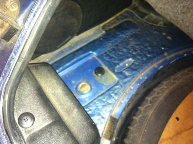

Roberto Posted July 29, 2012 Posted July 29, 2012 Don't suppose he shared images of what he was on about? Whilst playing around mounting my new exhaust yesterday, I came across what may have been what he was talking about. The plug that covers this hole had come off and I was struggling with fumes big time. "logr" suggests sealing the holes from both sides as it is in the frame rail. When I start driving, I will update any progress, but worth checking for a good seal here because it it right on top of the muffler. Quote
RB30X Posted July 29, 2012 Posted July 29, 2012 So you're referring to that black rubber grommet on the blue painted surface. Which seals that same chamber that has the similar hole for a grommet underneath? Might check out mine. Quote
