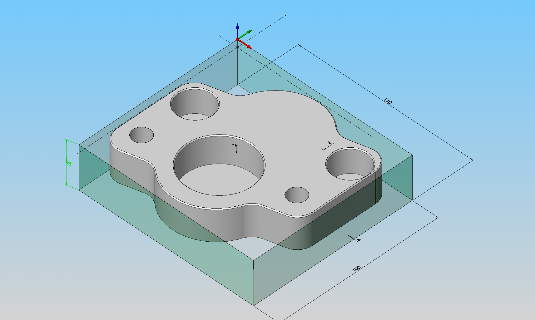

luvemfast Posted September 21, 2010 Posted September 21, 2010 I recently put these on the front of my zed: http://www.zccjdm.com/catalog.php/azcarbum/dt93255/pd1789104/CAMBER__BUMP_STEER_SPACER_ZCAR_ Kills two birds with one stone and as you can see there is lots of negative camber. If someone can supply me one, I'll model it up in CAD so it can be replicated easily. Quote
Riceburner Posted September 21, 2010 Posted September 21, 2010 How long would you need it for? I might be able to help.... Quote
RB30X Posted September 21, 2010 Posted September 21, 2010 I looked at those and thought they wouldn't be too hard to make as well. Quote
NZeder Posted September 21, 2010 Posted September 21, 2010 I recently put these on the front of my zed: http://www.zccjdm.com/catalog.php/azcarbum/dt93255/pd1789104/CAMBER__BUMP_STEER_SPACER_ZCAR_ Kills two birds with one stone and as you can see there is lots of negative camber. The only issue with those is they alter the roll centre - which in turn moves the bump - it does not remove bump it just places it at different location so you don't notice it anymore (ie back where the factory had it but now at a different roll centre) So these bump steer spacer should never be called that but roll centre adjusters as that is what they actually do is alter the roll centre and a side effect is moving the bump - it does not remove bump. The issue is now you have moved the front roll centre but left the rear in the factory spot - so this might cause other issues. But would this difference in front and rear roll centre be noticed on a road car anyway ?? Quote
luvemfast Posted September 21, 2010 Posted September 21, 2010 How long would you need it for? I might be able to help.... Not long Gareth, pm me your phone number Quote

Cozza Posted August 13, 2014 Posted August 13, 2014 I recently put these on the front of my zed: http://www.zccjdm.com/catalog.php/azcarbum/dt93255/pd1789104/CAMBER__BUMP_STEER_SPACER_ZCAR_ Kills two birds with one stone and as you can see there is lots of negative camber. If someone can supply me one, I'll model it up in CAD so it can be replicated easily. I know this is an old thread but, wondering if these ever got modelled up? Cheers Fellas Quote
luvemfast Posted August 13, 2014 Posted August 13, 2014 I know this is an old thread but, wondering if these ever got modelled up? Cheers Fellas It was a looong time ago. it did get done, but modified to suit my car's needs. I put castor an it too. Had them on for a while, but had a vibration under heavy braking on turn in. Thought it was the spacer, so I removed it. Turned out it was something else. Quote
PeterAllen Posted August 14, 2014 Posted August 14, 2014 Mick. I still haven't fitted the non-offset pair I have. It might be worth your while to take one to Stephen Fryer at Kirrawee and see what he would charge to make a set. I've got that book we discussed but I forgot to give you. Drop around if you still are interested. Quote
