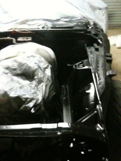

Stivva Posted May 24, 2010 Author Posted May 24, 2010 Started to paint the engine bay. I am going with a satin black and will paint the grill in the same colour. I cleared out the passenger side of the bay and roughed it up and hit it with the satin. Also the radiator was removed and I am spraying the area where the hinges are too. I will empty out the drivers side of the bay and get that done tonight. Quote

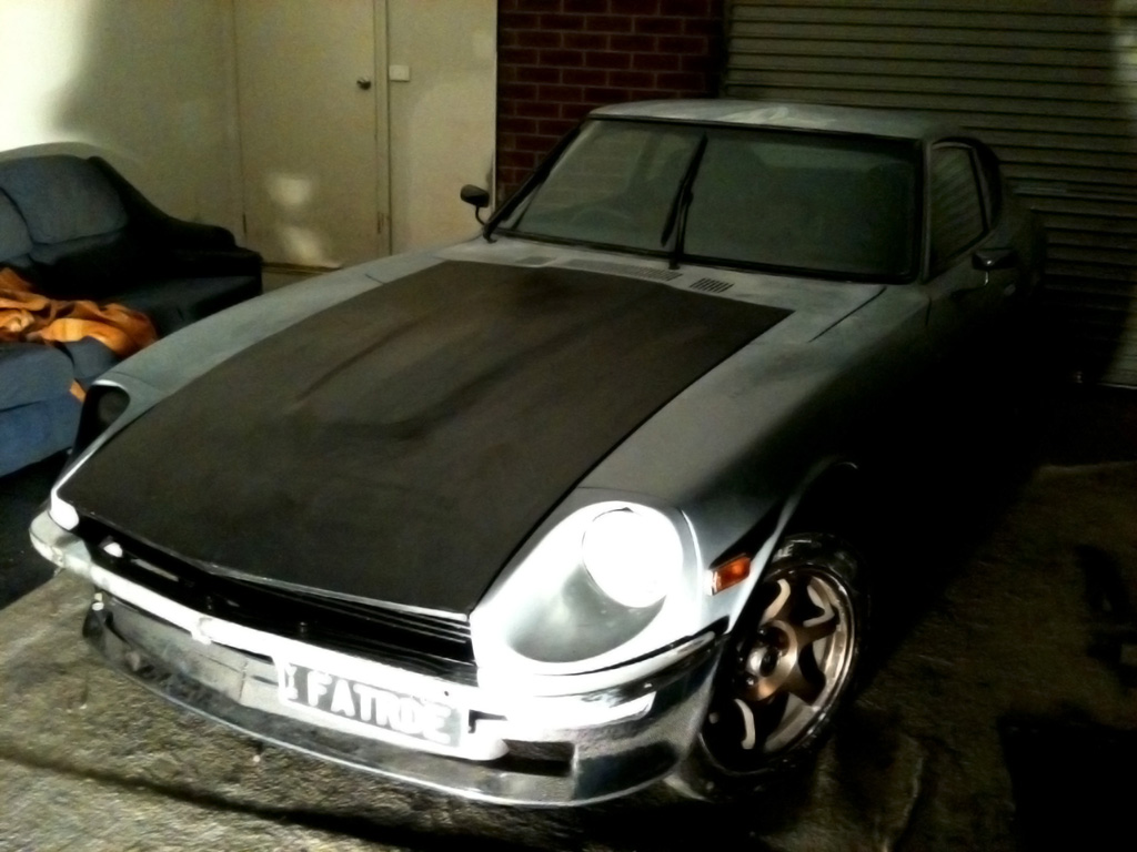

Stivva Posted June 8, 2010 Author Posted June 8, 2010 Cheers guys! I am doing all the work myself bar the chasis straightening. I paid someone to do that. Lol. I guess the black would be hard to paint in a gloss, but this is just a satin made specially for engine bays and what not, you don't need a clear on it. It is a 2k though. The underside of my bonnet is mint, the top not so much, only because of the old rust and bog. I am covering it in vinyl though. Quote

Stivva Posted June 11, 2010 Author Posted June 11, 2010 Also got the price for the vinyl wrap on the bonnet and thats going to be $350. So, damn..... Guess I have to pay it to get the result I want. Quote

Stivva Posted June 20, 2010 Author Posted June 20, 2010 Many thanks to Lurch for fixing up my tuning issues. I am half way through replacing my heater lines. Gave her a new layer of paint and assembled the old girl. Also got the vinyl wrap done. AND! Took some shitty photos Quote

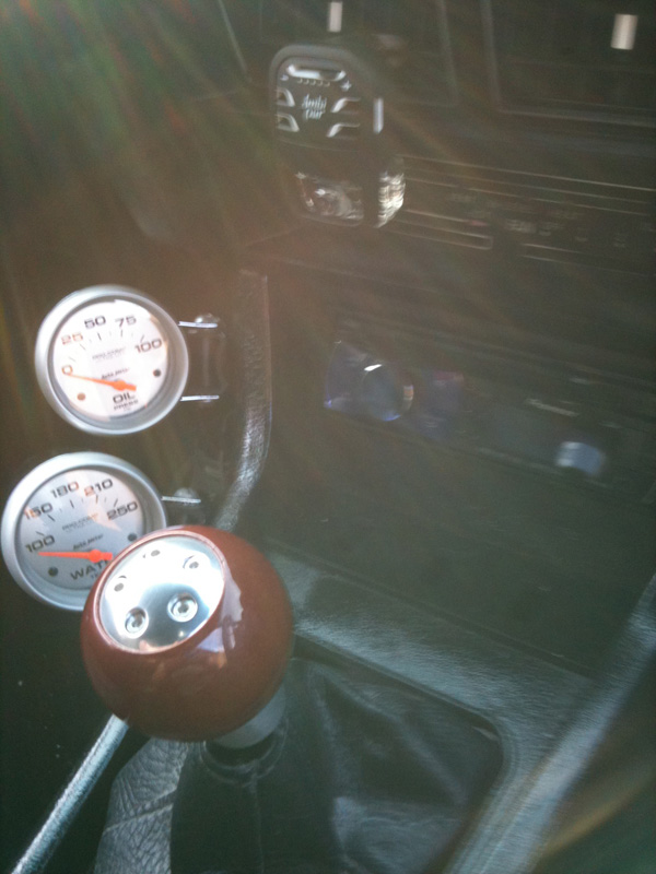

Stivva Posted June 22, 2010 Author Posted June 22, 2010 I installed my autometer gauges and radio today. Just have to do the wires for my drivers indicator and parker and a couple of other little things then I will go see whats required for the roadworthy. Quote
