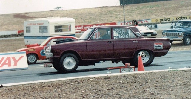

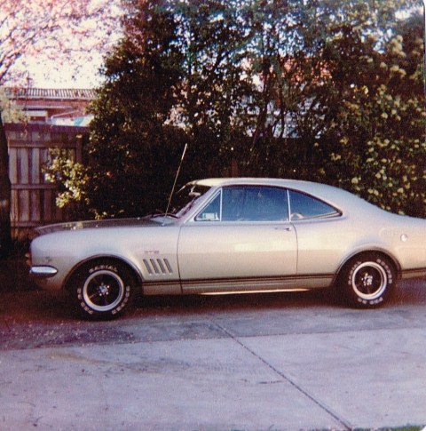

KatoKid Posted September 7, 2012 Author Posted September 7, 2012 The Torana that used the 327 out of the written off Monaro: Angle plug fuelie heads, 12:1 comp, GM Pink cam, Victor Junior, 750 Holley, toploader with vertical gate, 9" with 4.11's. This was a legally registered and engineered "road car".....well not really, it was an animal and nearly dangerous to drive with stock suspension and brakes. Great fun but big time cop bait. Ran 12's on crap street tyres and when I sold it the new owner bolted on a small set of slicks and it ran 11:20's with no other mods. Not fast by today's standards but back in 1981 it was quick enough. Quote

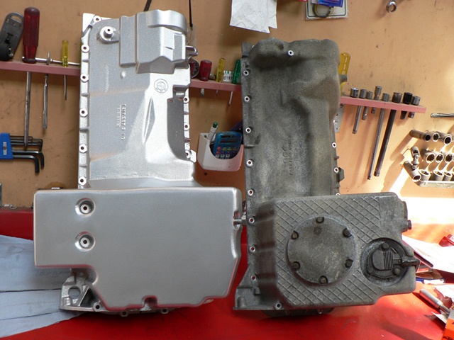

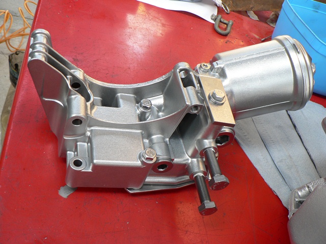

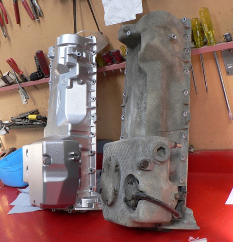

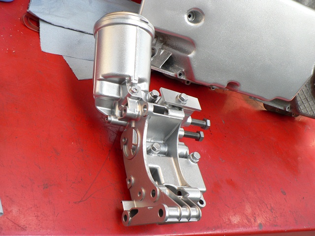

KatoKid Posted September 12, 2012 Author Posted September 12, 2012 Have to give this guy a plug..... Woodys Engine Services Greg an Louise Wood. (03) 9597 0387 Unit 12/ 20 George street Sandringham 3191 hydrolblast@iinet.net.au I had been looking at alternatives for cleaning/restoring the cast aluminium sump and accessory brackets on my M3 engine as they were badly corroded from the salted roads in the UK. Research says that hydroblasting is the way to go to get an as new finish. I was going to go to a guy in Pakenham http://www.southernhydrablasting.com.au/ but Peter Mc recommended Woodys. Im blown away by the quailty of the finish, it actually looks better than new, nearly fake its that good. Hyrdroblasting is like glass bead blasting but using water rather than air. Cost is $1.00 per minute, both items ended up costing $150. Not cheap but I think well worth it for something that looked terrible before. On the right is my old S50B32 sump for comparison.....the clean one was actually even worse beforehand. The oil filter housing/accessory bracket was just as bad. Quote

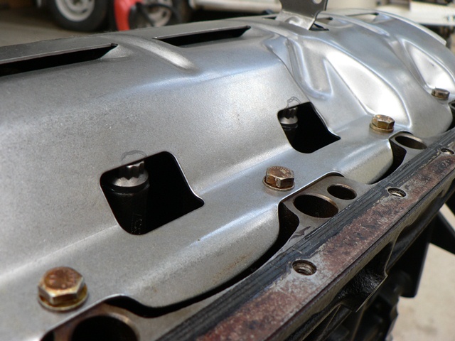

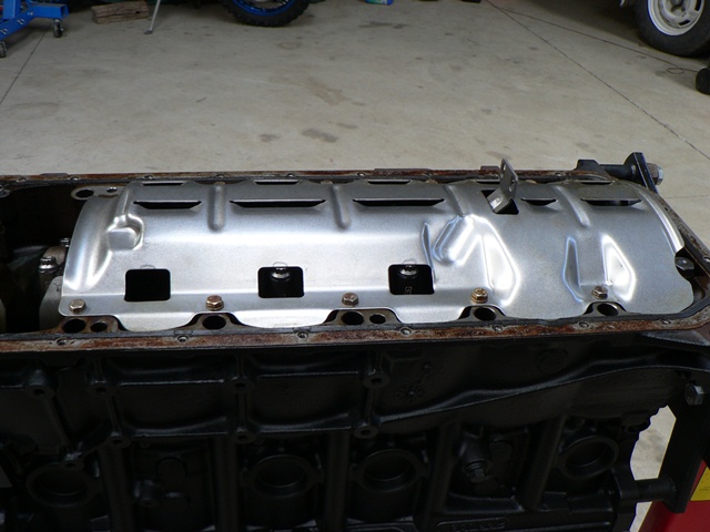

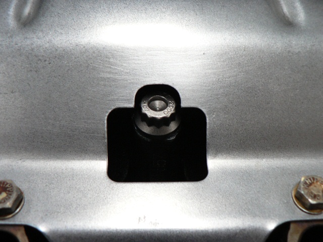

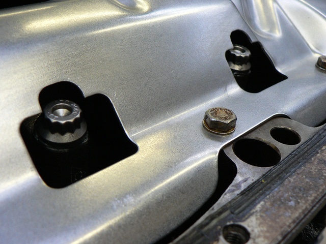

KatoKid Posted September 12, 2012 Author Posted September 12, 2012 Now that the bottom end is back together I could refit the windage tray that gave me a heart attack when I first started the engine on the test stand. This tray is from the 3 litre engine and the longer stroke on the 3.2 litre engine means there isn't sufficient clearance. The ARP bolt heads also stand a bit taller than the factory rod bolts so the rods 2, 3 and 4 were hitting the windows in the windage tray much more than previously. Some judicious filing and checking had it fixed and turning over with no other clearance issues. Quote
peter mc Posted September 12, 2012 Posted September 12, 2012 haha I'm always finding new things to get done, love his and her work i just had my hole motor done by them and it looks incredable, bet your blowen away by the finish Quote
KatoKid Posted September 12, 2012 Author Posted September 12, 2012 Youre right Pete, most amazing finish Ive ever seen. Looks like a ceramic coating buts its just aluminium. Quote
Moderators Zedman240® Posted September 12, 2012 Moderators Posted September 12, 2012 Would they be able to blast a set of triples on their manifold? Just curious as mine look like crapiola. Quote
Riceburner Posted September 12, 2012 Posted September 12, 2012 Looks fantastic Dave, well worth the money! Are you going to clear coat it? Dimitri.... triples, is that an update for the red baron? Quote
