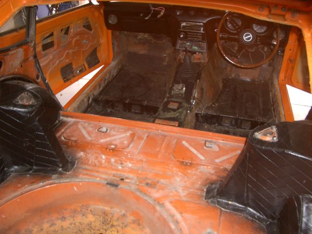

acf321 Posted July 9, 2009 Posted July 9, 2009 I asked Nzeder about these... I have two bolt holes in the rear shelf of my 240Z that appear exactly between the rear strut towers, and about 1 inch forward of the spare wheel well. I do not know what these are for, but they have been there for a very long time, as they seem to have held in two plates (about 2 by 3 inches each) whose shape are indented into the tar-based floor covering. In the following photo if you look just ahead of the wheel well you can see them... Anybody got ANY clues what they are There were no bolts in the holes when I bought the car, nor were there any brackets. I was thinking they might have been used to hold the diff up or some such thing ... but this was NOT on my last car (albeit that was 10 yrs ago). Do I get them welded up Quote

acf321 Posted July 9, 2009 Author Posted July 9, 2009 These are definitely not the holes for the straps that are used in the cargo area ... they are also there in their rightful place. The bizarre thing about these holes is the fact they Look like they were factory added, because of the depth of the indents in the tar based covering .. alternatively, they were added at a later point and bolted down tight such that the brackets sank into the tar based sealer.. in reality they could have been in there for 37yrs I guess. Another thought ,,, they don't appear to have been used for any sort of roll-cage as there is no evidence of any such cage anywhere else at all inside the car (either welded or bolted) i'd like to have them filled, but in really don't want to if they were infact there for a reason. Quote

acf321 Posted July 9, 2009 Author Posted July 9, 2009 Right ...thats interesting, because I also have one of those large bolts that is used to screw into the wheel well to hold down the wheel. Also. if these are the strap holes in FRONT of the wheel, where might the corresponding holes be at the REAR of the wheel well to join to? My car only has these two holes, and none at the rear of the wheel well? Quote
. Posted July 9, 2009 Posted July 9, 2009 just pop some bolts through. From the inside of the car it will look like they are attaching something under the car. I have done this to attach my fuel pump. Just to the side of where your holes are. Quote
chris240 Posted July 9, 2009 Posted July 9, 2009 in my humble opinion , these are not factory. I just checked mine which is factory virgin...and I dont have these, and the luggage tie downs are 20cm away & it has nothing to do with spare wheel tie downs.. got me stumped Quote
NZeder Posted July 9, 2009 Posted July 9, 2009 You know what I think I might know what they are for - a Tow Bar yes they made them for the zeds - mine had one fitted when I got (I still have it - but it mounts differently I think but the bar did go under the fuel tank and join up by the diff area) I have a photo of my zed somewhere with a horse float on the back when I took the now wife and the horse to a ODE when the normal tow car (now Father-inlaw's HQ wagon) was out of action. So my guess is it could have been a towbar mount that was installed when the car new or near new all that time ago which is what it looks like it has been there a long time/almost factory Quote
chris240 Posted July 9, 2009 Posted July 9, 2009 Bingo , Yep....I tend to agree...bloody towbar attachment points !! just what every zed needs Quote
acf321 Posted July 9, 2009 Author Posted July 9, 2009 Well Done Mike .... I actually thought that could be the case and the next thing I was planning to do was get up underneath her to have a look for any other evidence of this ... Its got to be this, as I say it looks very factory (especially the indentation) and the bolt holes are very large, implying the requirement for strength in that area .. Nat will be welding it up !! Thanks everyone for you help ... Really appreciate it. Cheers Quote

Mr Camouflage Posted July 10, 2009 Posted July 10, 2009 Defiantly tow bar. My first 240z had one. You can even see the outline of the flat bar that sat ontop to stop the bolt heads pulling through the floor. Quote
