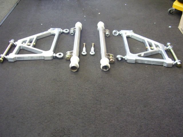

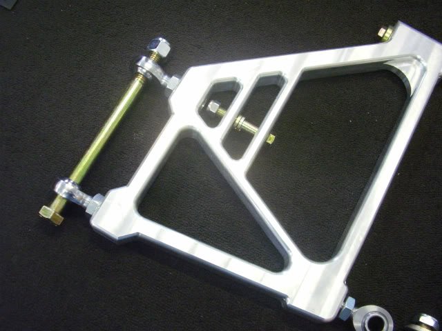

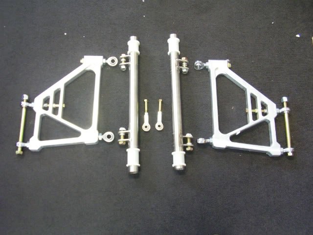

K240z Posted November 17, 2009 Author Posted November 17, 2009 Sup pplz Bit of an early christmas pressie from myself so i got me this..... Rear control arms from arizona Zcar
sco_aus Posted November 17, 2009 Posted November 17, 2009 With all the problems i have with my rear toe etc, I have wanted a set of these for a long time. Will look hawt on your car mate.
Scando Posted November 18, 2009 Posted November 18, 2009 Awesome Just looked up the price and it would work out pretty good while the Aussie dollar is strong. I have 2 deg tow in on one side a 4 deg on the other so I definately need to do something!
NZeder Posted November 18, 2009 Posted November 18, 2009 Just thought I might put this out there - I think Dave at Arizonazcar gets his alloy stuff from this guy - just look at the lower arms, diff bar and diff hangers and you can see they look the same just without the AZC branding http://www.newoldstockmotorsports.com/product_info.php?products_id=57
garvice Posted November 18, 2009 Posted November 18, 2009 Either arizonazcar gets them for a steal or they are not making more then $4. Ha.

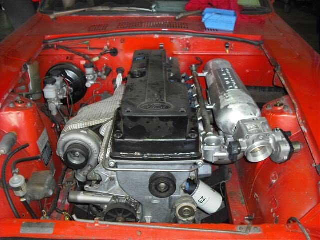

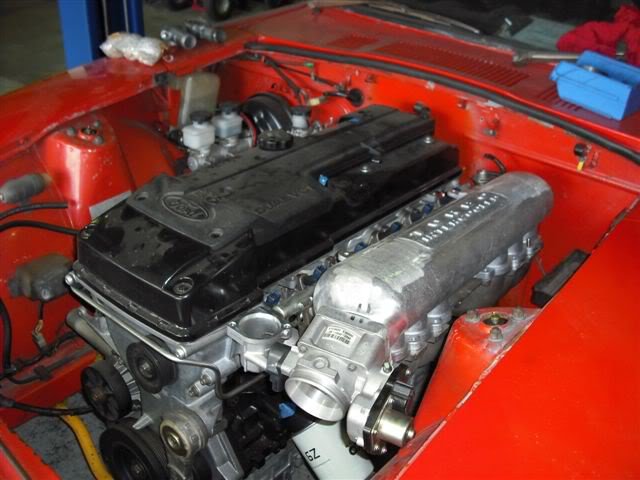

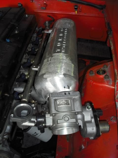

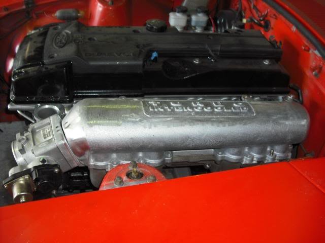

K240z Posted December 2, 2009 Author Posted December 2, 2009 Like everyone here, I'm looking forward to seeing the outcome of this. I hope it all goes smoothly for you. The ford engines are easy to work with. I've seen them used in a heap of different cars with great results. Well done for doing a swap that isn't the norm. yeah thanks hunterzed and every one else for all your positive feedback. yeah just wanted to be different thats all ok now i havent posted up a progress report for a while now coz nuthin much had happened. needed to pay off a few part before they could start work on it. But the have just finished modifyin the nizpro intake plenum so here is a couple of pics i got today Enjoy
Sirpent Posted December 2, 2009 Posted December 2, 2009 Kyle, As I said before, this is the best mechanical build I have ever seen in a Zed bar non, and hopefully some of the major mags will pick up on it and pay you the honors you deserve for your efforts, both here and afar. But it just makes you wonder what Ford Australia could achieve if they had the Gonads to do a proper sports coupe from scratch instead of something like a still born Capri or an imported Probe Mustang or Cougar, with this motor, they could probably achieve what the original Zed did in 71 in the states where it swept all before it in terms of value and kick for your buck. Hope some bean counter at FoMoCo Melbourne one days see's this car in an article and has a space cadet moment. Cheers John
