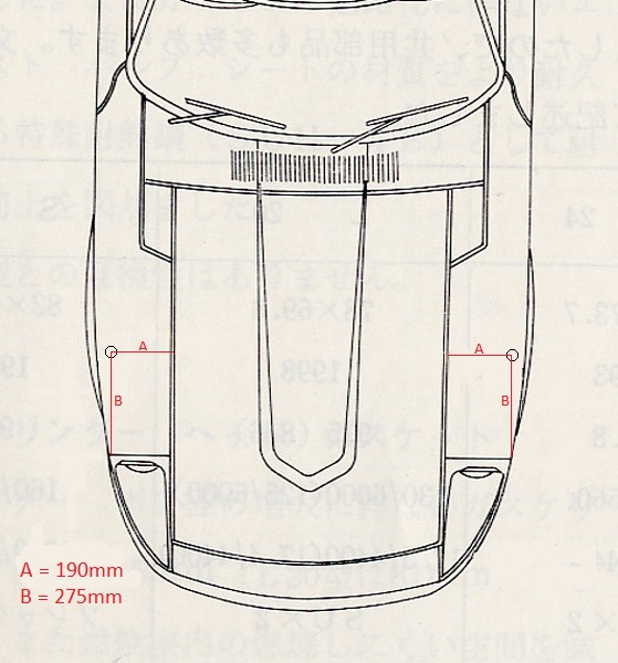

HS30-H Posted October 4, 2010 Posted October 4, 2010 Ben, The frustrating thing is that the original illustration used for the template ( see post #2 on this thread ) was actually from an original Nissan document. It's an ILLUSTRATION, not a technical drawing. Anyone commenting on how that illustration doesn't "look" right is obviously missing the point.... The dimensions added to the illustration were taken from an original Japanese market car which was originally fitted with ( the correct.... ) S30-series Z fender mirrors. It's also worth noting that the measurements were taken to the edges of the plastic mounting gasket and not the centres of the mounting holes. These have been cross-referenced with some other original Japanese market cars, and to be honest they were all slightly different to eachother. Ask anyone to measure theirs, and you'll probably come up with a difference too. It's a bitch to measure to a curving datum point, or one that is covered in paint, so you have to take the dimensions with a pinch of salt anyway.... For the record, I've never seen an original factory document that specifically states any mounting point dimensions for these mirrors. Quote

NZeder Posted October 14, 2010 Posted October 14, 2010 Ok I have asked the current owner of my old 240z (the red one that Adam likes so much ) to get some measurements. The fender mirrors were factory installed, the car is 71 build around 1200ish and NZ New and all NZ New 240z/260z had fender mirrors as we did not have legal issues with this location. I am waiting for the measurements based on the diagram in post #2 but the current owner (another Mike) does recall that there was approx 20mm different between LH and RH sides and they holes looked very factory. More details to follow later Cheers Mike Quote
NZeder Posted October 14, 2010 Posted October 14, 2010 Ok this is the reply I just got from the owner of my old 240z with fender mirrors. This does tie with the offset installation as recommend by Factory Nissan ILLUSTRATION posted in post #2. These numbers were taken as stated by HS30-H from the plastic mounting gaskets and using the ILLUSTRATION as - well go figure an ILLUSTRATION to take the measurements from Anyway here is the reply A= 173mm B= 238mm C= 172mm D= 260mm Measurements taken to the edge of the plastic gasket thing that the mirror sits in. I could get a measurement for the actual holes in the guard at the weekend if needed. Even (the wife) hadn’t noticed the different offsets on the mirrors until we just measured them. Quote

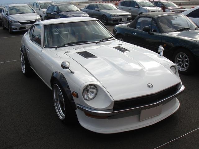

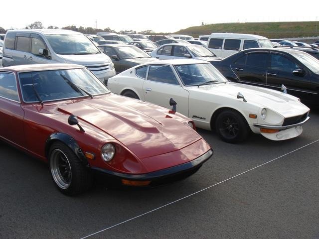

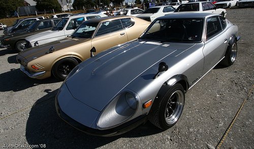

d3c0y Posted October 27, 2010 Posted October 27, 2010 I think that there is just one location and the ones that you and NZeder have pointed out are correct. If you look at photos of Japanese cars they are further back and further out. J-spec: Now ill pick on a few of my favorite Z's and my car which have been mounted using the diagram: Gareth's: These guys on Hybridz: And of course my car in the first page of this thread, looks like mine are even further forward cause they don't have the plastic mounting piece, damn. Anyway i'm over it if you want to mount them in the middle of your guards go ahead. When i repaint my car i will be moving them out board and backward. Quote
HS30-H Posted October 28, 2010 Posted October 28, 2010 I think that there is just one location and the ones that you and NZeder have pointed out are correct. Now ill pick on a few of my favorite Z's and my car which have been mounted using the diagram: These guys on Hybridz: And of course my car in the first page of this thread, looks like mine are even further forward cause they don't have the plastic mounting piece, damn. As I've already mentioned, there was more than one set of mounting positions on the Japanese market cars. If you choose to ignore that fact, it's up to you. The mounting positions on that orange car above are visibly odd ( I think it takes a fair difference in measurement to make it that visible ), but what proof do you have that the dimensions I provided were used for that? I certainly didn't create the 'flipped' diagram and measurements that people are using for the LHD cars, and I think some people have clearly misunderstood what is being measured to and from. Some of them are using C10-series Skyline and 510-series Bluebird mirrors ( with the different angled / shorter stalks ), and some of them clearly need to be supervised when using measuring instruments and sharp implements..... With all due respect to yourself, I'm wondering how you mounted your own mirrors without the proper plastic bases? If you didn't have the bases ( the edges of which are what the measurements I provided actually use as datum points ) then how did you measure anything? Quote

Veloce Posted September 13, 2012 Posted September 13, 2012 OK, old thread, i know, but why start a new one when all the info is kept in one spot.... i have modified the "original" fender mirror placement drawing with measurements taken to centre of mirror hole mount (the large hole) as supplied earlier in the thread. I'll be doing this soon so after looking at several 240ZG pics i think this is as close to JDM original as we can get without actually going to the Nissan museum with a tape measure. Quote
