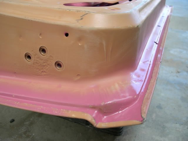

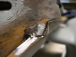

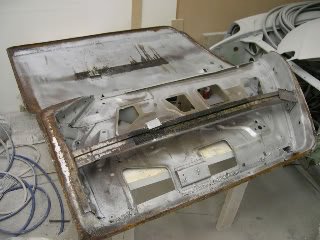

V8Datto Posted February 12, 2009 Posted February 12, 2009 This is Rob at ZFactory's door skin tool in action Only two welds to cut, one at each end, slowly bend the skin off at an even rate. And the skin can and was reused Quote

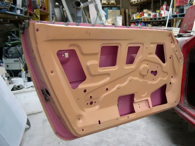

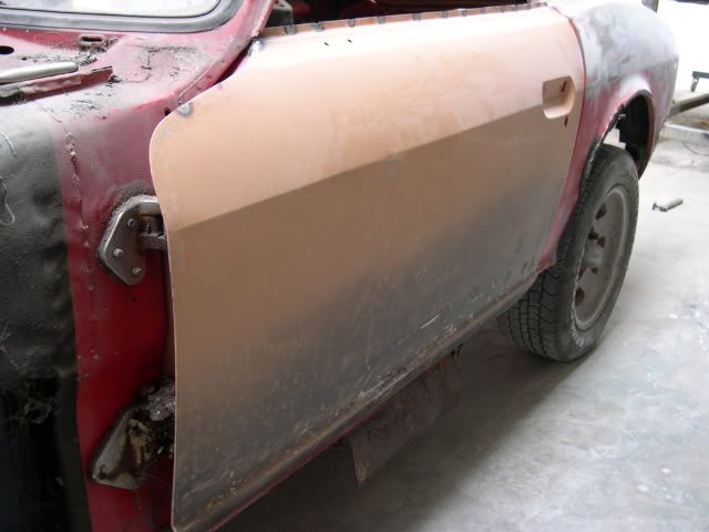

V8Datto Posted February 13, 2009 Posted February 13, 2009 I'm no panel beater and I took those door skin's off myself in about 10 min, very very easy. Had inside & out sandblasted and Rob put it all back together. I actually bought two new door skin for a lot of $$$ which Rob refused to use. He said the line's were different in the shape and wouldn't line up with the car. Here is some pic's of the door reassembled Quote

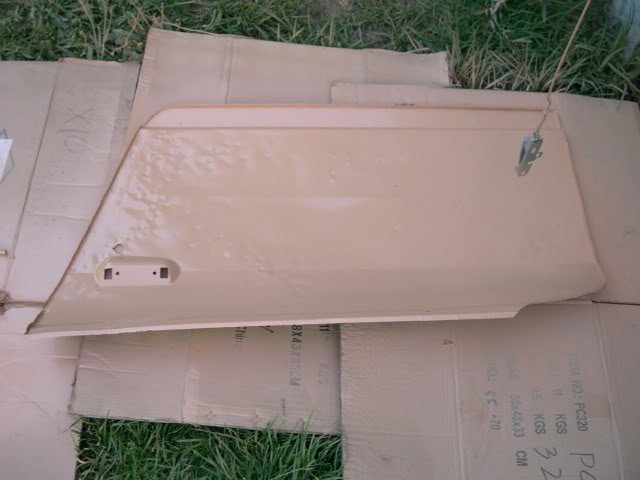

V8Datto Posted February 14, 2009 Posted February 14, 2009 I'm not sure where the replacement panels come from, but they don't come from nissan. From what Rob said to me was, you can reshape them to fit but it's more work. If your door skins are rusted beyond repair it's your only option any way. My door skins had a few rust holes and one was damaged due to an car accident at some point " picture below" , after I got them off they changed shape and distorted, I thought they were throw away jobs. This is just before Rob put them back together, a bit of work went into straightening this out tho He did a awesome job, really happy with how the door's came out Quote
