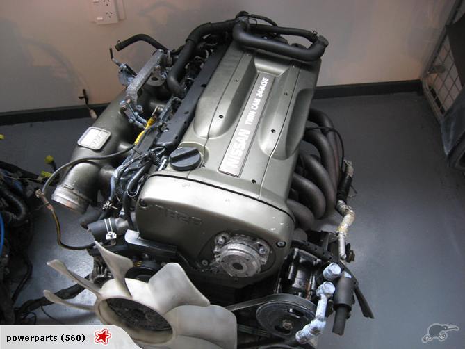

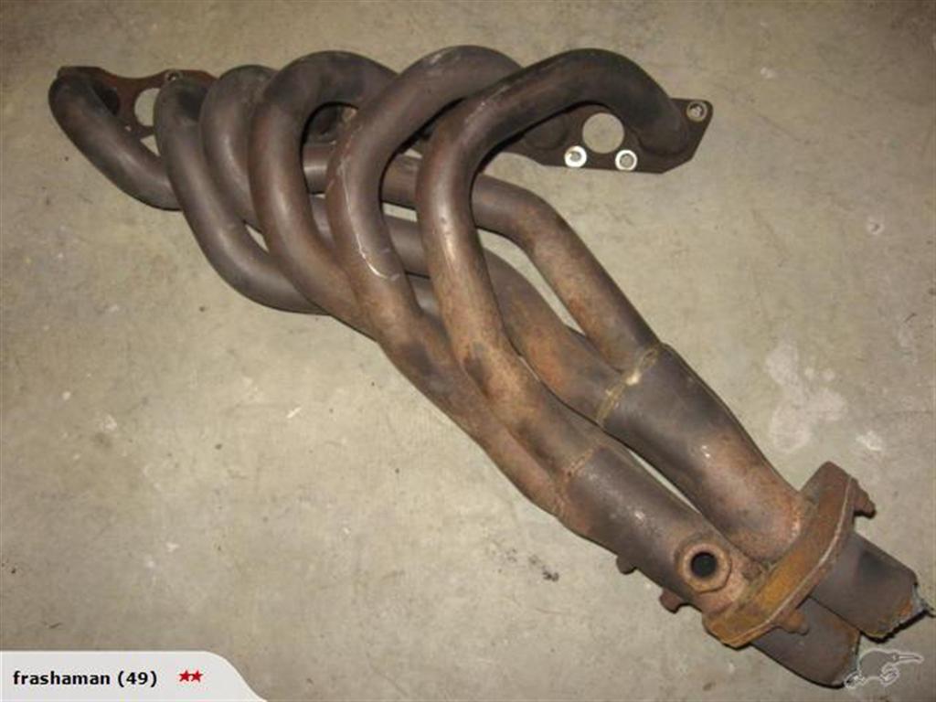

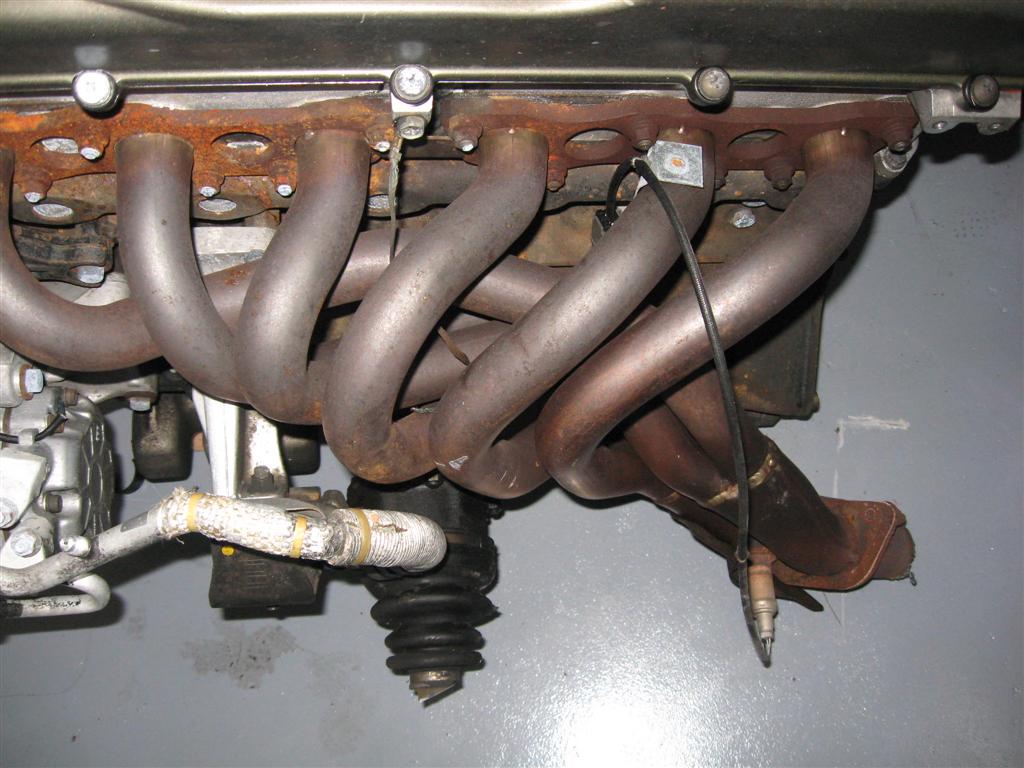

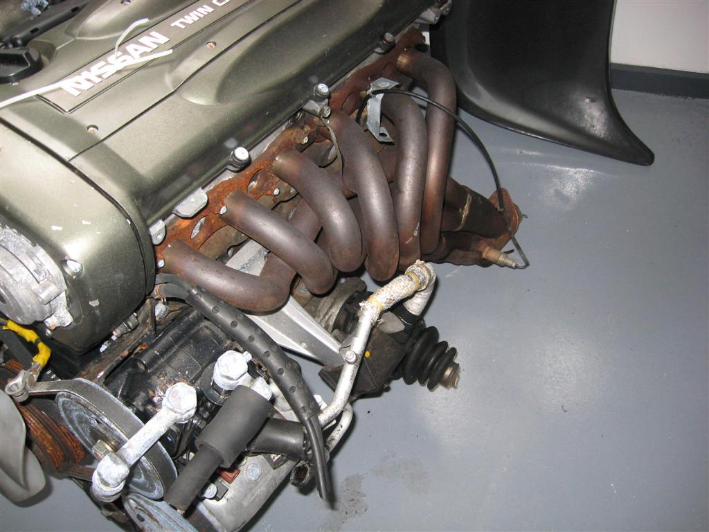

NZeder Posted April 6, 2010 Author Posted April 6, 2010 ok so been a while since I did an update. Not a lot of work to report. 13 years of storage = every part I go install needs to be restored or replaced Good news is the shed now has power and lights I also picked up a set of Genuine RB26DE headers from an Autech RB26DE. The engine was on trademe some 12-15 months ago and I was tempted to purchase it $3999 but I already had my 25/26 hybrid. I really only wanted the genuine headers. Anyway the guy that did purchase it in the end put a turbo on it so listed the headers on trademe for $500 NZD or $370 AUD in the current FX rate. The headers arrived at work today but I am off with a virus so will not see them until I am better and go into the office. But here are some pics I got from the original seller of the engine and the headers in the ad Quote
garvice Posted April 7, 2010 Posted April 7, 2010 but I am off with a virus It is a pain when you are off work with a "Virus" (Zed virus?) and the parts you need while working on your virus arrive at work. DAM! HA. Headers look great, but are they actually welded at the flange? I can only see one tack at the top of each runner, are they welded on the engine side of the flange? Quote
NZeder Posted April 7, 2010 Author Posted April 7, 2010 will let you know when I see for the first time myself Quote
Moderators Zedman240® Posted April 7, 2010 Moderators Posted April 7, 2010 Very yummy hardware there Mike! similar to the Rocky Auto zeds in a way. Quote
