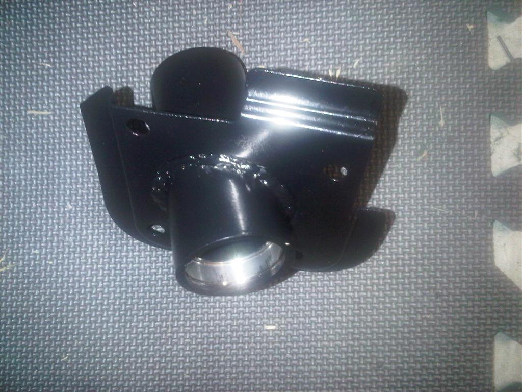

NZeder Posted April 17, 2011 Author Posted April 17, 2011 Ok did not get a lot done today - but did get some coats of paint on parts before the Hamilton race started on the box. Anyway here are some pics. 1 = All the parts as listed. 1. Suzuki Wagon R Electric Assist Column 2. Cut down 260z outer steering column tube 3. Custom sleeve/bearing holder for Suzuki lower shaft 4. Modified Suzuki lower shafts - modified at the Uni-Joint - had Uni replaced and joined the steering couple mount of the stock Zed shaft when installing the new U-J 5. Stock Suzuki Uni-Joint for mounting lower shaft to column 6. Stock 260z pedal box mounting plate - bolts to pedal box and #2 shown 7. Modified 260z firewall mount - new centre tube to hold bearing/sleeve and Suzuki lower shaft 8. Bearing and C-Clips for holding the sleeve/Suzuki lower shaft in Firewall housing/mount Quote
NZeder Posted April 17, 2011 Author Posted April 17, 2011 And some more bad cell phone pics 1. Modified Firewall mount 2. Custom bearing holder/sleeve - you can see were the grub screws go to hold/lock to the Suzuki lower shaft (NZ does not permit any welding to the steering components other than those the factor has done) 3. Suzuki lower shaft with Zed steering coupler jointed via new U-J. C-Clip must be installed before sleeve/bearing holder is insatlled or you can't get it on after the fact 4. Custom bearing holder/sleeve installed - good tight interference fit + grub screws to hold things tight (not installed yet - need to pick some up this week) More pics will come once I put top coat on the firewall mount - sometime soon Quote

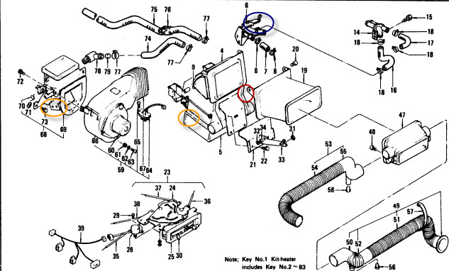

NZeder Posted June 17, 2011 Author Posted June 17, 2011 Yes it did John. Anyway ok simple break down. 260Z heater lever control has just one lever that controls all 3 doors - so as the lever moves left to right it changed as follows Off --- Vent --- Bi/Level ---- Heat ---- DEF So the factory doors are like tihs Off = fresh door vent (aka recycle) closed + radiator blend door closed (in the vent position) + foot/cabin doors closed Vent = fresh door vent open + radiator blend door closed (ie all air out the centre and side dash outlets) + foot/cabin doors closed Bi/Level = Fresh door vent open + radiator blend door 1/2 open (some air towards the dash outlets rest towards the raditor) + foot/cabin doors open Heat = Fresh door vent closed + radiator blend door full open (all air in towards the radiator and nothing out the dash outlets) + foot/cabin doors open DEF = Fresh door vent closed + radiator door full open + foot/cabin door open = air can only go out the DEF outlets which don't have a door on them aka once the blend door is open air can always get to the DEF just very little due to other outlets open. So that is how the factor non air fitted 260z doors work. So how does that match a modern control server? Modern usually have the following buttons Vent (little pic of seater person with arrow in the face) Vent/Foot (you know the rest ) Foot Foot/DEF DEF Recycle (separate button and actuator) As stated earlier all these modes are changed by just one actuator - however I needed two actuators one for the foot door and another for the vent/blend door. So using the stock actuator which has 5 positions (one for each mode) I hooked this and was just going to stick with vent/blend door moving from closed to open in 5 steps not 3 like the stock lever setup. That is how I left it while I worked on the new control circuit to open or close foot door. So I needed to find something on the control board that I could use to operate the foot/cabin door actuator when the buttons were pressed (the control panels buttons are setup so only one mode can be selected at any one time). So the LED indicating which button is selected was the best option. First I mapped out the current controller circuit board. I have attached this below. Then I made a decision to run the actuator/motor for the foot/cabin door different to the normal setup (no issue as these motors can run in either direction in fact that is what the main actuator does forward and backwards based on the button selected - this is what the circuit board does switches the + and - on the motor based on the position the motor is currently in and were it needs to go). So rather than switching the ground on the motor it was much easier to switch +12 using a PNP transistor switch - now it has been 18+ years since I worked as an electronic tech so I might have gotten the maths a bit wrong on the resistors I used but hey it must be close enough as the circuit works For those who don't under standard electronics this new circuit gets a short to ground (ie when the LED is connected to ground when the button is pressed ie LED is on) and then puts +12 on the wire to the actuator (ie the PNP transistor base goes into saturated mode and collect and emitter are connected ie acts like a switch) . I have since been thinking about the circuit and I am now thinking I might be able to change this to a much smaller circuit using just 2 x NPN transistors setup as logical not gate (or an inverter circuit if you like) FYI if you use a NPN as a switch you need a + trigger which I could not find on the circuit (there is a + signal but it stops when the main actuator get to the mode position = in some case that not on for long enough to fully open or close the foot/cabin door). I think in the weekend I might give the NPN inverter circuit a crack. Tonight I might just put together a diagram for those electronics engineers out there to check my work/circuit. So then once I was happy with this transistor switch setup I moved back to the main actuator and looked at the diagram as how I could disable the foot/def and def buttons from moving the actuator. This was as simple as making the two pins that are connected when the switch is off and disconnected when on to just make then joined when the switch is on also - so I just solder a link across the two pins on each switch/button so they are always connected = the actuator does not move past the Foot location. So I now have only 3 positions for the main vent door closed, 1/2 open and open just the like the factor cable/lever setup. There you have it - what I did. In the weekend I will get some pics and I might even do my first youtube video. Quote

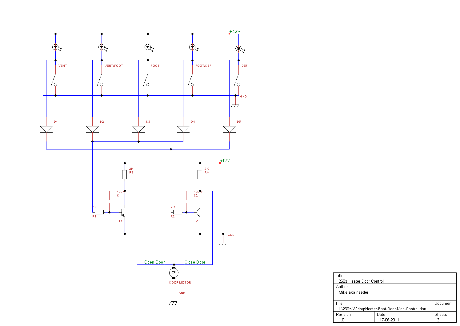

NZeder Posted June 29, 2011 Author Posted June 29, 2011 New plan for the circuits I am going to pickup a logic CMOS based NAND gate to control the foot/cabin door actuator I have added. I did visit the local pick-a-part and got the Nissan Aircon Amp + most of the loom, I planned to work out how the actuator works for the temp/water tap. However last night I did some reading and I might just make my own circuit - will take me just as long to do that as to trace out the stock unit which has circuits for sun sensors, inside temp sensors etc which I don't need or want. I only want to drive the actuator using the pot on the control panel and the feedback pot from the actuator/servo/gearbox setup. I think I can do this with a standard low powered Op Amps. So during lunch I will pop out to jaycar and get the parts I need to start my new circuit Quote

NZeder Posted June 30, 2011 Author Posted June 30, 2011 Makes perfect sense. The issue as you are fully aware is the location of the factory doors and their motion does not nicely match the modern setups. Here is some diagrams that might help others understand The pictures are from the donor Nissan I got the actuators from (well many Nissan share the same actuators it is box/doors/leavers that are different) First the Recycle actuator - this was simple - one for one install. The black boxes/circles show the actuator and the leavers that connect to it. As stated above I used a second of these actuators on the stock 260z foot/cabin door (will get a pic of the 260z heater and post/attach that also) On the 260z image I have used the same colour to show were I have installed the actuators (matching colour for colour - apart from the black which on the 260z pic has been swapped for orange to show up easier). Next is the modern box - the red shows the main actuator this is the unit that had 5 positions ie Vent, Vent/Foot, Foot, Foot/DeF and Def. The other Red boxes show the lever setup on this single actuator - for each position different doors move via these levers (or not the lever just slides along without moving the door etc). The actuator is mounted to the side of the 260z unit again shown as red. The 260z setup is simple just one door to move so I modified the control circuit so on the Vent, Vent/Foot and Foot button move this through the 3 locations just like the factory cable setup. The blue shows the blend door/water tap actuator and levers, this is what I am currently working on. This uses another control circuit from the air con amplifier. John's heater control panels has this amplifier built-in the unit. But the donor I selected had 2 different control panels, ones with cable water/blend door controls and then ones that have the actuator and amp circuit installed. Again looking at the 260z unit you can see the extra orange box/circle which is another recycle actuator that I have installed to operate the foot/cabin doors. Quote
NZeder Posted June 30, 2011 Author Posted June 30, 2011 Like you say John to drive the extra actuator I had to build a piggy back circuit that controls this based on the selections from the control panel. This is one reason I have gone for a panel that has separate buttons for the different modes as I can link my piggy back circuit off the buttons. Currently in phase 1 test using the transistors I am using the grounding of the LED on each button to control this extra actuator. I have found a spare pin on each button that I can use for a new circuit to control this extra actuator - aka phase 2 test circuit. I am going to use a Logic gate to control the actuator on this circuit. I just need to check what state this spare pin is in when the button is on or off to know if I need to stick with the ground leg on the LED and a Logic NAND gate or if this pin can be used then what Logic control do I need, NOR, ExOR, ExNOR etc. Quote
