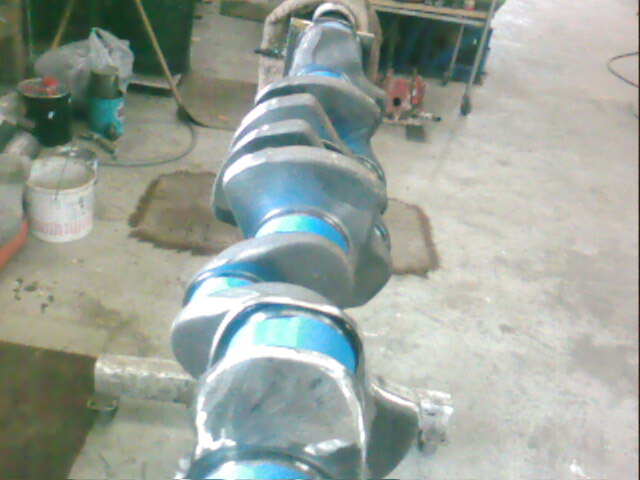

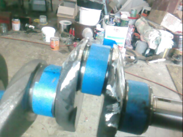

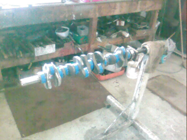

Progress has been a little slow but good things take time. Len is fairly busy at the moment but a few things have been done. Crank has been cleaned up and hot bathed, the block has been hot bathed and shot peaned (spelling) and checked to be true, the head has been cleaned with the injector notches welded. Cam has been reground 72 degrees, i dropped the clutch off to him Exedy ceramic button clutch. Fly wheel has been balanced and lightened aswell. He told me he really likes to put in time and get things perfect but sadly the real jobs that make real money are taking precedence which is fair enough considering. Im expecting it back and all together by the end of Jan as he said he should be quite after christmas.
