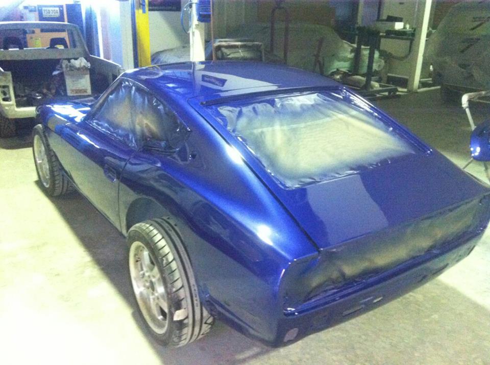

changed jobs, moved house, paintwork crazed and went to shit, stripped it all back, took it to a professional shop to get done, changed the colour slightly while it was there.

For the last 2 months the car has been stuck in paint jail, he did me a good deal so unfortunately that meant my car would take a back seat if something more important came along, I have my wedding coming up in November and im trying my hardest to have the car presentable for that, most likely only on a temp permit.
Im also trying to get as much done as possible, as i am looking to buy a house near the end of the year. that should be pretty good at sucking out any remaining money for a while.
BUT! Good news, i got sent a photo from the painters today and i have organised for my car to come home on Thursday arvo, right in time for re-assembly on Friday, Saturday and Sunday.
I should be able to get most of it done over those days, so that'll be awesome!
anyways, Progress pics!!!!
(more to come after i put it back together, i promise)

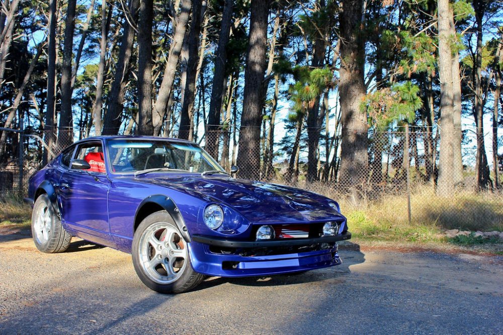

Took it out for a quick spin down the street this afternoon, its pretty rough, needs to be tuned and have a good going over the suspension and driveline.
Unfortunately my rear main seal has started leaking, so the plan is to get the gearbox off and replace it. I also need to fix up a slight leak from one of the brake line connections, but thats an easy re-flare job.
by no means is it finished though, on the outside i still need a couple of badges for the pillars, a pair of FG bumpers, a nicer set of wheels and some small detailing.
I havent decided what to do with the front corner lights yet, im undecided on whether to put the standard original ones in, fit LED insides to the standard housings, or build a custom set from scratch.
I havent touched the rear suspension or the interior yet, so i still have plenty left to keep me busy.
lol, ride height still in 4x4 mode ;D
I'll get dropped, dont worry about that.
the wheels are ok, bit of gutter rash around the edges but reasonably heavy, I want to get some Lenso D1-R in 17x8"
that'll finish it off nicely.
As for the spot lights, i made some small mounting brackets that are welded to the bonnet hinges, they bolt on sideways onto them.
I have some HID inserts to go into them, so they'll project a pencil beam spot almost 1km when they are on  8)

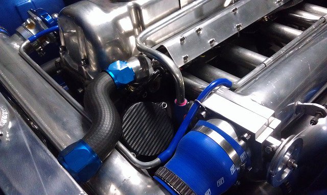

seeing as i no longer had any leads coming off the cap, i decided to smooth it over and make it neat looking.
I cut the top off the cap, leaving about 1cm worth of the bottom of the cap. Then i laid come fibreglass on the inside of the cap to fill the gaping hole.
after that dried i sanded the outer edges, smoothing it all off.
a bit of 3M carbon fibre vinyl wrap and it looks the goods now.  8)

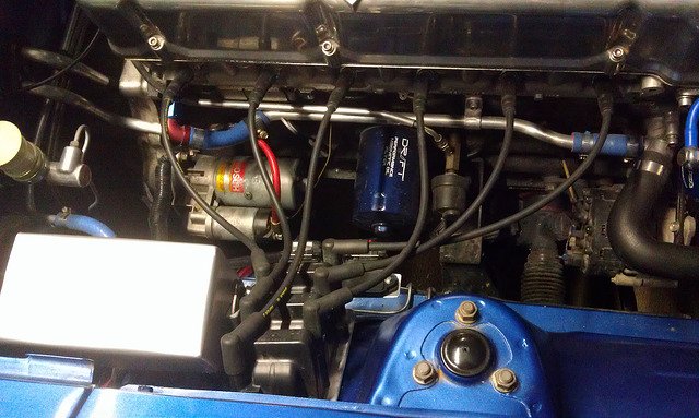

For the coil pack, i used an Au falcon coil pack.
Its what they call a 'dumb' ignition system, as the dwell and ignition firing control is done via the ignition module instead of incorporated within the coil.
(EDIS module for anyone looking at the 'standard' setup)
The coil is mounted on a peice of alloy plate to help with heat dissipation, with the ignition modules mounted just below the coils.
In my setup, i used 3 Bosch 124 ignition modules, 1 per waste spark coil.
Its also possible to use a 3 channel ignition module from something like an Audi V6 motor or some skyline RB motors, but getting the wiring plugs can be a pain.
Cost wise it ends up about the same.
I like the individual module setup as it gives some redundancy, eg, if one of the modules burns out, it'll still run on 4 cylinders, not very well, but enough to get it off the road ect.
With a fully incorporated system, once one bit breaks, it all stops.

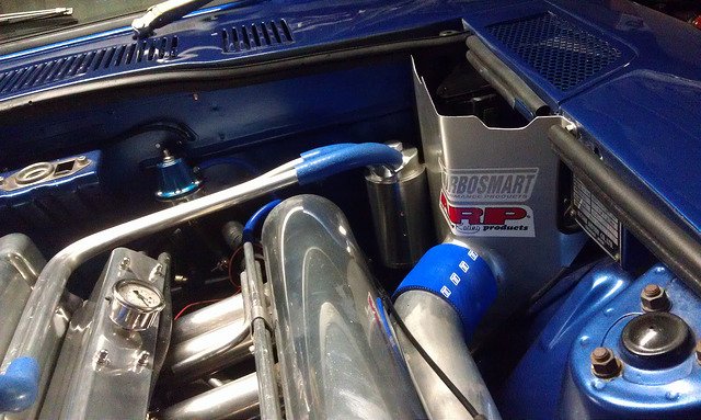

I also finally mounted my oil catch can and finished off the engine breather pipes.
The catch can is mounted to the side of the airbox wall. inside the airbox there is a fitting that passes into the catch can, with a hose running from that to the inlet pipe just after the air filter.
End result is a catch can that works and burns the fumes, instead of being all illegal and venting to atmo.
(pro tip, fill your catch can with steel wool, it helps the oil vapour to shed the oil and stay in the can.)
