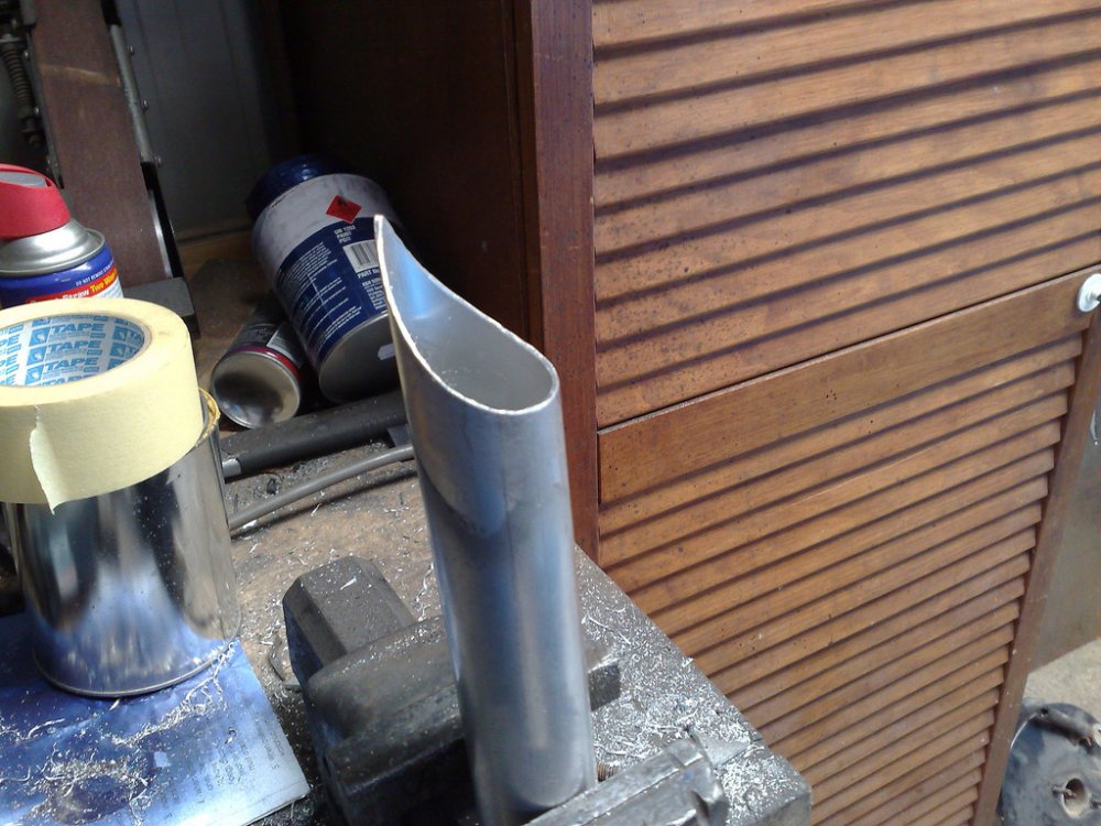

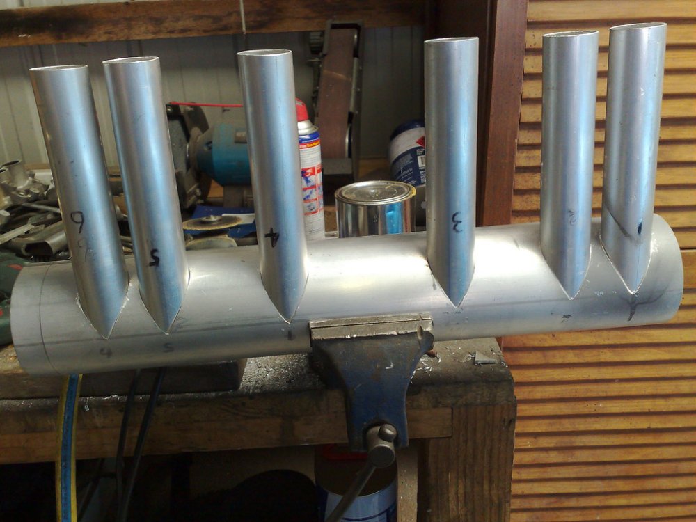

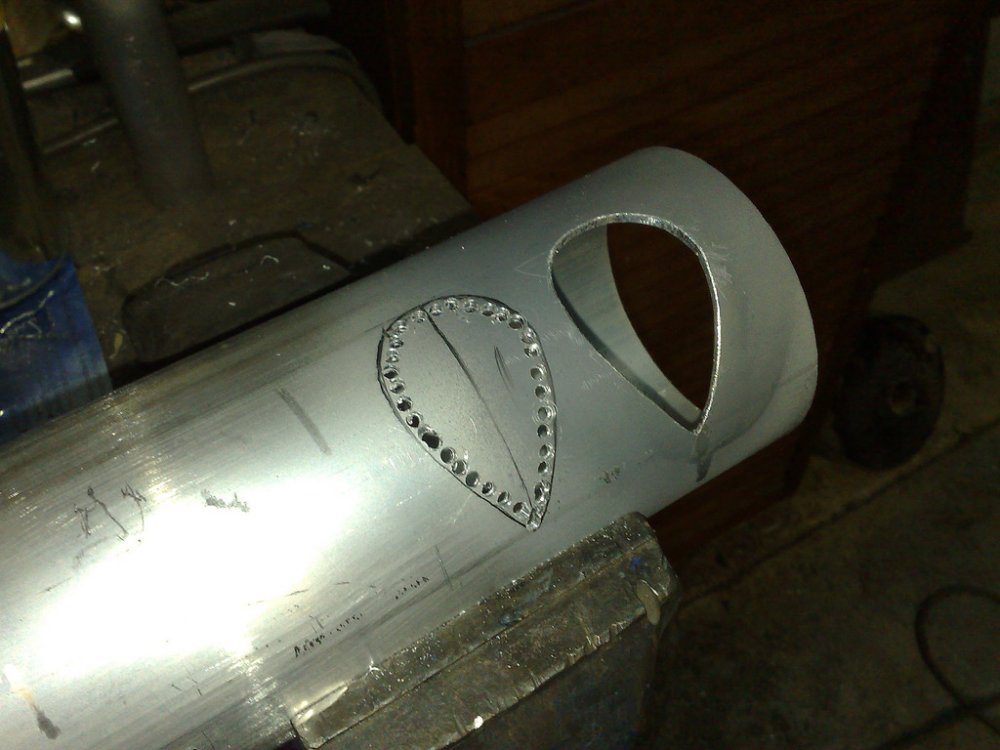

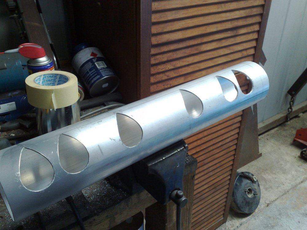

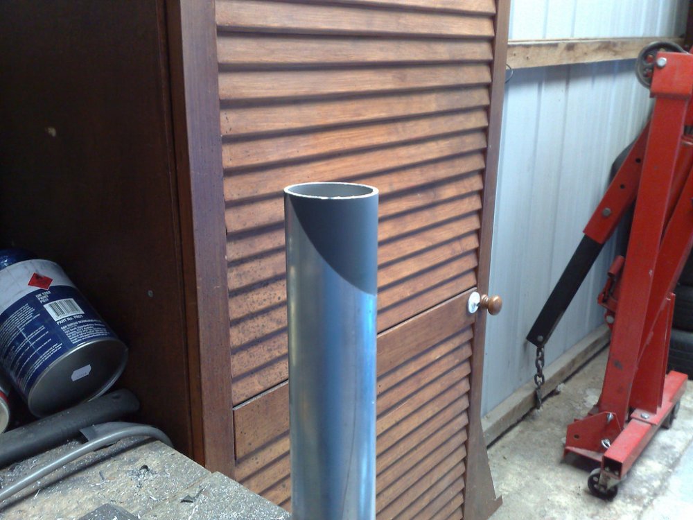

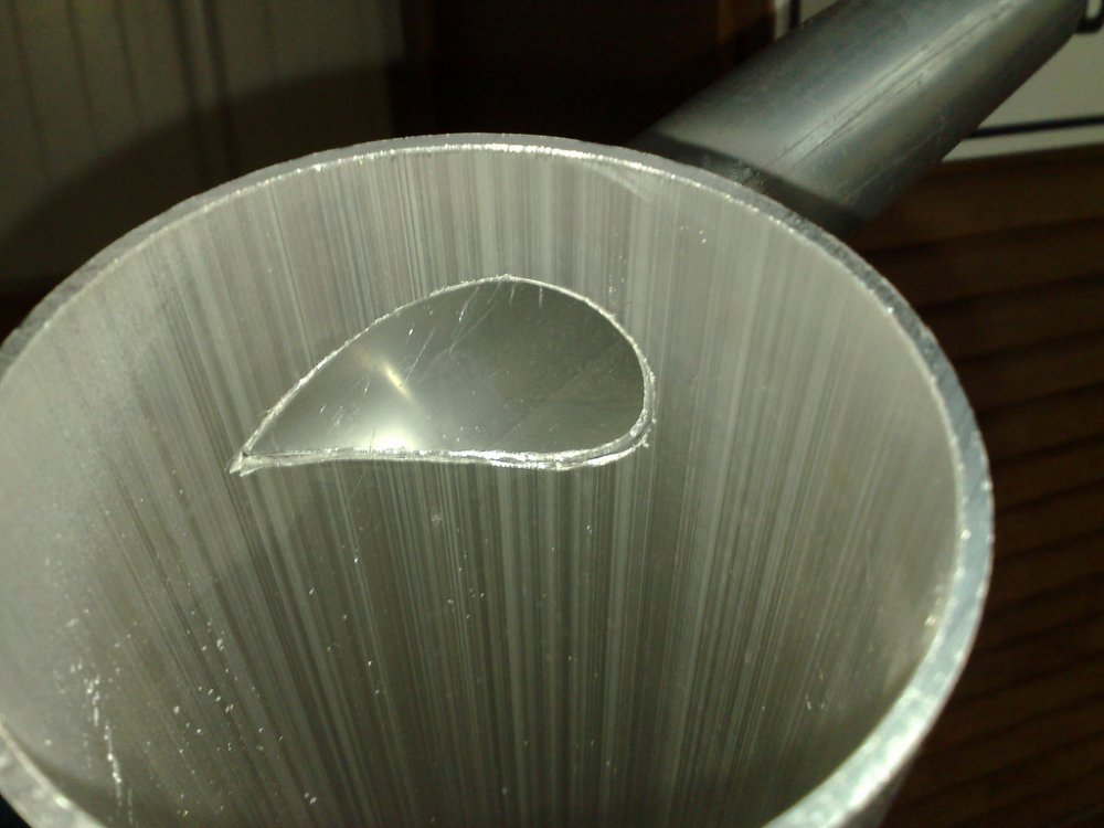

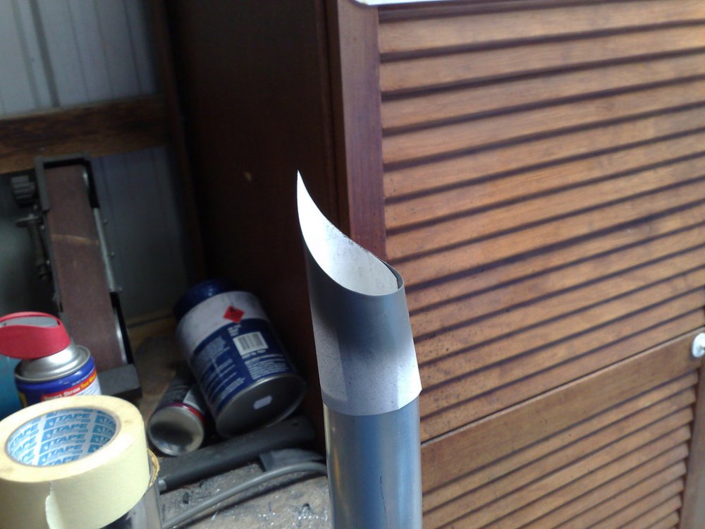

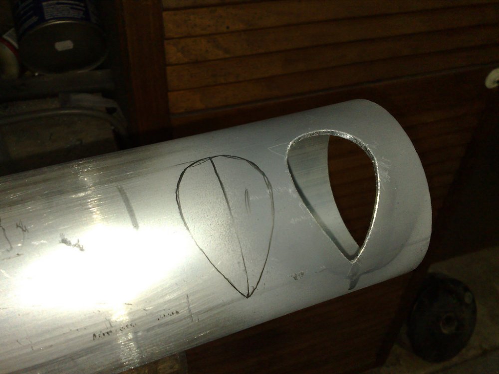

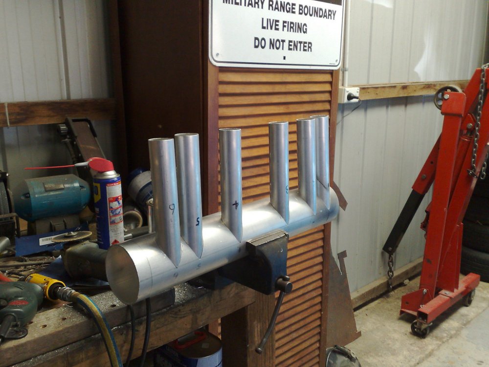

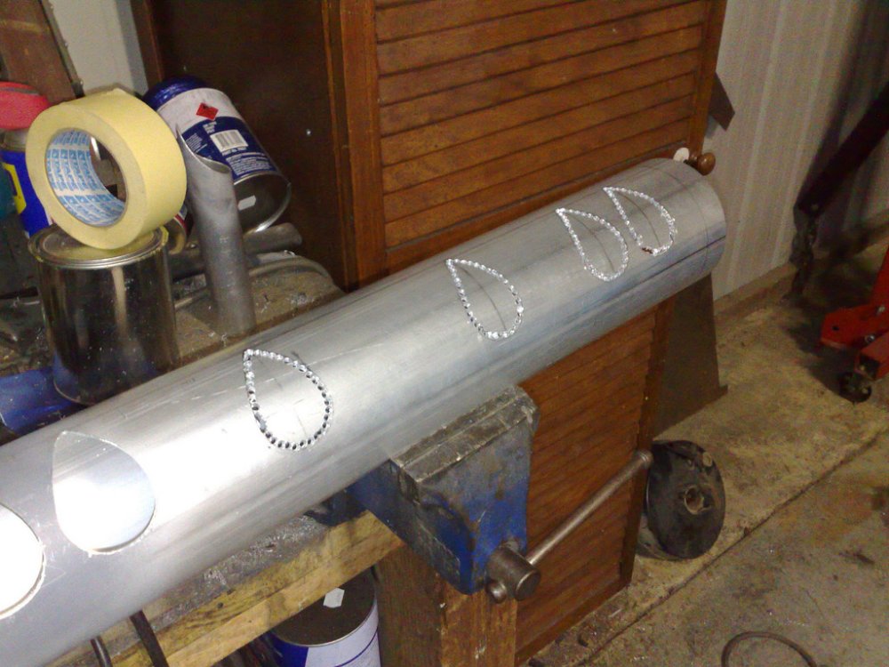

nizm0zed Posted January 11, 2009 Author Posted January 11, 2009 okies, been working on my new manifold. firstly, i found a brilliant free program on the net, for working out how to cut pipes so they fit together. its a massive timesaver. http://metalgeek.com/static/cope.pcgi from there, i started with a runner, cut to roughly the right length. 11012009215 by Alan Hartcher, on Flickr then i got my template. 11012009217 by Alan Hartcher, on Flickr put it on my pipe, 11012009216 by Alan Hartcher, on Flickr marked it with spraypaint, 11012009218 by Alan Hartcher, on Flickr and cut out the painted bit. 11012009219 by Alan Hartcher, on Flickr from there, i took my new peice of pipe, and marked it against the plenum, again with spraypaint. just hold it against it, and spray around it. i cut that out, and trimmed the hole. after that hole was perfect, i made a template of it, to do the other holes. 10012009206 by Alan Hartcher, on Flickr 10012009207 by Alan Hartcher, on Flickr 10012009205 by Alan Hartcher, on Flickr 10012009210 by Alan Hartcher, on Flickr the other holes were marked, and cut, needing LOTS of careful drilling, and then grinding out with a die grinder. 10012009211 by Alan Hartcher, on Flickr 10012009212 by Alan Hartcher, on Flickr 10012009213 by Alan Hartcher, on Flickr 10012009214 by Alan Hartcher, on Flickr 11012009220 by Alan Hartcher, on Flickr once i had done all the runners, it was all carefully placed together, to see the fit. 11012009223 by Alan Hartcher, on Flickr 11012009224 by Alan Hartcher, on Flickr you can see that each runner is numbered, thats because each runner is ground specifically for each hole, as they arent a 100% even match. this ensures that it'll all be as close as possible when i weld it together. now i have to make a jig, to keep all the runners even, and in the right spot, so i can weld them to the plenum, then trim the ends to the right length and weld on the peice of manifold that i trimmed earlier. once thats done, i'll smooth out everything inside, and weld on an end plate and throttle body mount. then i can keep doing the intercooler piping, and mount that stupidly oversized BOV. yes, lots of pics i know, but this is the first one i have done, and i figure others would like to see how easy it is to actually do in your own garage. this is all done with simple tools, a hacksaw, 4" grinder, hand files, die grinder, cardboard and markers. If you dont have the facilities to weld it together, you can allways take it to a shop to be done for you. Quote
zedevan Posted January 11, 2009 Posted January 11, 2009 looks good to me, how did u work out what large diameter tube to use? does it have the same cross sectional area of the 6 smaller tubes or ? actually, its feb 76. thats when ADR27a was introduced. everything before that can vent to atmo my car was made in january 76! so that makes me very happy, the vin plate only has adr 27 listed, seems like i narrowly dodged a bullet there... Quote
nizm0zed Posted January 11, 2009 Author Posted January 11, 2009 I picked the diameter of the tube for the plenum out of thin air no really, i did. im sure there is a fair bit of math, and theory to it, but i went with the rule that the capacity should at least be the same as the engine capacity, that and the 4 inch tube matched well with the throttle body that'll go on there. Quote

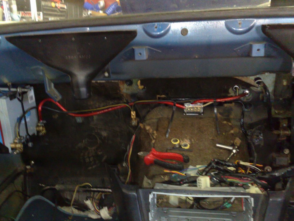

nizm0zed Posted January 25, 2009 Author Posted January 25, 2009 well, still around, finished a 16 day week (in retail ) and had the weekend off, back to work on monday for 7 days straight. I have a full week off after that, so hoping to get a bit done. i have mounted my willwood rear bias adjuster, and have been working on the wiring under the dash. I have incorporated the Alarm, Central locking, power mirrors, windows and stereo into the factory loom, Inc proper plug connections. worst bit is i have to anticipate how i may change the car later down the track, and put the wires in now for it. Im thinking with the big ass space that was left under the dash after removing the heater box, i'll mount the amplifier, and build a carputer for it, replacing the heater controls with a 10" touch screen. yea bling i know, but isnt it obvious im not interested in concours? short term though, it'll just be a regular stereo for the sake of some tunes. more progress pics in a week, i promise Quote

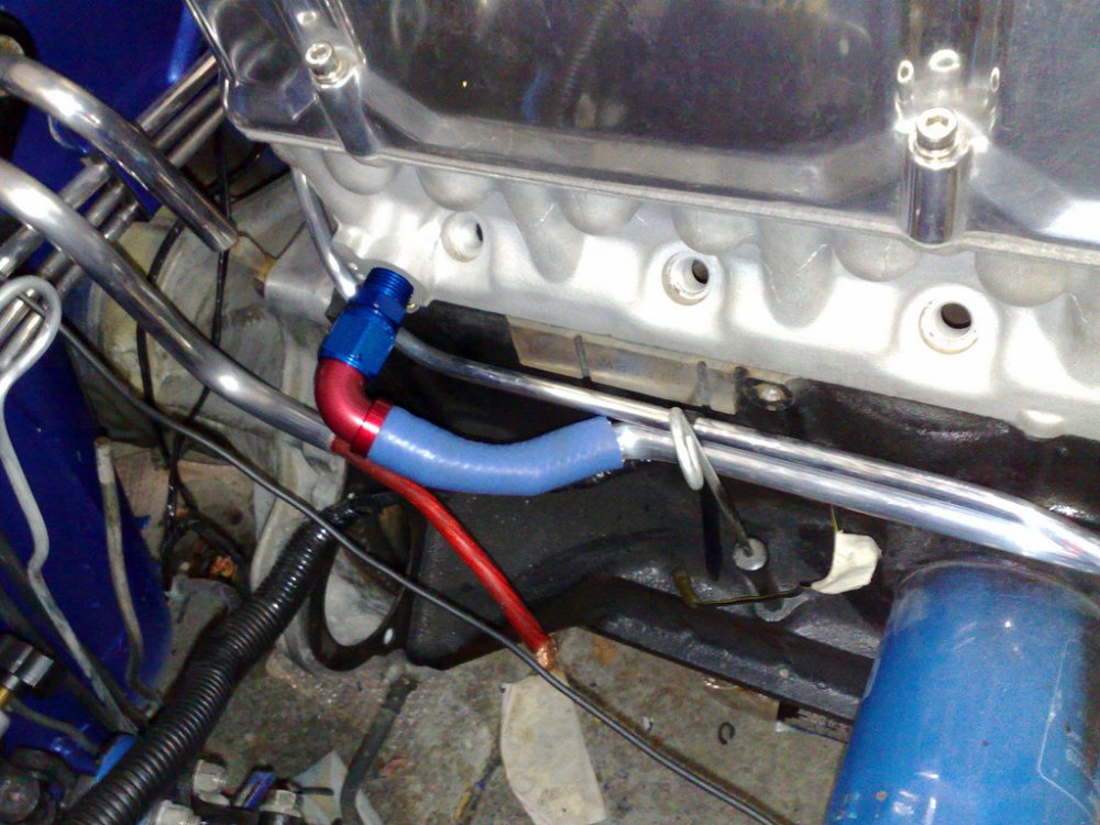

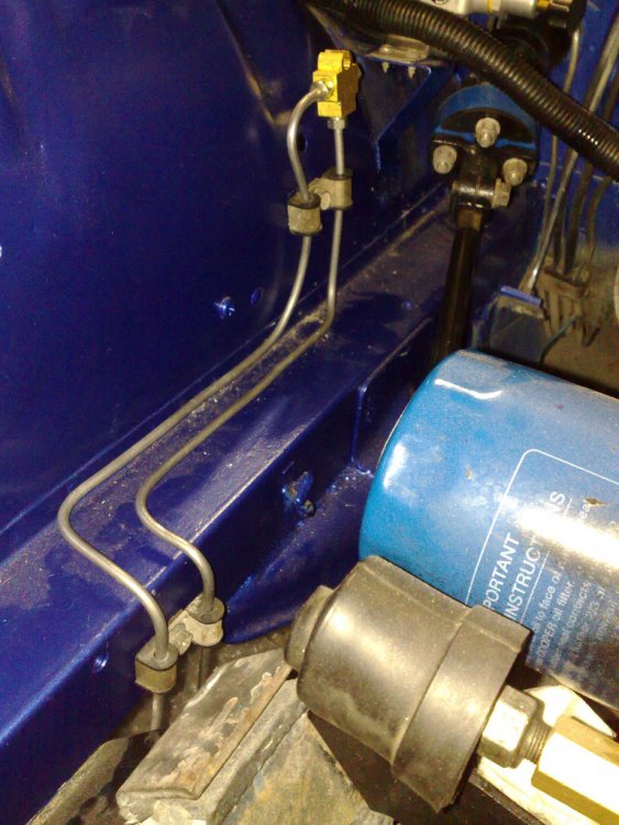

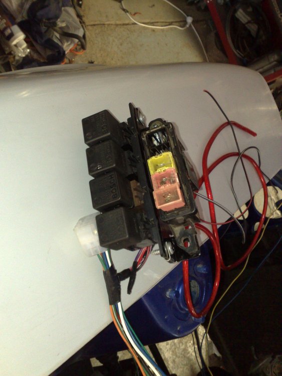

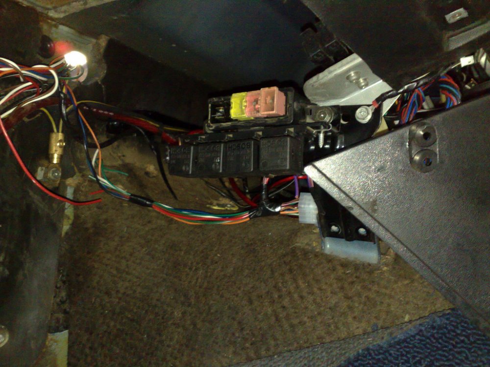

nizm0zed Posted February 21, 2009 Author Posted February 21, 2009 well, been working hard over the last few weeks, so i haven't had much time to work on the car. but, i have managed to do a few small jobs in my limited spare time. most of it is very unexciting, so not really picture worthy. just been doing all the under dash wiring. and finishing off the brakes. as i mentioned in one of my posts before, i mounted the bias valve, and finished the lines, just need to polish it all up now. 03022009229 by Alan Hartcher, on Flickr 03022009230 by Alan Hartcher, on Flickr 03022009228 by Alan Hartcher, on Flickr I have removed the heater box, and have ran the main power wiring inside to the battery thats mounted in the foot well, a distribution block came in handy for all the new power wires. I had to make up a new bracket for my custom fuel line brackets to bolt onto, as they previously went onto the heater box mounting points. I also rerouted the coolant pipe on the side of the motor. 04022009231 by Alan Hartcher, on Flickr 01012009201 by Alan Hartcher, on Flickr 07022009233 by Alan Hartcher, on Flickr because i removed parts of the engine bay wiring, eg, the shunt and fusible links, and had to move the coil wiring and temp sender wiring to the passenger side of the firewall, i have gone to the effort of making it all stock like. So, along with the alarm wiring, stereo etc, its all neatly routed in place, and wrapped in black electrical tape. the EFI wiring was needed too, so thats all mostly in place now. I cant build the manifold loom till i finish the basic manifold, but i needed to build a relay and fuse box for all the extras going into the car. So, one engine bay fuse box salvaged from a VR commo + some creative wiring and a custom mount bracket = 21022009237 by Alan Hartcher, on Flickr the white plug you can see under it, and the loom that comes off it, is the ECU loom. its all integrated into the relay and fuse box, its pretty much all standalone to the rest of the car, there is only a big fat power wire, ground wire, Ignition switched wire, and the aforementioned coil and coolant temp wires connected to it. it'll make it very easy to adapt to a microtech later on down the track. for now, two of the fuses are left out, one is for the thermo fan power and relay, the other is for the heater system i still have to build. and, how its mounted in the car. 21022009240 by Alan Hartcher, on Flickr Quote

nizm0zed Posted February 21, 2009 Author Posted February 21, 2009 just one wire at a time. and it helps to draw your circuit diagram before hand, so you have a map to follow. Quote

nizm0zed Posted February 21, 2009 Author Posted February 21, 2009 amazingly enough, i find designing and building electrical systems quite relaxing. diagnosing and troubleshooting on the other hand, bugger that! Quote

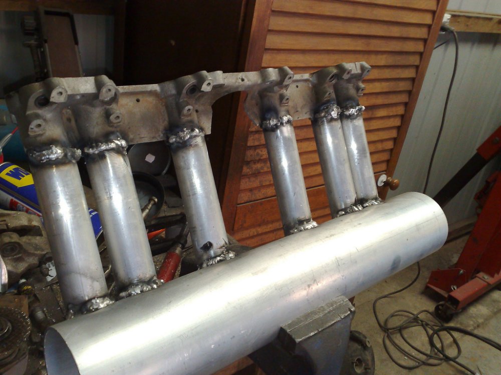

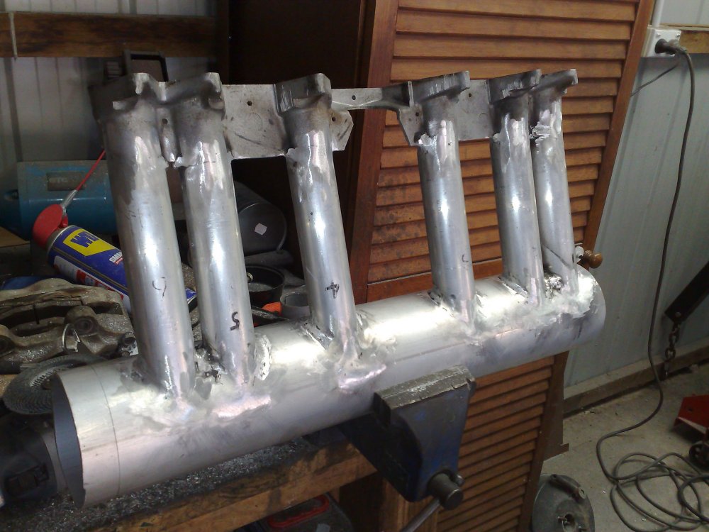

nizm0zed Posted March 22, 2009 Author Posted March 22, 2009 well, been working hard again. got some wire for my mig, and connected up my gas bottle, so i thought i may as well tack the manifold together so i could do the engine wiring loom. I got carried away, and welded up most of the manifold. 21032009251 by Alan Hartcher, on Flickr yea, messy i know, but i havent mig welded in a LONG time, and this is the first time i have ever done alloy. anyways, i ground back my welds, and cleaned everything up. 22032009254 by Alan Hartcher, on Flickr once that was done, i started working on the loom. I had a rough idea of how i wanted to do it, and to be honest, im real damn impressed with the end result. the top pipe will house the throttle cable, and i will weld the throttle body on an angle. Just need to make up a plate for it, and buy a throttle body. those 100mm billet alloy ones are looking mighty tempting 22032009258 by Alan Hartcher, on Flickr 22032009255 by Alan Hartcher, on Flickr I will start on the fuel rail soon, and get that in place. I have a peice of extruded rail, ready for the job. I need to find a workshop capable of drilling out the injector bosses, and making sure the finish is diamond smooth. Otherwise they have a tendency to leak. Quote

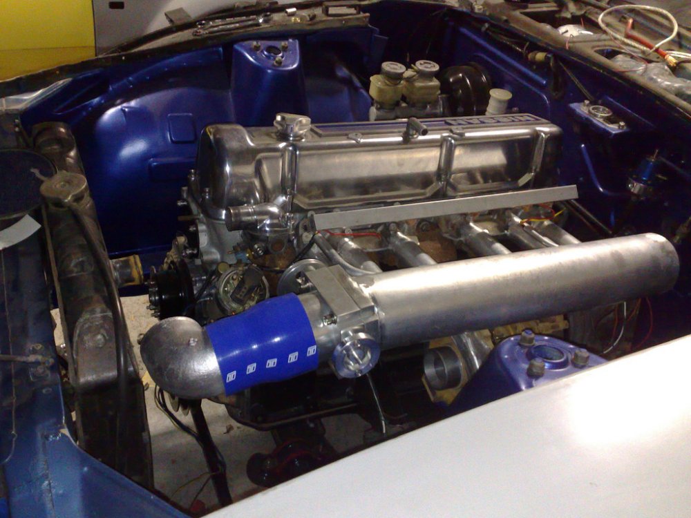

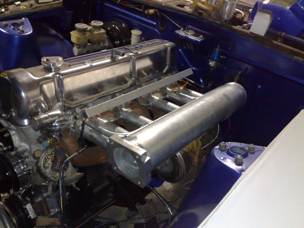

nizm0zed Posted April 7, 2009 Author Posted April 7, 2009 well, got the rail drilled by M&A engineering. I dropped my injectors off for servicing, and flowbenching. I welded on the throttle body, and the back of the plenum. that was jigsawed out of a peice of 10mm thick plate. I needed it thick enough that i could tap directly into it. 07042009261 by Alan Hartcher, on Flickr 07042009262 by Alan Hartcher, on Flickr 07042009267 by Alan Hartcher, on Flickr 07042009268 by Alan Hartcher, on Flickr aaaaaaand, just for the hell of it, Things that fit in my throttle body 07042009265 by Alan Hartcher, on Flickr my BOV. 07042009263 by Alan Hartcher, on Flickr Quote

JP Posted April 8, 2009 Posted April 8, 2009 because i removed parts of the engine bay wiring, eg, the shunt and fusible links, and had to move the coil wiring and temp sender wiring to the passenger side of the firewall, i have gone to the effort of making it all stock like. How did you tackle removing the fusible links? I moved my battery also and put a jumper post in the engine bay. I connected the red/white power circuits from the fusible links directly to the jumper post as the cable to the battery has a circuit breaker on it. I am still in two minds whether some individual fusible links should be applied to these circuits though... Quote
