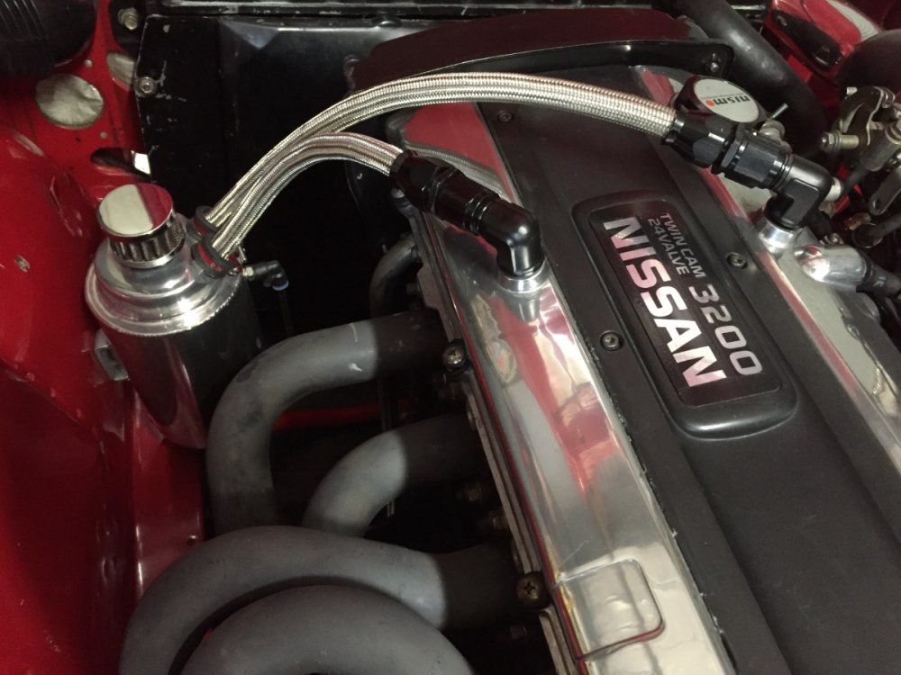

CBR Jeff Posted March 3, 2021 Posted March 3, 2021 Block breather is blocked off so only breather is through the rocker cover. Runs into a catch can under the coil and then back to the middle air cleaner. All mounted using existing holes from memory. Just like you are thinking about Gav. Jeff gav240z 1 Quote
260DET Posted March 3, 2021 Posted March 3, 2021 My preference every day would be to use a block breather in preference to one up top but for a road car it probably does not matter too much. gav240z 1 Quote
Administrators gav240z Posted March 5, 2021 Author Administrators Posted March 5, 2021 Hey Scotty, do you know what brand of catch can that is? I need 2 inputs and the little breather on top is probably sufficient for me. Would keep it neat. Quote

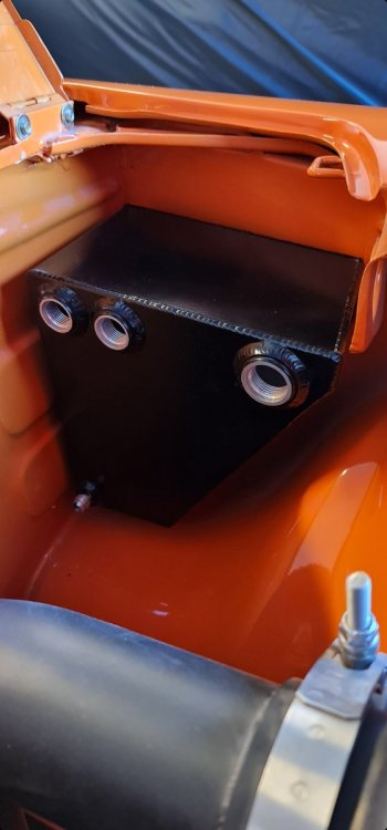

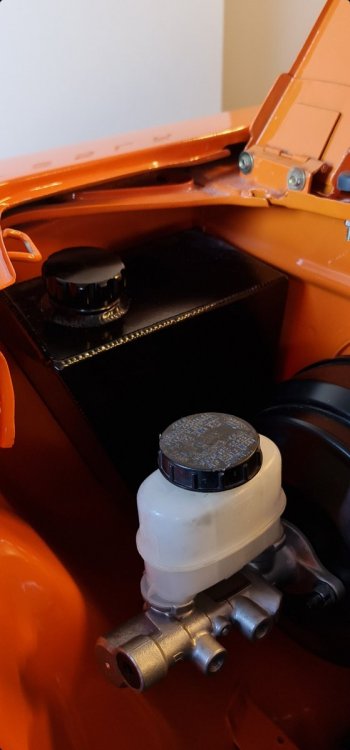

JDM-TOY Posted March 6, 2021 Posted March 6, 2021 @gav240z I had my battery tray cut out and I got a custom catch can made for the RB and a replica wiper water bottle. Hidden and simple gav240z 1 Quote
ScottyD Posted March 6, 2021 Posted March 6, 2021 22 hours ago, gav240z said: Hey Scotty, do you know what brand of catch can that is? I need 2 inputs and the little breather on top is probably sufficient for me. Would keep it neat. Sorry Gav no brand, it was already installed when I purchased my Z. Quote
