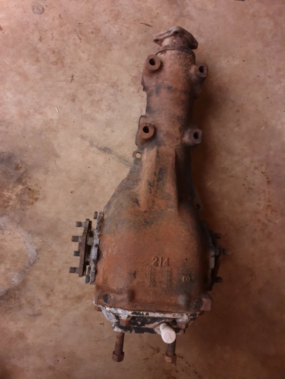

  4. Selling the diff out of my 73Z. believe its a R180, 3.9 ratio. was taken out for an R200 conversion. Has rear mounting bolts and nuts, breather is intact. In Adelaide can deliver locally if required. $150 Will Consider any reasonable offer

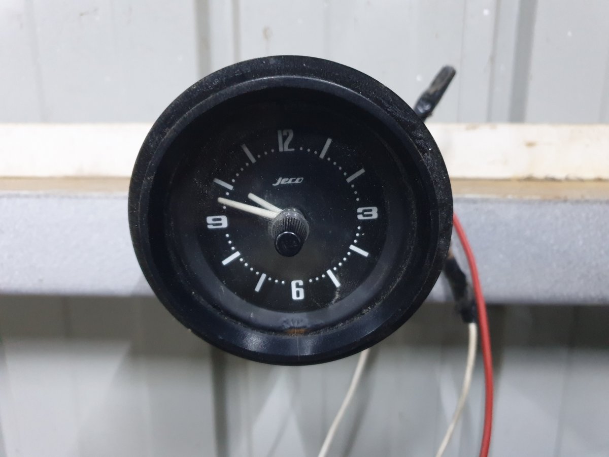

  6. Needed a clock for the workshop. Actually just rebuilt this one so am letting it run to make sure it works. Love the mechanical ticking sound it makes

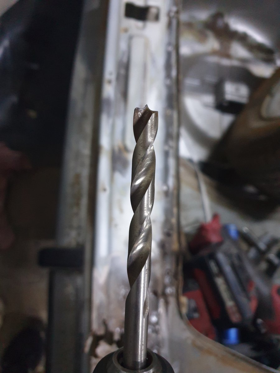

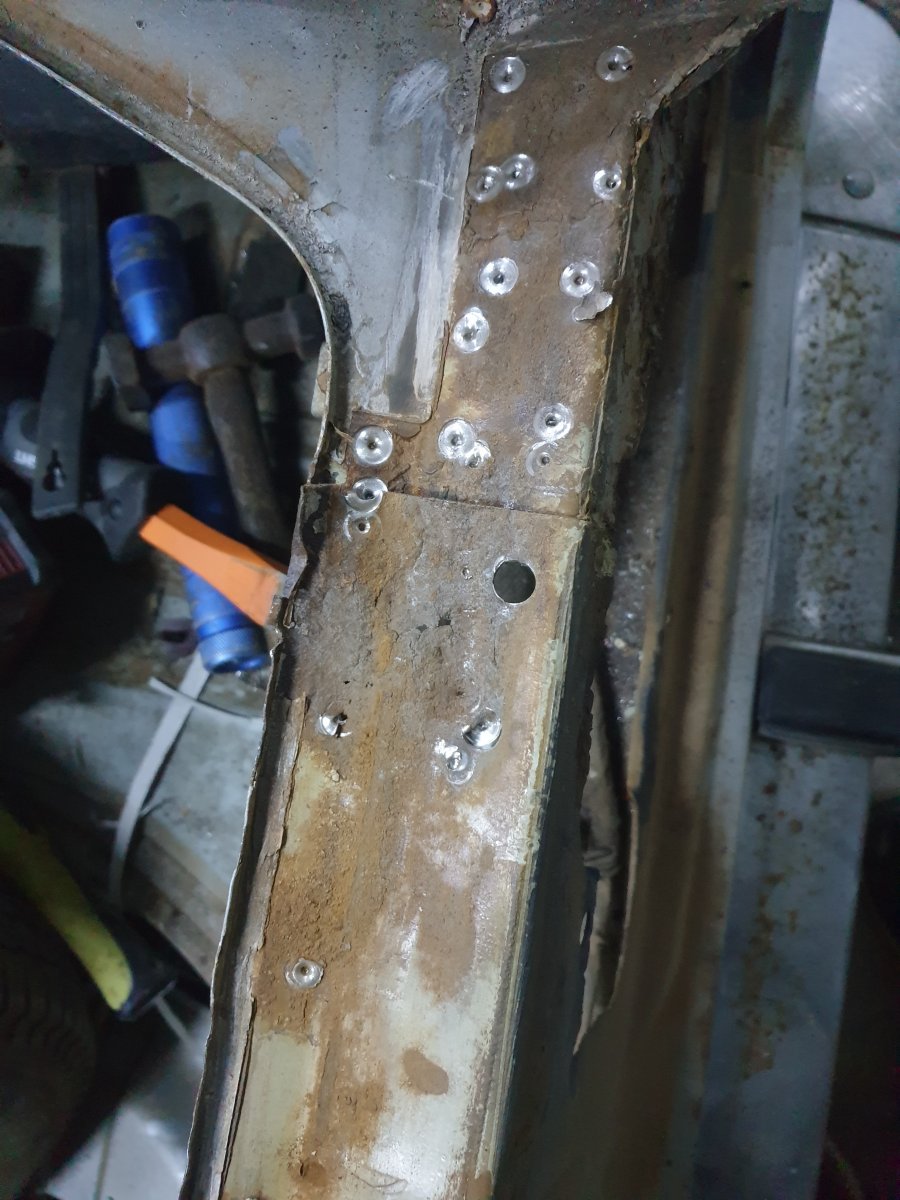

  10. Time to remove the slam panel. Thought about buying a spot weld cutter but thought why not regrind a drill bit . Seems to do the job well. Now just to find all the hidden spot welds. Have been reading through a couple others builds to locate them. At first the panel only had a small blister turned out to be full of big on each end. So I guess I will be ordering in the rare spares replacement one

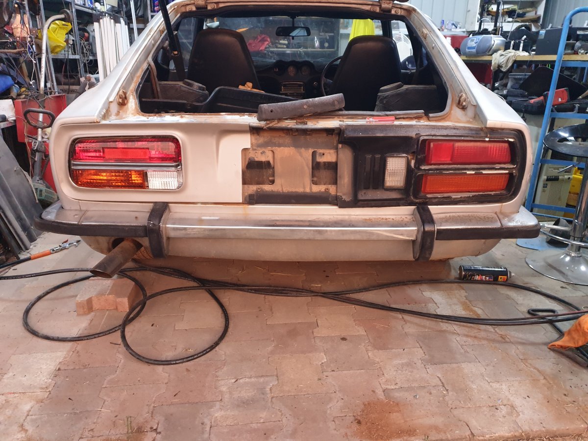

  13. Finally got my 73 rust bucket into the shed. Final inspiration was seeing jeff43's beauty parked at my neighbours place I figure the easiest way to get going is to start at the rear bumper and work forwards. Have been collecting parts , will need front bumper, windscreen washer bottle, air ducts from rad support panel. I'm sure more bits will be needed . And I have a working clock First task get rid of the 260 tail lights and replace with 240 ones . Because of the butchery that was done to pu in the 260 lights they didn't seal properly and the typical cancer above the tail light has taken hold. I'm wondering if the car had been hit in the rear hence the replacement lights. Rear hatch is full of big and looks like it had a rear spoiler fitted at one point. Lots of rust removal. Typical spots., dog leg floors (have replacement floors) lower guards, I'm guessing the frame rails will be shot. I guess I will be an expert welder when I'm done. Have a couple of trashed panels I have been practicing on. Anyway will post more pics as I progress

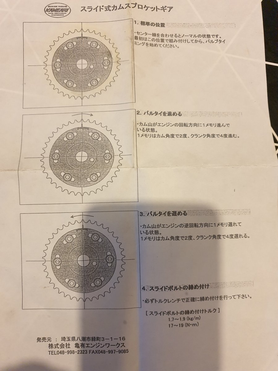

  18. I have one at home I will measure it up and let you know tonight. Just measured mine up and it appears to be able to go more than one tooth each way and from measuring the sprocket it is about +- 10 degrees rotation of the cam so in term of crankshaft I guess it would be double that Here is the instruction sheet that comes with it if you can read Japanese.
