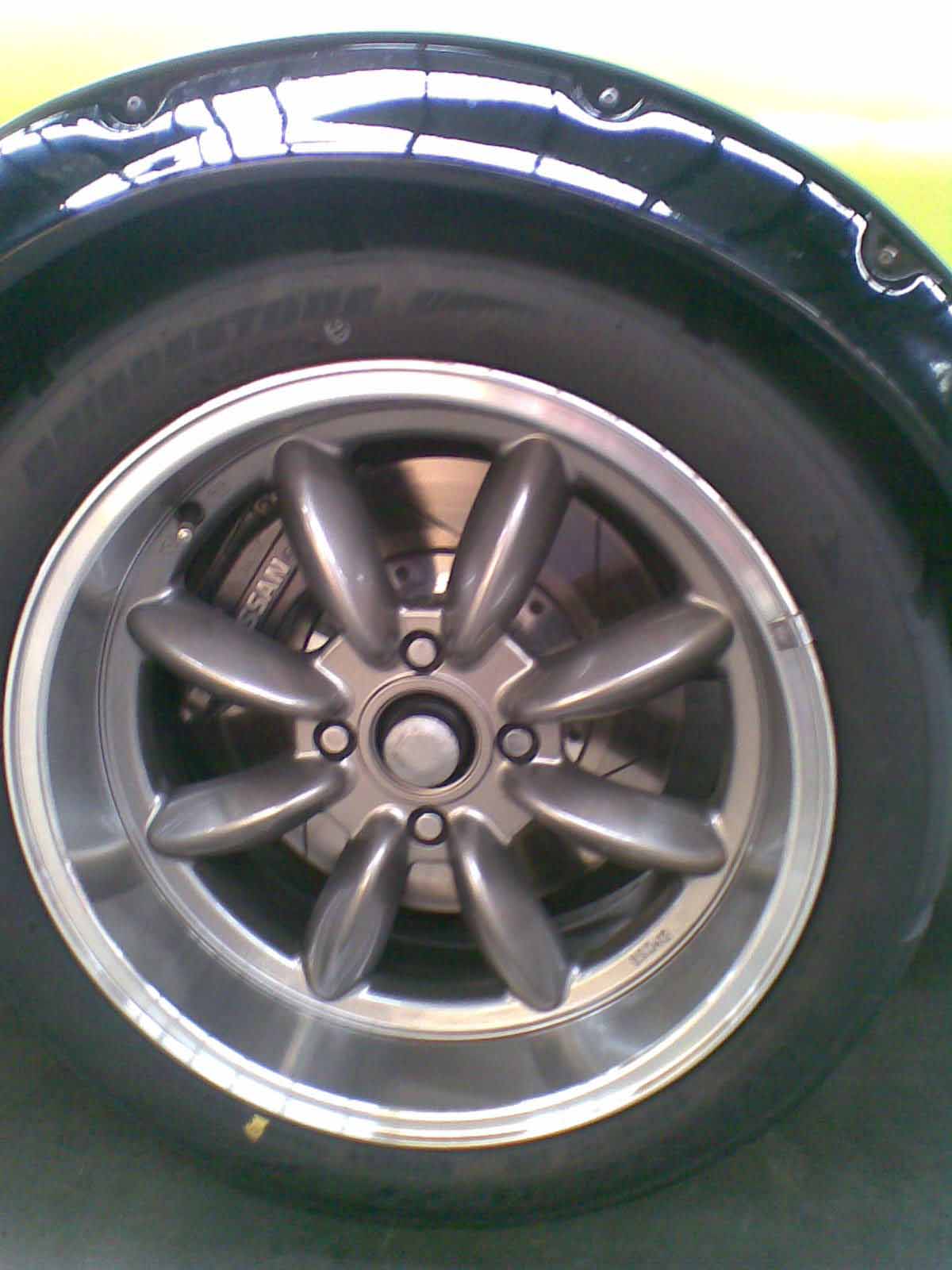

Scando Posted May 24, 2009 Author Posted May 24, 2009 Here's some pics of the front brake upgrade as requested. Sorry for the dodgey phone pics and sorry it's taken me so long to get off my lazy butt and post these up! -The first pic is of the bracket, I know it doesn't look much but it does the job! It would be easy to make something that looked neater. -The second pick shows the hats and the assembly all bolted together in the car. -And the third pic is how it sits under the wheels. If anybody is serious about doing this conversion then I can provide more info but I don't have measurements of the brackets sorry. Quote
