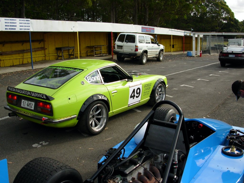

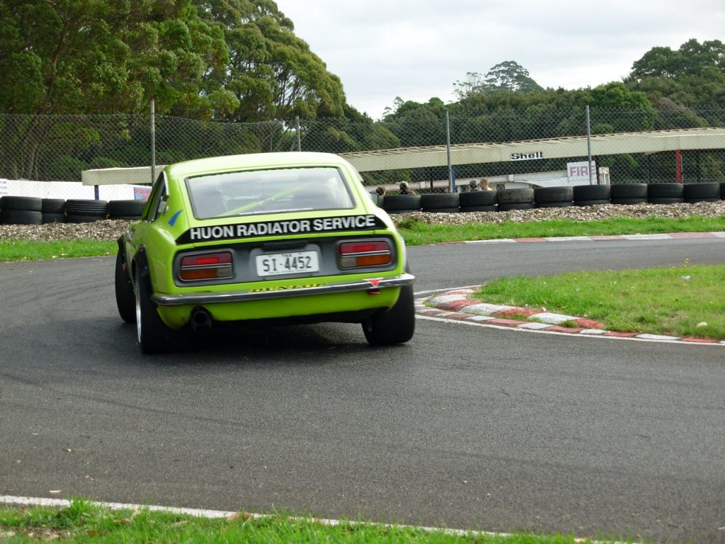

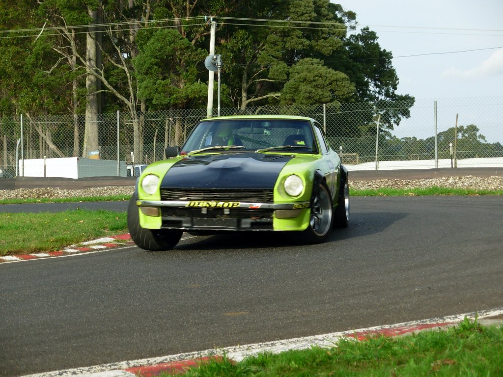

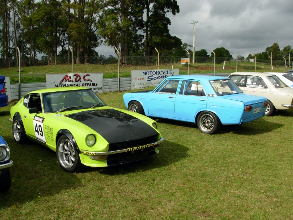

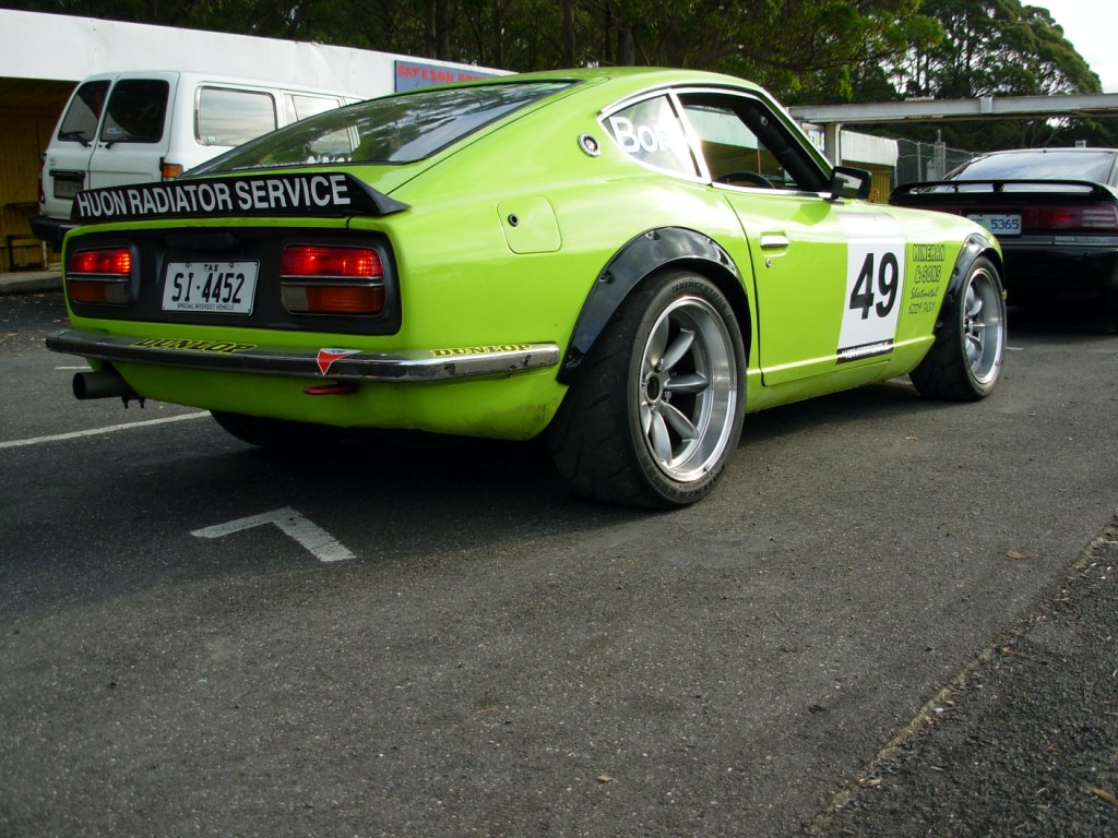

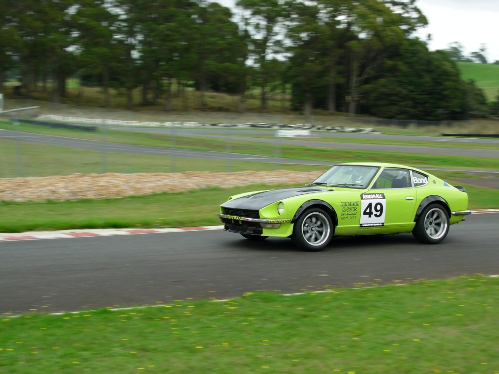

bluerat Posted April 19, 2010 Posted April 19, 2010 Scando popped up to the north of the state and competed in our Kart track lap sprint day and carved up the local's to score a 2nd outright behind a WRX STI tarmac rally car, and 1st in class. It looked and sounded fantastic!! what a weapon. Quote
sco_aus Posted April 19, 2010 Posted April 19, 2010 Me too. And now i know exactly what my zed will look like with the Rota RBs im getting, fucking hot like yours Quote
Scando Posted April 19, 2010 Author Posted April 19, 2010 Me too. And now i know exactly what my zed will look like with the Rota RBs im getting, fudgeing hot like yours What widths did you go for Scott? Your car will look great with them on. Big thanks to Bluerat and Mrs Bluerat for the accommodation for the weekend. What Bluerat failed to mention is that he also carved a track in his L20 powered 1600 to win the under 2 litre class by over 2 seconds! A 200B rally car with an L20 stroked to 2.4 litres also won the 2-3 litre class to give the mighty Datsun badge 3 out of 6 class wins! I got some good in-car footage from the weekend so i'll put it up on youtube when I get a chance. Quote
Scando Posted April 20, 2010 Author Posted April 20, 2010 I am thinking 17x9 and 17x9.5 I originally tried to go for 17x9 all round but the offset doesn't suit the fronts all that well. I know there are plenty of guys running them but most of them end up with 225 rubber to squeeze them in under the flares which defeats the purpose for me. I ended up going for the 8.5 fronts with 9 rears with 245 rubber on the front and 255 on the rear. The offset on the 8.5's is spot on for the front (if you're running coil overs) so it allows you to run the widest rubber from what I've seen . There would be room for more rubber under the rear than the 255s but that's the widest most companies make 17 inch semi slicks so there was no point me going to the 9.5. I'm sure you could get 265 x 17 road tyres though. How did you go with the Z32 Transmission? All I've done so far is bought the fitting kit. My house got started just before christmas so the poor Z has sat untouched since then until I dragged it out for this event. I just ran a 280ZX box I had kicking about because I knew this event would be easy on the drivetrain. I'm looking to have a Z32 box in by August to run a round of our state series. Quote
