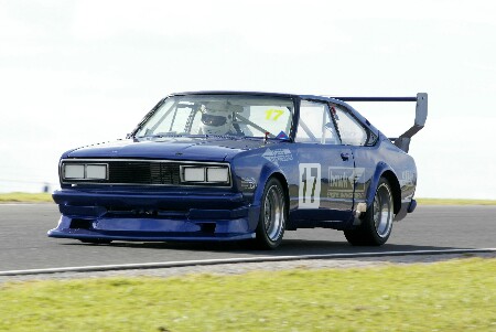

Moderators Zedman240® Posted September 10, 2009 Moderators Posted September 10, 2009 Found a pic of Steve Newings 2 ltr Stanza sports sedan with the heli rear wing... Quote
Scando Posted September 11, 2009 Author Posted September 11, 2009 That's a serious wing! Simon, the big wing will definately work. My 240 had a RX7 Group C bird bath when first built for 2B Marque Sports and it could be driven flat through turn 1 at eastern Creek, the duck tail won't let you go anywhere near that quick. I know Dat2kman, Jason will have some moulds soon, and I have a spoiler. They do need to be modified to sit best on the car, and need to be done as a three piece to work properly. You should get yourself to brisvegas so we can get the aero you need working I'm heading to QLD for a holiday in a week. The Z is a bit big to fit in my suitcase though Quote
