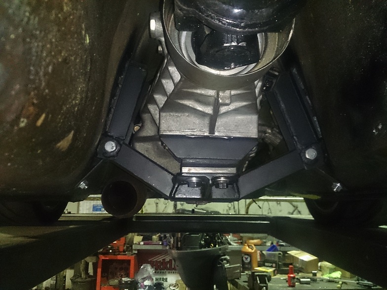

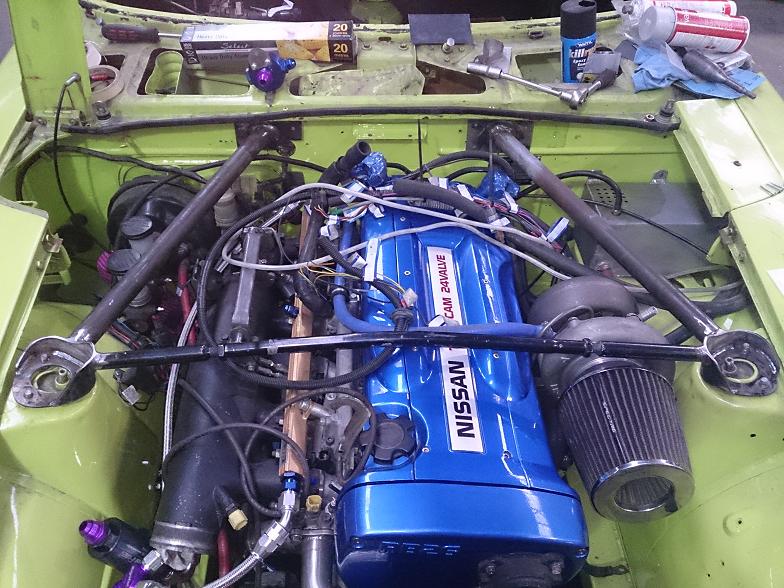

Scando Posted May 22, 2015 Author Posted May 22, 2015 The thread about lack of content made me realise how slack I've been. Since my last update we've had a daughter and she's now over 2, which also has a bit to do with the lack of posts The engine is mounted, plumbed in and just awaiting wiring. A mate (SBF Fabrications) modified a patrol sump for me to make it 6.5 litres with wings and a gate. It was a bit of a battle to get enough volume in the sump with the engine sitting so low but I'm happy with what we came up with. We have vented the sump to both the head and the catch can to try and relieve a lot of the oil issues RB's have on the track. We also fitted a resticter in one oil feed and blocked off the other, and enlarged the oil returns as per the guidelines on the SAU forum. I ordered a CRS gearbox mount and it was complete rubbish so we came up with our own desing which I'm much happier with. It uses the strength in the tunnel where the original mounting points are rather than the flimsy floorpan and chassis rails that the CRS mount uses. We also now have room for the exhaust which the CRS mount seems to neglect! Funds were running short and we've never built an RB before or an engine for E85. So we decided to do a throw together out of 2nd hand bits to see if everything works the way we think it will. The bottom end uses the standard RB30 crank and rods with RB25 pistons and the block decked 30 thou to bring the pistons back up flush with the block. This will give me a compression ratio of around 9.5:1 which is what I was after. We threw in new bearings and rings to freshen it up a little. The head is all standard RB26 with standard cams, freshened up with new valve guides, etc. For the fuel system I've used a cheap E85 compatible lift pump, new larger hard lines and braided teflon lines everywhere else. I've used a Magnaflow pressure pump and reg with ID1000 injectors in a Sard rail. I've used my old GT35R turbo with a 1.00 a/r twin scroll housing on a cheap manifold just to get it going. If it doesn't crack then I'll probably stick with it. Using a Tial 60mm wastegate to make sure we don't have over boosting issues like we did with this turbo on the L28. We have also replaced the drivers side chasis rail with one of Nato's (passenger side had already been done by a previous owner). These are very well made and it made the job a lot easier than expected, a credit to his work. We also added a dash bar into the cage and triangulated the strut brace as shown in the below pic. We've aligned the mounting points for both the dash bar and the strut brace with the gussets that run from the inner firewall to the outer firewall. This should stiffen it up nicely. Have also fitted a set of ZCar63's adjustable rear arms. These are very well engineered and it will be great to fix the uneven rear tow. I've got someone lined up to do the wiring in a few weeks time so it shouldn't be long until it's going again. We have another bub due towards the end of the year so it might still be a while before I do an event with it. So there is 3+ years of posts shoved into a few paragraphs. I'll try to keep the updates a little more regular for now on! Quote

Scando Posted August 5, 2015 Author Posted August 5, 2015 I had the car up on the hoist last night so I took a pic of the gearbox mount as I thought it may be of interest to some people doing RB conversions. It uses the strength in the tunnel where the original mounting points were so hopefully it should be up to the job. And, unlike the CRS kit, it leaves room for an exhaust! Quote
