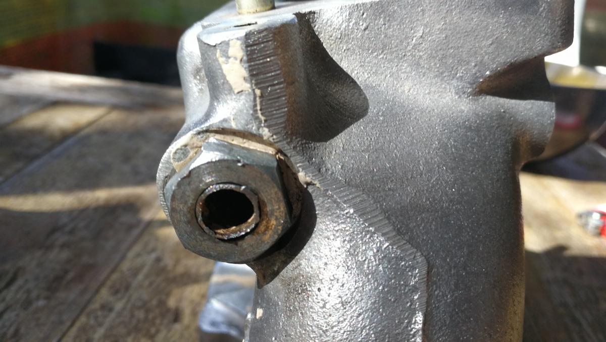

RAP260 Posted March 17, 2018 Posted March 17, 2018 (edited) Howdy all,Just in the process of removing the old water pipe that runs between the intake manifolds.Just need to confirm that the nuts, on the internal metal pipe, use the normal thread handing? . Struggling to get them off, just making sure I'm not trying to tighten them.. LolCheers,Rob Edited March 18, 2018 by RAP260 Quote
Retro Z Posted March 17, 2018 Posted March 17, 2018 Yeah they have a normal thread. Get a impact gun on it. RAP260 1 Quote
RAP260 Posted March 17, 2018 Author Posted March 17, 2018 Cheers mate. Yea, think that's going to be the only viable option. Quote
gilltech Posted March 17, 2018 Posted March 17, 2018 Standard RH thread. Very tight but also corrosion is a factor due to differing metals. Lots of WD-40 first. RAP260 1 Quote
AndBir Posted March 17, 2018 Posted March 17, 2018 .... Lots of WD-40 first. And if that fails, try some PB Blaster - seems to be the Bees Knees in the USA. https://www.ebay.com.au/itm/PB-Blaster-Tyre-Wheel-Nut-Loosener-Penetrant-Catalyst-11oz-311g-Spray-Can/152627004535?epid=889697634&hash=item2389474477:g:ZEMAAOSwLEtYfuH1 RAP260 1 Quote

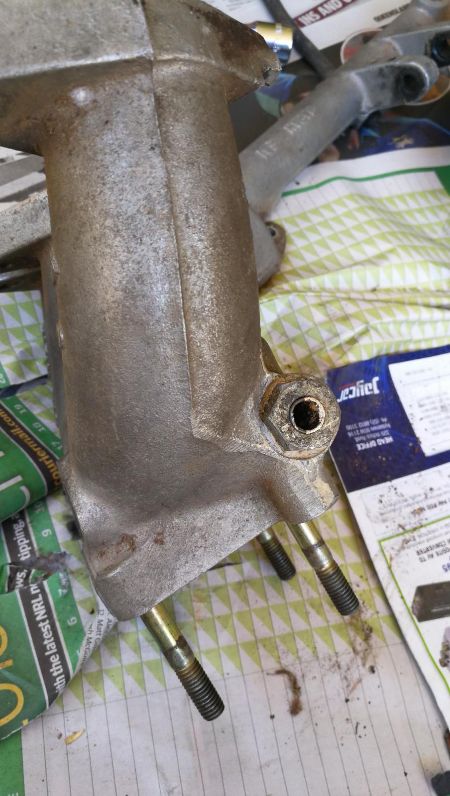

RAP260 Posted March 17, 2018 Author Posted March 17, 2018 Cheers folks. I'll give some WD40 a go. But as you can see from the attached photo, they've used some sort of adhesive. That stuff is tough. That's left after a thorough wire brush cleaning! May have to visit a local mechanic, as I don't have a rattle gun. PB blaster looks interesting though, lots of other future uses for something like that. Quote
