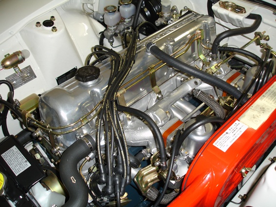

LLN260Z Posted February 22, 2018 Posted February 22, 2018 Hey guys, I have searched the net, forums and the workshop manual on what hose or outlet goes where. I bought a set of early 240z su carbs and gave them to Wilson Carburetors in airport west to rebuild them. Before that I test fitted it to make sure I can everything covered before I get the su back. Originally car had holley 4160 fitted so some hoses and connections are all over the place. I took a photo of my su fitted and circled the parts I am unsure of. I also don't have the stock airbox so I was thinking of running individual air filters. If someone can tell me or link me a set that would go straight on would be great. 1. 2. 3. 4. 5. 6. (I think this is for coolant line, and there is another outlet on the right side which I think is coolant return line) RAP260 1 Quote
gilltech Posted February 22, 2018 Posted February 22, 2018 1. is for the crankcase breather, long pipe projecting out of upper LH side of motor, basic emissions 2. and 3. these connect to the airbox, or indivdual air cleaner bases if you go that way 4. connects across to your brake booster for vacuum, god knows what you currently have? 5. blanking plug - original, not used, leave as is 6. from memory is part of water circulation, it used to connect to the side of the thermostat housing IIRC Go online and download some photos from all angles of stock original 240Z engine bays and the above will make sense. Hope that helps. gav240z and LLN260Z 2 Quote
LLN260Z Posted February 22, 2018 Author Posted February 22, 2018 Brake booster should be easy got that hose. Water circulation makes sense now too. 1. Just get a hose from crankcase to the bar. What about the vacuum lines that goto the carbon canister and distributor advance? Quote
Administrators gav240z Posted February 22, 2018 Administrators Posted February 22, 2018 3. is for fuel vapour (it's a breather for the fuel float chamber) that goes into the orange airbox (which you're missing). Distributor advance connects to the left hand carb body (just in front of where the SU mounts to the insulator part of the manifold). You also appear to be missing your fuel rail. The Carbon Canister won't be used with these SU's since there is no emissions set up on the 240z's (AU market). Like there is with 260z's. LLN260Z 1 Quote

gilltech Posted February 22, 2018 Posted February 22, 2018 I wonder where the hose that is coming out of the thermostat housing is going to ? Just plug the water circulation system at the thermostat housing end with an aftermarket blanking plug if you can't find an automotive one, and remove the Tee in the heater hose at the other end, you don't need all that. Individual aftermarket air cleaners will generally come with a fitting on the back to connect those small carby hoses to, you can just about see where they would be in Gav's first photo. Or maybe better to get hold of a proper 240Z air cleaner, put everything back to stock, unless you like the resto-mod look. LLN260Z 1 Quote

gilltech Posted February 22, 2018 Posted February 22, 2018 What a beautiful engine!!! Sure is. And you can see in there that he's retained the water circulation system. But I disconnected and later removed the water circulation system on my '74 260 more than 3 decades ago after one of the hoses failed right on Xmas holidays when I needed the car, deciding it was potentially unreliable with so many hose and pipe connections involved, any one of which could leak. And never looked back with either the flat tops or round tops I installed later. The KISS principle for me. Quote
