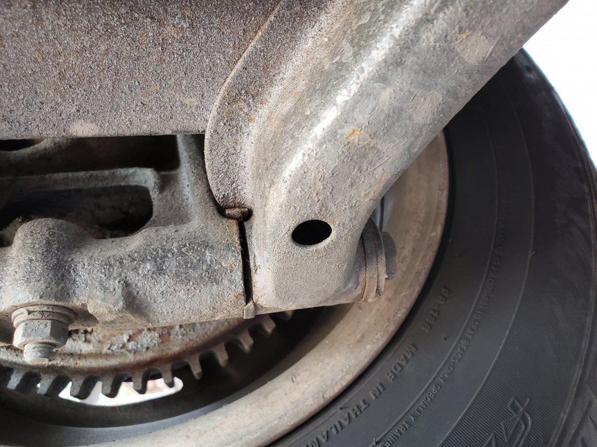

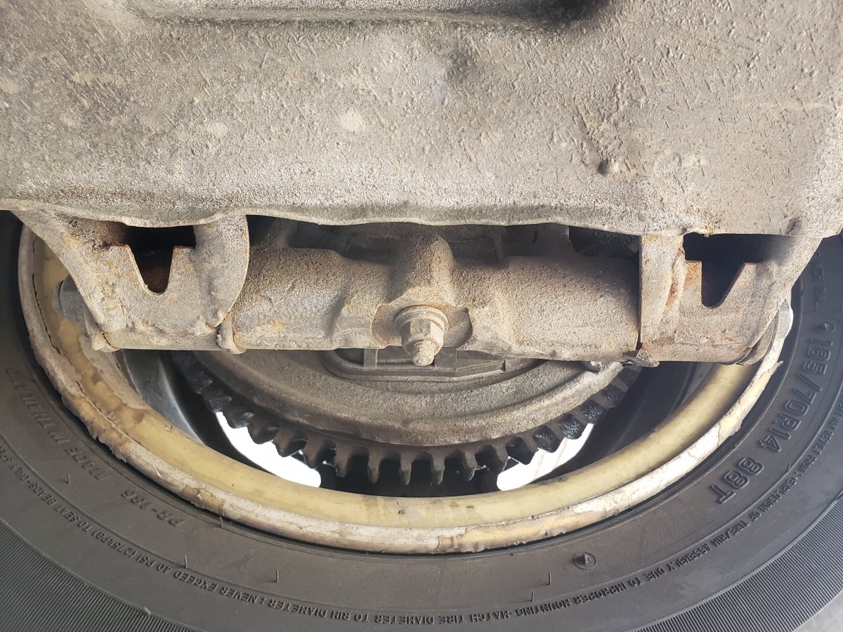

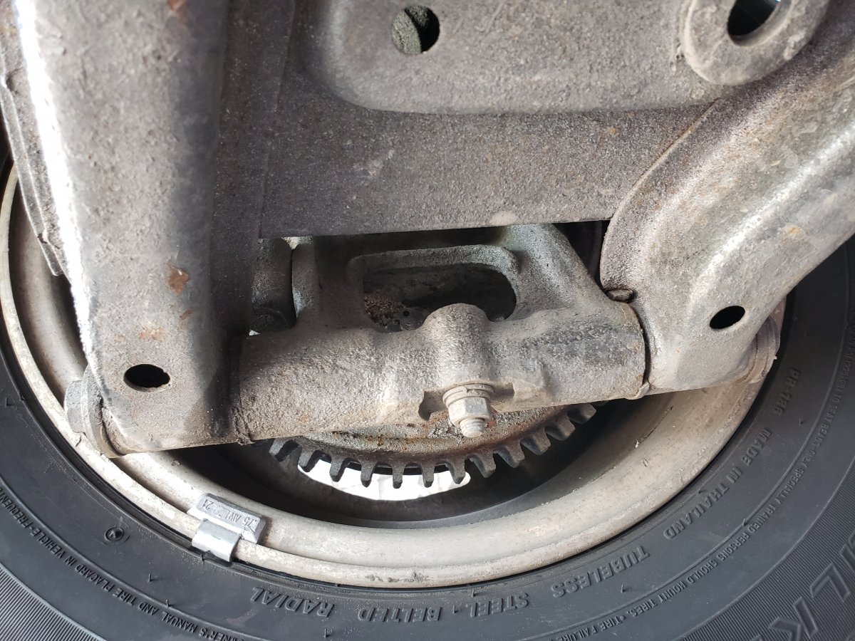

Last saturday i decided to lift my car on an elevator and was wondering i should change the bushings on the rear control arms as shown. If so, what kit is recommended and which supplier in the US?

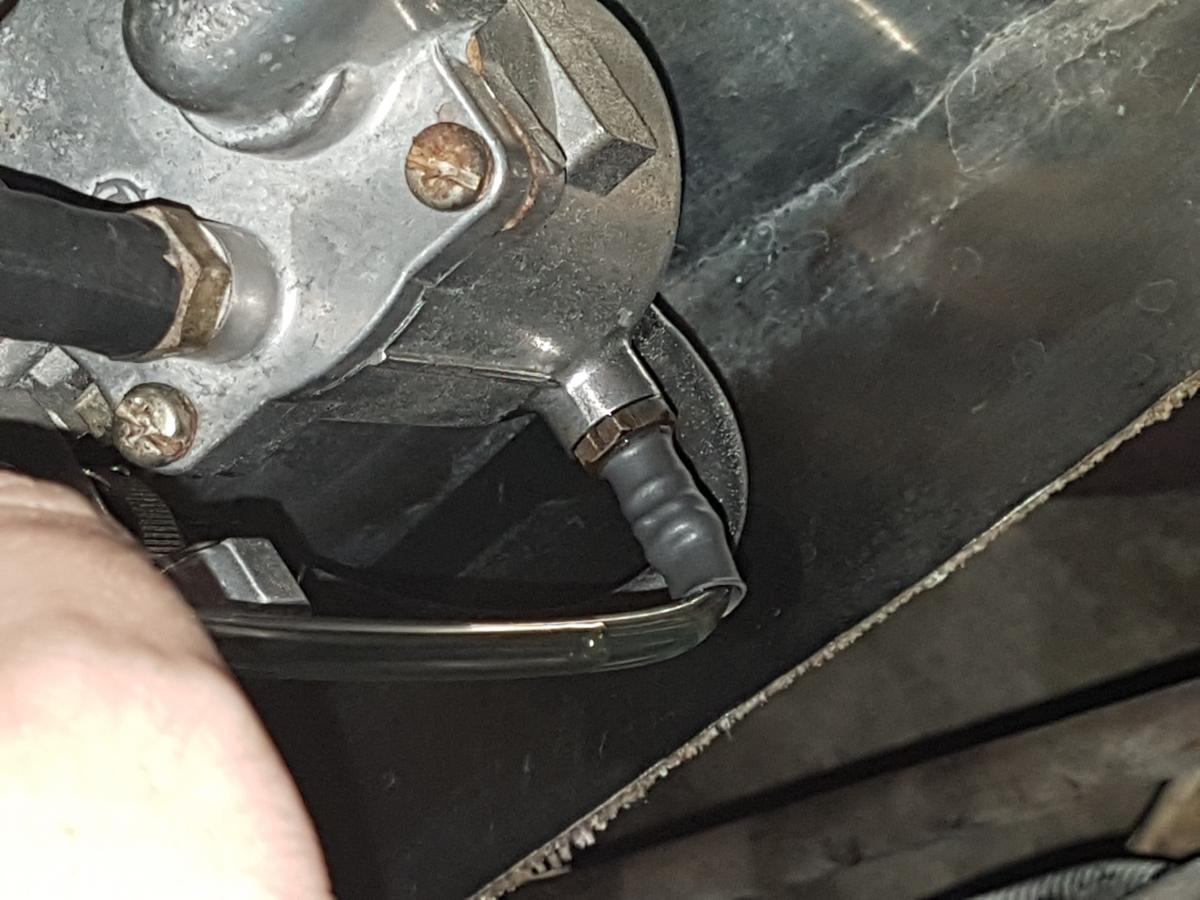

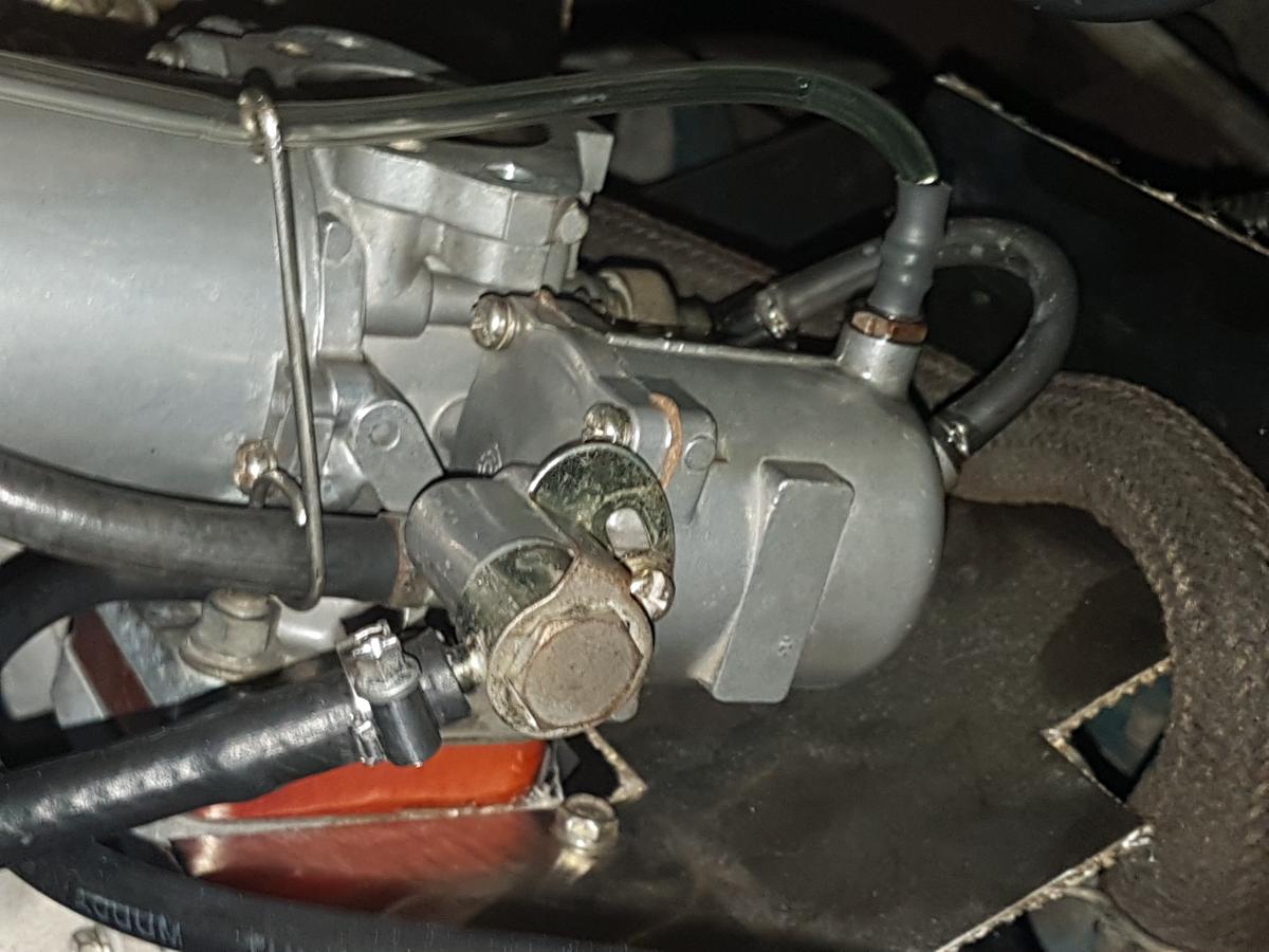

Well i tried using the sight glass method to set the gap between the float and float lid in the best possible way. I have posted pictures for your opinion on the levels. The first one is the rear carb and the last one is the front carb. -

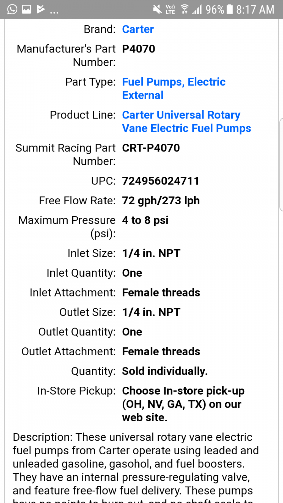

Recently purchased a couple of Airtex 8012SX which advertise as 5.5 to 9 psi. Once plumbed into the fuel lines when measuring the PSI before the carbs, the fuel pressure gauge reads 3.2 psi. I guess this company must be going through quality control issues: https://www.summitracing.com/int/parts/atx-e8012s/overview/ I was recommended a Carter 4070LP fuel pump: https://www.summitracing.com/int/parts/crt-p4070/overview/ Will this pump provide a steady 4 to 4.3 psi??? I just dont want to be wasting money and effort on cheap non feasible electric pumps. -

I really need a steady 4 psi electric fuel pump. Is this carter 4070 any good? I read its noisy but will it give me the required 4 psi? -
