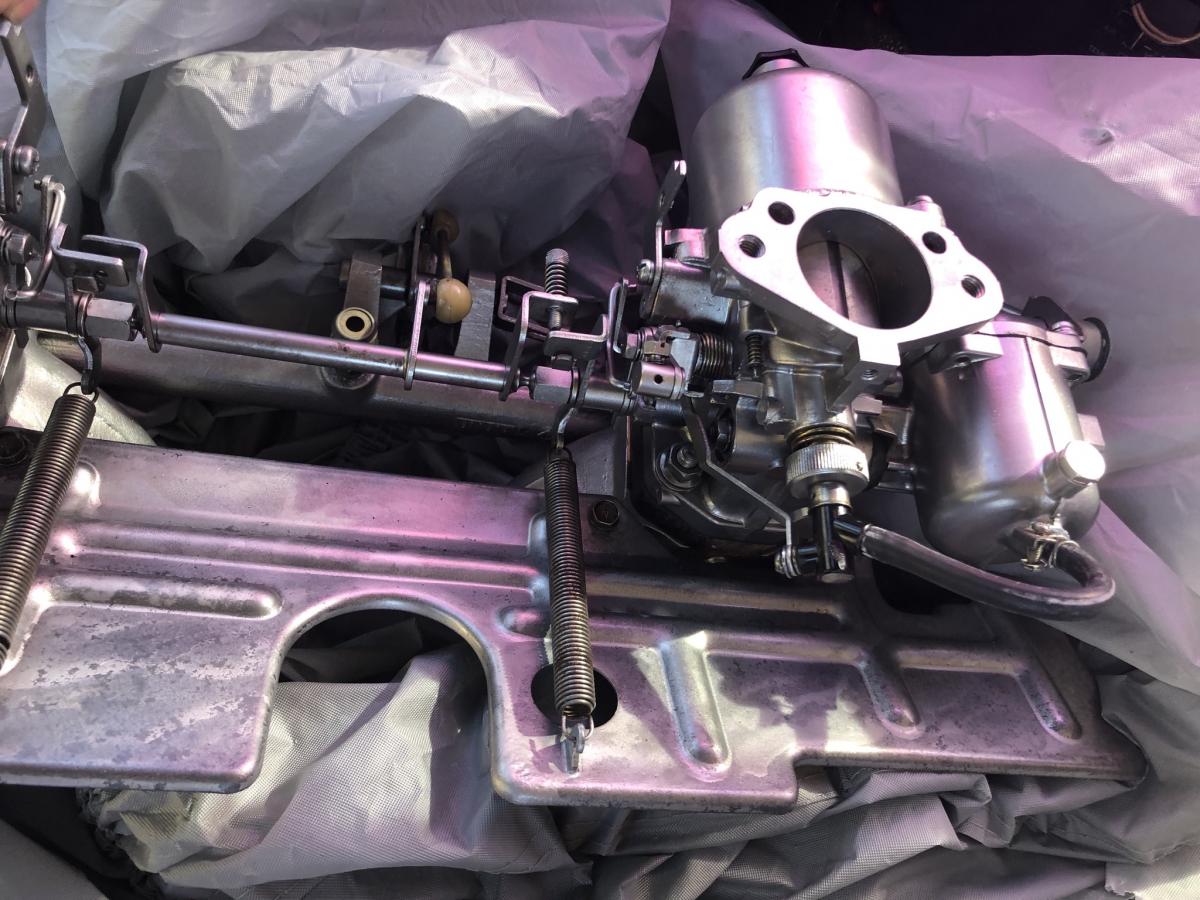

  22. Wow last post was in Feb. so I finally got my su carbs back from a rebuild. 7weeks later and $1250(rebuild and hydroblast cost) I am keen to fit them tonight and see how it goes. Here is a photo of before and after.
