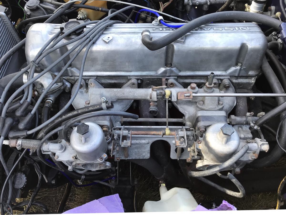

  6. Hey guys, I have searched the net, forums and the workshop manual on what hose or outlet goes where. I bought a set of early 240z su carbs and gave them to Wilson Carburetors in airport west to rebuild them. Before that I test fitted it to make sure I can everything covered before I get the su back. Originally car had holley 4160 fitted so some hoses and connections are all over the place. I took a photo of my su fitted and circled the parts I am unsure of. I also don't have the stock airbox so I was thinking of running individual air filters. If someone can tell me or link me a set that would go straight on would be great. 1. 2. 3. 4. 5. 6. (I think this is for coolant line, and there is another outlet on the right side which I think is coolant return line)

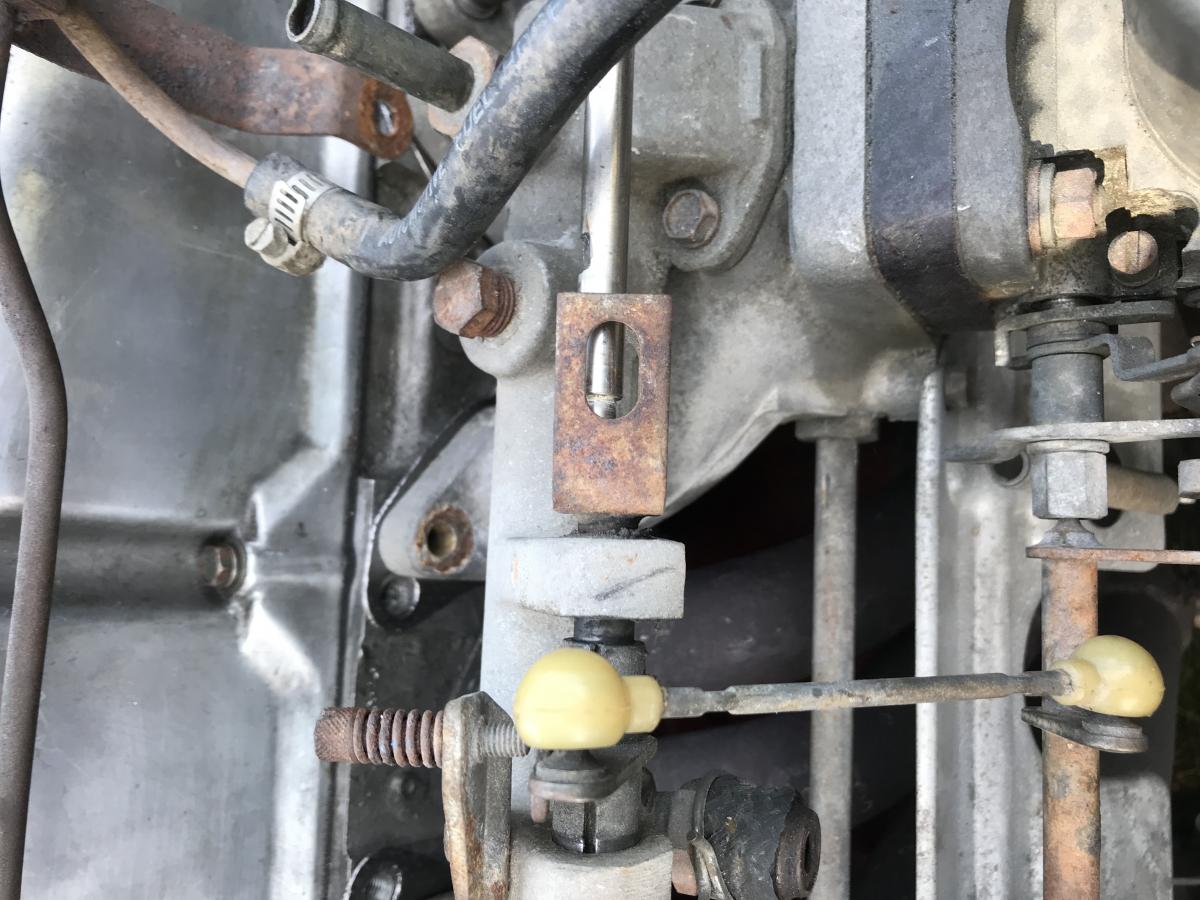

  11. So I have ordered a holley fuel reg and a guage. I have got the fuel lines for the carbs and also figured out the fuel supply and return lines. The metal lines are pretty rusty, what can I do to get them nice looking again? The existing linkage i have there goes right into the su carbs as shown in pic, what can I do to get the two working? When I get the fuel reg, should I set it to max 4psi?

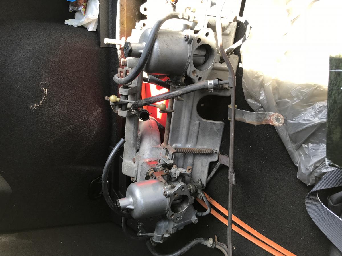

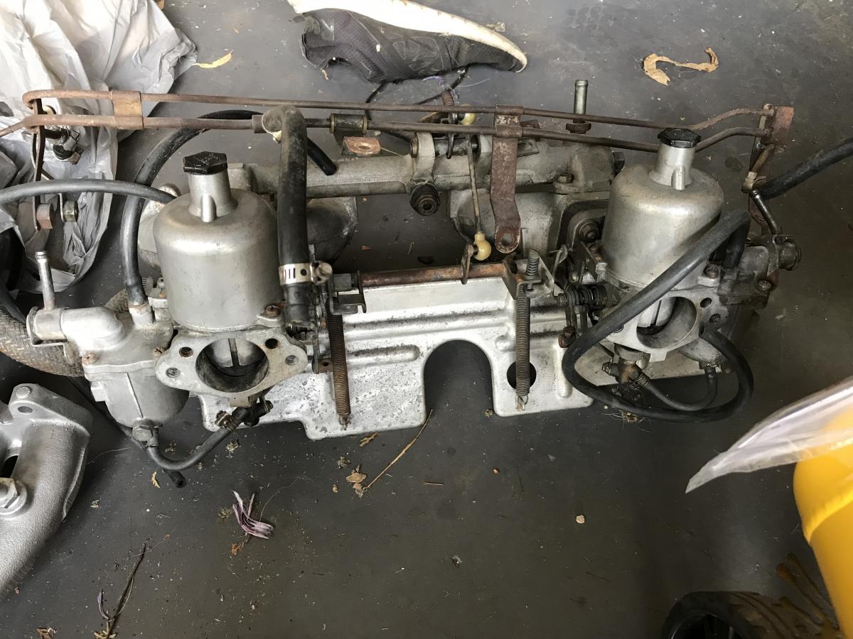

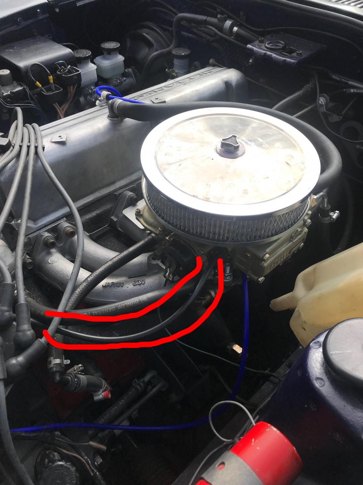

  13. This is the holley 4160 390cfm fitted. I believe the fuel pump currently in there is a 9psi pump. And the mechanical fuel pump has been removed right? These are the su carbs I bought.
