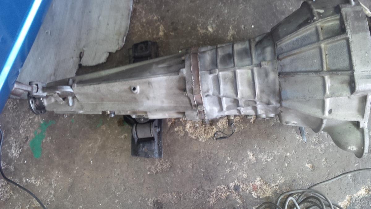

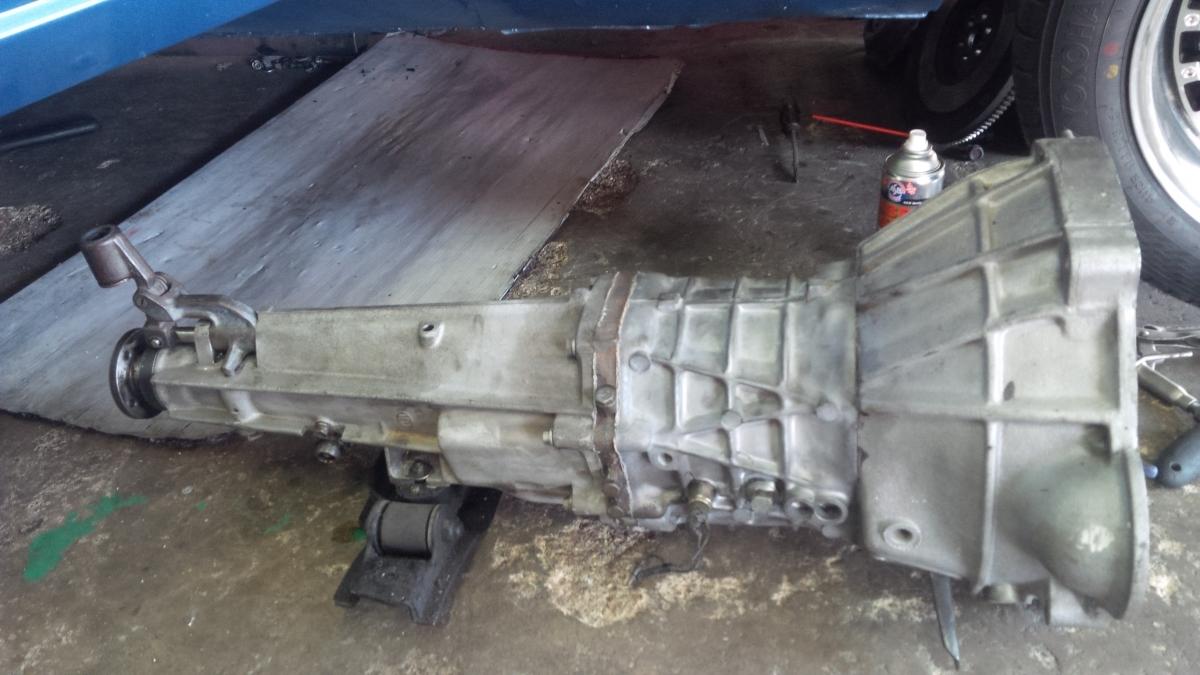

locklock Posted July 3, 2017 Posted July 3, 2017 Hi, can anyone help me to identify this gearbox please? Its taken out from my 240z. By looking at the box, would it be able to tell what is the ratio? The previous owner mention he did something to the gearbox during early 90s, but couldn't remember if it was changed or overhauled. Thanks! Quote
locklock Posted July 4, 2017 Author Posted July 4, 2017 Does a z432 also uses the same gearbox? gav240z 1 Quote
dat2kman Posted July 4, 2017 Posted July 4, 2017 First gear will be 2.9 Same gearset as fitted to Datsun Roadsters with U20 motor. There were two Option ratio sets, a 2.5 first, and a 1.8 first, aka, " Mid Close" and " Ultra Close" Really couldn't see the 432 being fitted with the Option boxes, standard. The bellhousings are interchangeable between the boxes, to suit L, U and S motors locklock 1 Quote
HS30-H Posted July 5, 2017 Posted July 5, 2017 Does a z432 also uses the same gearbox? Most 432s and 432Rs used the FS5C71-A transmission, but with a specific bellhousing to suit the S20 engine. A few 'Kouki'/late model 432s used FS5C71-B transmissions, again with a bellhousing/front case to suit the S20. The FS5C71-A was stock equipment on HS30-001503. gav240z and locklock 2 Quote
Administrators gav240z Posted July 5, 2017 Administrators Posted July 5, 2017 Yep HS30 10552 - my 72 240z was 1 of the last HS30's to receive the 71A box. It was literally a December 1971 built car. Quote
locklock Posted July 5, 2017 Author Posted July 5, 2017 Is there anywhere selling the internal gears? I belive the teeths of the gearbox is quite worn out. I seen mostly for 71b and 71c only. Quote
dat2kman Posted July 5, 2017 Posted July 5, 2017 I could have helped you out, but recently sold three 71A boxes in fully dissasembled state. Google search "Lou Mondello" he is a Datsun Roadster specialist, he will have stock of good used internal parts for 71A He is in the Moorabbin Victoria Australia area ( see you are in KL, he should ship overseas!) gav240z 1 Quote
Administrators gav240z Posted July 5, 2017 Administrators Posted July 5, 2017 Yeah speak with Lurch or Lou Mondello they have 71A parts etc.. Quote
