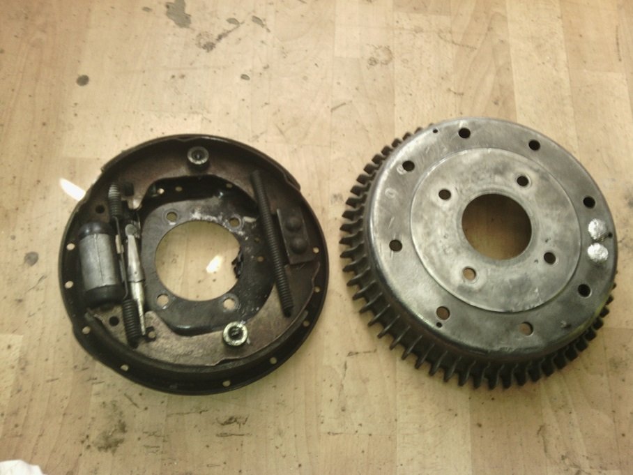

Agno Posted September 26, 2016 Posted September 26, 2016 Also out of general curiosity, Nick do you mind throwing up a photo of your drums and how they are drilled? There wouldn't be anything wrong with them I just want to see how others have drilled their drums so I can copy it! Quote

Scoota G Posted September 28, 2016 Posted September 28, 2016 As others mentioned get some pics of all the equipment you have. You may be using a combination of different Datsun parts causing the incompatibly. Pity you can't run discs on the rear as i have a new 300MM Rotor option for the 240Z 260Z < (Shameless Plug) Quote
Nickymac Posted September 28, 2016 Author Posted September 28, 2016 As others mentioned get some pics of all the equipment you have. You may be using a combination of different Datsun parts causing the incompatibly. Pity you can't run discs on the rear as i have a new 300MM Rotor option for the 240Z 260Z < (Shameless Plug) They are absolutely standard 240z drum assemblies, the only exception being some cooling holes drilled. You can't fit 260Z/280Z cylinders, linings or drums to this backing plate. I will take some pics though, it's a good idea, somebody may well see something. Cheers Nick Quote
