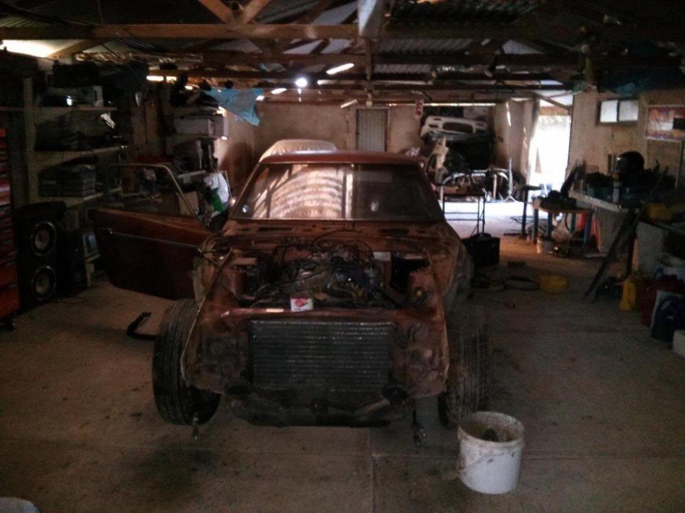

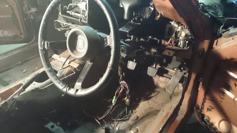

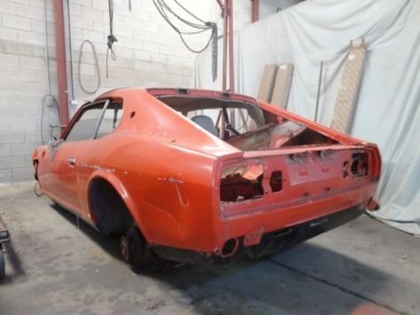

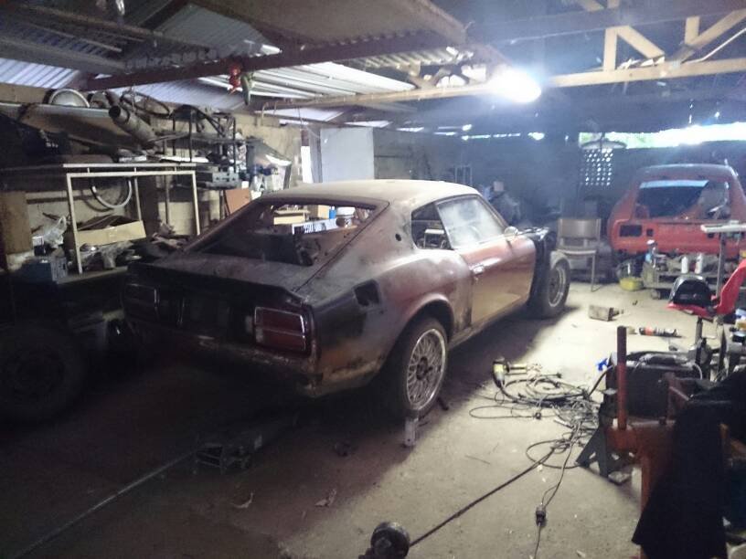

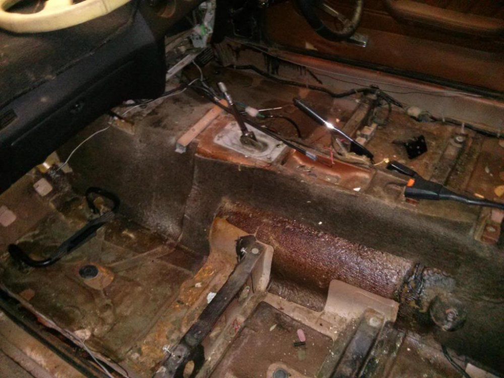

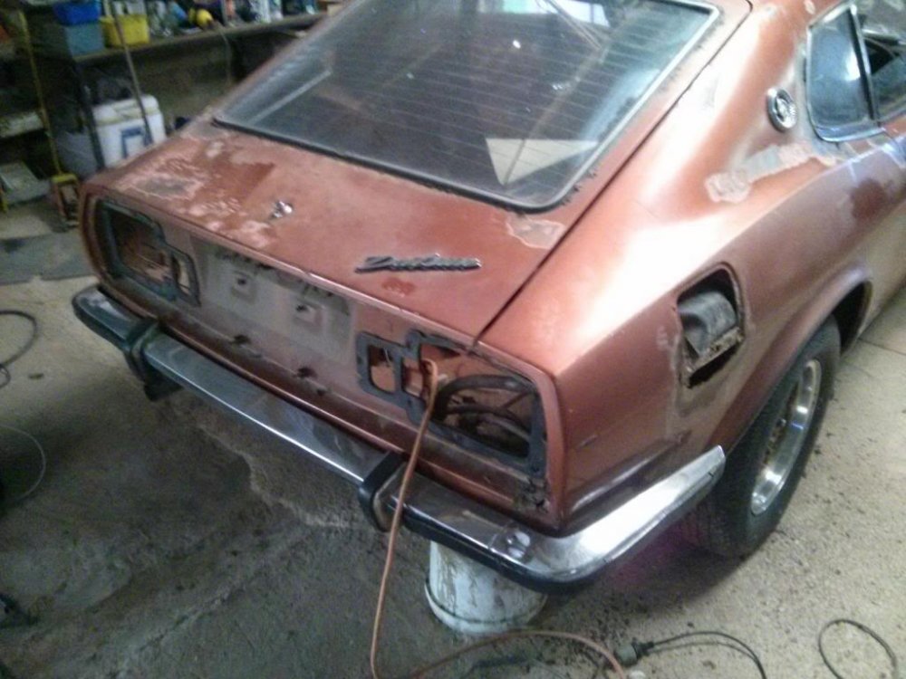

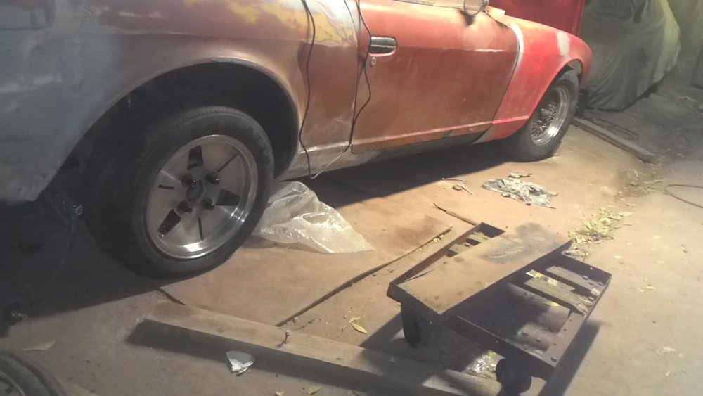

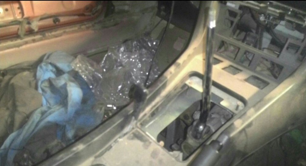

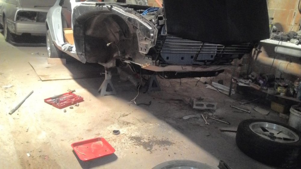

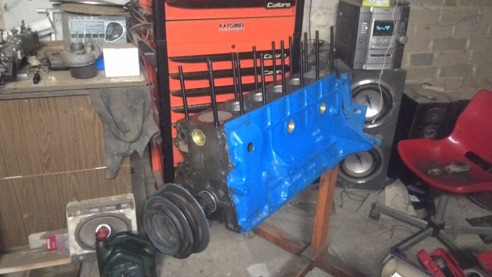

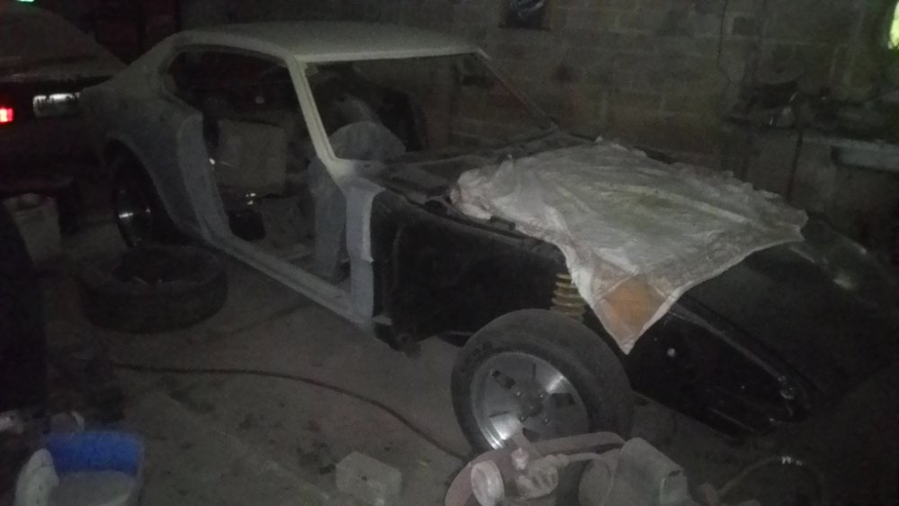

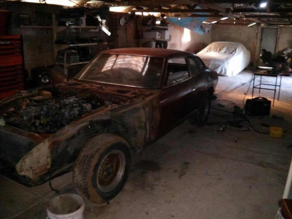

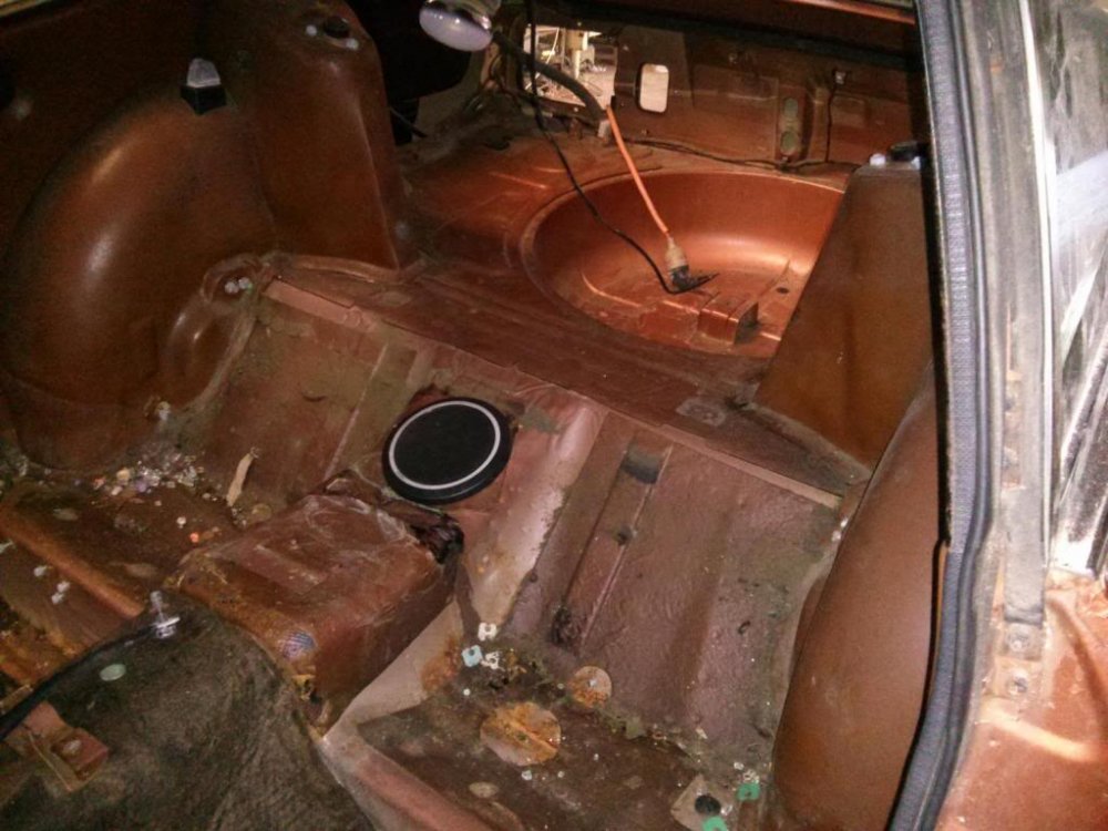

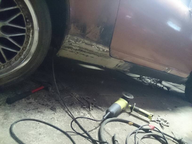

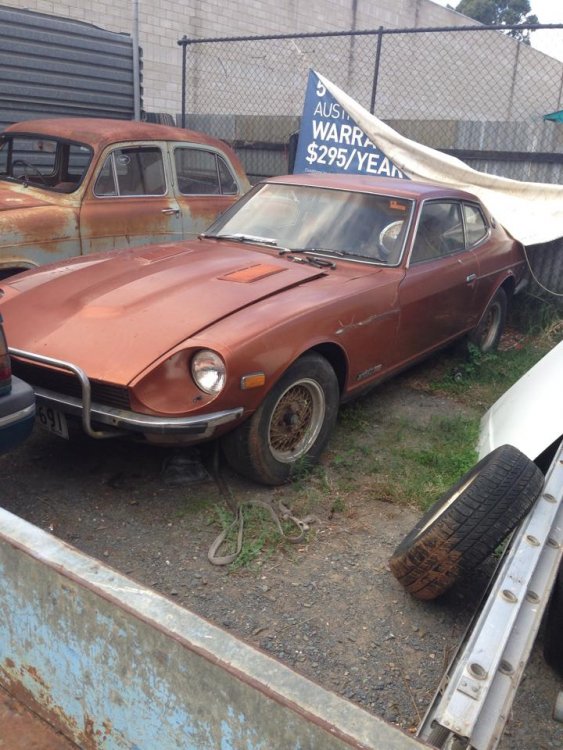

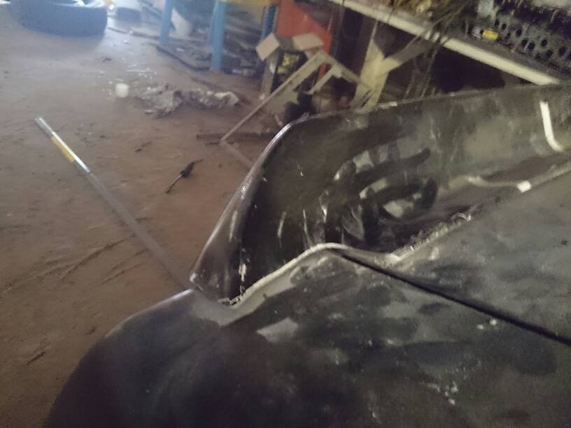

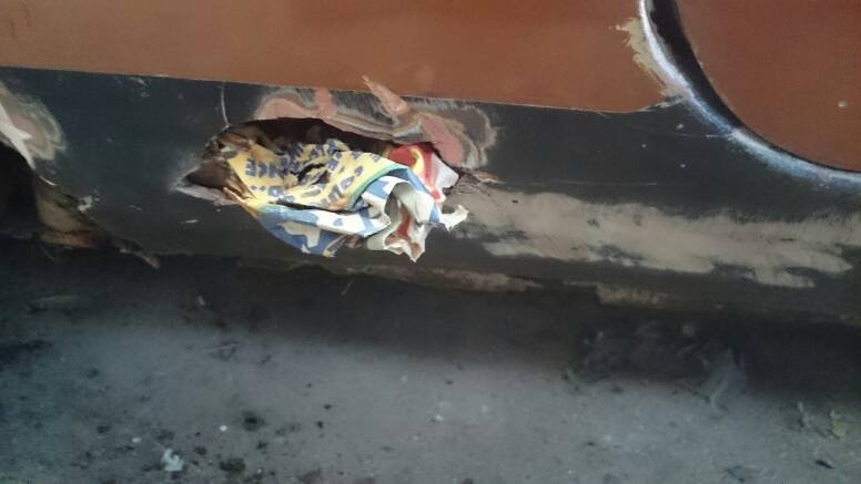

alex_260z Posted November 28, 2015 Posted November 28, 2015 Hi, Bought these two Z's in early 2014, this has been my progress since then. The guy wanted $3k for both cars which was a bit steep, but after some haggling managed to get him down to $2600 which I thought wasnt too bad for a car with walkin rego plates and a spare shell Got started on stripping out the interior of the car which was quite waterlogged. After a lot of broken bolts and blowtorch persuasion the front end came off. And then the rear lights and garnish Thought id try start the thing given the guy who sold it said it kind of ran. Managed to start it a few times and seemed to run fairly smooth, no strange noises or knocks. Few pics of the rust that was cut out of the thing. Some creative paper mache repairs from the previous owner :-) Bog fixes all problems... Seal panel had quite a bit of weight to it Found a couple surprises when tearing down the engine.Had been rebuild previouslly with new 40 thou overbored pistons and oversized bearings at some point in time. Had a look at the inside and it was pretty sludged up. One of the rod journals was scored and the bearing looked like it had spun. Tore down the engine and cleaned it out. Fitted some new welch plugs after cleaning out the coolant passages. Couldn't find the turquoise kind of colour it originally comes in so just gave it a spray in ford blue lol Sent the engine off to have the crank regrinded and bores honed. Ordered a bunch of new engine parts while I was at it. Got a set of flat top,new rings, clutch kit, electronic 280ZX distributor, new water pump. Full gasket kit and new Leads Chucked in a set of kings. As both cars were previously automatics I had two auto pedal boxes. Managed to take both auto pedal and trim them down, fitting them into the one pedal box. Spacing between them wasn't too bad but the footrest is pretty useless now. Finished the metal work on the front end in the past few weeks and sealed it with a gloss black enamel which later came off. Turns out it liked to react when coming in contact with pretty much anything. Some of my dodgy fabrication skills. Also fitted a rear spoiler of eBay that was sold as a 240Z/260Z item, as per usual with fibreglass parts it wasn't even close to fitting so have had to take a bit off. Im guessing it might have fit alright on a 2 seater. Engine came back from the machinist. The crank and rod journal were ground down to fit 040 oversized bearings as it had already been rebuilt to oversized bearings in the past. Cleaned the block up installed the main bearings and then dropped the crank in, only to find it didn't fit. Pulled it out and noticed the thrust bearings were too large for the crank. Looks like the engine machinist didn't account for the thrust also being oversized on the center main bearing. The weight of the crank damaged the thrust surface of the bearing. Used a piece of glass and slowly brought the side of the main bearing down to create clearance. This took a few days of going back and forth checking tolerances. My potato camera can't focus properly but you can kind of still see the ridge the crank made. Crank finally in with the correct end play checked. Scored some spare rods out of an l28 patrol from upullit for $13 a piece. To replace the damaged rod that had a spun bearing. Got to work on de-gunking and prepping the head All cleaned up and valves lapped. New stem seals installed Had a spare head with a c grind cam so chucked that cam and valve-train in for now Short block with 40thou oversize 240z flattops and ARP head studs Head on the block and setting the timing Chucked on a few bits and pieces painted for a mockup to see what it looked like Came to the conclusion that I wanted to do an efi setup and learn how it all works. So purchased a Megasquirt 2 DIY kit from DIYautotune and assembled it. Few days of soldering later. Seemed to talk to my PC fine after assembling and plugging it in, so here's hoping it actually runs the car. Managed to grab this intake manifold for a 6 pack. He even chucked in a turbo sump, rocker cover and fuel rail with injectors. How it sat And a shot of the reacted paint from my attempt at doing it in enamel Stripped majority of the engine bay paint back and sprayed it again with a duplicolor quick dry enamel this time, thankfully no more reacting. Ordered a chrome-moly flywheel from the US after finding out the last I bought wasnt for a L engine (almost a vg30e but seems like a smaller diameter surface?) Chucked the engine and gearbox together to drop into the car to do some of the wiring and start welding up the exhaust. Had a wrx 2.5" mid section in the shed with a resonator that will be making up part of the exhaust. Seems to clear the ground and tailshaft fine. Also made an attempt at a strut brace for the rear. Still needs a tidy up with the dremel. Cheap plasma cutter didnt cut very cleanly through thick steel Rebuilt the front calipers and master which seemed to be pretty ceased up with varnish. Bores looked good thankfully. (Excuse the potato photos) Gearbox came out and new chomemoly flywheel and clutch went in. Lost the original flywheel bolts so bought ARP ones. Looked like I had the wrong sized collar for the pressure plate. At full extension of the slave cylinder pin only just pushes the clutch fork enough for the throwout bearing to touch the pressure plate. Ended up making an adaptor plate to move the slave cylinder closer to the clutch fork. Also made a start on the megasquirt wiring and kick panel plate. Datsun 1200 shifter kinda fits the 260z. Ended up bending it into shape, at a later date. More parts arrived to go in. Bought an alloy rad with twin thermos as the old one turned out to be stuffed. Fins were coming off when I ran my finger against it. Also got the surge tank and fittings. As well as a rep hks pod to go with the intake setup Managed to grab this set of Advan ADA 360/460s for $220. Bit of oxidisation, but polishing up alright. Will definitely need some larger tires. The current 185/60/14s are a bit too small for the size of the car. Will probably end up going with the original sized tires for the car so that it fills the guards a bit better. Started putting together the fuel system for the engine. Drilled and installed a few fittings into some fuel rail extrusion. Made up a wiring loom for the injectors using some updated plugs from a later model pulsar, which you can kind of see the final product of in 3rd photo below. This will be replacing the ugly looking old rail. With this one that is a bit tidier. Started removing the old paint with crows feet and resealing it. Chucked some high-fill on the roof which showed up a few small dents that I have been filling. Anyway, managed to get the surge tank mounted under the car the correct way round using some custom made brackets. In the process I also made a plate for holding the other hardware like the tank filter, lift pump and high pressure pump. To make room I had to remove the existing fuel pump brackets. First up made some cardboard templates to get an idea of how it was going to work. This one bracket above mounted to the original fuel pump assembly bolt location. Next part was a plate to hold the tank and other hardware. I was happy with how they looked and transferred them to metal. Excuse my crap welding skills, probably should have removed more paint from the steel. Needed one more bracket to hold the opposite side steady. Repeated the process and eventually ended up with this. Started replacing all the front end bushings, wheel bearings and tie rod ends. Pulled everything off the front of the car. Not that you can make much from the photo but everything was covered in this mess. Everything rubber was disintegrated. Looks like they never replaced anything Started with stripping the grease and rust off everything and painting it black. Installed new ball joints Also fitted new LCA bushes, steering rack bushes and tie rod ends. Bought some HEL lines as the originals were beyond stuffed. gav240z, hmd and oldmates260z 3 Quote

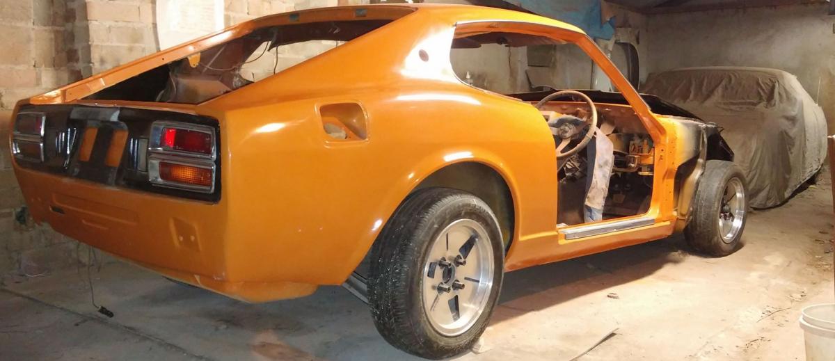

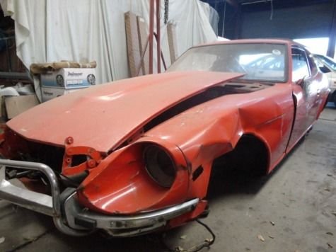

blu260z Posted November 29, 2015 Posted November 29, 2015 Hi alex really nice work there mate. When I was looking for my 260z I stumbled into these cars aswell. I had a look and decided it was to much work and hassel, but very glad someone snapped them up. What Did you end up doing with the orange car ? Also what spoiler are you running on the 2+2? Chris Quote
Moderators PB260Z Posted November 29, 2015 Moderators Posted November 29, 2015 Gidday, You have been busy. Reading through all that you have done I get the impression that you are doing absolutely everything yourself. What colour are thinking of for body work ?. Cheers PB Quote
alex_260z Posted November 29, 2015 Author Posted November 29, 2015 Hi alex really nice work there mate. When I was looking for my 260z I stumbled into these cars aswell. I had a look and decided it was to much work and hassel, but very glad someone snapped them up. What Did you end up doing with the orange car ? Also what spoiler are you running on the 2+2? Chris Hi Chris, Have kept the orange car undercover with plans of maybe building it up as a track car. I had originally thought about swapping everything onto the orange car as it looked like it might have been in better shape, but it will either need the front end straightened up or be converted to a tube front as the collision has brought one of the strut towers inward slightly. The spoiler I'm running is this one here from memory http://www.ebay.com.au/itm/DATSUN-240Z-260Z-REAR-BOBTAIL-SPOILER-/231315801779?hash=item35db7f06b3:g:ZwIAAOxyUgtTKqKr It needed quite a lot of trimming on the ends to avoid it hitting the shoulder of the car when closing the boot, but that's to be expected of cheap fibreglass parts I guess. Gidday, You have been busy. Reading through all that you have done I get the impression that you are doing absolutely everything yourself. What colour are thinking of for body work ?. Cheers PB Hi PB, That has been my goal for the car to try and do everything possible myself. Wanted to do something a bit more challenging then the previous Nissans I had rebuilt this time round. The colour i'm thinking of painting it is the 918 240Z orange. Regards, Alex Quote
blu260z Posted November 29, 2015 Posted November 29, 2015 When I looked at the two cars I was going to strip the orange car for its parts and sell or scrap it. But I had nowhere to store 2 cars and the girlfriend would have cracked it . Thanks for the info on the spoiler alex I will definitely keep it in mind. Its good when you can say (I) built the car from a rusty old wreck Quote

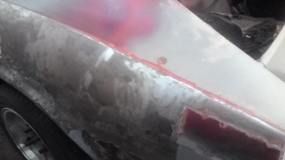

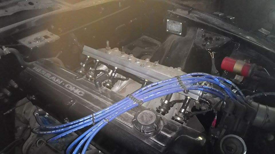

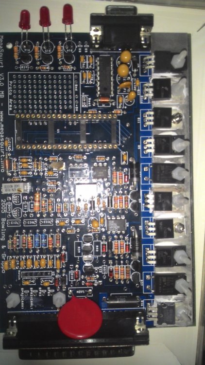

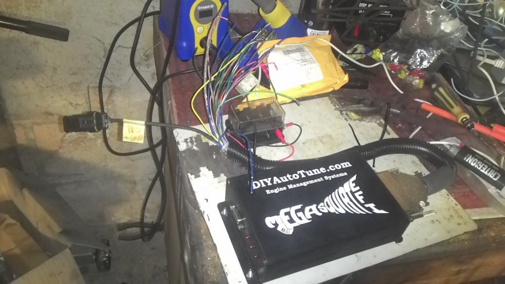

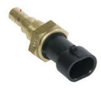

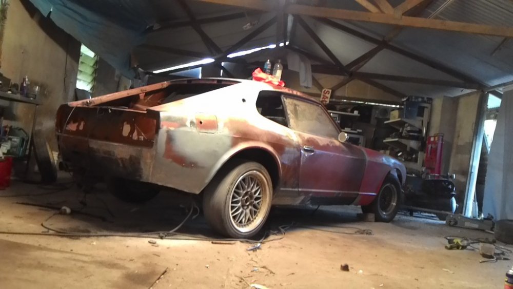

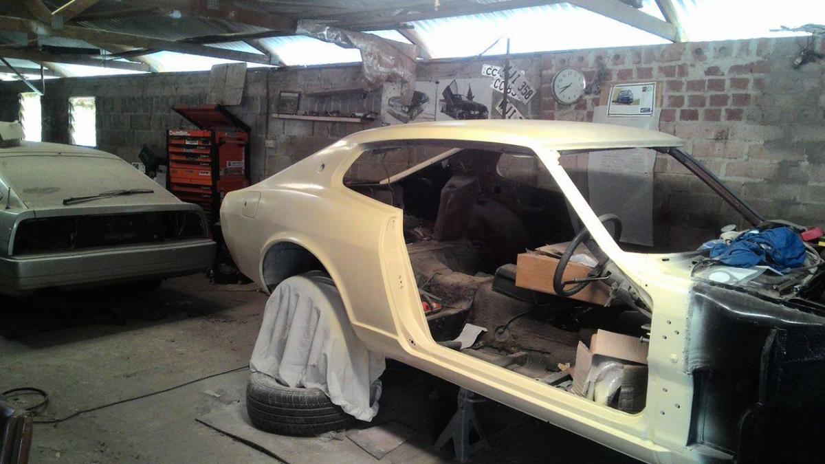

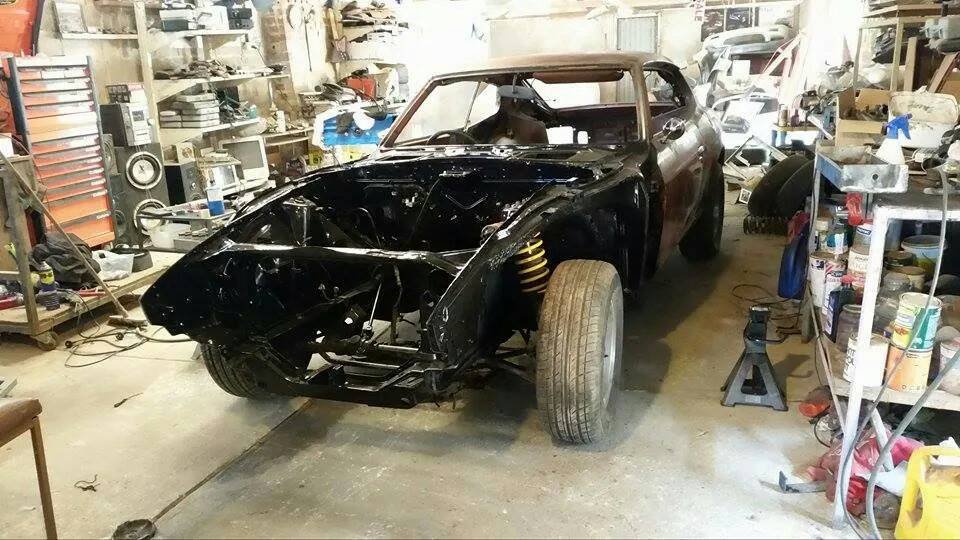

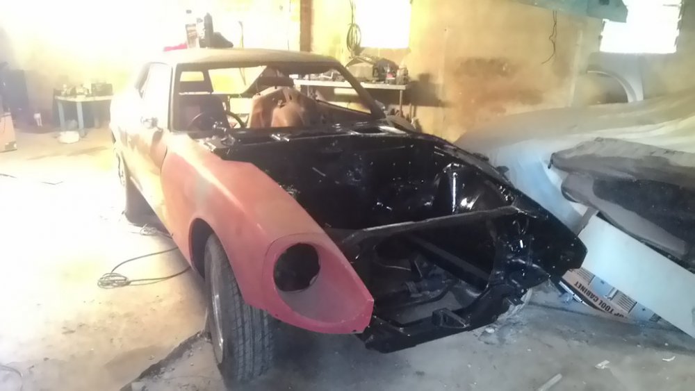

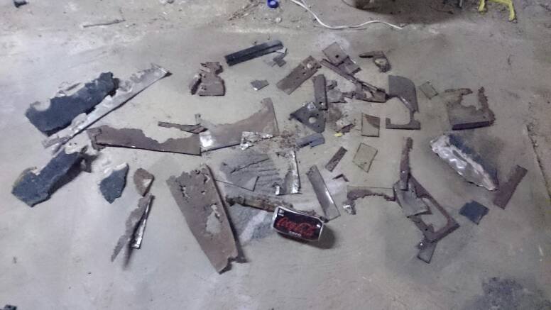

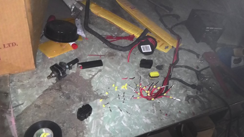

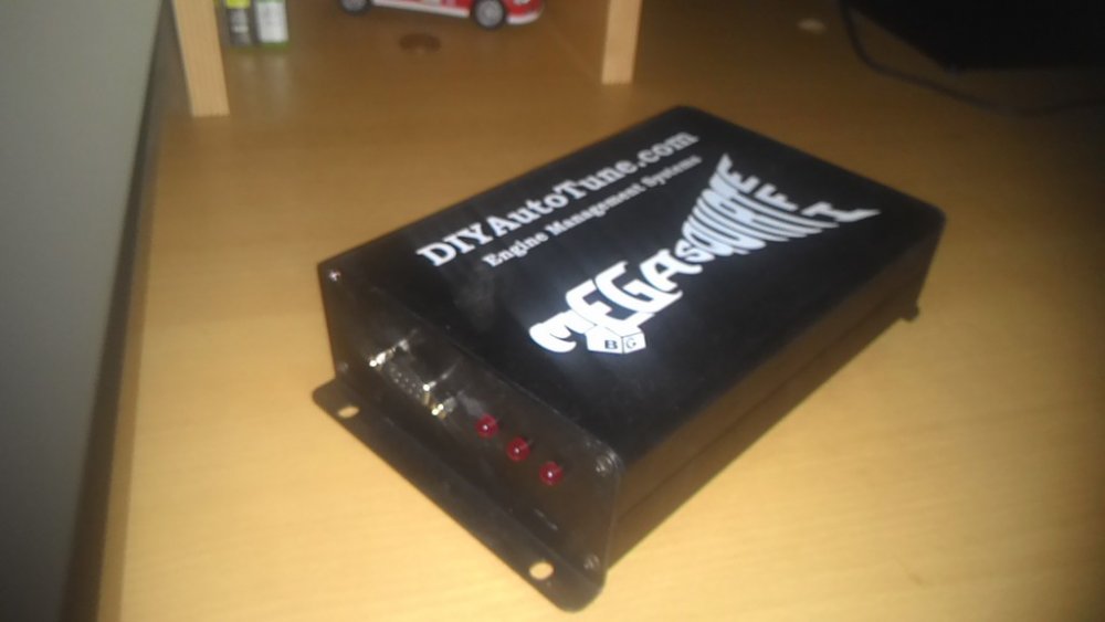

alex_260z Posted February 3, 2016 Author Posted February 3, 2016 An update of the past month or so. Car is now in high fill, with all the rust having been cut out and repaired. Made a start on sanding out scratches and making everything flat. Made up some replacements for the front guard mudflaps, using a sheet of rubber from Bunnings. Have also been working with the Megasquirt to get the car running. Majority of the wiring has been done minus the crank trigger. For the coolant temp and air temp sensors I used VT commodore coolant sensors. For the TPS I used one that was from a later model pulsar from memory (PN: A71-601 T00), after realising that the TPS that came with a 280ZX and a Y30 one I had lying around were both switches rather than potentiometers. To make this fit the 280ZX throttle body I made some short sections of metal with a hole on either end to adapt the two together. Switch Style - Doesnt work with MS Potentiometer Style - Works with MS My plan is to control fuel-only first using the Megasquirt. Ignition will be controlled by a 280ZX electronic dizzy. Once that is working and I familiarize myself with tuning it, the plan is to control ignition as well. I attempted to get the signal for firing the injectors of the negative side of the coil but this didnt work. Im guessing I wired the jumpers inside the ECU incorrectly. So instead I've got with a Trigger wheel from EFI hardware and crank angle sensor from an EF falcon. The wideband controller I purchased was an APSX wideband DIY board with a Bosch LSU4.2, but it is proving troublesome to calibrate as it uses a magnet rather than a push button for some reason. Thinking of replacing it with a TechEdge DIY controller. Once I have a working EFI setup and have a better idea of what I'm doing I might put together a write-up for a budget Megasquirt setup. Quote

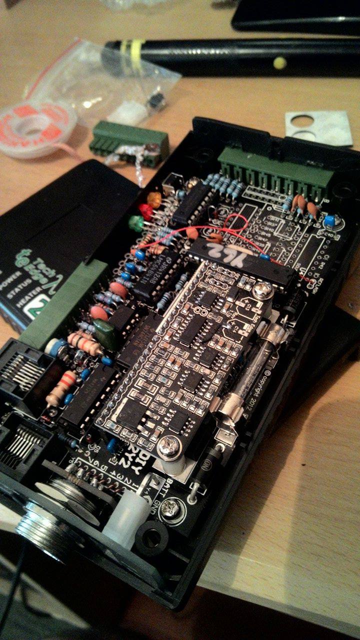

alex_260z Posted March 26, 2016 Author Posted March 26, 2016 Gave up on the APSX wideband and purchased the TechEdge 2Y2 wideband controller. Took 6 or so hours to assemble the PCB + another 2hrs to assemble the cable, but quality looks a million times better than the APSX, yet try it though. Fitted the 36-1 trigger wheel to where the external pulley would usually go on the r30 harmonic balancer. The Ford Crank angle sensor is mounted using a custom bracket made out of box section and angle iron. This bolts to where aircon would usually go I'm pretty sure. Have since painted the body and installed the windscreen using some rope. Still have to do the doors, guards, and all the small bits like the inspection flaps, headlight cones etc. Painted the spare boot I had black for now while I fix the rust in my other which will be orange with a black wing. While trying to get the car to start the original starter started shooting sparks then eventually died. Swapped it over for an R31 starter. Found this one at the wreckers and was slightly larger than the other r31 starters. Part number mentioned GTS1, GTS2 so might be larger for the higher compression on them. Straight bolt-up as I found mentioned on another post here, with no issues. Quote

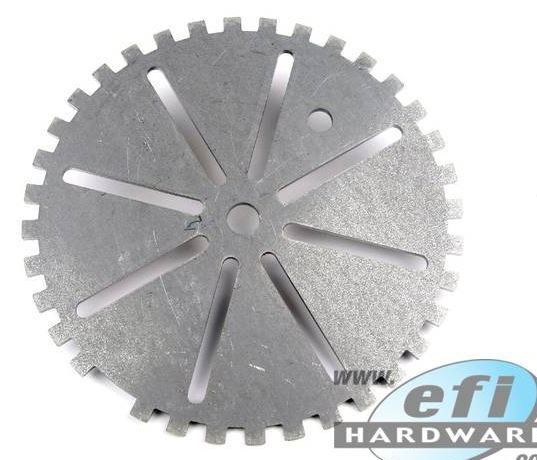

alex_260z Posted September 28, 2016 Author Posted September 28, 2016 (edited) Made some minor progress over the past few months as have been busy with fixing my Brumby. Had trouble with mounting the trigger wheel in a way that it wouldn't jump out of balance. Solved this by using an l24e crank pulley as it has a very larger back face. I chucked the trigger wheel in my desktop scanner and scaled the image to the same diameter of the pulley face. Then printed this out and cut the shape of the wheel out to leave the teeth. This template was then glued lightly to the back face of the pulley and painted over with a rattle can. This left the pattern of which I needed to cut out. Using both a grinder and dremel each tooth was cut out leaving me with a single piece pulley and trigger wheel. Also scored what appear to be c10 skyline mirrors from a swap meet for $20. At least looks closer to original than the eBay set. Other than that, have just been preparing the front panels for paint Edited September 28, 2016 by alex_260z Quote

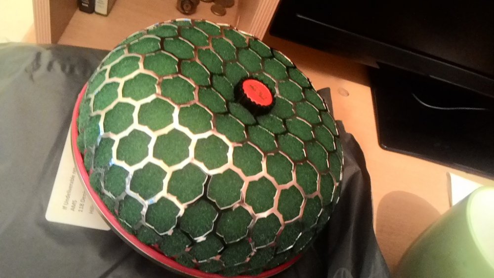

alex_260z Posted October 13, 2016 Author Posted October 13, 2016 Great work Alex & congrats on your ingenuity mate ,very clever. Can't wait to see your handy work when I come over . Regards : Alan. Thanks Alan Managed to find this 280z airbox from the US via eBay which will be used in place of the pod filter to keep things tidier. Postage was a little pricey but a few can be found around the $150 mark Inc postage. Painting more front end panels gav240z 1 Quote

alex_260z Posted October 19, 2016 Author Posted October 19, 2016 Also managed to fit the 280z air box to the engine bay. Some minor trimming of the rad support was required to sit it in the same place. The two required holes required to mount the box are pre-drilled but covered by an alternative panel. It was simply a case of drilling the hole put completely. Then a nutsert was used in each of the holes. Photos of it fitted Quote

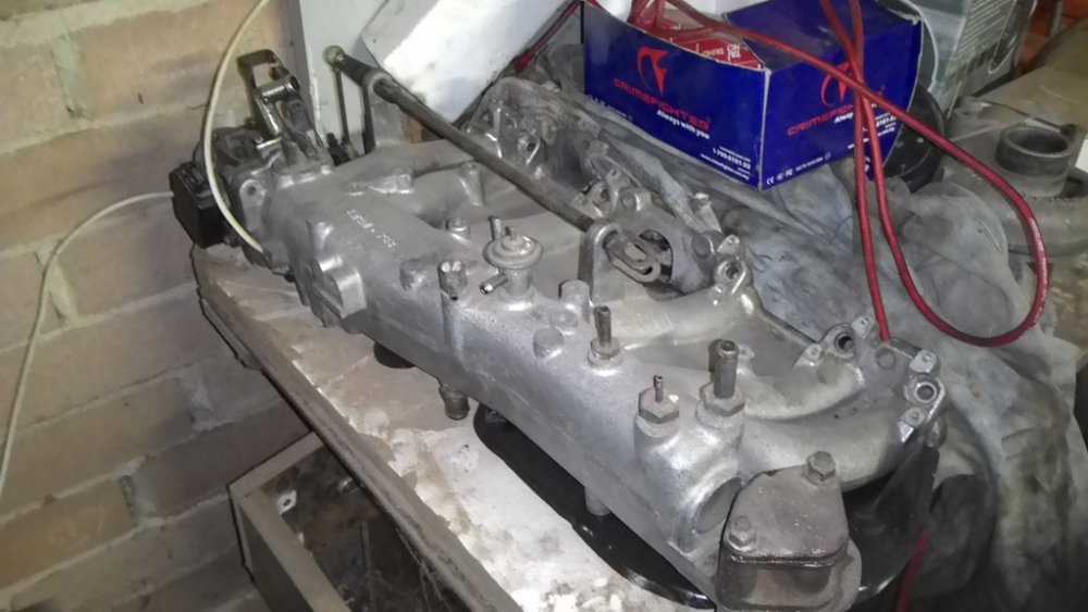

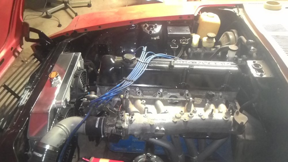

alex_260z Posted September 5, 2017 Author Posted September 5, 2017 (edited) After a spending countless hours tuning and tweaking the EFI setup the ECU decided to die on me as far as I can tell(stuck in a reboot loop). Decided to take the easier path and go with a triple carb setup. I purchased a Kameari manifold and linkage kit from rhdjapan and solex addhe's off an alfa via eBay. For the fuel setup I have ordered the Nismo high flow pump 17010-A7601 which mounts up to the original cradle. Installing the manifold I did have some issues with it interfering with my thermostat housing which required a bit of trimming to resolve the clearance issues. Purchased a set of velocity stacks of AliExpress for $70 which turned out to be of awful quality in terms of plating. I managed to obtain a partial refund so it doesn't really bother me as it will all be sitting within an airbox. I also purchased ball style throttle levers to match the manifold's linkages. These ended up being for the wrong side of the carburettor so the components will need to be drilled out and welded to the opposite side of the plates. The airbox will likely mock the s20 style with the filter being remote in the 280z usdm airbox. A box will be fabricated that encloses the velocity stacks runs air through the filter at the front of the car Edited September 5, 2017 by alex_260z RLY240 1 Quote

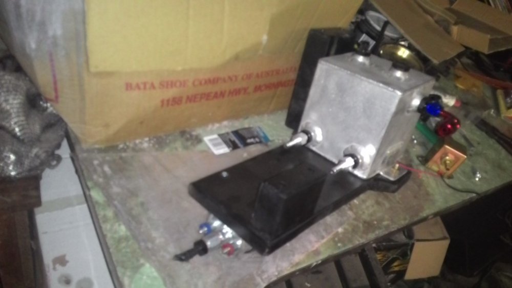

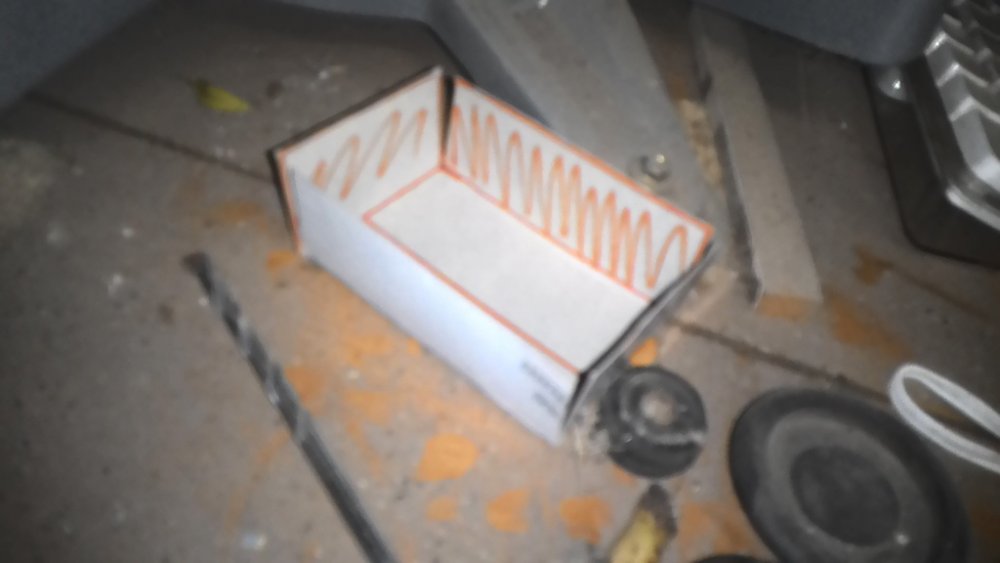

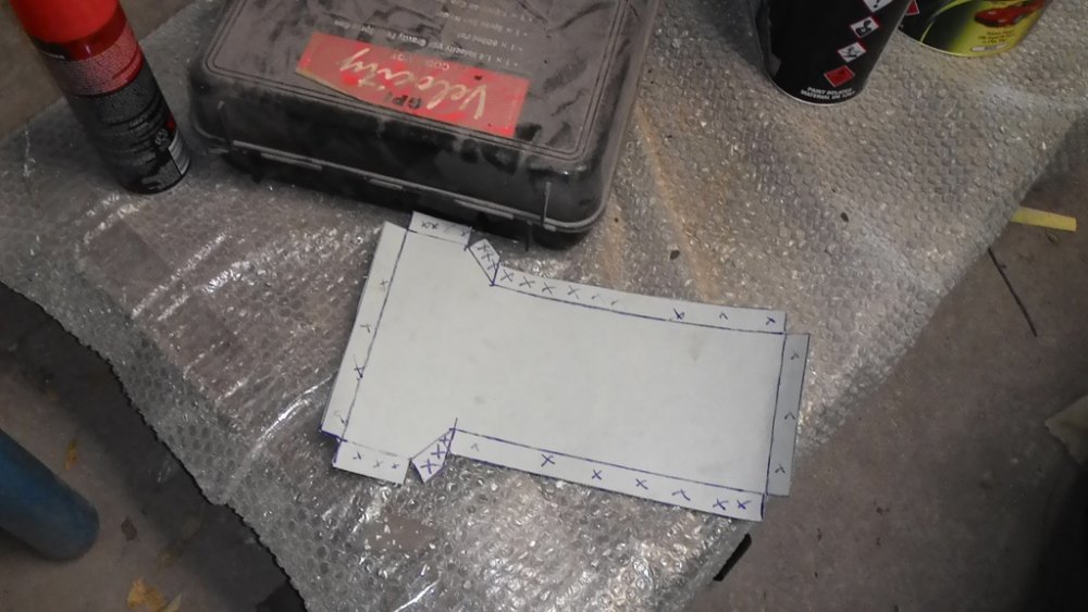

alex_260z Posted September 24, 2017 Author Posted September 24, 2017 A few pics of the box setup. Made up using a sheet of cold roll steel ($20) + engine enamel ($10) +cost of mig wire/gas gav240z 1 Quote
Cozza Posted September 24, 2017 Posted September 24, 2017 Nice work. I like it. I notice screw fixings along the top edge but what did you use along the hard to get to bottom edge? Also, have you plumbed the crankcase breather into the box? 10 points!! Quote

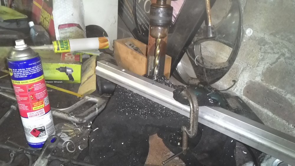

alex_260z Posted September 26, 2017 Author Posted September 26, 2017 Nice work. I like it. I notice screw fixings along the top edge but what did you use along the hard to get to bottom edge? Also, have you plumbed the crankcase breather into the box? 10 points!! Used speed nuts across top, sides and bottom and then a screws through them. Bit tricky to do up the bottom side. I would probably recommend using some sort of clip arrangement instead though to make it easier to remove. Bent up a piece of pipe the same diameter as the breather and welded to the top of the box to plumb the crankcase and keep it as legal as possible. Quote
