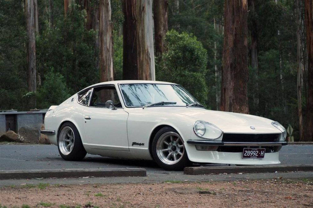

adam Posted October 29, 2015 Posted October 29, 2015 It'll all depend on your tyre selection. I've been running 15x8 0 and 15x8.5 -6 with 185/55 from memory and I can tell you now you'll need a roll out back. Hasn't given me any grief with hard hills driving. You should be able to get away with a 195/xx but any wider and you may need to begin flaring. gav240z 1 Quote
74zzz Posted October 29, 2015 Posted October 29, 2015 adam that a sexy looking zed.........don't think ive ever seen photos of your car...... Quote
theremm Posted October 29, 2015 Posted October 29, 2015 adam that a sexy looking zed.........don't think ive ever seen photos of your car...... check out his blog... google two forty zee blog Quote
Rtiny Posted October 29, 2015 Author Posted October 29, 2015 I spent 2hours today reading through your blog. So much progress and so sexxy. Is inspiration Quote
adam Posted October 31, 2015 Posted October 31, 2015 Thank you gents Definitely not up to the quality and standard of some of the builds on here but it'll do me for now.. Quote
ryn004 Posted November 24, 2015 Posted November 24, 2015 Following up on this thread, does anyone know if the 2+2 have wider stock arches at the rear? Quote
Administrators gav240z Posted November 24, 2015 Administrators Posted November 24, 2015 Adam where was the photo taken? Looks familiar. Quote
