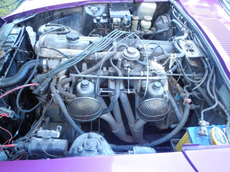

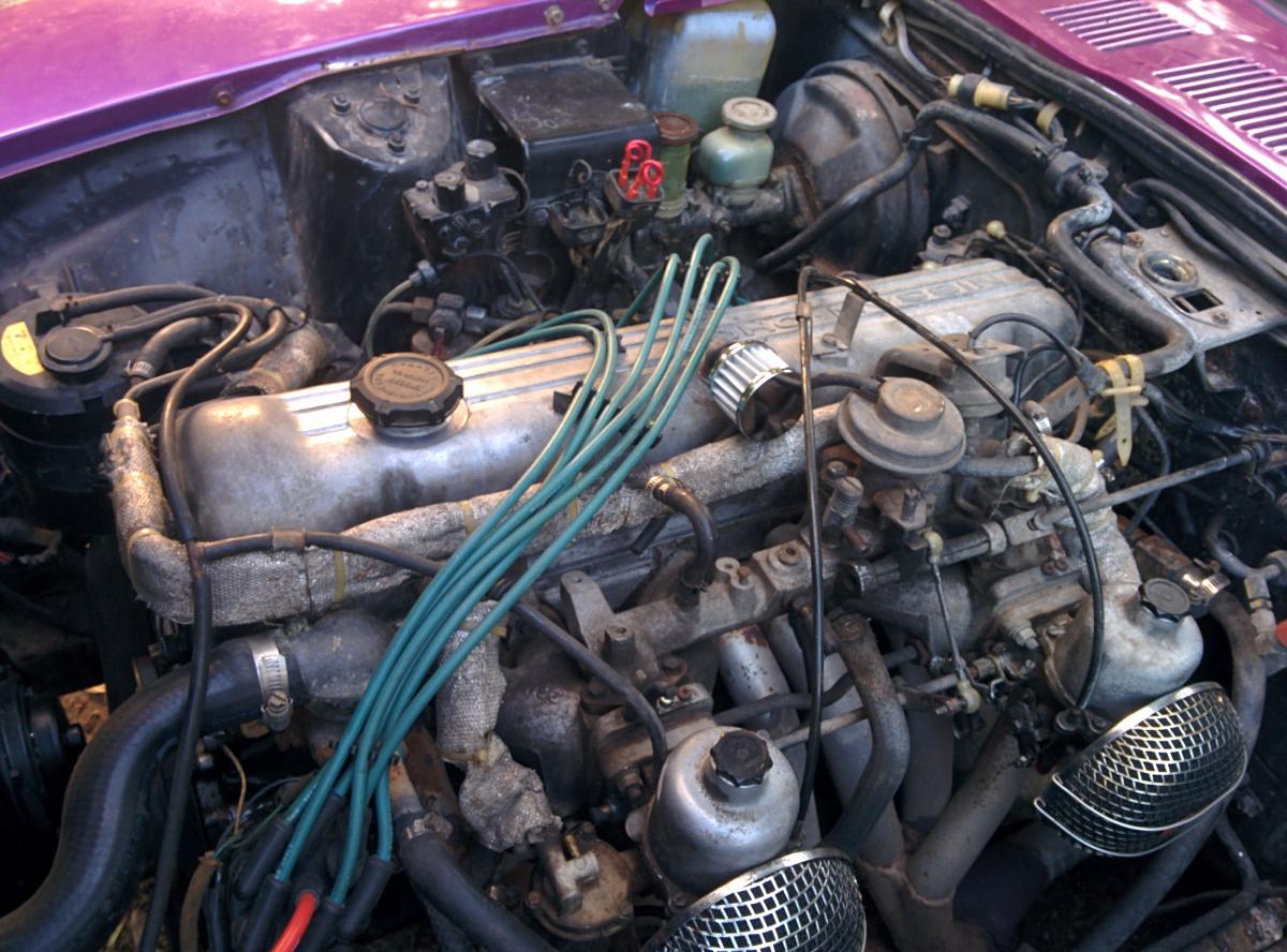

After a new battery later it is running… very rough, it's a spluttering mess really. It shouldn’t be a surprise but there was always hope that it would clear itself out, like a bad curry.
I was going to change spark plugs and other regular maintenance bits and run a compression test. Considering the car isn't warming up, I've decided to follow advice and drain the tank first. Hopefully apply the kbs kit. In between that I'll be doing more cleaning in the engine bay to help determine the other issues (once the tank is back in). I will need to get an air pump belt and work out where to get the other parts - mainly hoses and eventually door seals.

I would be having a look at the carbies, after sitting still for so many years they could be gummed up.

Not to mention the carbs look undersized for the L26, would be worth finding a good set of hitachi SUs if you can find /afford them etc..?

Carbs - potentially i was going to see after some clean fuel and some new filters. I also need to find the exhaust leak. It's hard to work out the order to do things in. I would like to have a go at cleaning them up but i would need to spend dedicated time on them and that is a challenge. Posts in the carb sections mention the carb service center in Burwood, which isn't too far so that might a very possible option.
As for the manual conversion - I'd love to do it, but I don't really know what condition the rest of the car is in and what else it will need. I'll play it safe for now.
Geez I hadn't thought of changing them. I'd hope the very least they would need was a service. Not really looking for great performance - that might change.

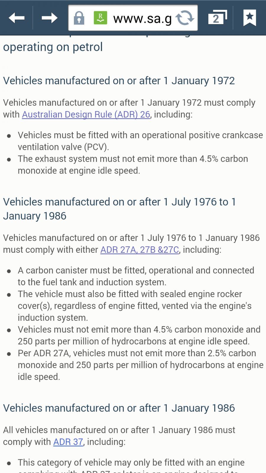

Posted (edited)
From what I've read in other post the original running gear as in the emission control systems need to present for NSW rego. I wouldn't want to have issues down the track.
I have attached a pic of the emission rules here is SA. I have switch my 76 carbs to a 350cfm holley, So from what I can see is aslong as I follow this its fine. I intend on running a catch can but having it venting back into the PCV, and also running a catalytic converter to keep the exhaust emissions down. But they will probably find some way to not aprove me :(

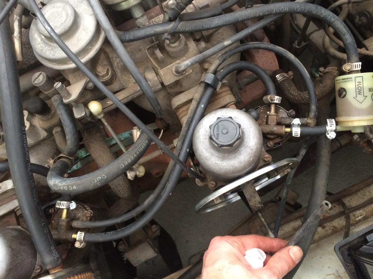

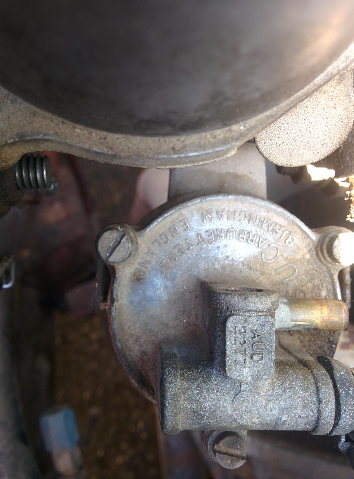

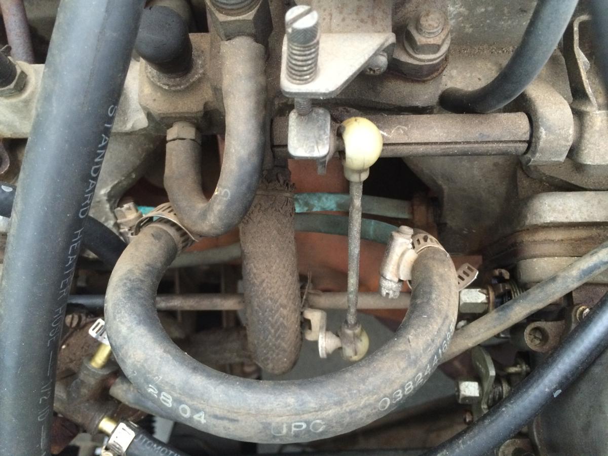

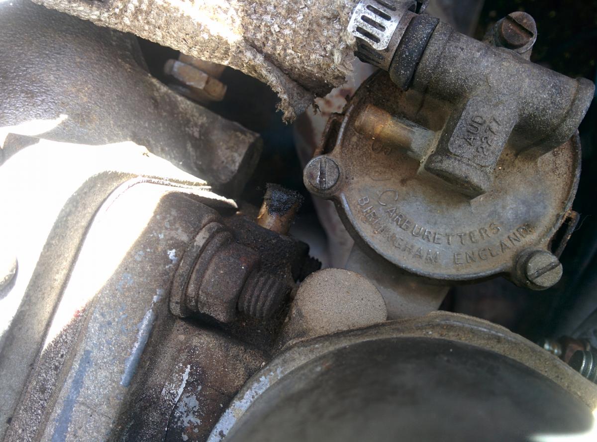

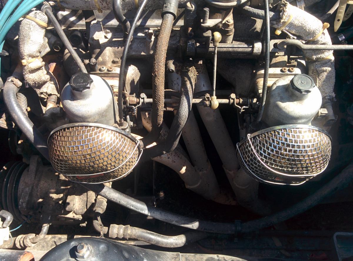

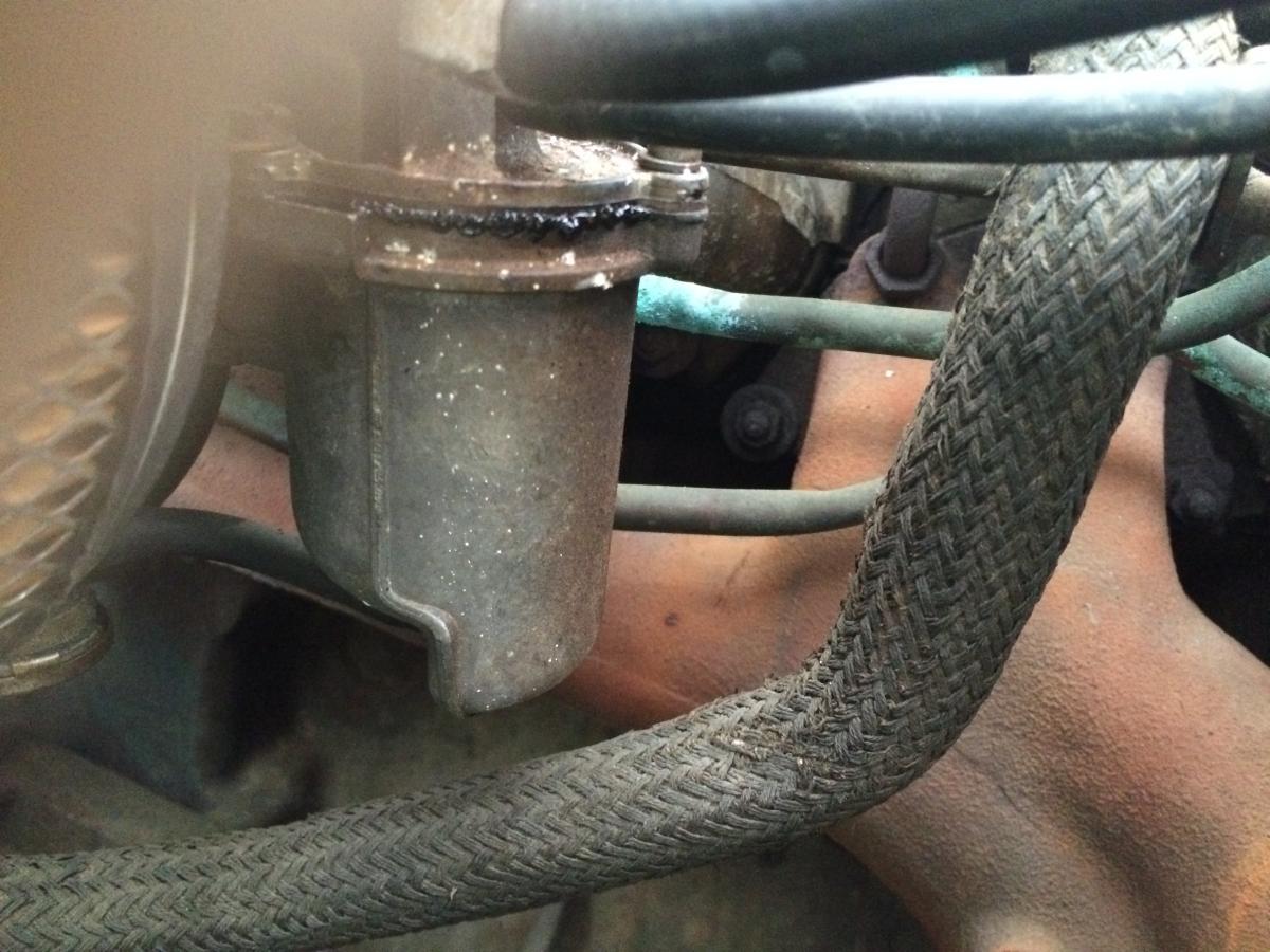

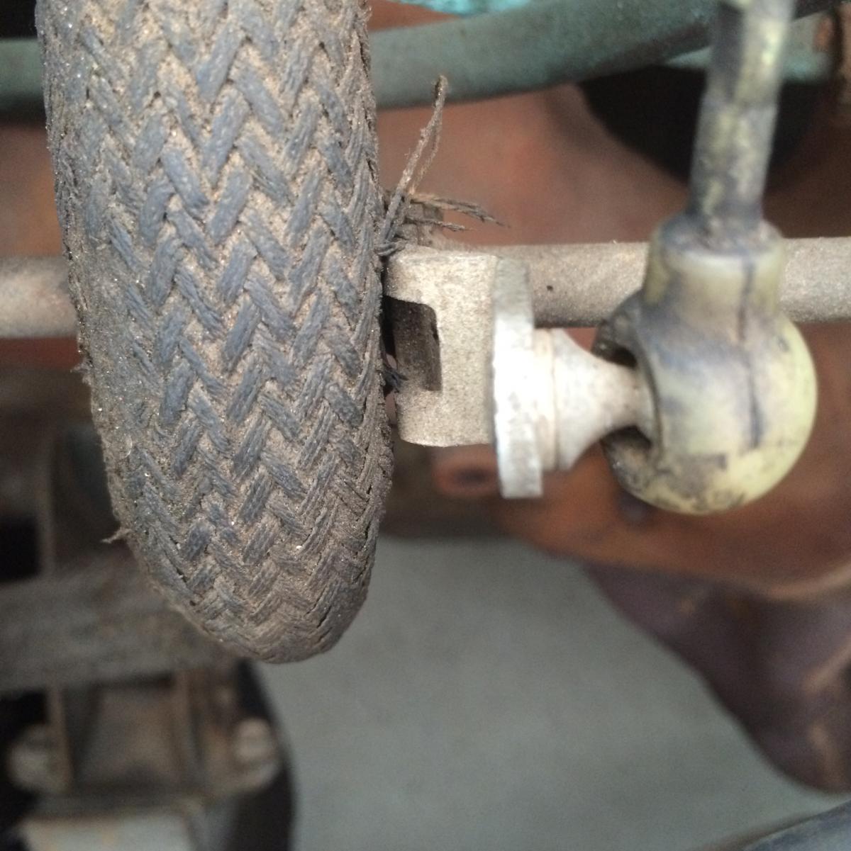

I am making slow progress with the tank but I've been looking around the carbs. They are British SU's. Unsure if how the hoses were connected, they seem rather od (to a noob).
Loop the loop and nice wear on the hose from the throttle.
close up
One hose is broken and this one doesn't go anywhere. Just to confirm, that where the hoses are connected to is the assy-servo diaphragm?
Hose in my hand was hanging next to the battery hose that goes out the bottom of the engine bay. I tend to think it could potentially pass fuel, seemed a bit close to the exhaust for my liking if that's the case.
I've been trying to find similar engine shots to compare how connections are set out. The throttle and the hose seem not to be close to each other.
I guess its not a gasket but fuel residue... yummy

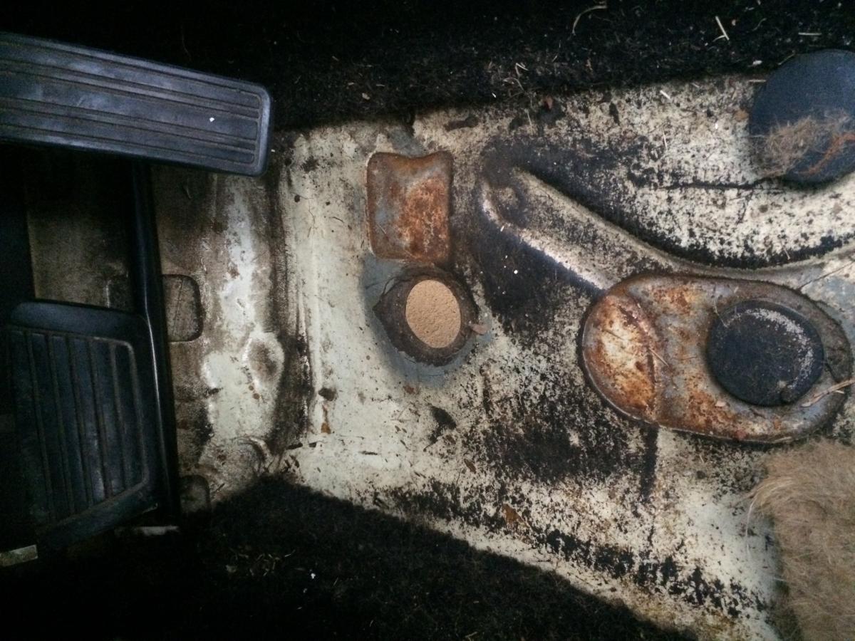

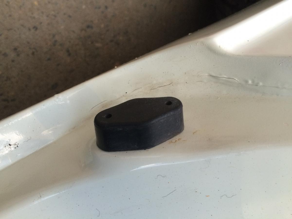

Body related. Drivers floor panel, floor 'gromit' is worn so there was a chance of water got in. To be cleaned and treated.
Passenger door is missing this door bumper. Are these available locally?
Found one in the states but prefer to keep it local if possible.
close up
Still trying to understand how it all works.
I have the exact same carbs ( I think, I'll get some photos later or tomorrow)

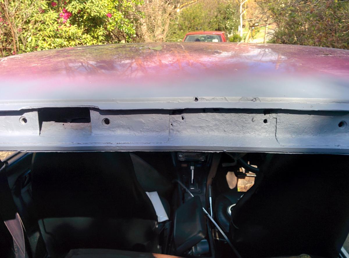

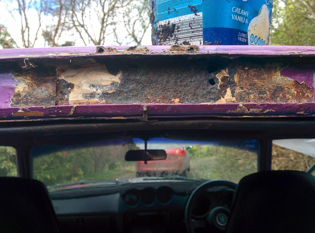

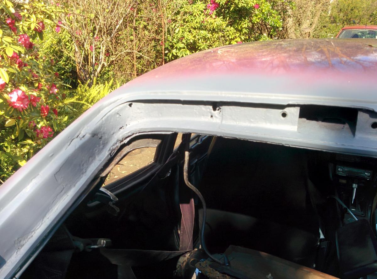

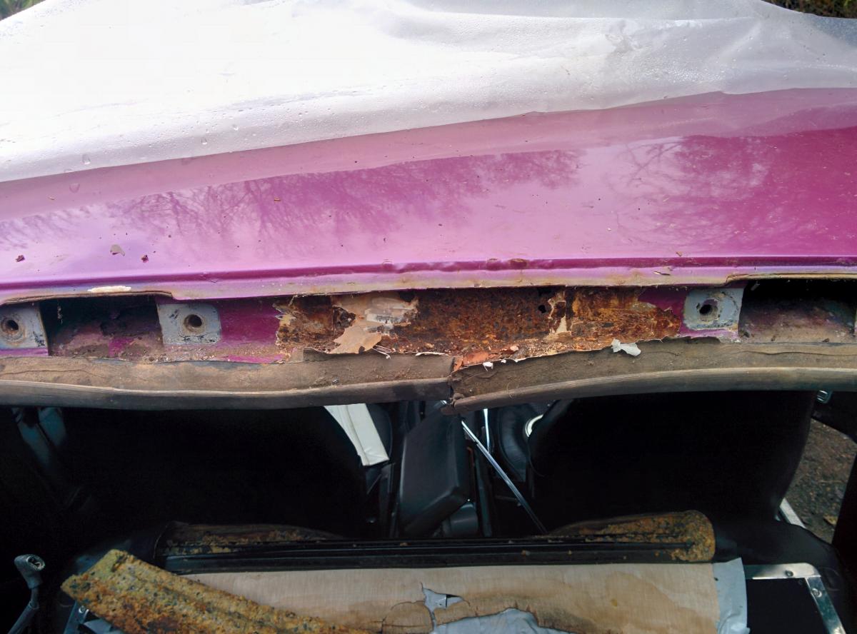

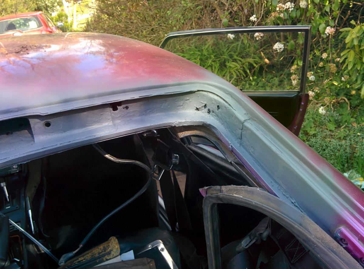

I then noticed the top of the hatch has rust coming through. I know there's another thread on 2+2 roof issues so its a bit of a worry.

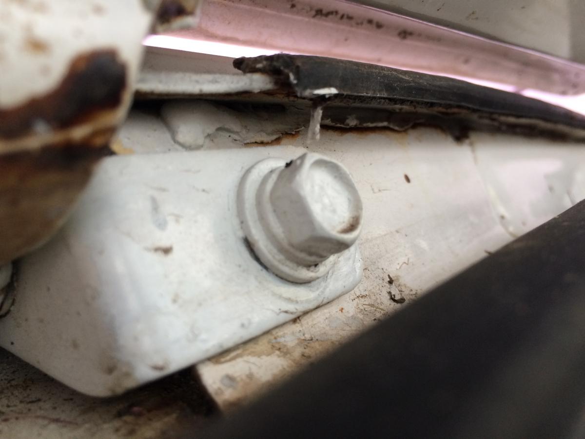

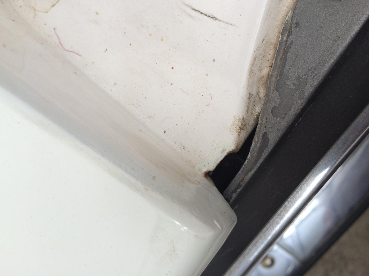

Just wondering, is there meant to be a gap between the rear lights and hatch area?
No there shouldn't
And something else i noticed in that photo, earlier in the thread, someone else mentioned that your rear slam panel looked "mint" and i just thought to myself i was actually thinking the exact opposite.
The rear quarter panel folds over into the slam panel  about half way down and is spot welded there, so why would someone bog over it and smooth it out /shave it, unless they were hiding something?
For example here is mine:
and yours has been shaved out and is smooth.
Id be grabbing a  brumby disk and a grinder and getting into it, and I have a bad feeling you should probably order a replacement slam panel from rare spares.
Good luck!
Rudi

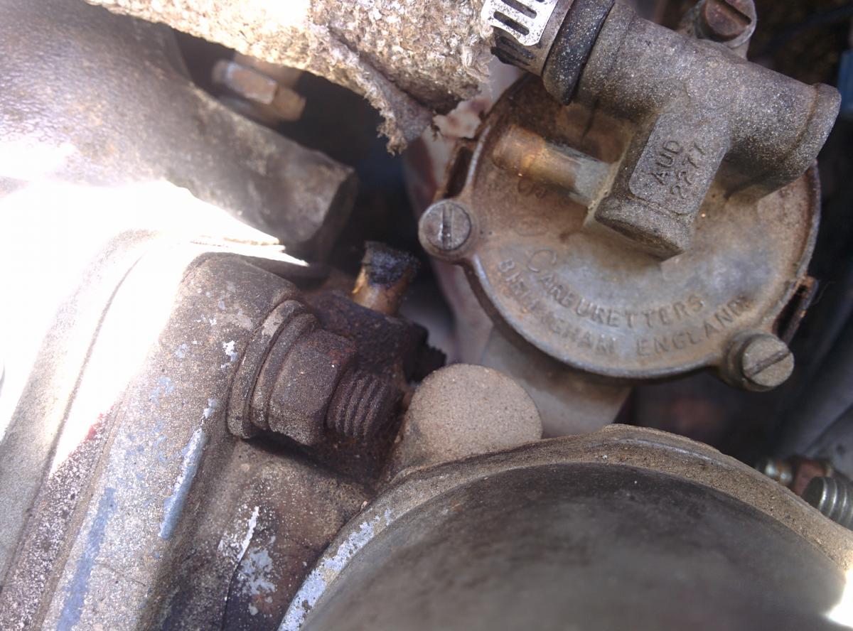

Completely forgot about the carb photos!
Also, I wouldn't worry too much about that rust at the top of the hatch...
But seriously, I would be sanding all of that back and dealing with it now before it gets this bad. I still need a short term solution for my issue as I don't have the resources to take to roof off etc. at the moment. I've just used rust converter where I can.
No there shouldn't
Good luck!
Rudi
Thanks Rudi, I thought it looked strange. I'll leave it for now and sort the tank and roof first. I might end up taking the lights out and see if anything is jumps out.
Almost need another car to compare with ;)

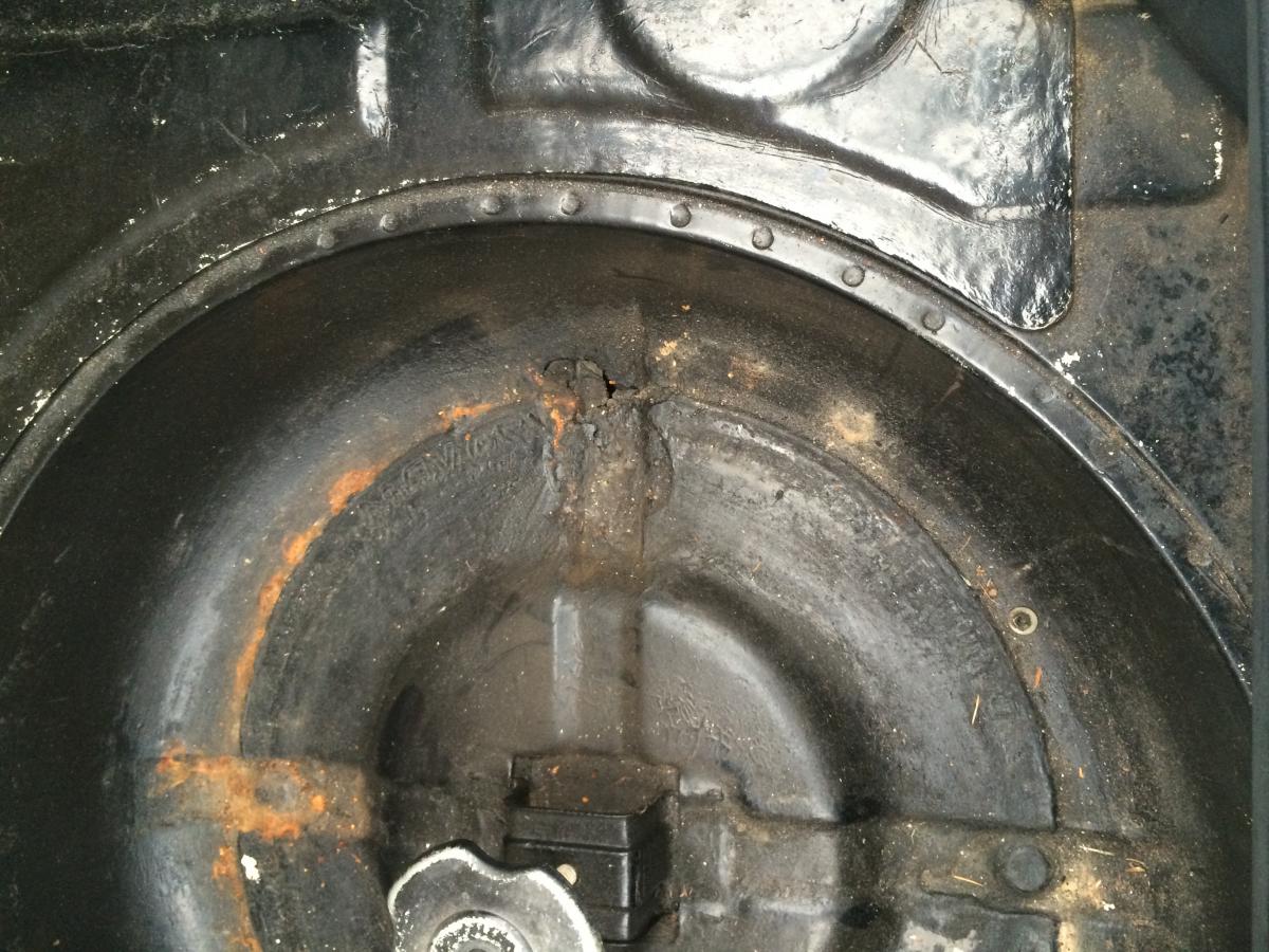

It has been a long time, almost 3 years to my first post and the car hasn't gone to far since then. We've been renovating of late, not for 3 years and that has shown me how little time i actually have to spend. To recap the past 3 years - the fuel tank was in pretty bad shape internally which i sorted using the tank sealing kit. I took the time to pretty up the outside of it. It took quite a few goes to get it right or to a state that i could live with. It does have rather a large dent which may have happened while it was off the car, possible when attached to the cement mixer.
IMG_2734.JPG.e3d33dd7273e2c547e6846a55caff154.JPGIMG_2746.JPG.f22e672e4b3e1c6c3d81b9962b1283b7.JPGIMG_5833.JPG.d69d541646a66e35234a8af13edc67ec.JPGIMG_5931.JPG.afcf9085f8f83847749162494129d8c4.JPG
After the tank I ended up removing the spare wheel well, yep what a pain and probably the wrong option. I ended up cutting a replacement out of a different car, it was so many years i can't recall the model. I basically made a template and walked around the wreckers in the jap section. The replacement panel fit perfectly but I ended up buying a proper one from Warren at Z parts - if any one wants the one below let me know.
The only benefit of not having the spare wheel well was that i was able to get into the back and work on the fuel filler section. I've removed it and was trying to recreate the panel around it. I had been fixed previously, and its was quite rough, so it doesn't bode well for the hatch area. I want to try enjoy the car while I'm still kicking so once i been able to drive it for a while i can get to that part.
That is pretty much it, i did waste a lot of time with the tank, it was too humid or too cold for the paint and I end up not doing much at all and waiting.
