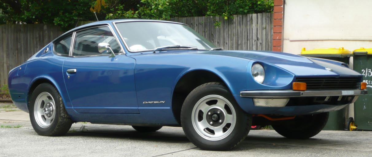

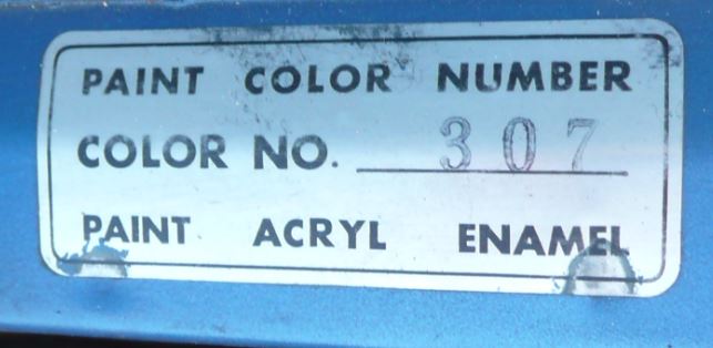

GongZ Posted August 18, 2015 Posted August 18, 2015 Very sure. 307 was available on late 240Z's here. As far as I know, 307 blue was not available on US 240Z's, which is why most people think it was only a 260Z and 280Z colour. My car is a 9/73 compliance plated 240Z which has never been repainted (I should say not yet anyway). I bought it from the original owner in 1984 when it had 19,514 miles on the clock and it had never been changed from the way it appeared in Capitol Motors' showroom. The pics show my paint sticker and a general view. Quote

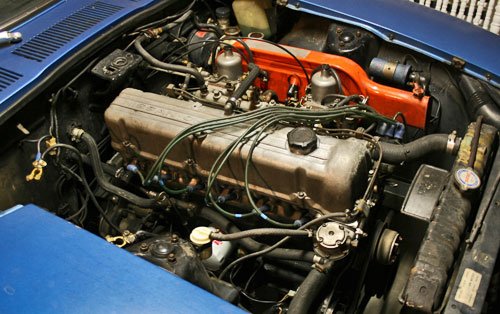

blu260z Posted August 27, 2015 Author Posted August 27, 2015 (edited) So with all the engine work coming along nicely, I thought I might take a look at the engine bay. What I have is a large battery tray rust issue, because of that battery acid has either stripped the paint or discoloured it. Should I paint it blue again or shoot it all satin black? The reason I am thinking black as it will hide most of the wiring and hoses and make the cleaned engine and freshly painted BLU engine block really show ? What do you guys think ? Edited August 27, 2015 by blu260z Quote

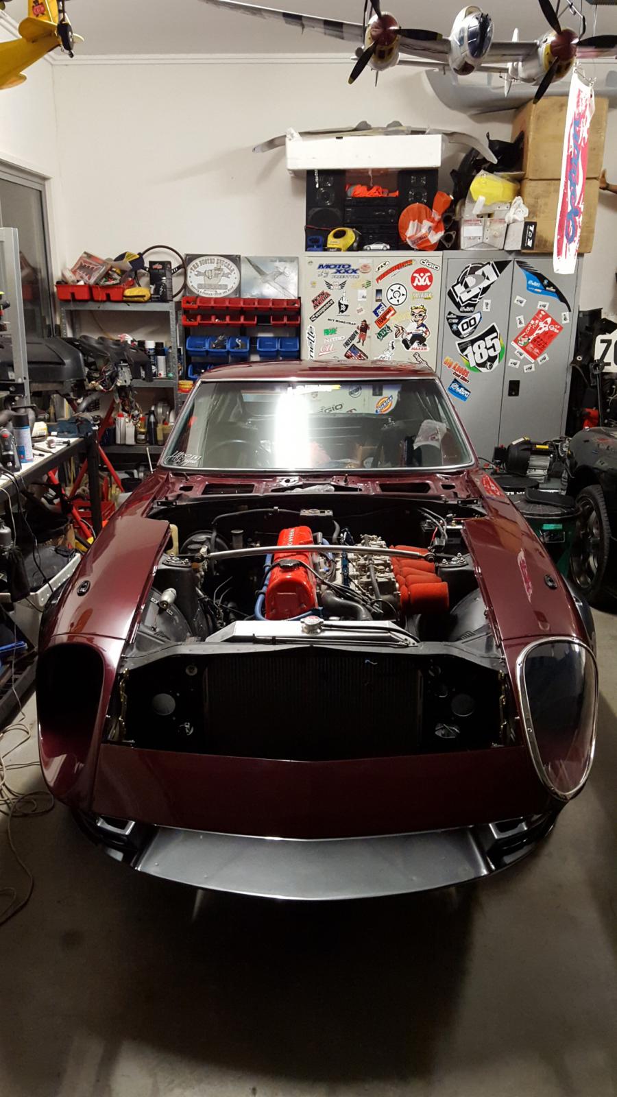

d3c0y Posted August 28, 2015 Posted August 28, 2015 (edited) That is a crappy pic for the satin black engine bay argument. The idea with the satin black is about making the engine the centre piece of the engine bay. Mine is obviously far from finished but gives you a better idea. Edited August 28, 2015 by d3c0y Quote
blu260z Posted August 28, 2015 Author Posted August 28, 2015 Thats a much better pic d3c0y. I like the satin black look especially if the engine is clean and really pops like you said. I think I will take some time to try hide some of the wiring, radiator overflow bottle and charcoal canister etc. Thanks fellas Quote
d3c0y Posted August 28, 2015 Posted August 28, 2015 Re-attached up the right way now. Yeah there is a lot you can take out of there. I am removing all the fuel lines from the chassis rail and have moved the coil to the block etc. Then you can have specific details like the radiator and the engine bay inspection light that really pop. Best of all I did my engine bay with rattle cans and you can touch up anything you scratch. blu260z 1 Quote

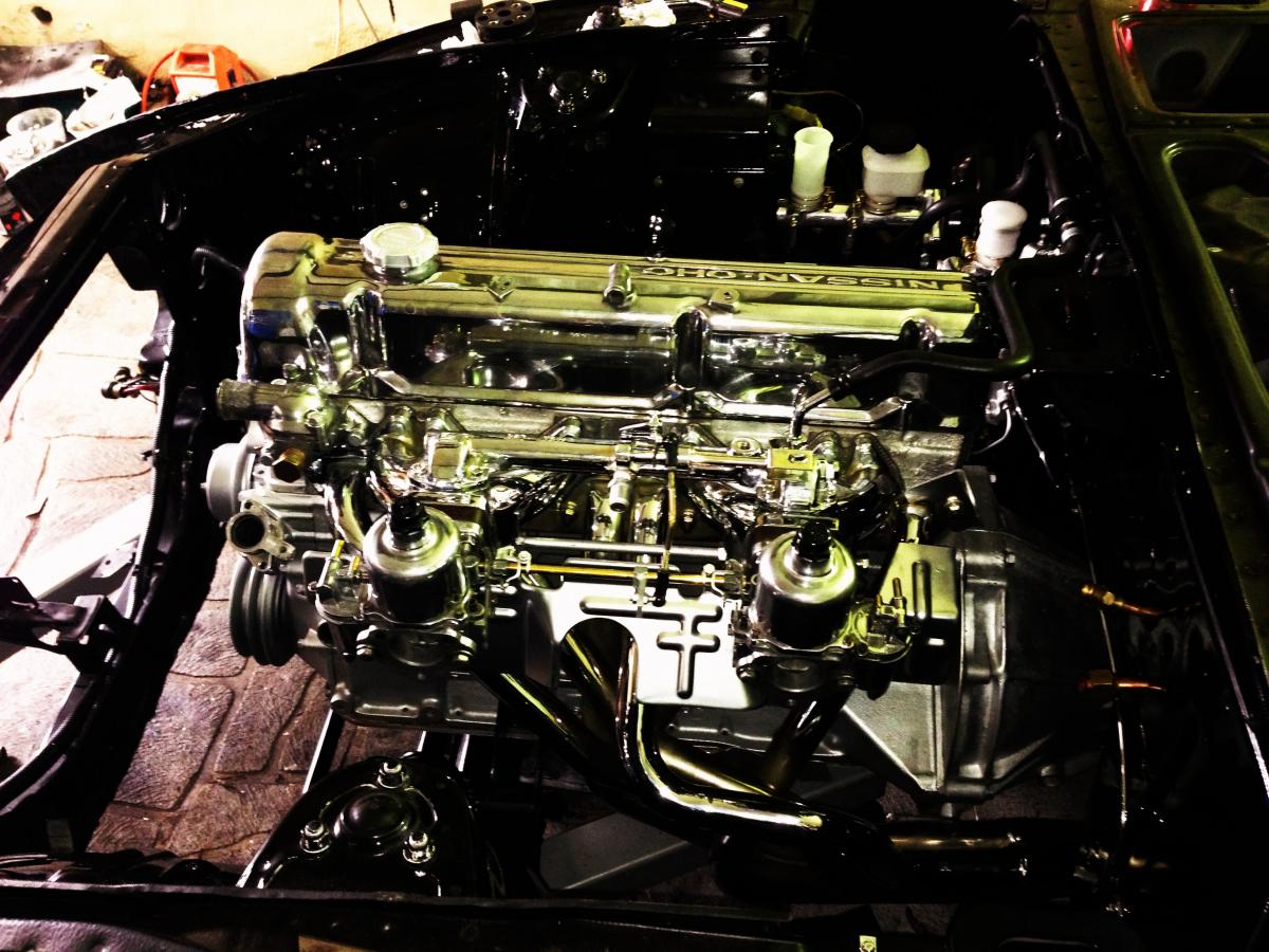

blu260z Posted September 11, 2015 Author Posted September 11, 2015 Had an RDO today so made the most of the cracking weather and spent the day locked up in the shed ?. I have been working on the engine and engine bay area lately. I decided to go with the satan black enginebay and glad I did, the engine is going to really make a statement in there. So I have been cleaning, removing and degreasing To prep the enginebay for paint. Here is a pic of it so far its all painted just needs everything bolted back in. Now the engine☺ I fully stripped the head and spent about 15hrs total giving it a port polish, wow was that a task you could fall asleep doing that. I re lapped the valves and cleaned up all the cast aluminium parts then sent the head off to get a light skim just to deck it. And here is the almost finished project looking all pretty with trolley I custom made for my engine and gearbox ☺ George 1 Quote

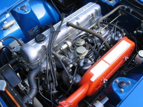

Geos260 Posted September 13, 2015 Posted September 13, 2015 (edited) my engine in a gloss black engine bay Edited September 13, 2015 by Geos260 Quote
blu260z Posted September 20, 2015 Author Posted September 20, 2015 Spent some time today bolting up the intake manifold with the lung transplant. Now all you Zed originalists you might want to take a seat, Because I am keeping the 350 holley. I am not chasing the "bling" chrome engine bay look so it will have a ramflo air filter. I also heat wrapped my extractors I do like the look it gives, plus the obvious heat reduction reason. The engine shouldnt be far away from dropping back in as the wiring has been tidied up and the loom put into split conduit tube. Enjoy the pics fellas Quote
blu260z Posted October 1, 2015 Author Posted October 1, 2015 Ok guys mannaged to get the engine back in before the long weekend. I was only waiting on a few small things like my clutch fork rubber boot and some stainless steel exhaust flanges from the laser cutters. I am really glad I went with the black engine bay, it has really made the engine the focal point. ☺ some nice painting work by the girlfriend Engine bay and engine before and after oldmates260z 1 Quote
