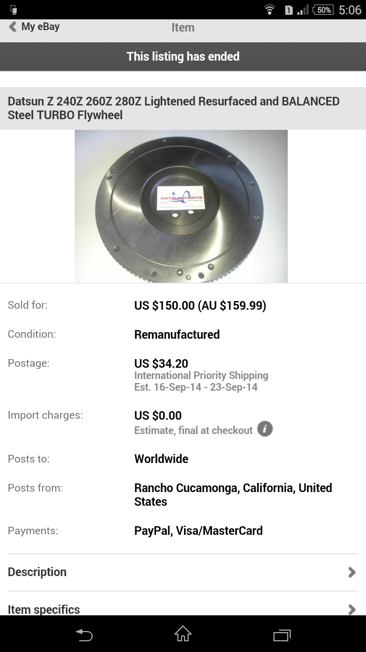

sydney mike Posted September 6, 2014 Posted September 6, 2014 Your intentions for your zed sounds the same as mine and my engine guy told me not to go too light and waste money on a performance lightened flywheel for the street. So I had a stock 240z lightened, balanced and IIRC it was under $100 exchange. I am running mild cam with triple carbs. Feels good. When I was at the workshop he showed me a performance flywheel like the one pictured below. It came out of a track car because the owner deemed it too light even for the track and went back to a lightened stock flywheel. Here's some more info: http://www.infinitegarage.com/light-flywheels-pros-and-cons/ Quote

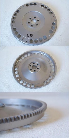

Riceburner Posted December 18, 2015 Posted December 18, 2015 There's this old thread. http://www.viczcar.com/forum/topic/6688-light-weight-flywheel/ It's been great on my car, really changed the throttle response. I got it from eBay for about $300 quite a few years ago, I have seen them on yahoo Japan still. Datsun Spirit also sell them too https://datsunspirit.com/shop/lightweight-cromoley-flywheel/ And a few pics Quote
